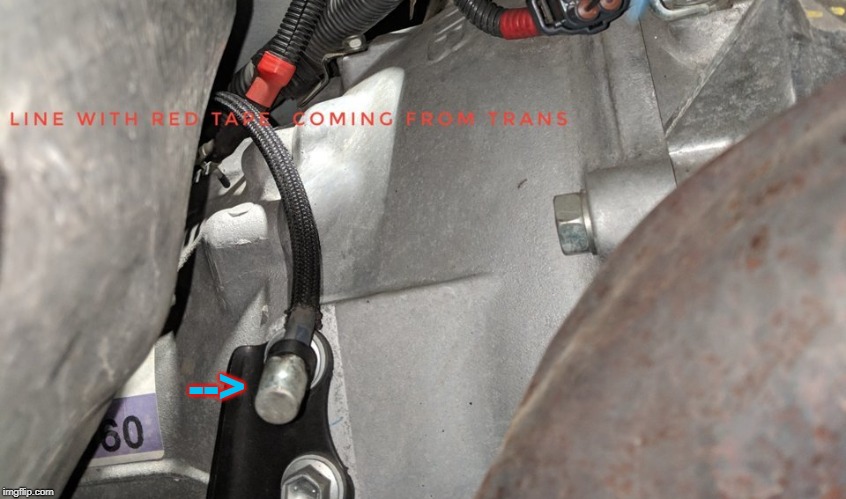

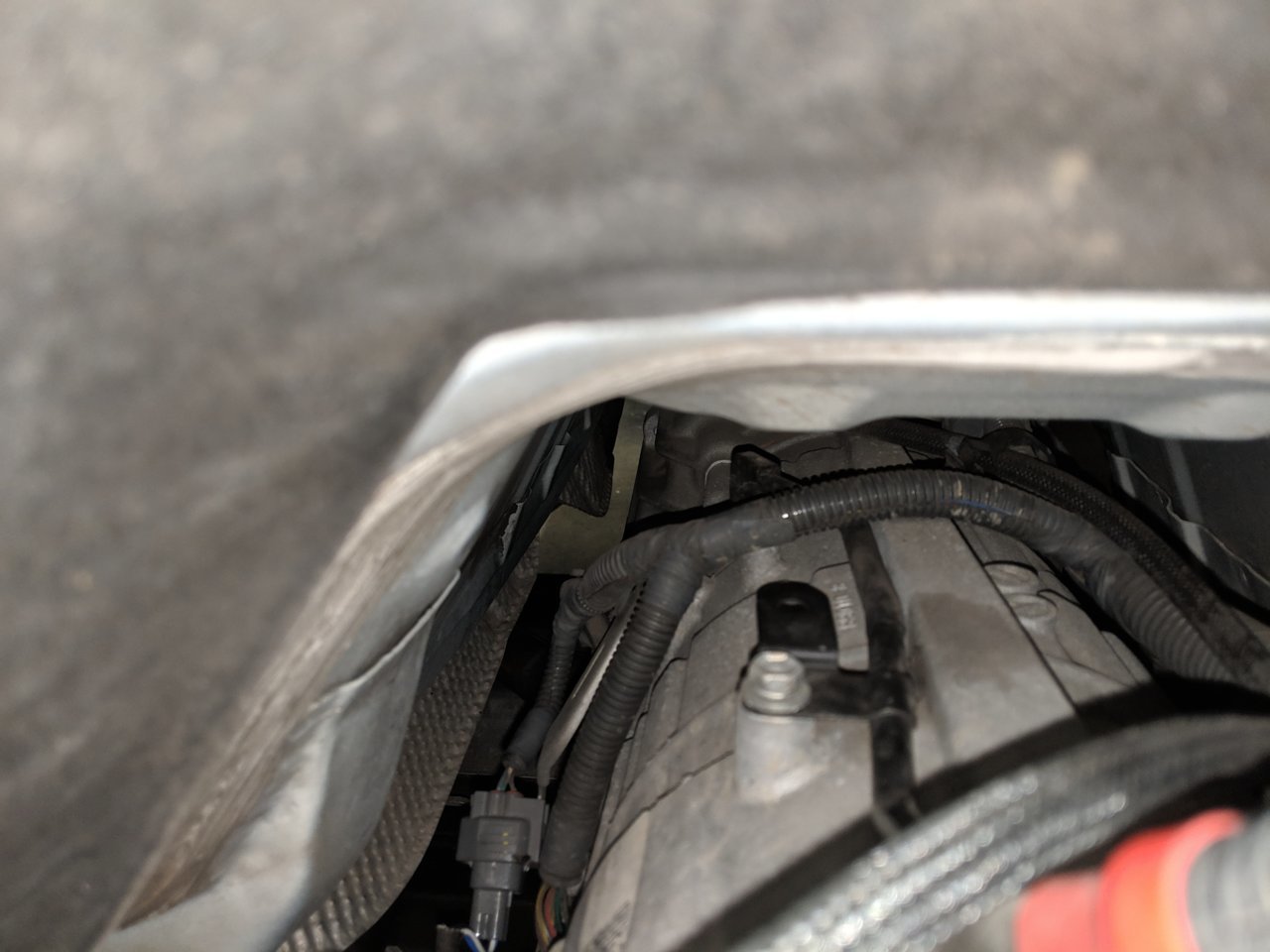

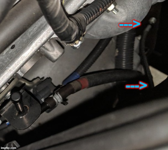

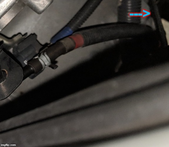

    Now that I'm in a much wetter area, I am moving my rear diff breather to the engine bay (was in the fuel door and would get wet). Figured I'd take care of the transfer case and transmission breathers while I was running the line. You can see the transfer case breather hanging down in the first pic.

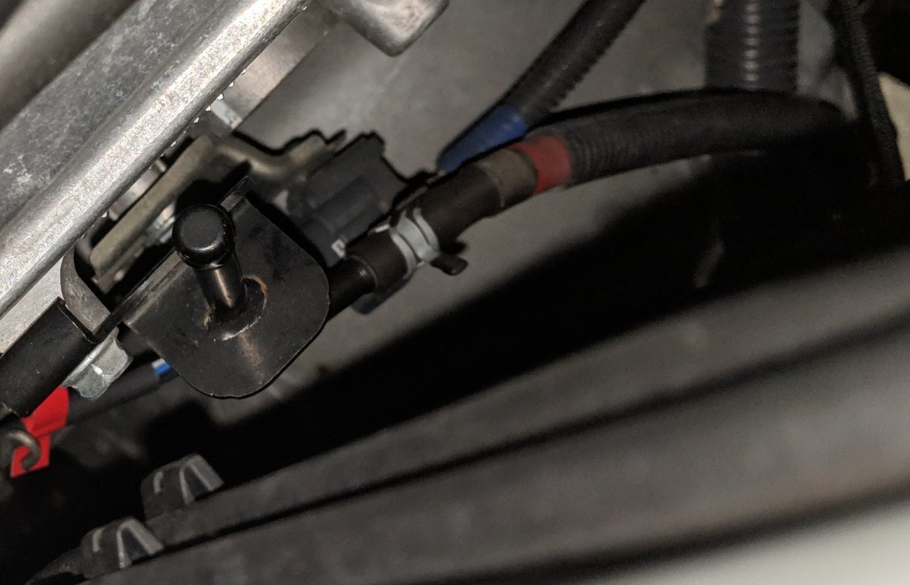

    From all the info I could find, the transmission breather on my 5 speed (Automatic) 2010 TRD Sport with tow package should terminate into a plastic breather where the engine and bell housing meet. I think I found the breather line but I can't find the breather. It appears that the line continues into a metal bracket that's bolted to the back of the engine block. What am I looking at? Im pretty sure that is the trans breather, but what does it terminate into?

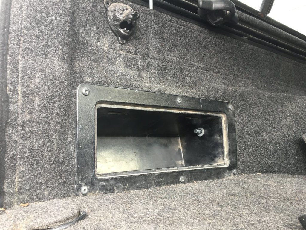

    Also, why not relocate the rear diff breather to the bed cubby?

    I have other plans for my bed cubbies and I know the engine bay will keep the breather dry.

    I just cannot find the transmission. I spent a good while feeling around the top of the transmission and sliding my phone up above the transmission. There is only 1 line, that felt like a breather, coming off the top passenger side of the trans and ending in the metal bracket on the side of the engine block (pictures above).
    Heres a top view of the trans, facing towards the back. Thats the line with the red tape that ends in the metal bracket on the block.

    On a second look, that braided line runs all the way back on the Transmission. You sure that connects to the transfer case?

    That's the transfer case breather. I followed it back to the transfer case. I moved it out of the way while searching for the transmission breather.

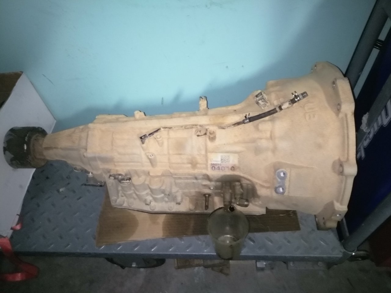

    @Nixinus Yours is here:
    I thought you had an AT. :facepalm:

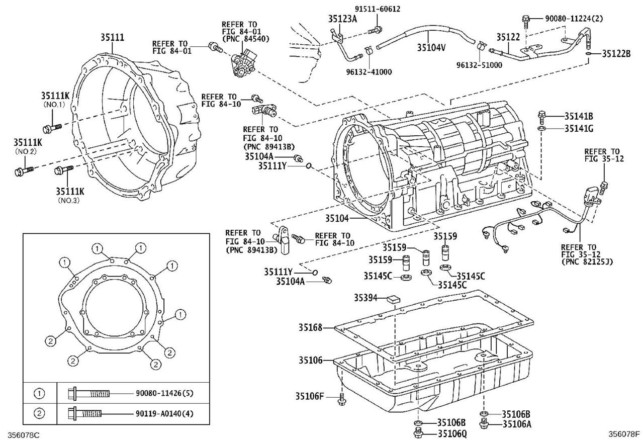

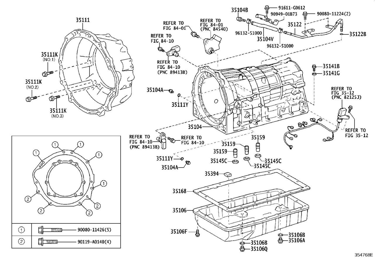

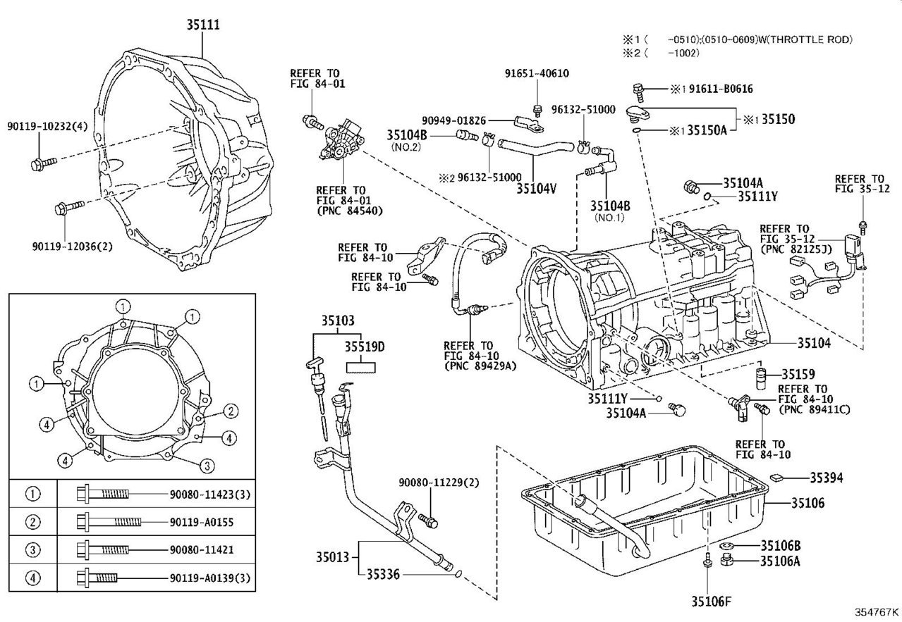

    The parts fische you posted got me looking at OEM parts diagrams. Under my truck specs I can find 3 different diagrams that appear to show the breather in different configurations. I can't figure out if it's different models of the trans or different views.
    This one has a dipstick so it is clearly not mine.
    This one appears identical to the 3rd fische except for the way the breather terminates.
    Mine appears to be this one. Part #3512335010 (35123A on the diagram) is the black metal bracket bolted to the back of the block. It is the terminal of the line I assumed was the breather. It is listed as "SKIRT, TRANSMISSION BREATHER". I would love to know how it functions as a breather.

    It might be a plastic breather too, so look for plastic and metal.
