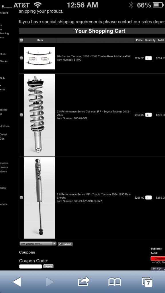

    For that price you could get a really nice coil over setup that would be my recommendation.

    Full coil over set up with aal and new rear shocks all fox
    May be a tad more but a lot better setup if you ask me

    what website is that and how much lift is that?? and is that everything ill need or are there other parts to order also? i would be happy with a 4' coilover lift i just need to know evrything i need to buy. i wont be offroading much since cant afford to tear anything up right now and its everyday vehical and with baby riding in back seat lol thatnk yall for the help btw

    Tcprerunner what website is that and would that be the only three things I need to buy, cuz it seems like in the kits there are alot more peices involved to lift it? And how much lift is that?

    http://sdhqoffroad.com/
    And yes that is all you need aal gives you rear lift and the coil overs give you front it is max 3" but you won't even need that to clear 33" tires.. This setup will work q0x better then a db lift .. Only other thing you may need is extended brake lines and if you do the Max 3" you will need aftermarket uca's to correct alignment issues..
