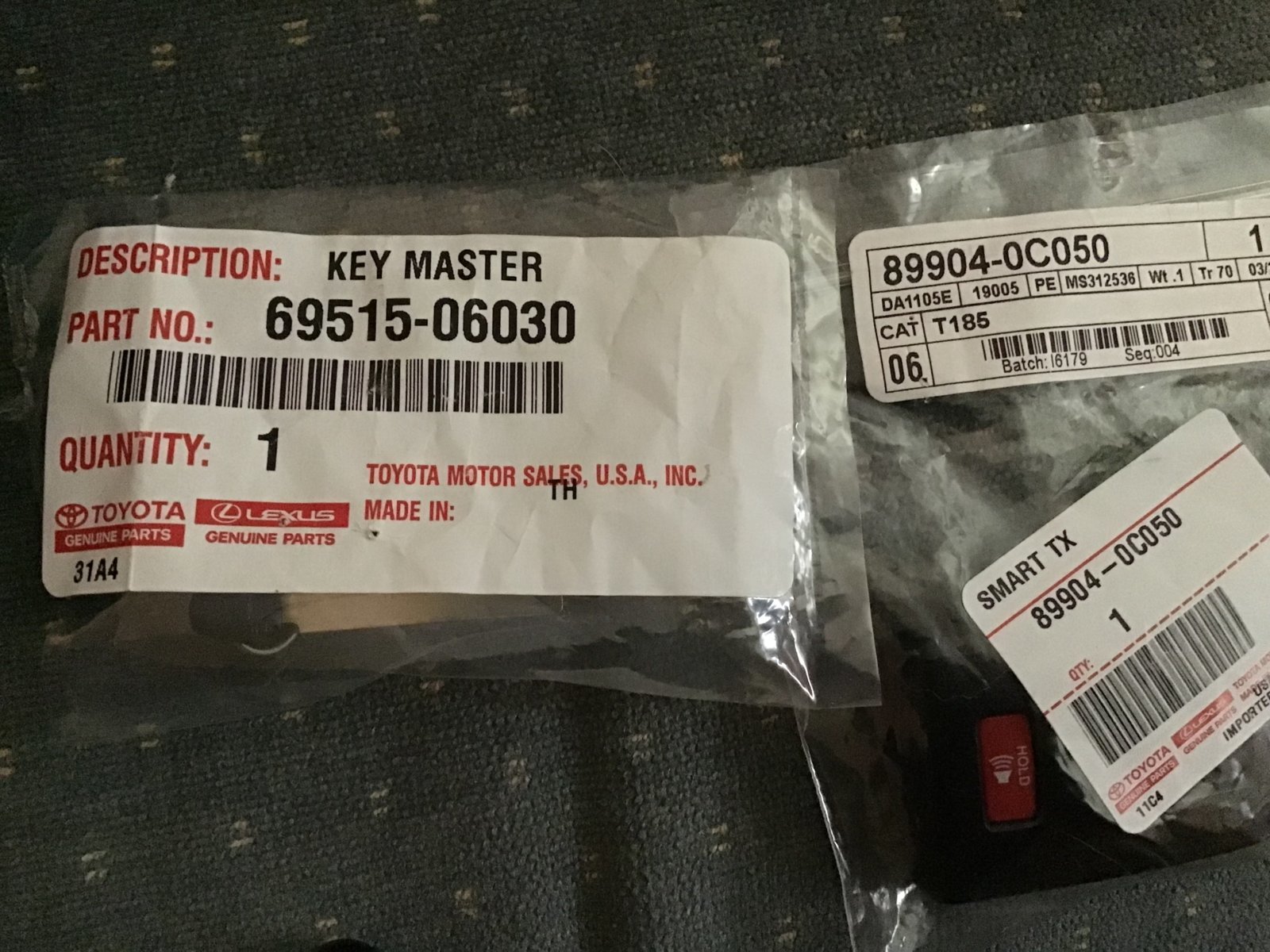

    IMG_0457.jpg Does anyone know about these dang keys? I recently purchased 2023 Taco TRD off-road dealer had one key ( the smart variety, push button start yadayada ) He owed me second key. I traveled pretty far to get vehicle, so he fed-ex other key, a month later.
    Key Came in two pieces. The key master appears to be ‘cut’ matching the original. Inserting the key master into the fob doesn't appear to be enough to make the key work. Do I need to do any thing- like go to dealership or locksmith, or do the old key new key over the start button dance?
    Is there another step to programming the key to the truck? Any help would be appreciated.

    There is no way to pair that 'new' key to the truck with what you have on-hand. (no button dance, etc will make it work).
    It will have to be done by a dealer, locksmith, or you will need hardware/software to do it yourself. Which solution is most ideal for you is going to vary widely based on how much a dealer/locksmith charges and if you want techstream.
    I went the route of getting Techstream working so I could add my own keys. (as it also allows for alot more customization and diagnostics, but can be an effort to get working)
    Here is an old example of how Techstream is used to add brand-new (never used) keys. (links are old and probably dead on this post)
    https://www.tacomaworld.com/threads/how-to-program-your-own-smart-key-fob.555673/
    (To program a key that has been 'used' on a different truck is very difficult by comparison, this process above doesnt work.)
