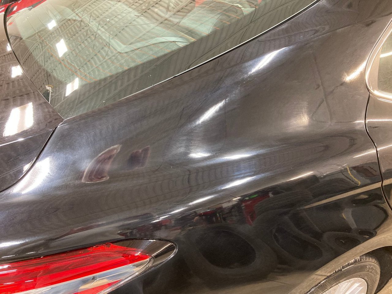

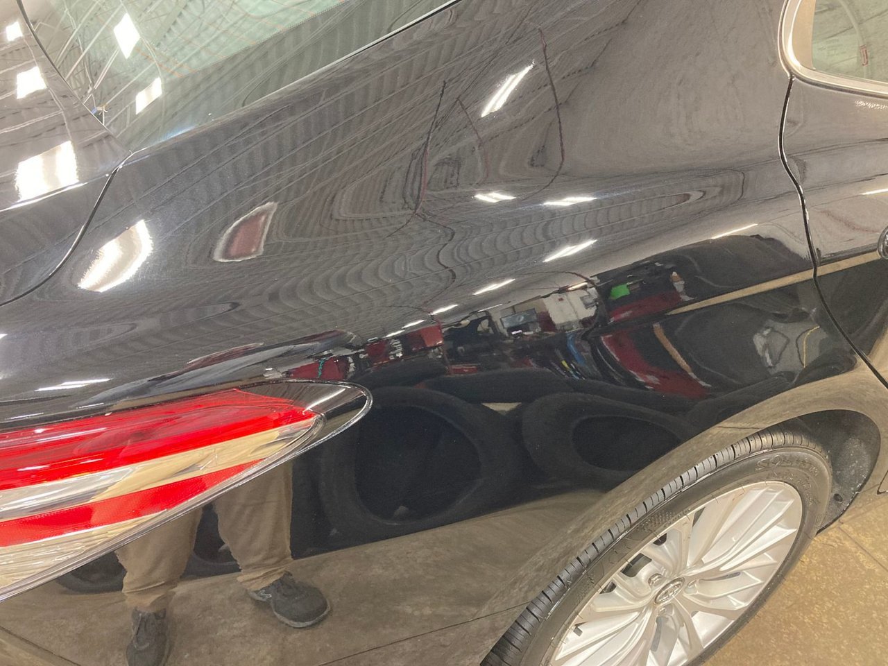

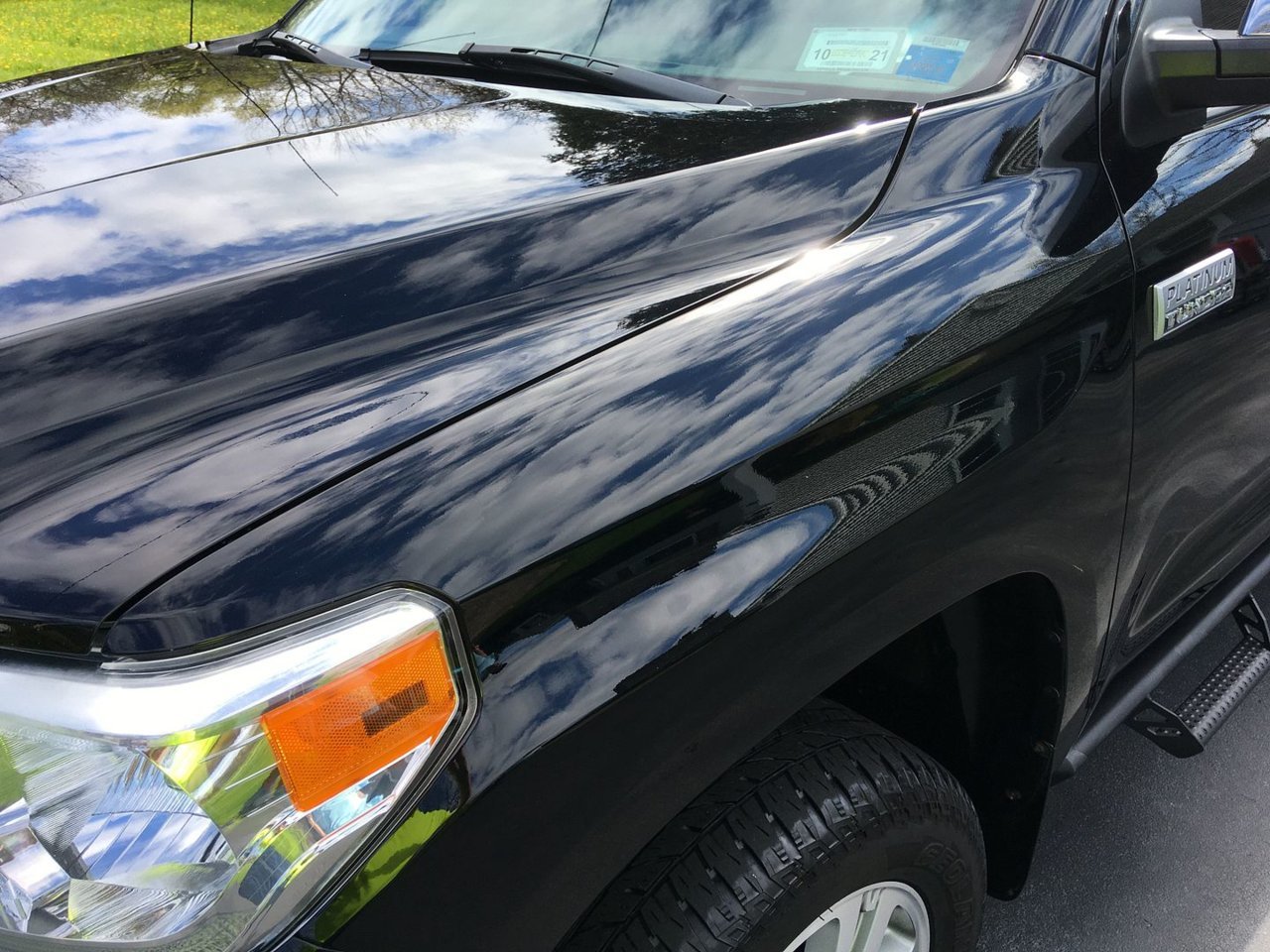

    Let me see if I can answer your questions. First, I haven't used 3D One much in direct sunlight. The one (2016 Black Tundra) that I did in direct sunlight turned out awesome.
    As for 3D One on soft, finicky clear coat, I haven't run into any clear coat yet that doesn't tolerate it just fine. As with any polish - and any finish - go with the least aggressive process first. For 3D One, that means starting with a softer pad, then moving up as needed. For instance, here's a 2019 Camry with truly abysmal body shop paint on the right rear quarter panel that they wanted to see if I could make it look a little better. How's this for truly awful?
    Here's that same quarter panel 30 minutes later after one pass with Menzerna 400 on a Rupes Blue Cutting pad, then multiple passes with 3D One on a Hex Logic Cutting pad on my Flex 3401. Yea, I hit it pretty hard, but the 3D One finishes out really well.
    I used to use M105, then abandoned it in favor of M101. The M105 just caked and dusted way too much for my liking. I still use M205 for a finish polish on a fairly regular basis. I no longer use even the M101 because it was just too much of a PITA compared to 3D One and / or my current favorite heavy cutting polish - Menzerna 400.
    As for a learning curve on 3D One, it's pretty simple. It'll cut for as long as you can polish and you'll wear out before it does.
