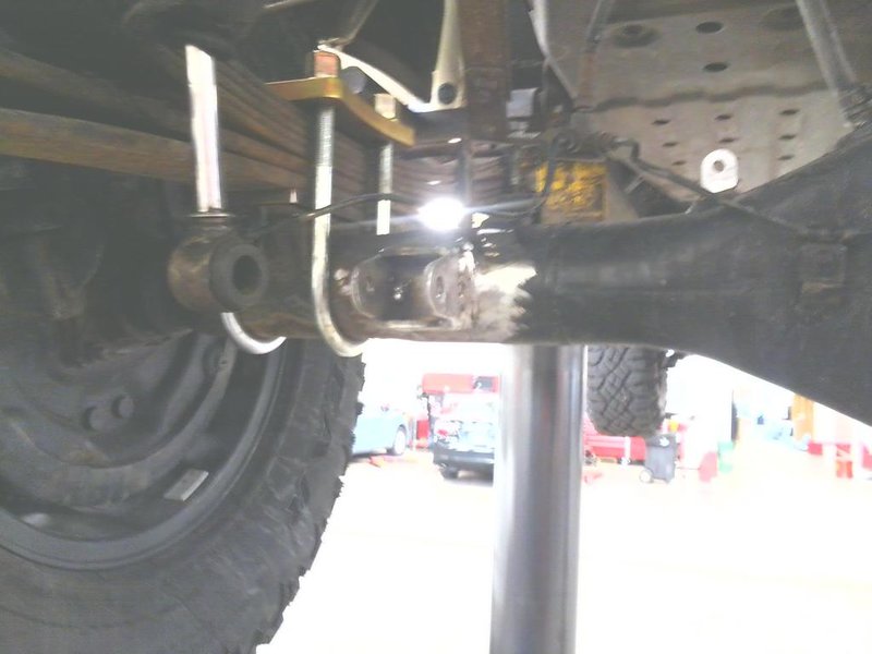

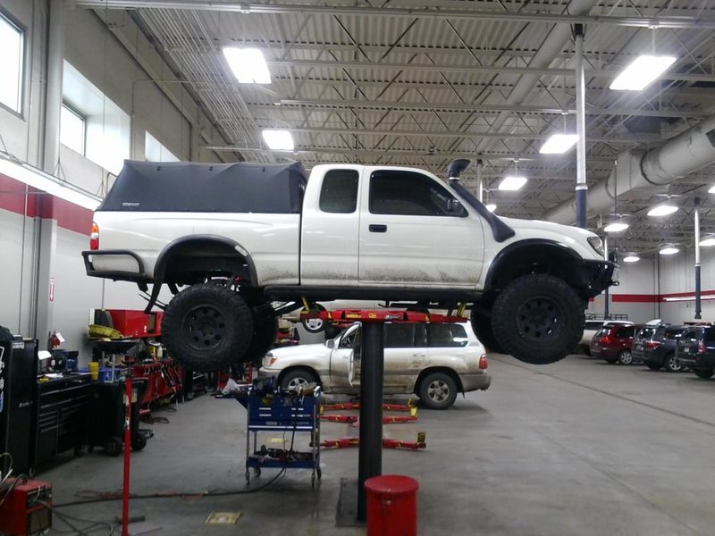

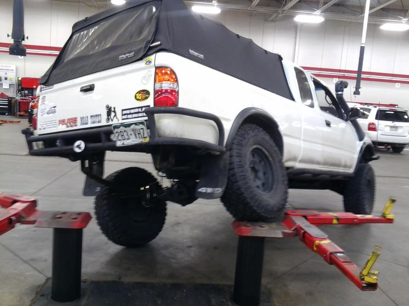

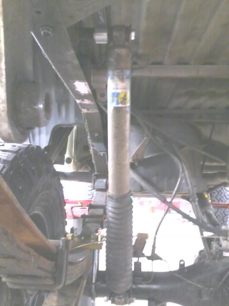

    i chose to keep my shocks mounted staggered for stabbility reasons. i ended up doing almost exactly what the guy in this thread did
    http://www.tacomaworld.com/forum/1st-gen-tacomas/236813-rear-shock-relocation-question.html
    for the top of the shocks. I couldnt weld the shock mounts closer to the ubolts because the axle tube tapers right there. I would throw the mount off angle. so i welded them horizontal with the axle and just on the edge of the taper. this required me to space out the top of the shock like in those pics in that thread. pain in the ass.
    finding sleeves that were the right ID and OD for the bolt and shock bushing..... i was lucking to find aluminum spacers which worked really well.
    onece i had the shocks mounted straight up and down. i removed them and started measuring.
    full droop measurement 26 1/2
    droop while flexed, almost lifting a front tire 23 1/2
    compressed while flexing 17 3/4
    (not sure how else to measure compression? cant compress both sides all the way? )
    so im looking at some billies that are 17 compressed and 28 extended. should work fine...
    all in all this project kicked my ass. so much measuring and cutting and trimming and grinding.... but it is pretty cool looking, theres almost nothing under the axle to get hung up on now:)
    still gotta mount bump stops and reinforce above the shackle hanger
    pictures!

    what do u think about the shock travel numbers vs the new shock numbers? shorter then needed by 3/4 inch and longer by almost 2 inches, should work right?

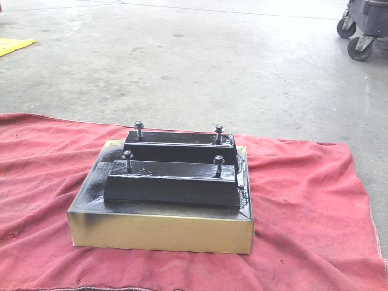

    made these today....

    dents & scratches
    nice...another step closer

    What are those things you built?

    bump stop mounts...weld them to the frame where the old bump stop strike plate was
