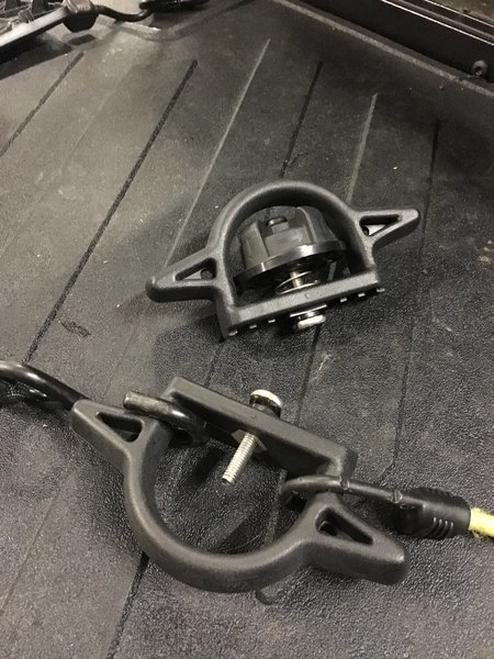

    I had a play around with the OEM cleats and the biggest issue is the wheel - take that off, replace it with a nut and it'll fit just fine. It's flush up against the top of the tonneau rail so it loses some of it's function but for occasional bungees and securing lighter cargo I'm sure it'll be fine - at least it'll work until I find a need for something different, but that's a problem/project for future me...
    I'll grab a couple more pictures once I've picked up the right nuts and have them in place but this should give you an idea.
    The curved part of the D is lost, thats the part thats flush against the tonneau rail but there's enough of a gap (about an inch) between the flat part and the pointy bit to get the end of a bungee or a tie down in. Win!
