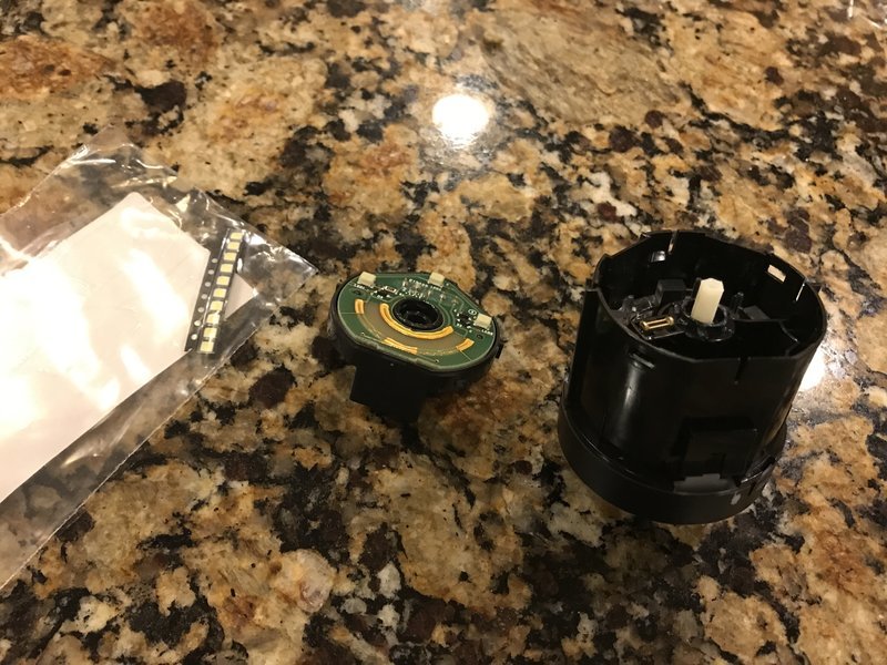

    Any LED like these will work. You can find any color you'd like. As far as a write up goes I don't know of any. It's really just take the switch apart. Take the factory leds off and solder on the new ones. I know that which way the leds goes matters but I have no idea how to figure out which way they go. I just put them on, tested them and then rotated them if they don't work.

    Got the switch apart! Now got to get this thing soldered!

    I soldered my new LEDs on last night. Went very well and looks awesome white. I noticed that the LEDs on the switch and the new LEDs both had little triangle markings on one corner or each LED. I made sure to use the mark as a way of aligning it the correct way and all 3 worked the first try!

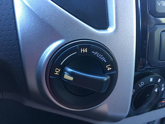

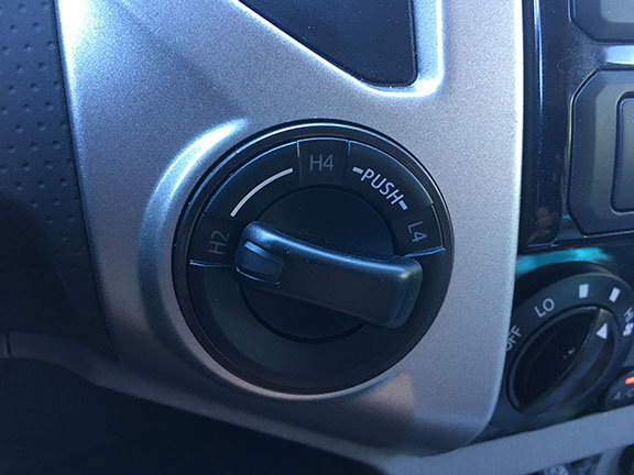

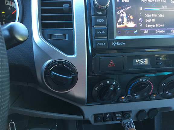

    Switchlightupclose_398ef39712b6121912aae3950bfb382f695f0e12.jpg Switchofffar_7b65db13477ab458ad3bb19f8db7c26f4b8ad4d1.jpg Switchlightupfar_897cf4e868ba26fb094f92b03088779bad002d32.jpg
    I used white LED's IRL they look white. I am not sure why my iPhone camera made them yellow.
    I used Rustoleum Universal Carbon Mist to paint my ring. I also gave it a urethane top coat. It blends into the dash perfectly.
    Turned out AMAZING!!! Thanks Everyone for all of your help!
