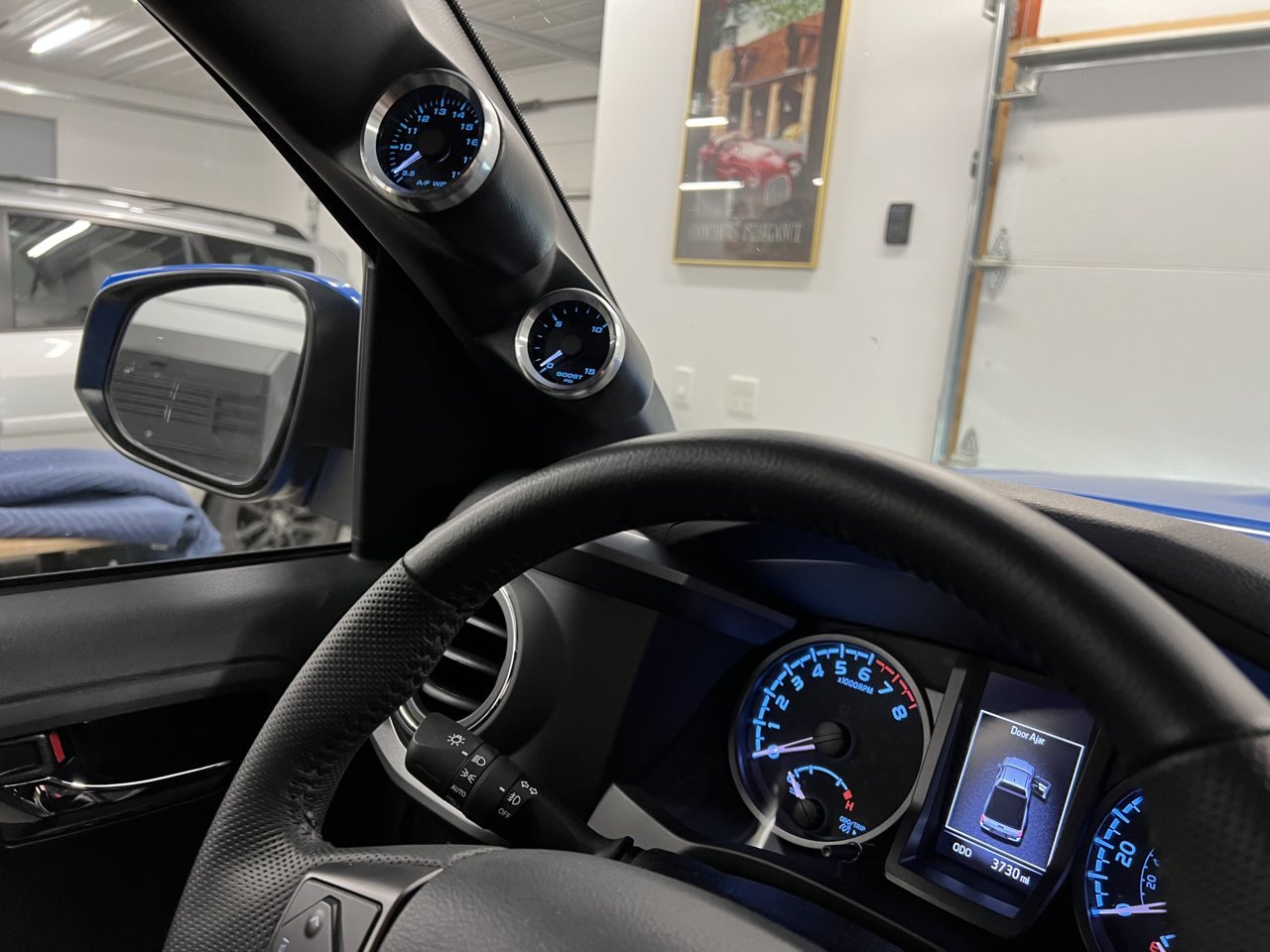

  5. Feb 28, 2022 at 2:04 PM
    #2065
    Kruuuzn
    Kruuuzn Well-Known Member
    Jan 6, 2020
    #315283
    683
    Randy
    Traverse City, Michigan
    Yup, I can see that now that I've had a chance to see exactly how a boost only gauge works. I may just bite the bullet and buy the vacuum/boost version.
    I wrapped up my gauges this afternoon. They didn't turn out too bad.
    EDIT: Speedhut told me I can send back my boost gauge and they’ll rebuild it to the vacuum/boost configuration for $40. That sounds like a deal to me. I think I’ll tear it back apart tomorrow.

  6. Feb 28, 2022 at 2:05 PM
    #2066
    Supr4Lo
    Supr4Lo Well-Known Member
    Jul 23, 2018
    #260306
    3,633
    Jason
    Surprise, AZ
    2020 DCSB Offroad MT, Supercharged, NWF Eco-Crawler, 4.88's Locked F&R on 37's
    Where's the A-Pillar Pods from? looks great!
  7. Feb 28, 2022 at 2:06 PM
    #2067
    758_Moto
    758_Moto Well-Known Member
    May 1, 2020
    #326496
    294
    2004 LT Taco, 2019 Taco
    2019: Icon Coilovers/UCA/AAL, 16x8 Methods/285 Duratracs, URD Spec-U Exhaust, Nexus +P Tune 2004: Chaos LT w/Kings/62" Deavers/12" TC Shackles, Glassworks hood/fenders/bedsides, TRD SC, URD fuel mods/lightweight flywheel/10psi Pulley, JBA Headers, TT Supra MAF
    That looks great. I didn't know anyone had come out with A-pillar pods yet.
