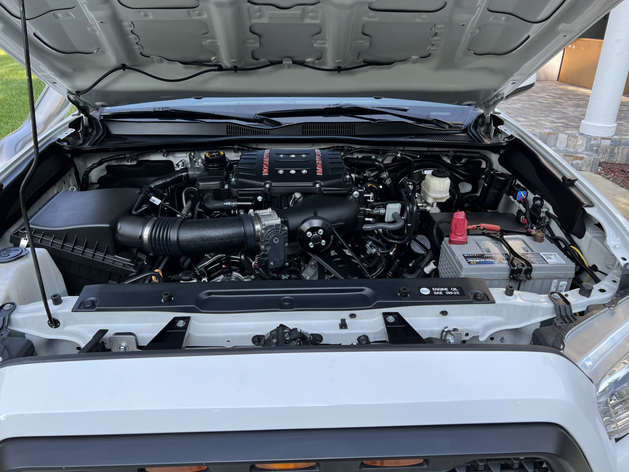

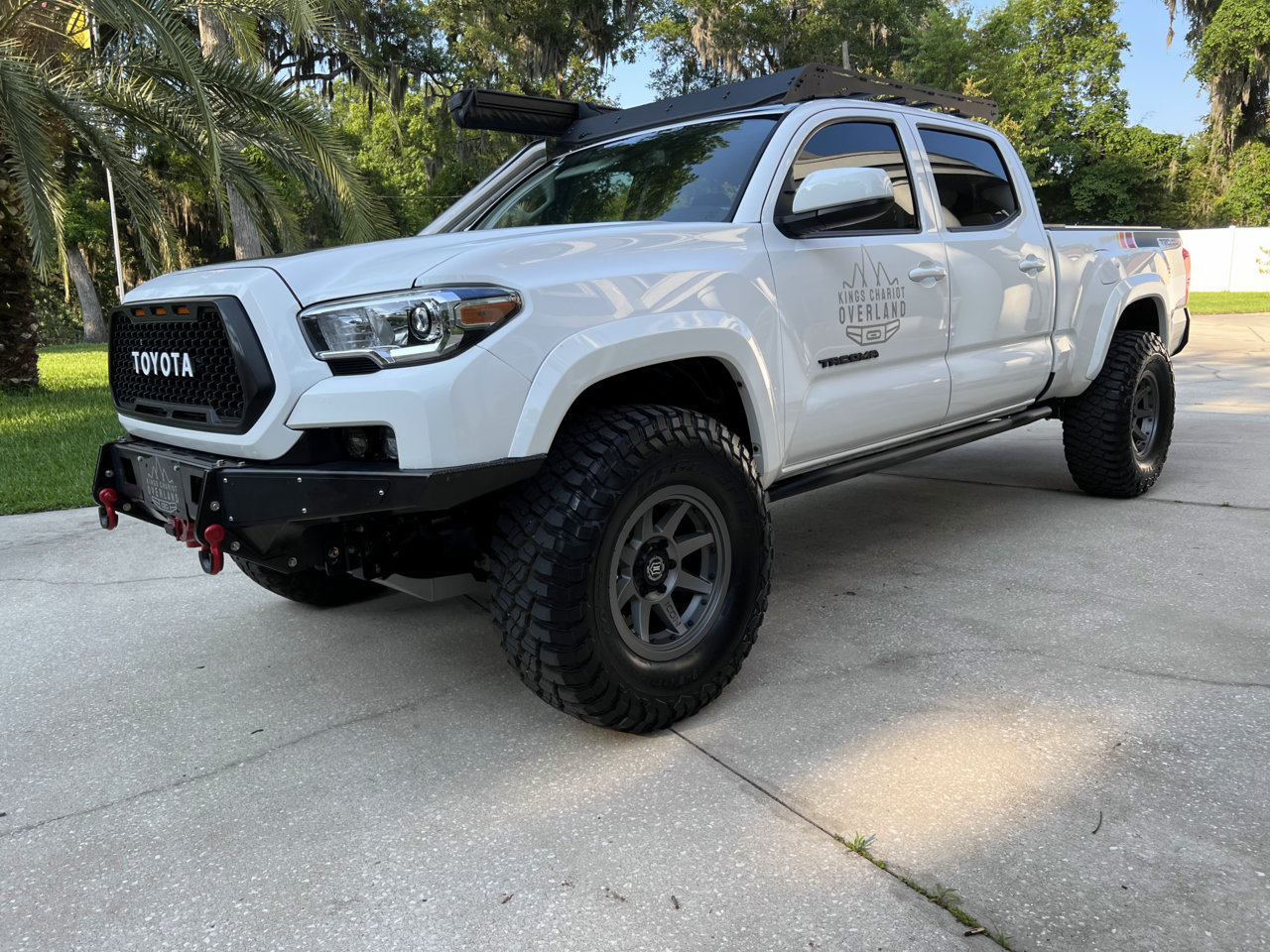

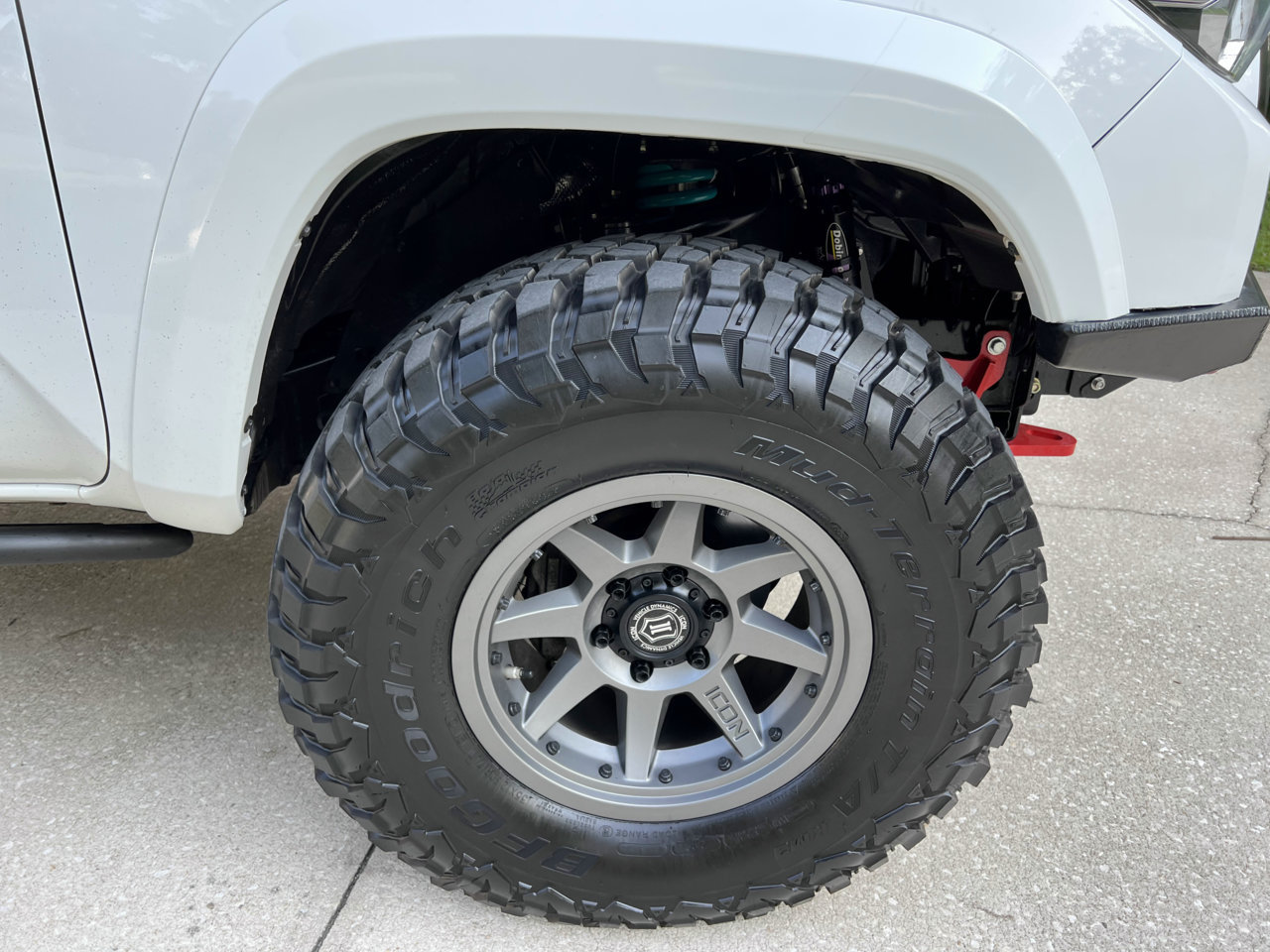

    With the mods before the Maggie on the truck the MPG dropped to 13. I went with the Maggie because i was hoping for some low end torque to get the truck in 5th and locked converter more on the highway and get the MPG back up. I was also hoping there was enough torque to haul my classic cars on a full car trailer in 5th gear. I have been riding around today and taking it easy and I can see my expectation might be realized. Ill know more in the next few days.

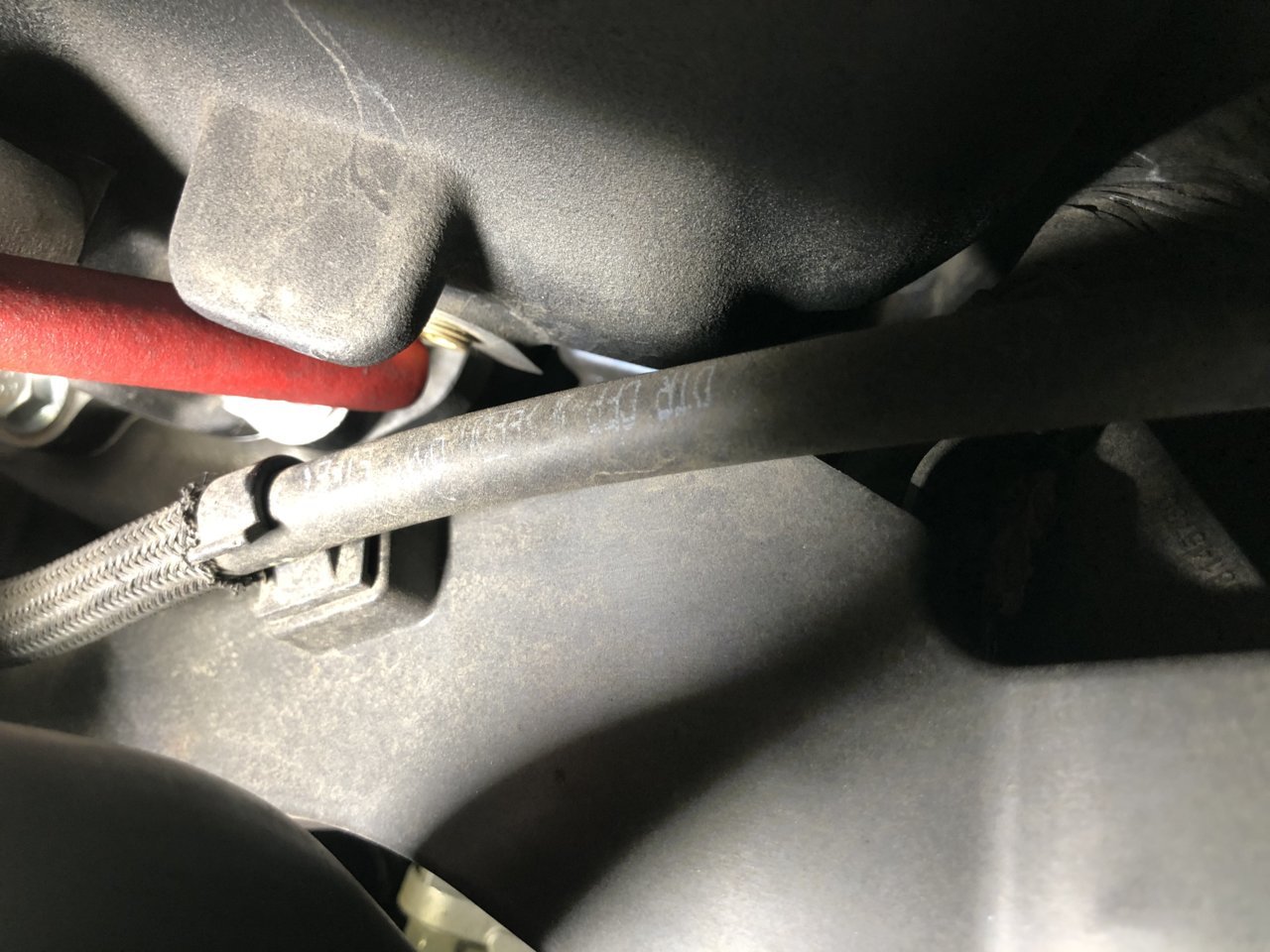

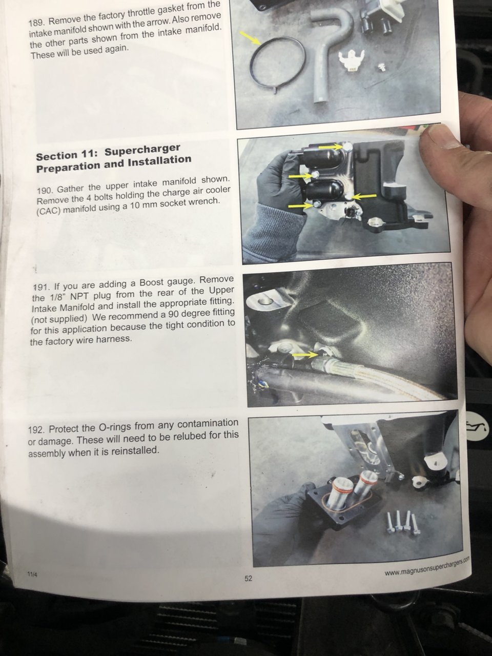

    Can anyone confirm if this is the boost gauge port mentioned in the manual? Installing a VLS boost gauge. Is it the brass fitting that my red pen is point to on the rear passenger side?
