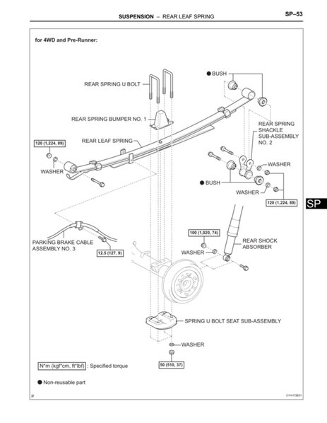

    what nuts are you talking about? I saw that the u-bolt nuts are 37 foot pounds each for the 2nd gen trucks. Can you show us a picture of which nuts you're talking about?

    ok, so that pictures is wrong than? it says 37 foot pounds very clearly. Where did you get your data of 74 foot pounds from?

    On this website, do a search for it. The 37 was a typo.

    oh okay, just wanted to make sure folks didn't put out misleading information out there.

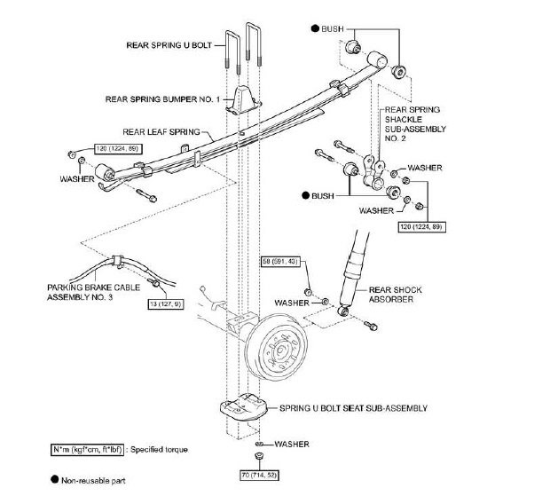

    well did a search and found a different picture but this one says 52 foot pounds.
