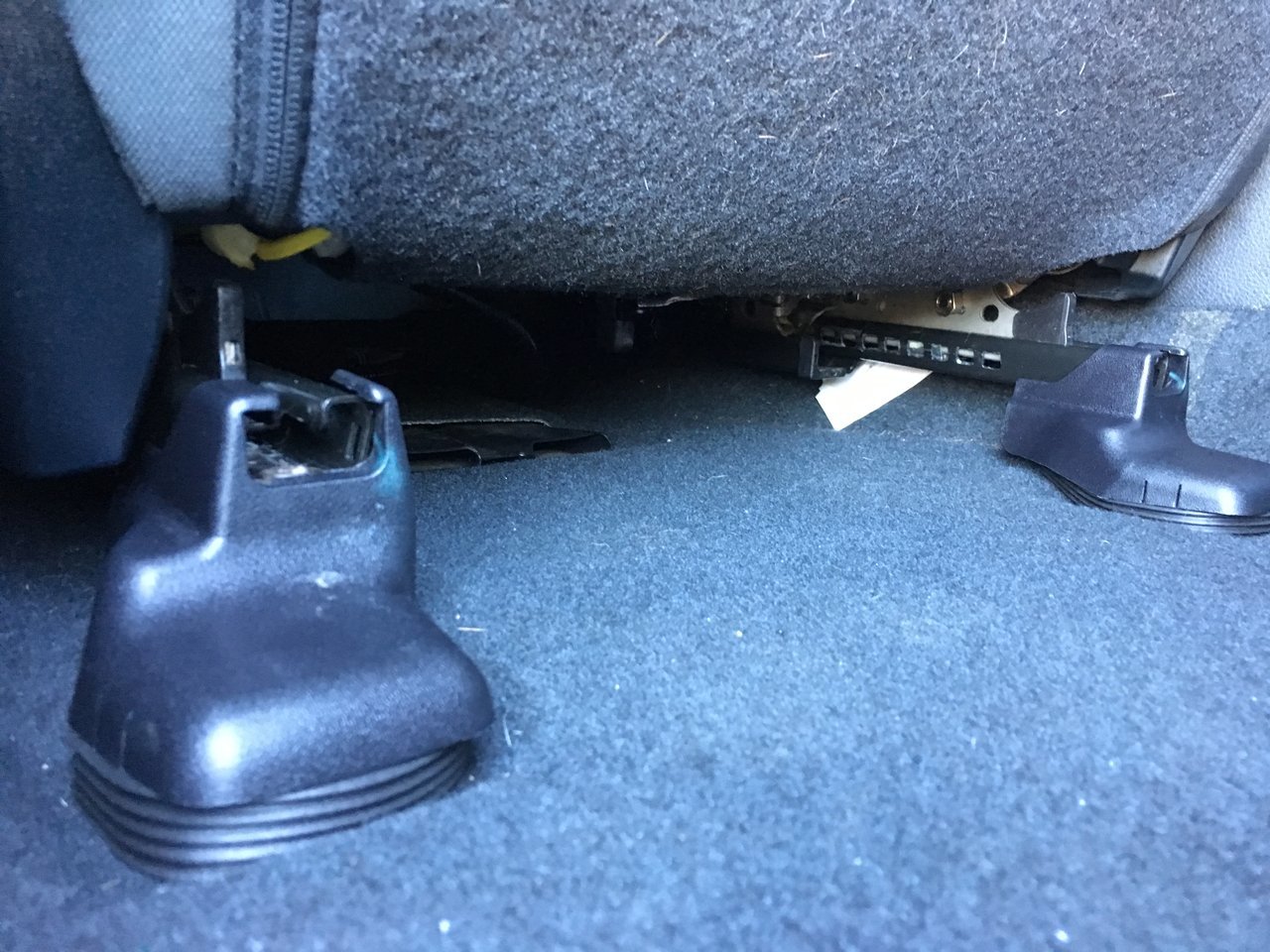

    I used 10.9 10x50 bolts and grade 8 lock washer. I made the spacers from .05" 1"x2" aluminum 6061 flat bar stock. I figure to take some criticism but don't mind hearing your thoughts.
    RobP62 likes this.

    Work in progress...
    I was trying to get this photo in there also. It isn't the height the seat but the angle that I like better.

    After testing a couple height options (rear only) using stacked large nuts and washers I settled in on 32 mm added height, made spacers on 1-1/4" aluminum round stock and used longer higher strength bolts. This got my butt out of the sunken pit Toyota seemed to want it in--did the wife's side too, she likes it.
    Like so:

    Not to shit on your mod, (and I'm no engineer), but I would think the lateral force on that bolt in an accident with it being raised the way it is would multiply exponentially over one being bolted directly to the floor.

    This has been brought up before; I am an engineer (MSME MIT '71) and can assure you the stresses and strains are well under control with this mod. The specifics are discussed in this post...
