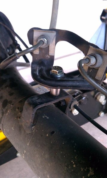

    R you still running it like this? I am doing the same thing w/ my new Dakars, but am debating new lines. I hear its a pain in the ass.

    Yep haven't changed it but not sure if it'd be good to go if I got longer shocks, at least with the dakars.
    New lines aren't that big of a pain if you can bleed your brakes yourself. Might have to do a little dremel work to the mount but other than that fairly simple to unscrew the lines and add in the new ones and then bleed.
    Another trick is to bend the mounting plate forward so your lines go more straight up rather than the come out and then up thing they do now. Don't over-do it though.

    UNLESS Toyota overtorques the flare nuts at factory such that they exceed the ID of line threads, in which case you're close to completely fucked and are probably going to have to have your brake lines replaced. Ask me how I know. Or HBmurphy.
