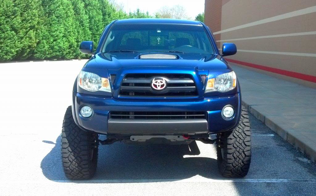

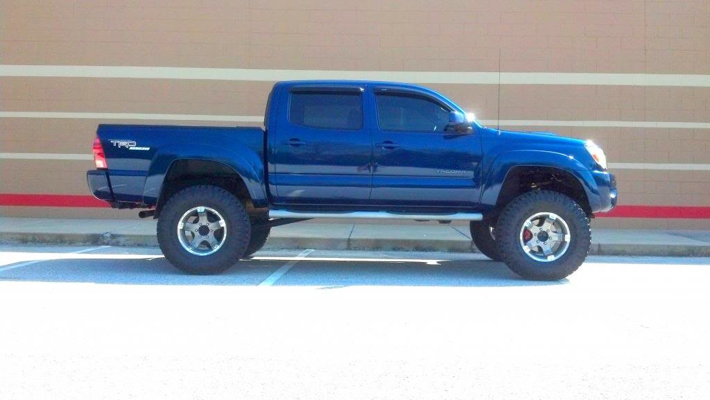

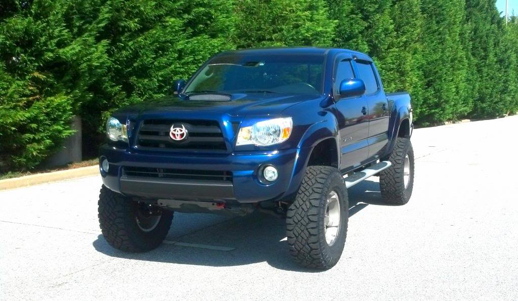

    Finished my spindle lift last week and so far I'm really happy with it. Looking forward to new wheels and tires in the future.

    that is a very clean truck man, looks freakin awesome!

    Any trimming? Amazing job exactly what I'm looking for
