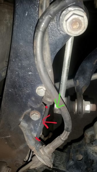

    If possible spray all the bolts tonight with PB blaster or something like that that way it has all night to soak in.
    I would take the spindle out first, you're gonna need that little bit more movement from th LCA to get the strut out. Not to mention the spindle kinda gets in the way, it's a lot easier with it wide open.
    Oh & make sure you have some wire or small bungee cords to hang your calipers out of the way. I'd also suggest something to cut the brake line brackets that bolt to the spindles, they hit the swaybar end links if you don't cut them.
    Red is where I cut, from dot to dot & green is where it rubbed before I cut it.
    I'll try to remember all the tools.
    sockets & wrenches-
    10mm, 17mm, 19mm & 15/16 for the new Maxtrac bolts
    10mm flare nut wrench for the brake lines
    Torque wrench
    I may be forgetting something but I think that's it.
    Here's all the torque specs, ft lbs is the # in the right. If you're doing the rear the pic shows 37 ft lbs for the U bolts but it's really 73 ft lbs.
    https://www.tacomaworld.com/threads/the-torque-spec-guide.318116/
