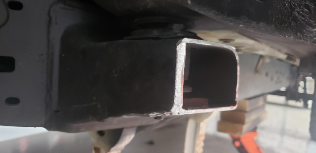

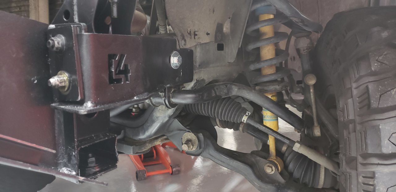

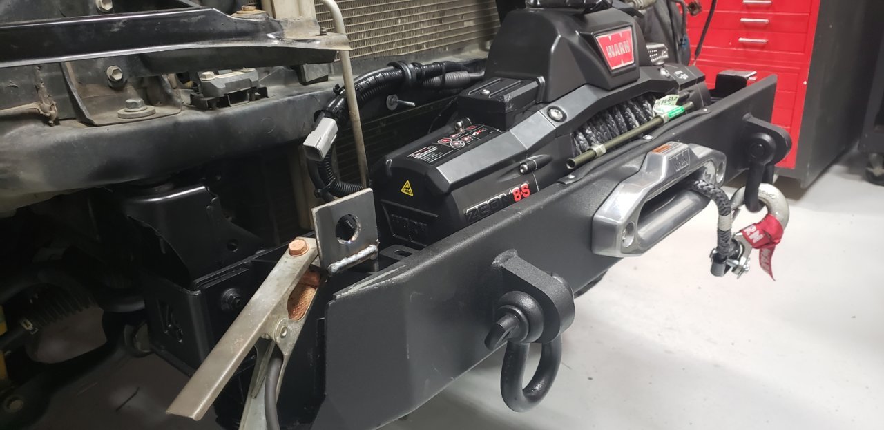

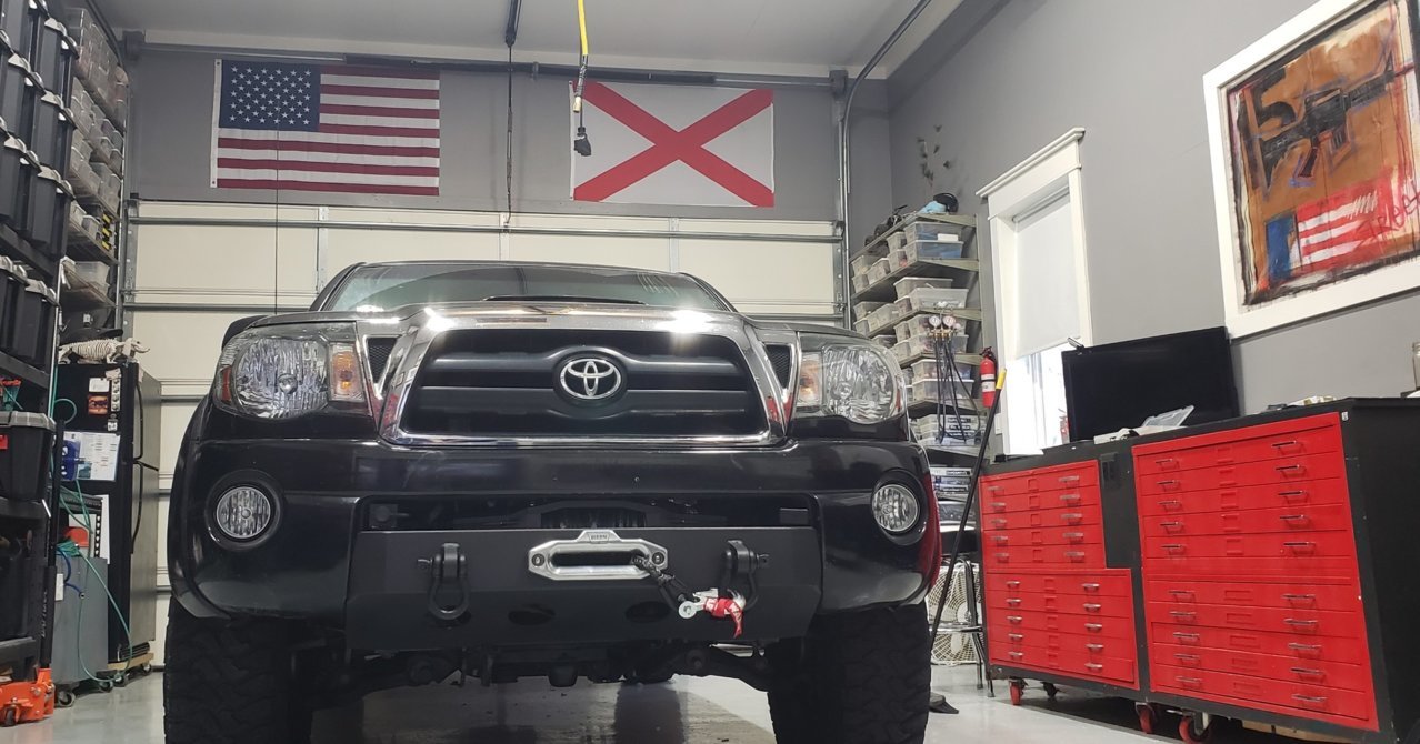

    US Off-road Low Profile (≈75 lbs.) P/N: TACO-05
    C4 Fabrication Bumper To Frame Brackets

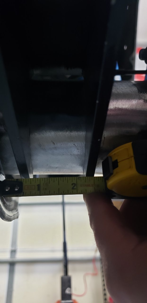

    This was one of my first project. Unpacking, painting, installing.

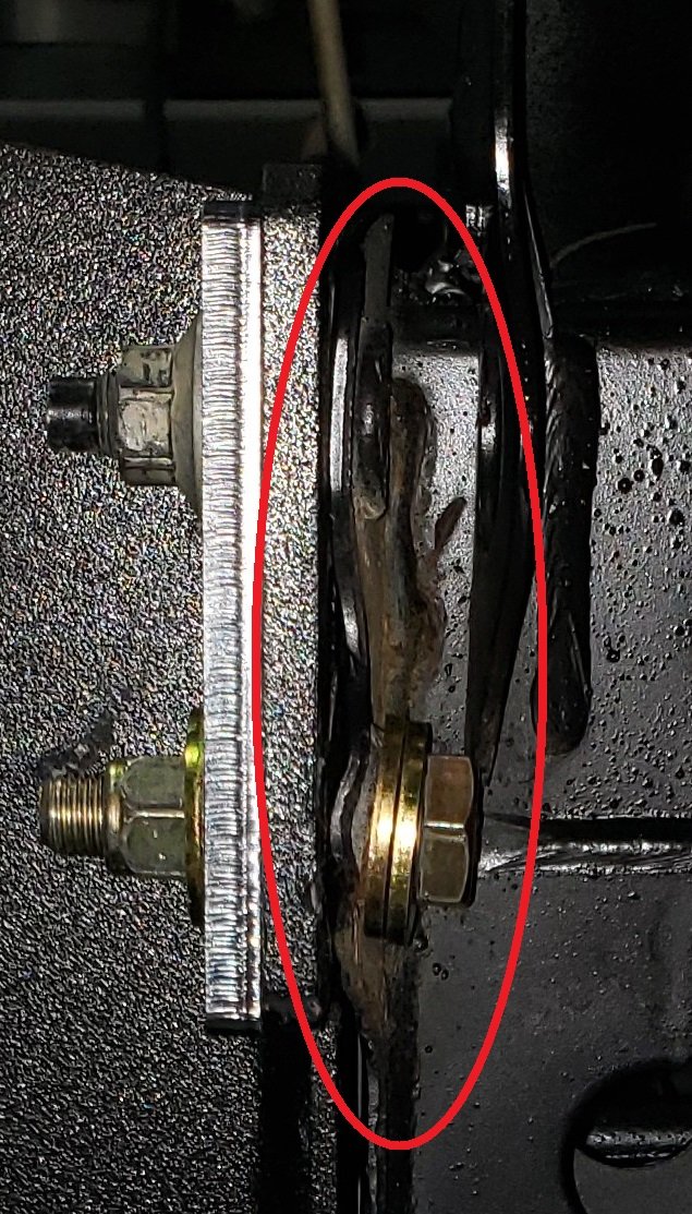

    One of the main items that concerned me was the bumper to frame connection. Notice the only thing holding the bumper to the frame is a small 3/16 piece of metal. I could imagine my entire bumper being ripped off during my first time using the winch. I decided on installing some bumper to frame tiebacks. However, this did become an issue with my King remote reservoir bracket.

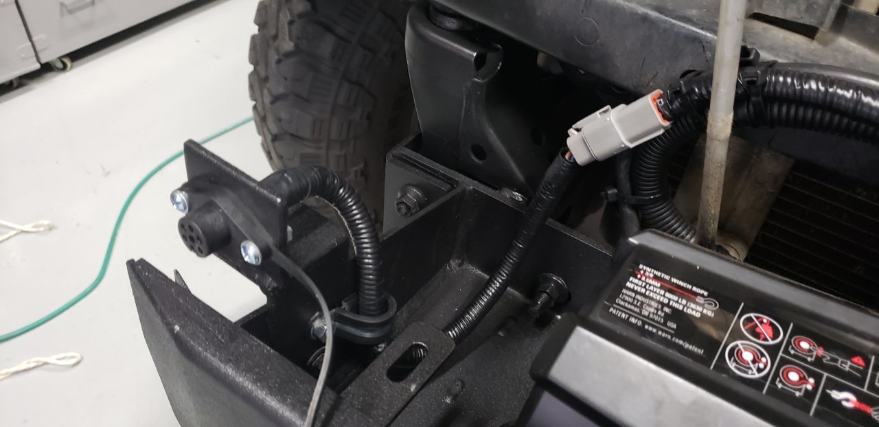

    Welding brackets for my winch remote connection, jumper cable quick connect, and wish I would have welded one for my air compressor coupling. I also insulated the hole the winch battery leads goes through and installed a battery disconnect to prevent having power on the cables unless needed. I would hate to have a short to ground with these leads

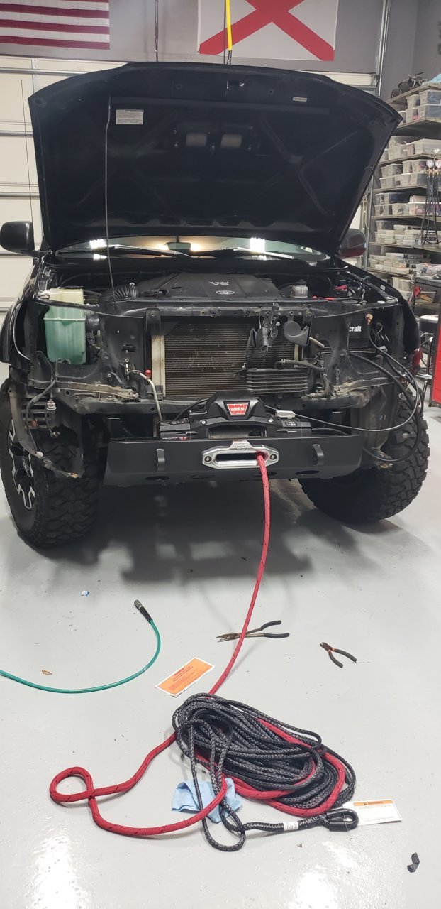

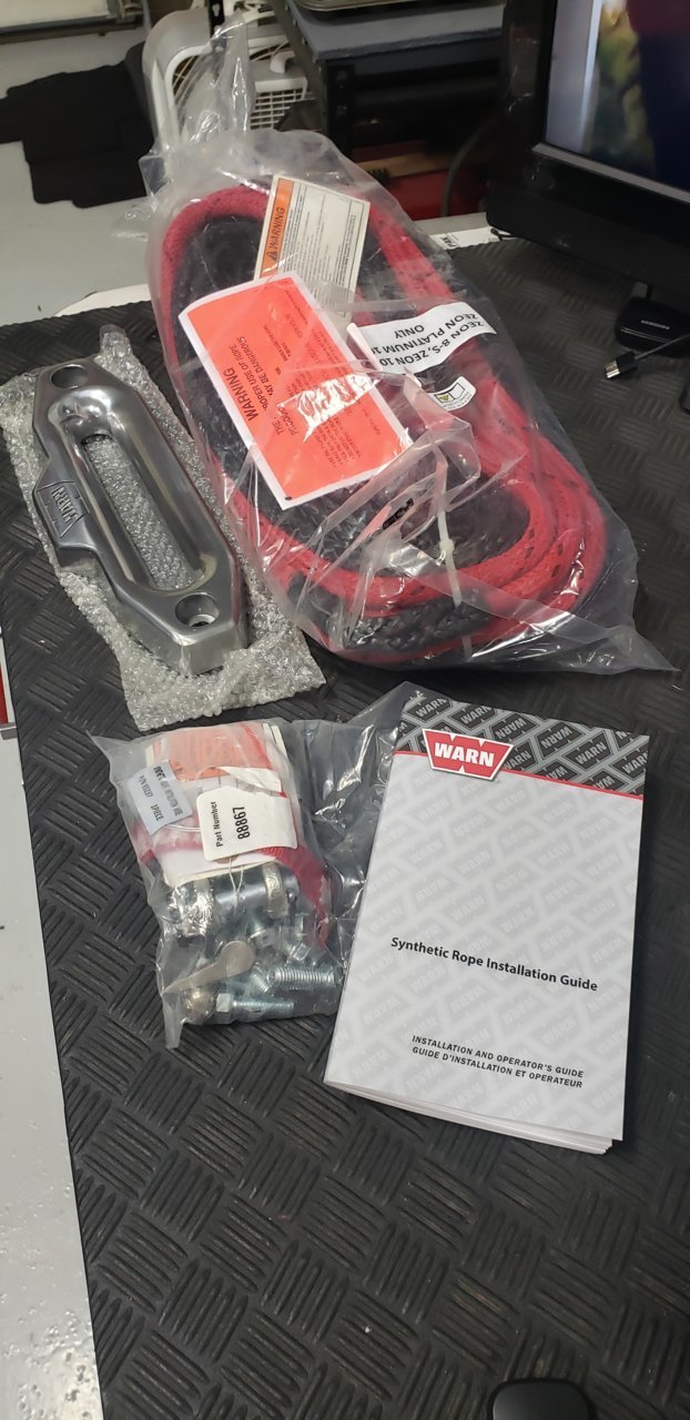

    Warn Zeon 8-S 8,000 lb. winch with synthetic rope (≈100lbs) P/N: 89305
    Remote Control Socket Assembly P/N: 100154

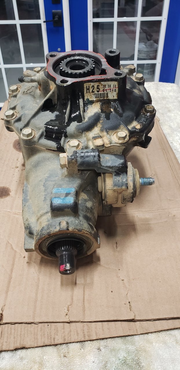

    Contents of 8-S winch

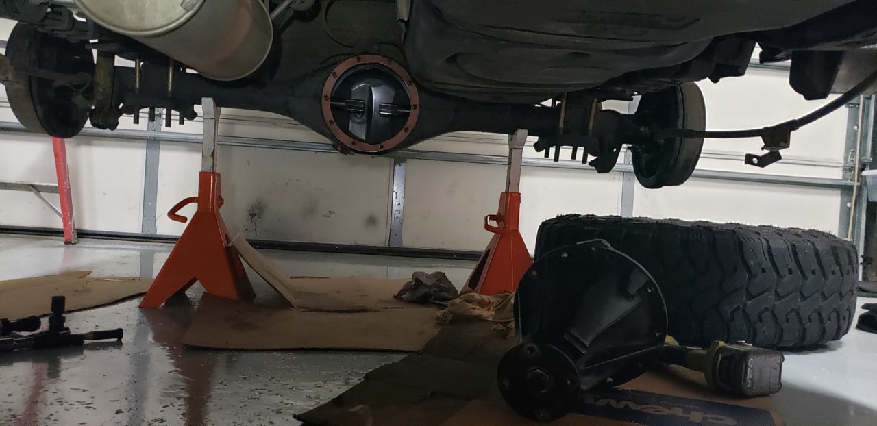

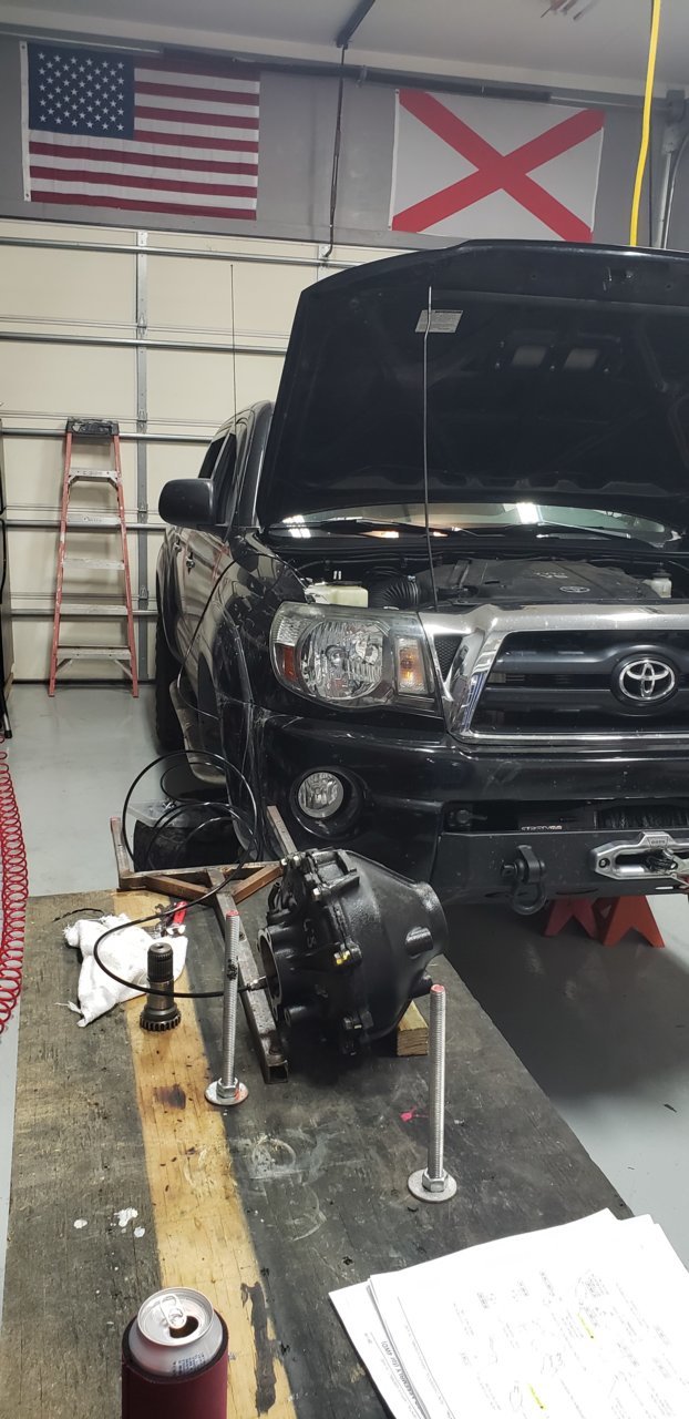

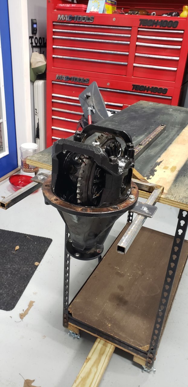

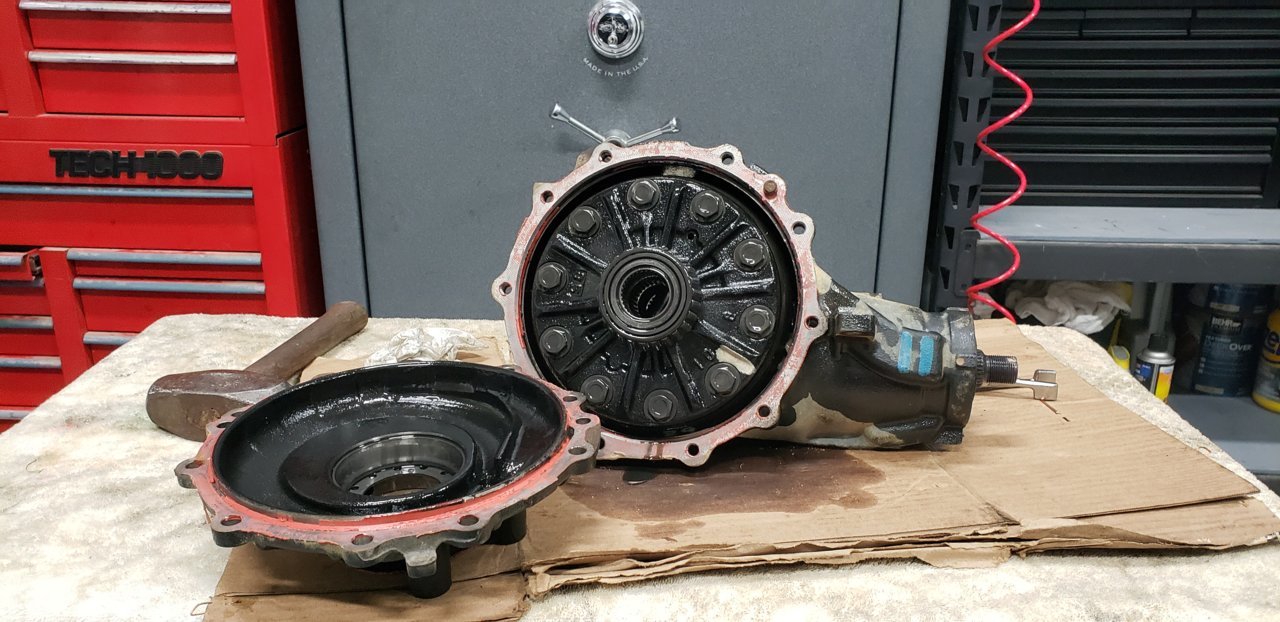

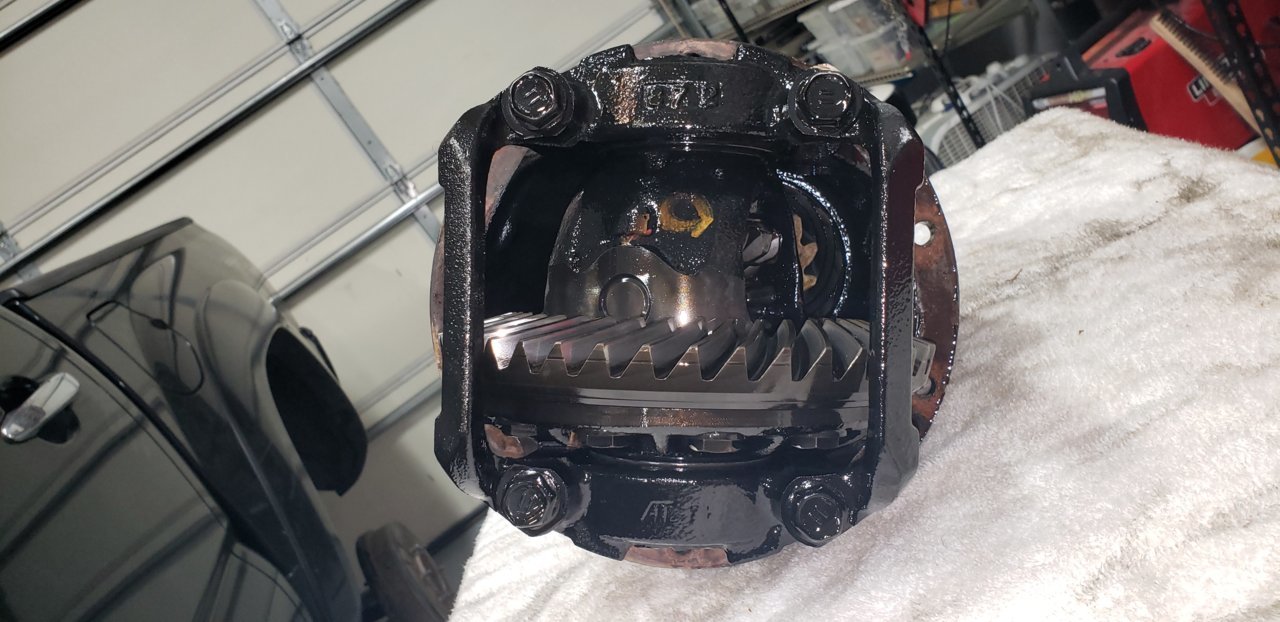

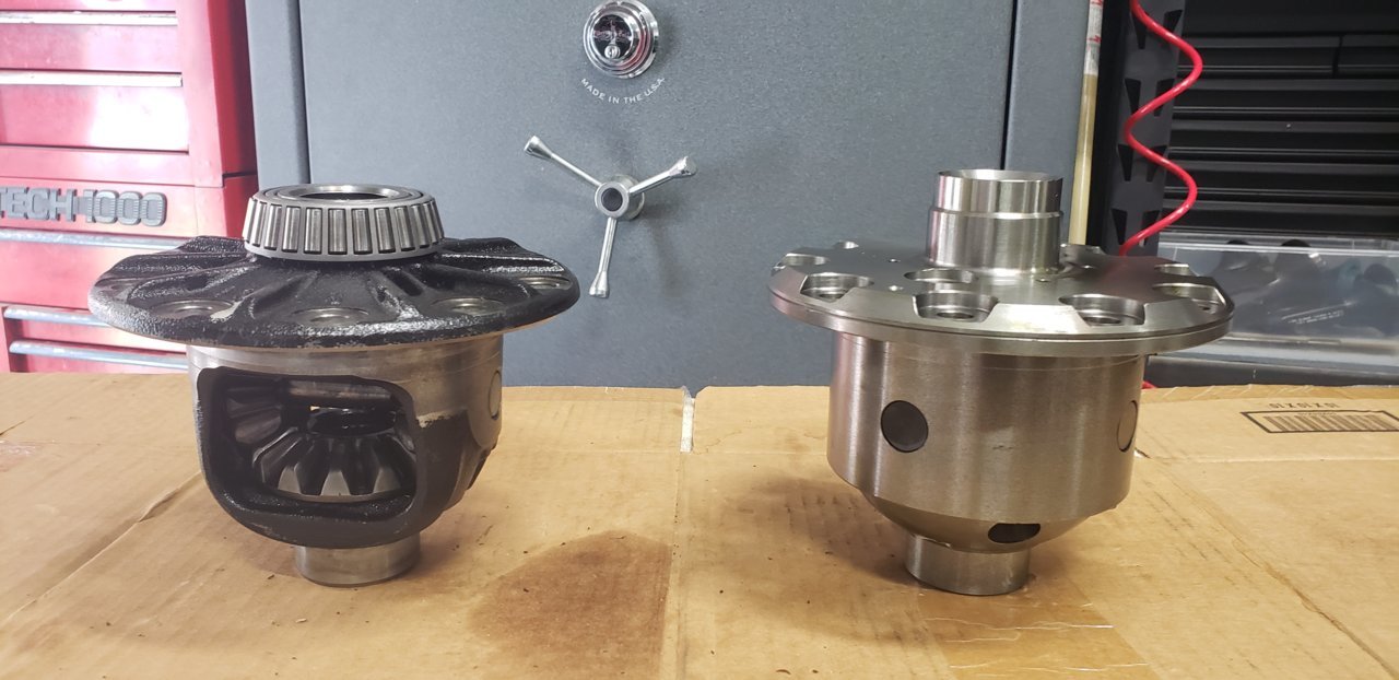

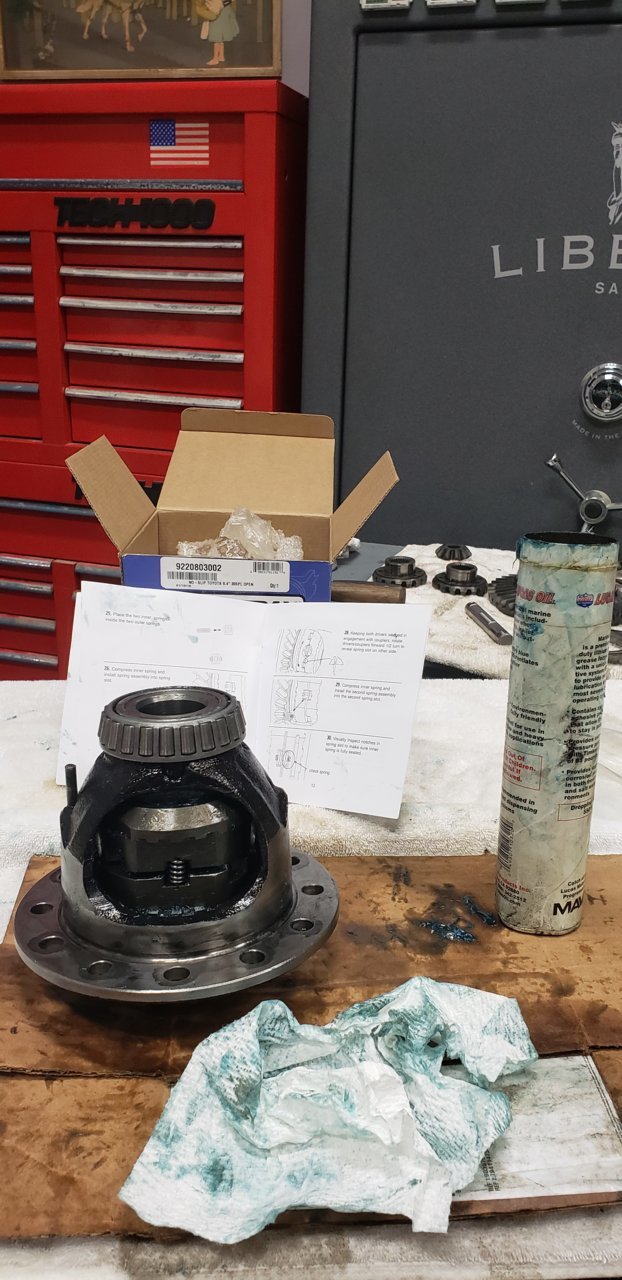

    4.56 Nitro with ECGS solid sleeve YK T100 14113
    PowerTrax No-Slip 9220803002
    This is one of the easiest lockers I have ever installed.
    Getting a little help.

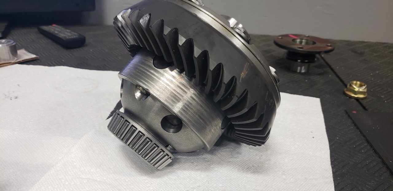

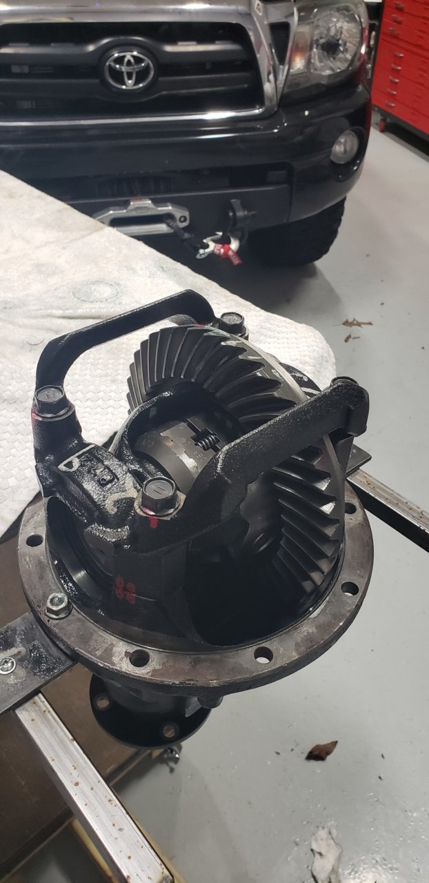

    4.56 Nitro with ECGS solid sleeve T8S-456RT-NG
    ARB Air Locker RD121

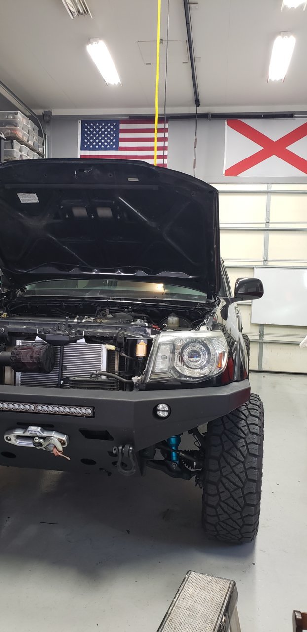

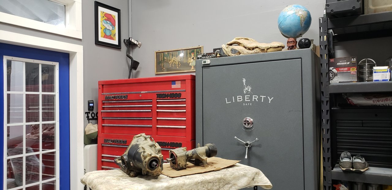

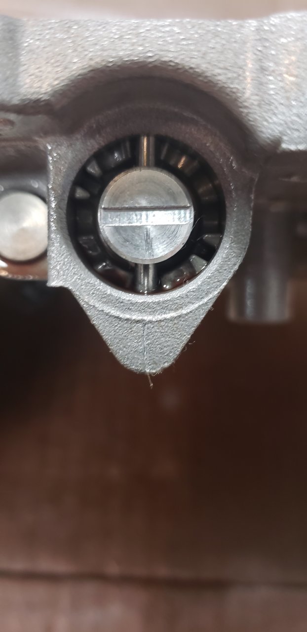

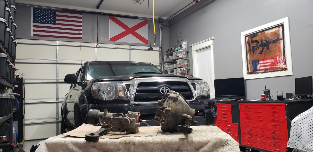

    The front clamshell was fun to remove and install. You need to be a PT monster or have two people to remove and install. The ARB requires drilling a hole in the clamshell. Yeah, that was kind of spooky. Measure, mark, measure, mark, measure, mark, beer, drill. Requires tap to thread hole, Tap 1/4"-18Npt tap, URL: https://www.amazon.com/Hanson-1903ZR-18Npt-Taper-Extraction/dp/B00B7421BEyou
    Also, you will need a special tool check the backlash.
    How to URL: https://www.tacomaworld.com/threads/regearing-my-ifs-clamshell-got-some-questions.213737/
    Purchase URL: https://www.dialindicator.com/indicator-accessories/angle-and-hole-attachments

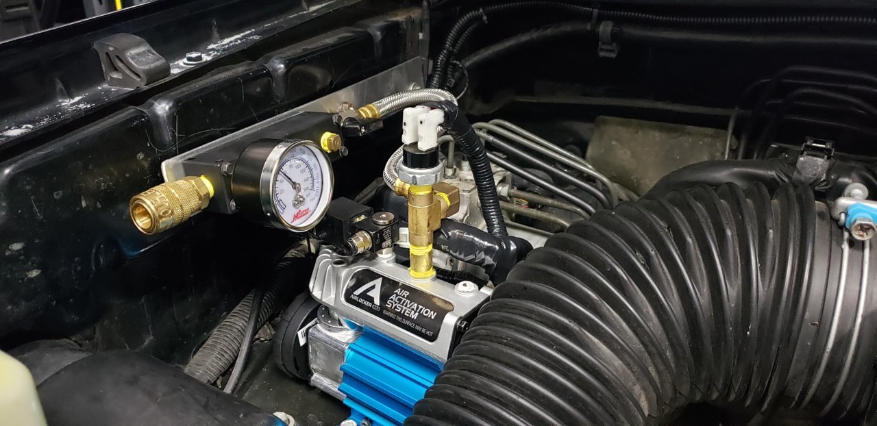

    New ARB Carrier. Looks really good.
    Drilling and tapping for air fittings
    Air compressor and manifold installed
    Bench testing the air locker before installation. Don’t want to do this twice.

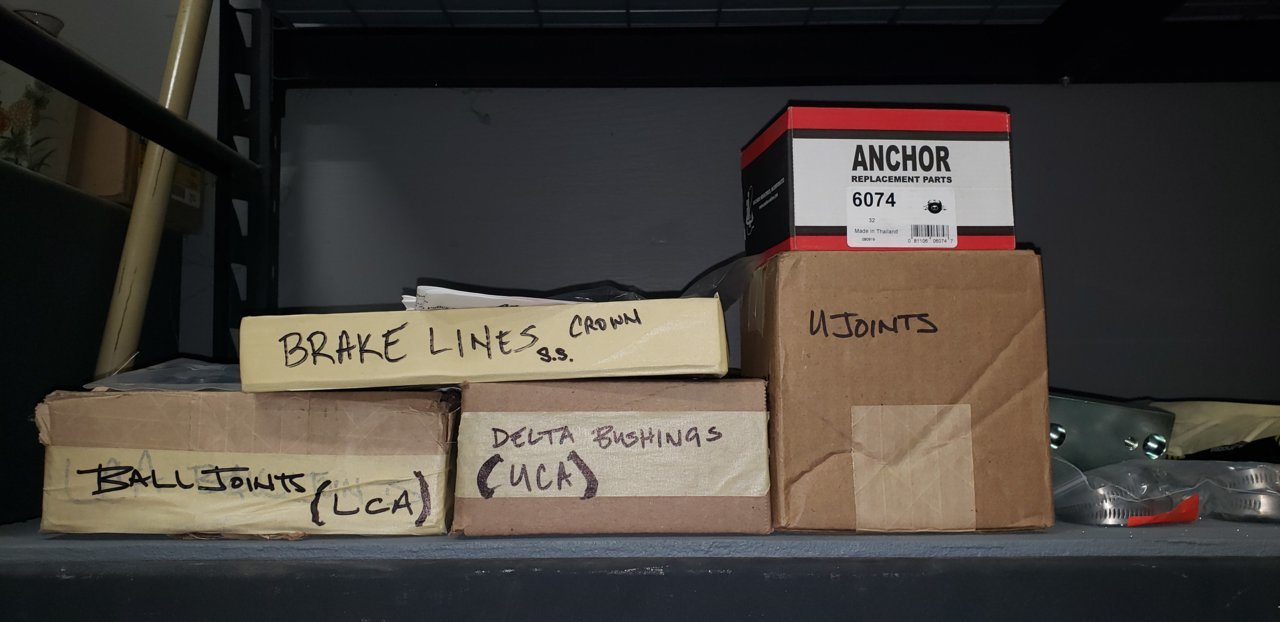

    Front Suspension
    King 2.5 Extended Travel Front Coil overs with Compression Adjusters P/N: 25001-119A
    Delta Joint Tubular Upper Control Arm Kit P/N: 58450DJ
    MOOG Ball Joint P/N: K808274
    Whiteline Front Control Arm Bushing P/N: W53312
    Crown Performance Brake Line Kits P/N: TOYO33FR03
    Gear Tech Customs PROTEC 2nd Gen Tacoma Splash Guards (05-15) P/N: 2GSG

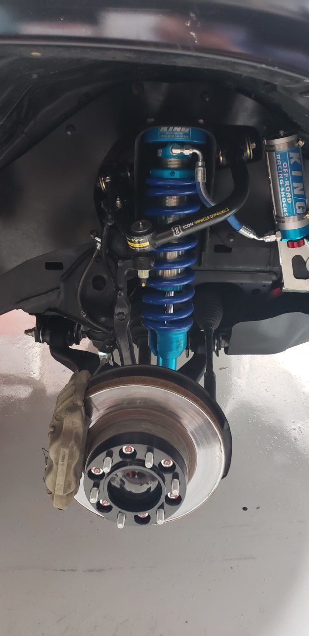

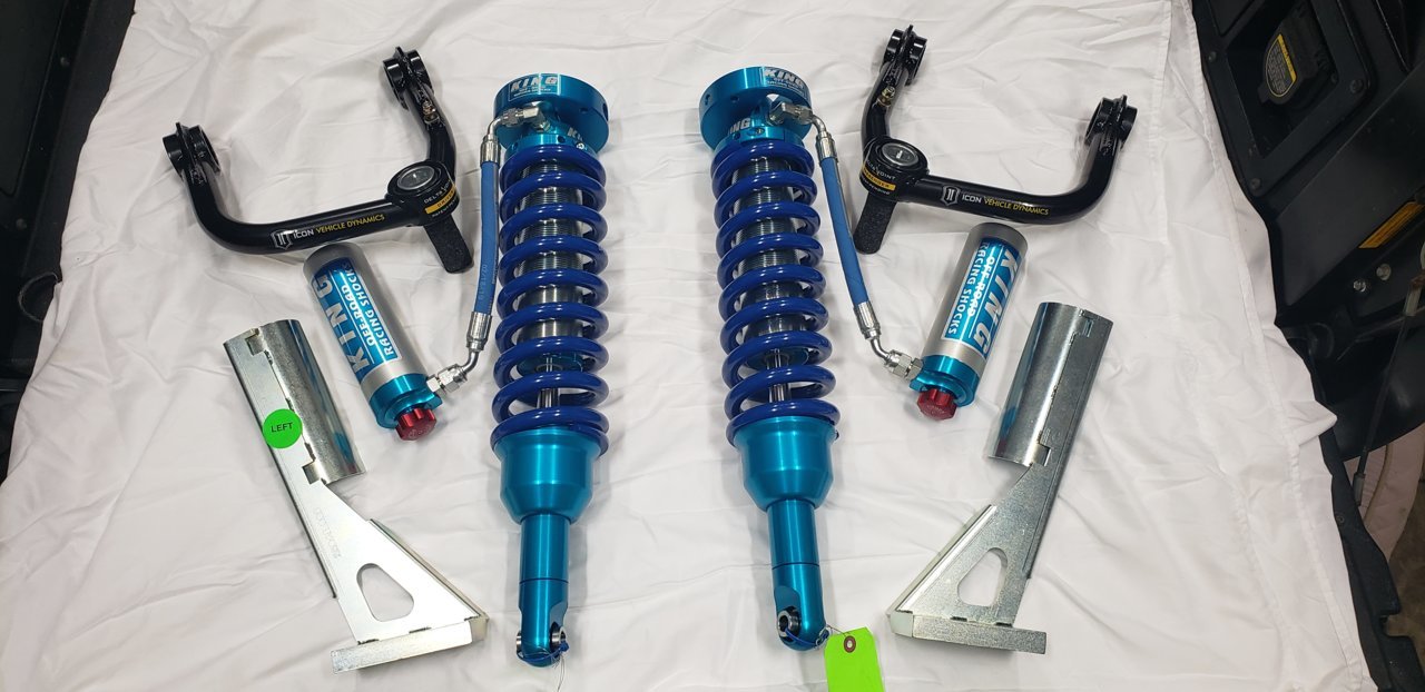

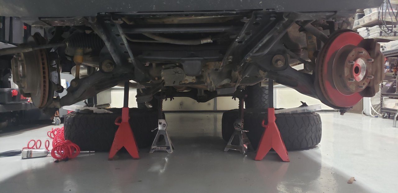

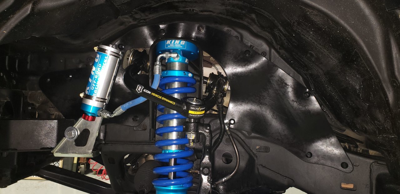

    Finally, my front suspension has arrived. You need to have patience when ordering Kings. It took about 6 to 8 weeks to arrive.
    Bushings and brake lines also
    Suspension installed and Gear Tech customs splash guards

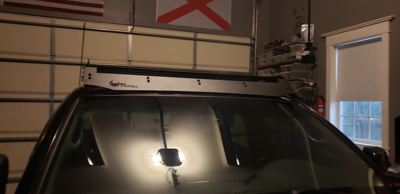

    Roof Rack
    Prinsu Design Systems Cab Rack

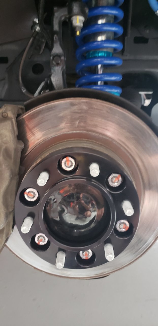

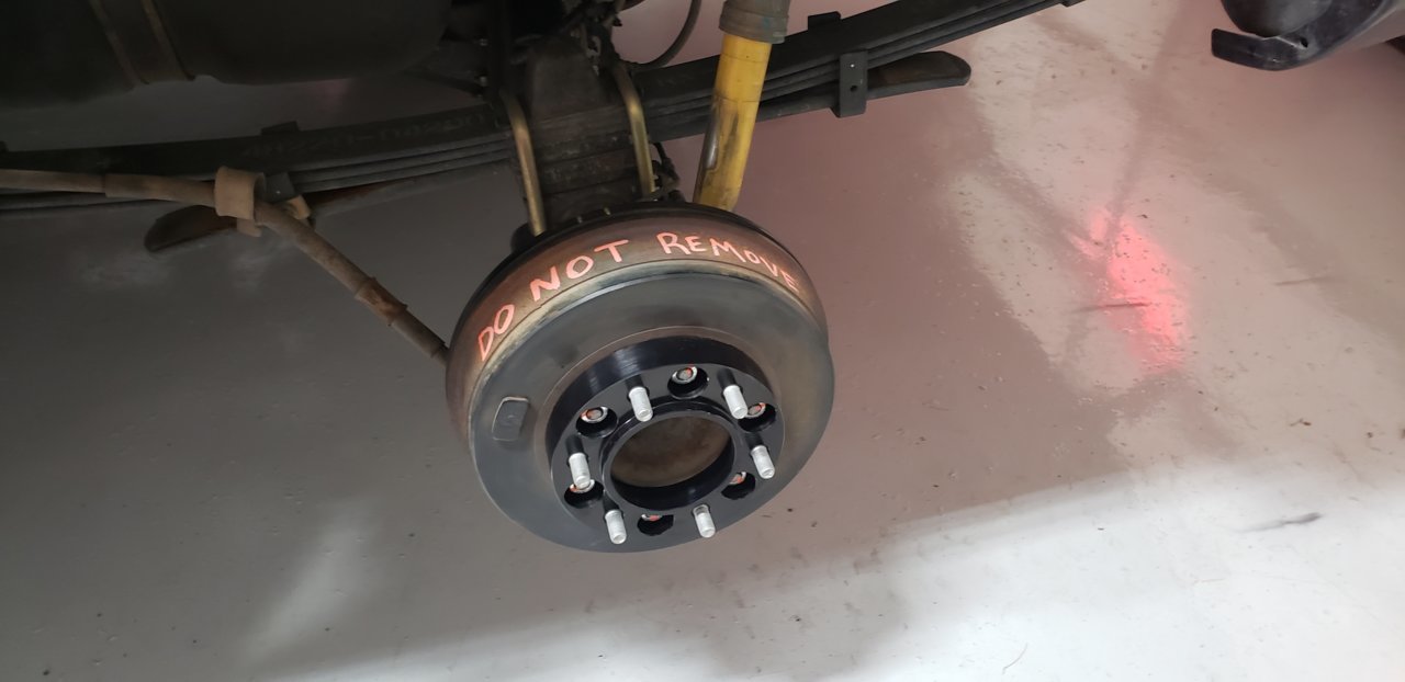

    Wheel Spacers
    Spidertrax Toyota 6 on 5-1/2" x 1-1/4" Thick Black Wheel Spacer Kit

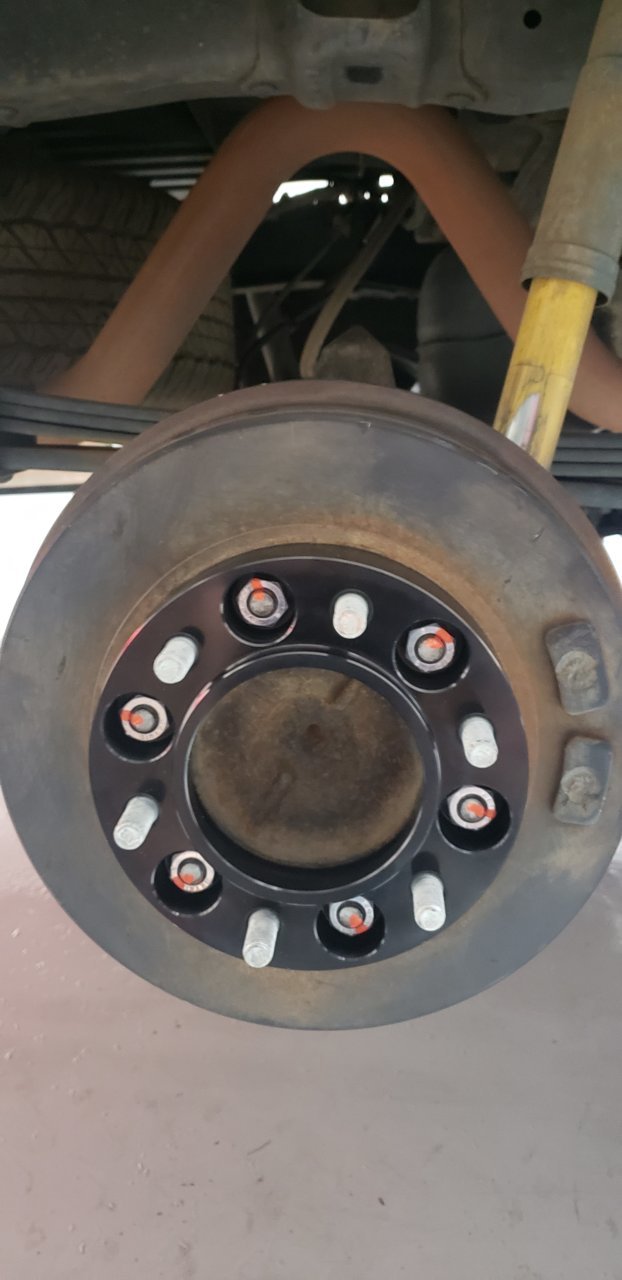

    So I have been waiting on SCS to release the Ray10 brushed gold wheel again. I broke down and purchased some wheel spacers to give it a similar stance. Once I wear my 285/75/16 out I am going to have to purchase wheels and tires. I am trying to hold out. Anyway I installed 1.25” Spidertrax spacers in black.
    I got tired of alignment shops removing my rear drums and me having to adjust the rear brakes again. Guess this was a hint to not remove them.
    I used blue loctite on spacer lugs, torqued them, and marked them for ease of mind when removing the wheels.

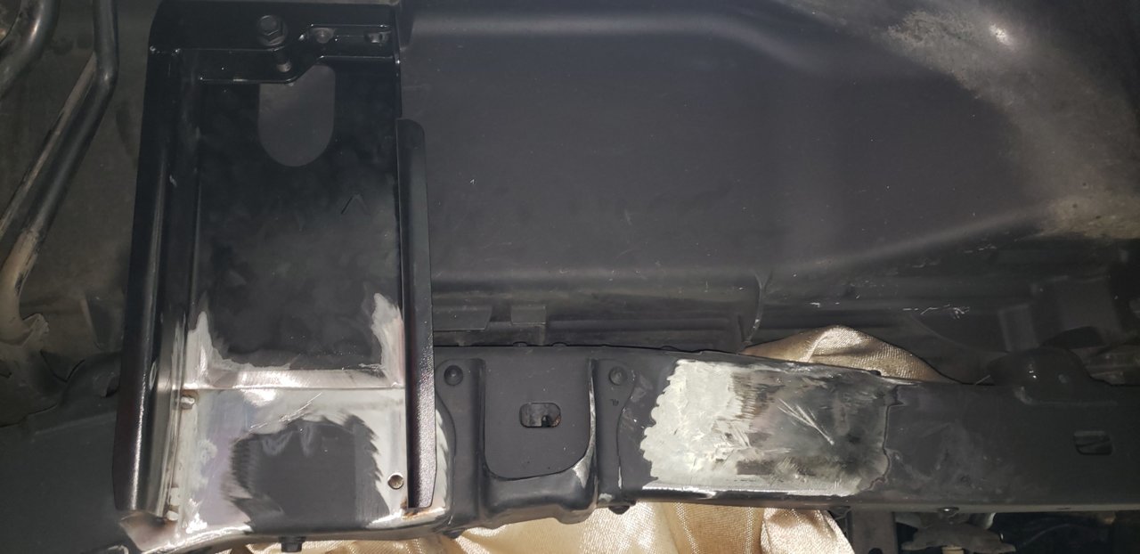

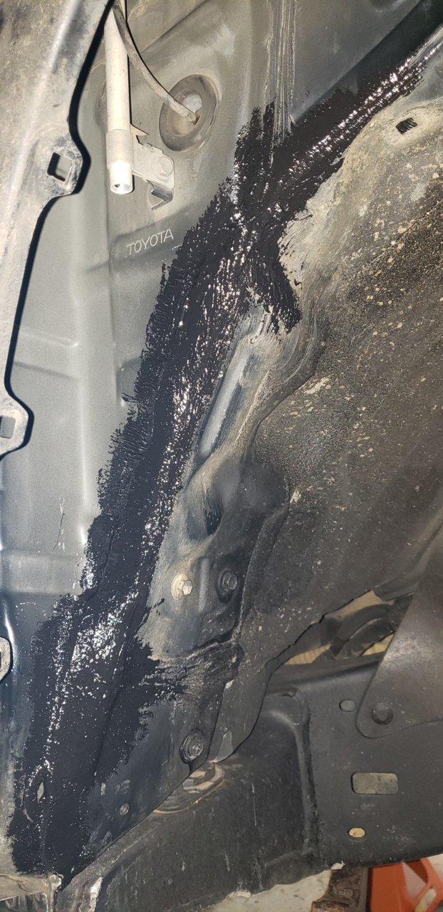

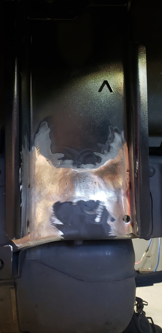

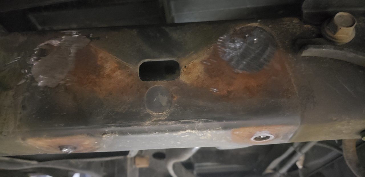

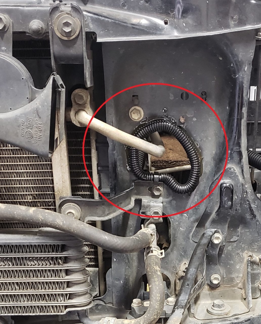

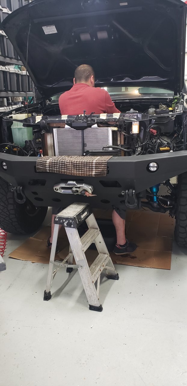

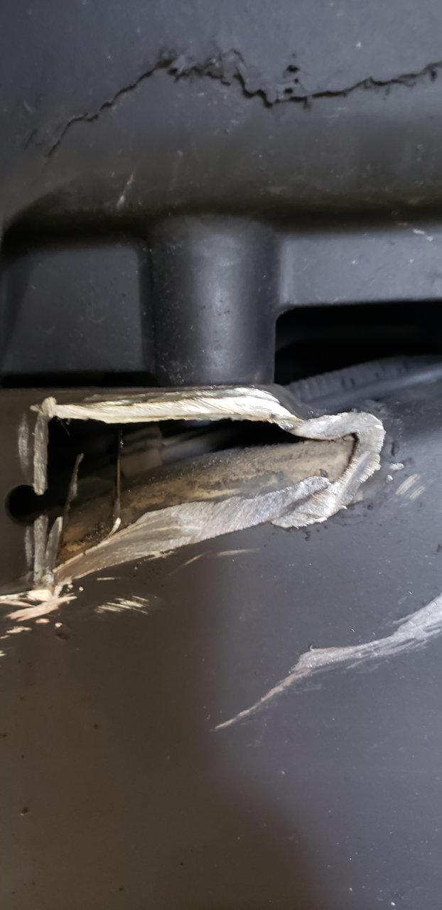

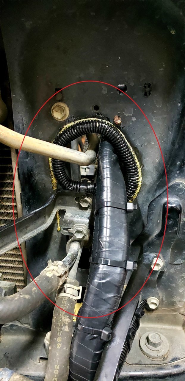

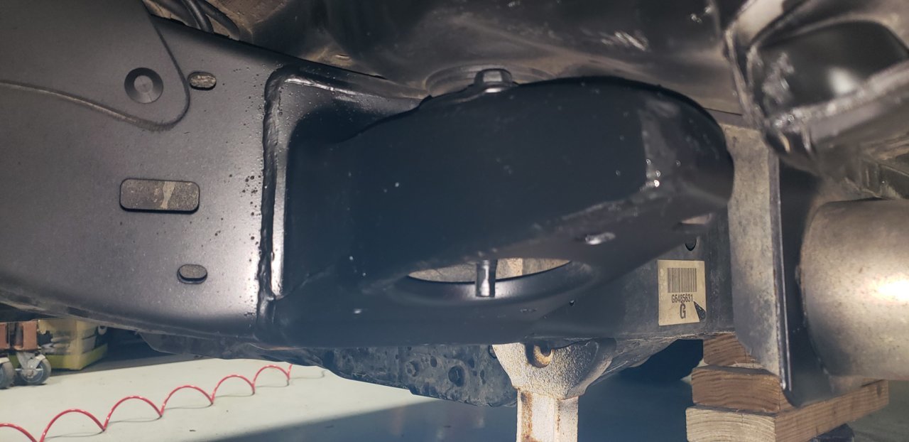

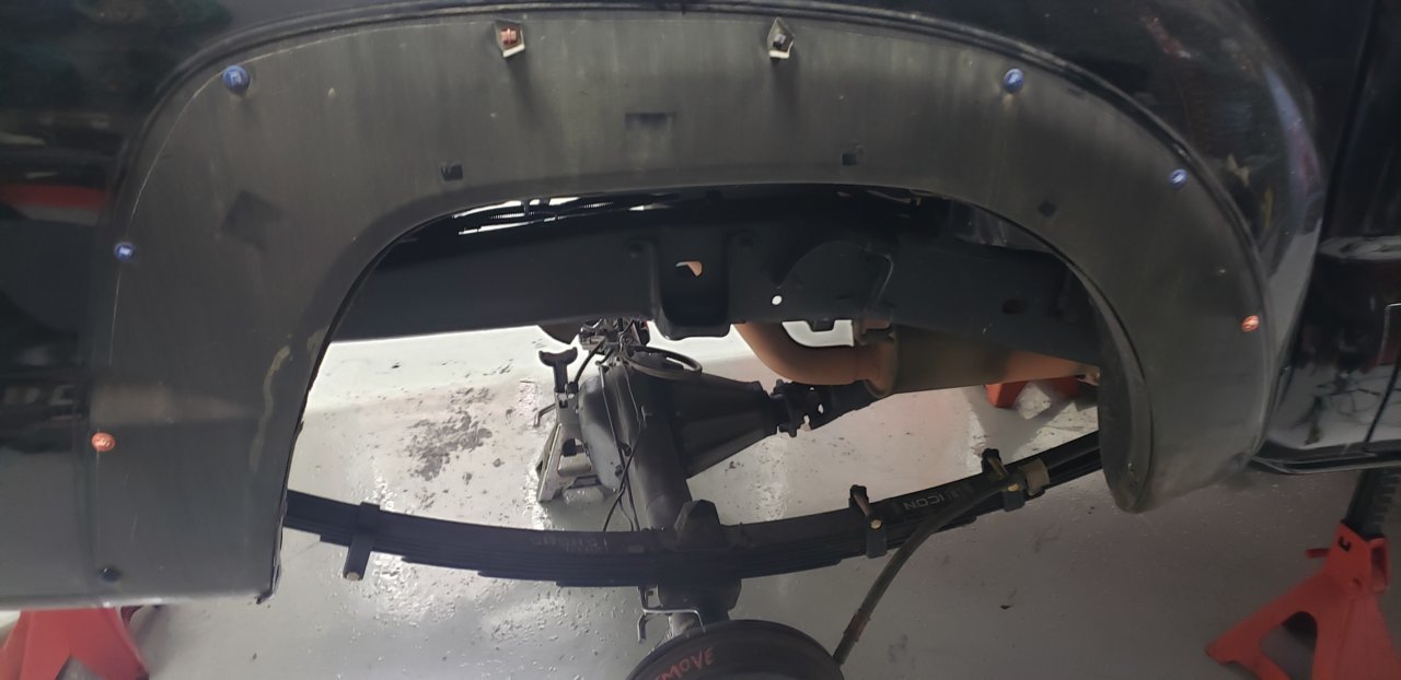

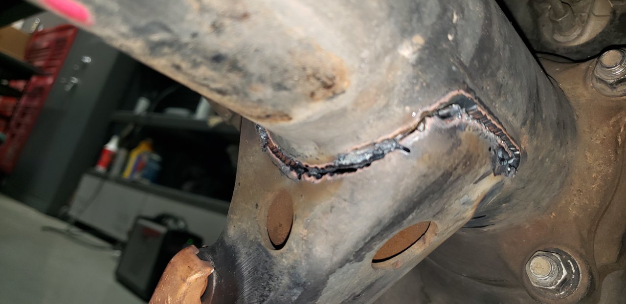

    Cab Mount Chop (CMC) and Pinchweld BMF Mod
    In preparation for bigger and better things, I went ahead and started beating and cutting. I also trimmed the fender near the CM a little. Not going to do the entire fender until I have evidence of my future 35” tires hammering the fenders. I imagine it’s a sure thing, but I want to be conservative about trimming.
    If you do this, make sure to use seam sealer.
    I never get to use my Hypertherm plasma cutter.
    I use my welder much more, but wanting to show it off anyway.
    More chop, chop
    I probably should have purchased the kit that totally relocates the mount. Anyway, it turned out looking ok.
    I am very lucky to have good help!

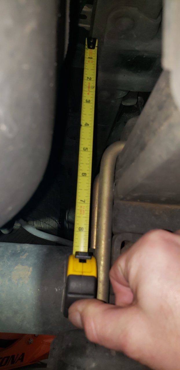

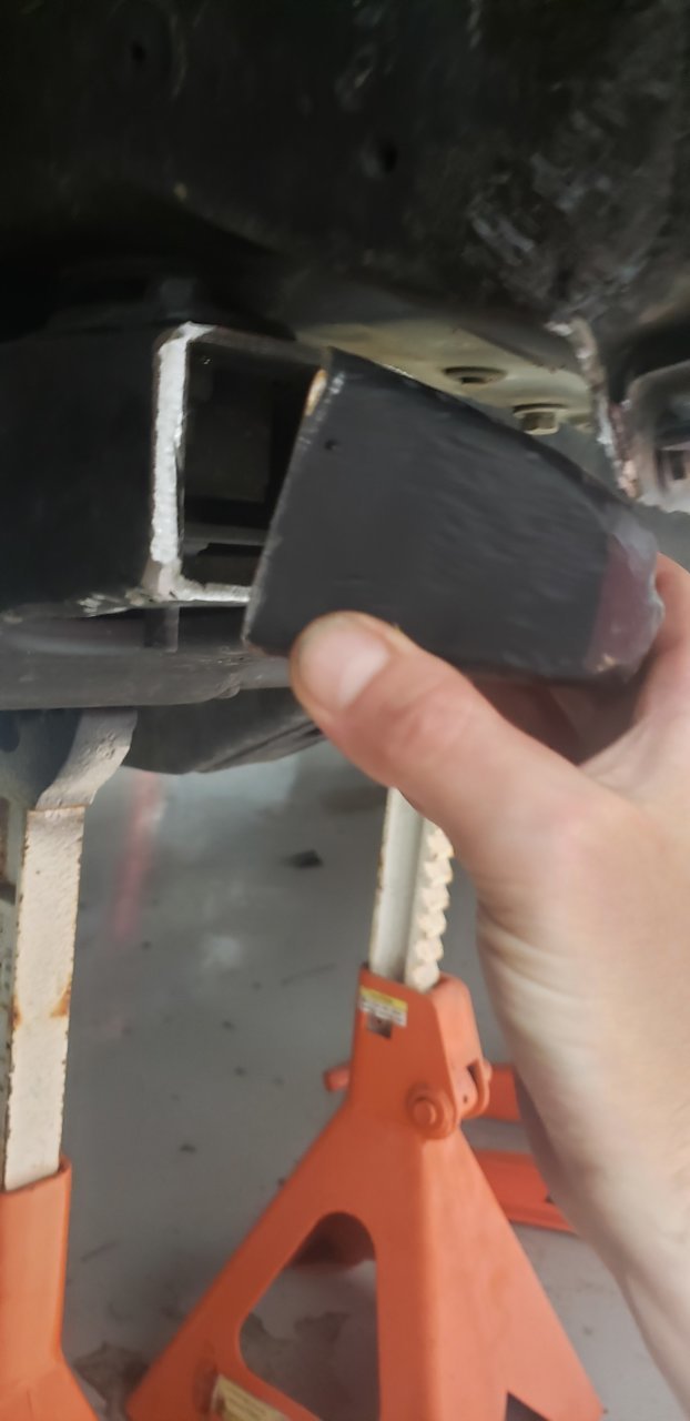

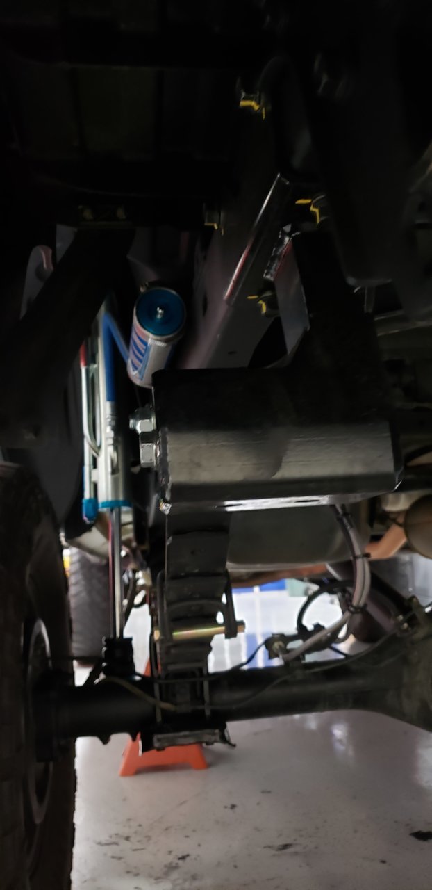

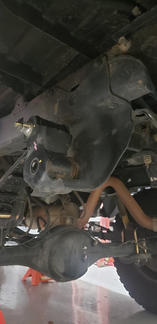

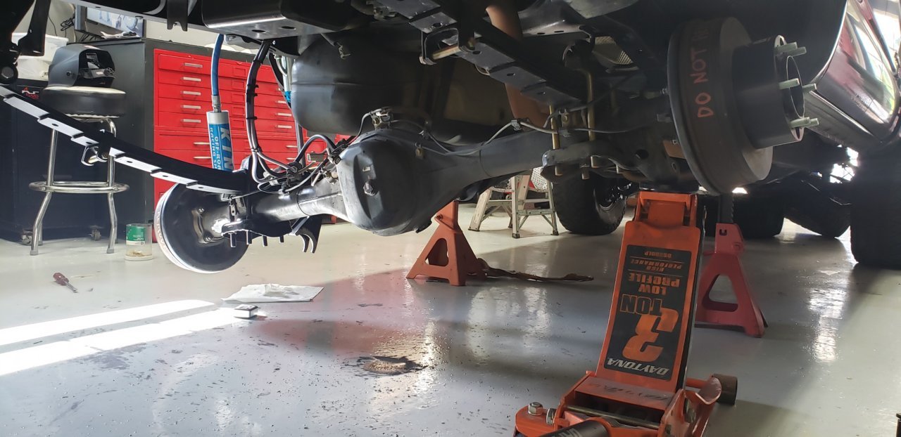

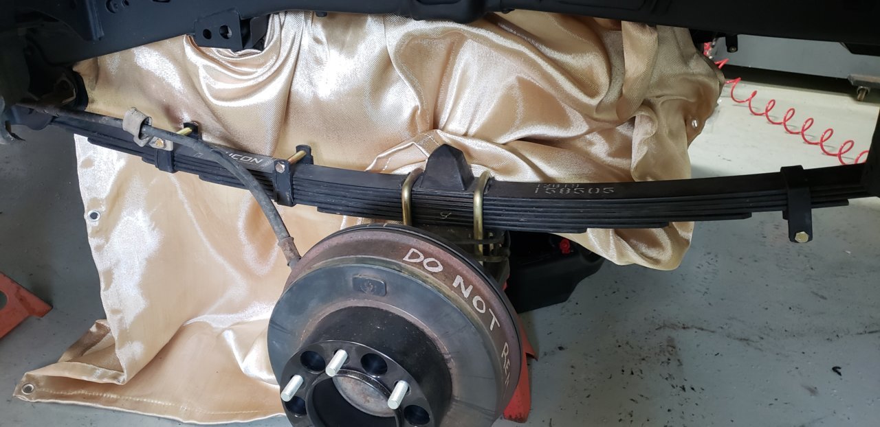

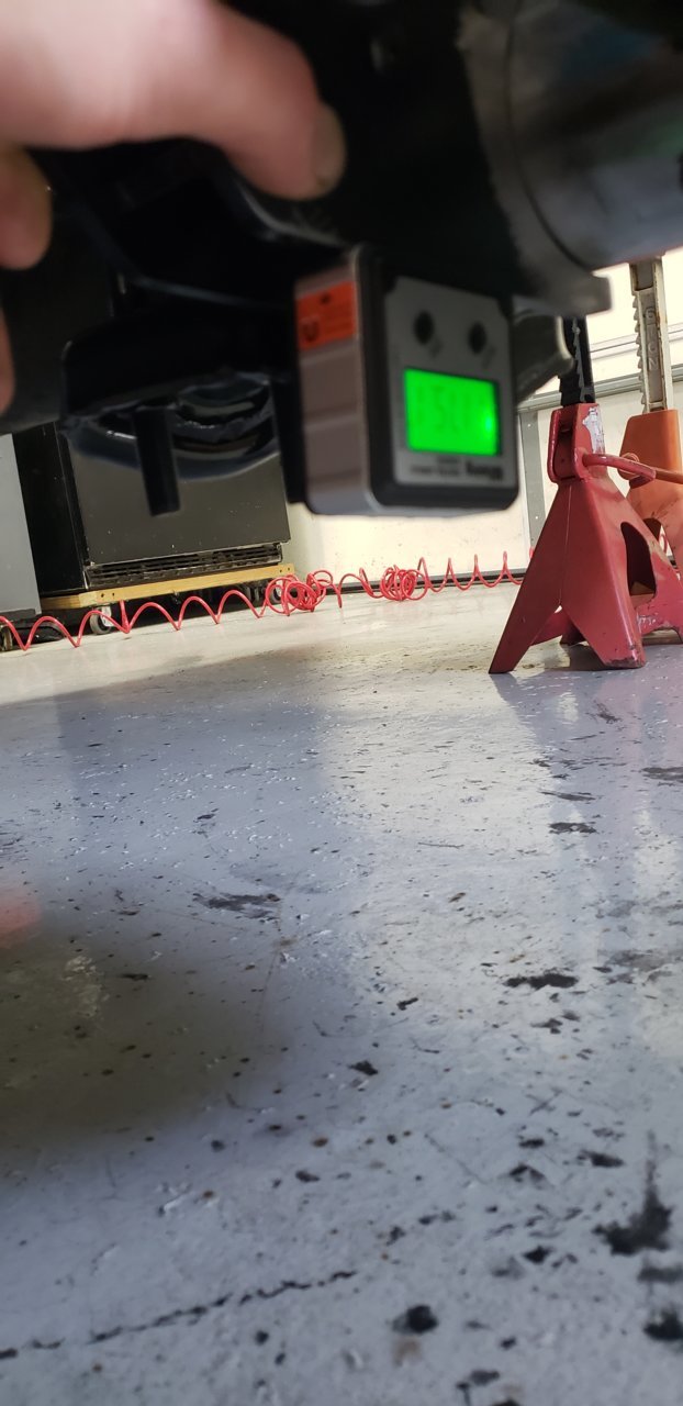

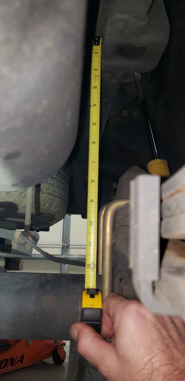

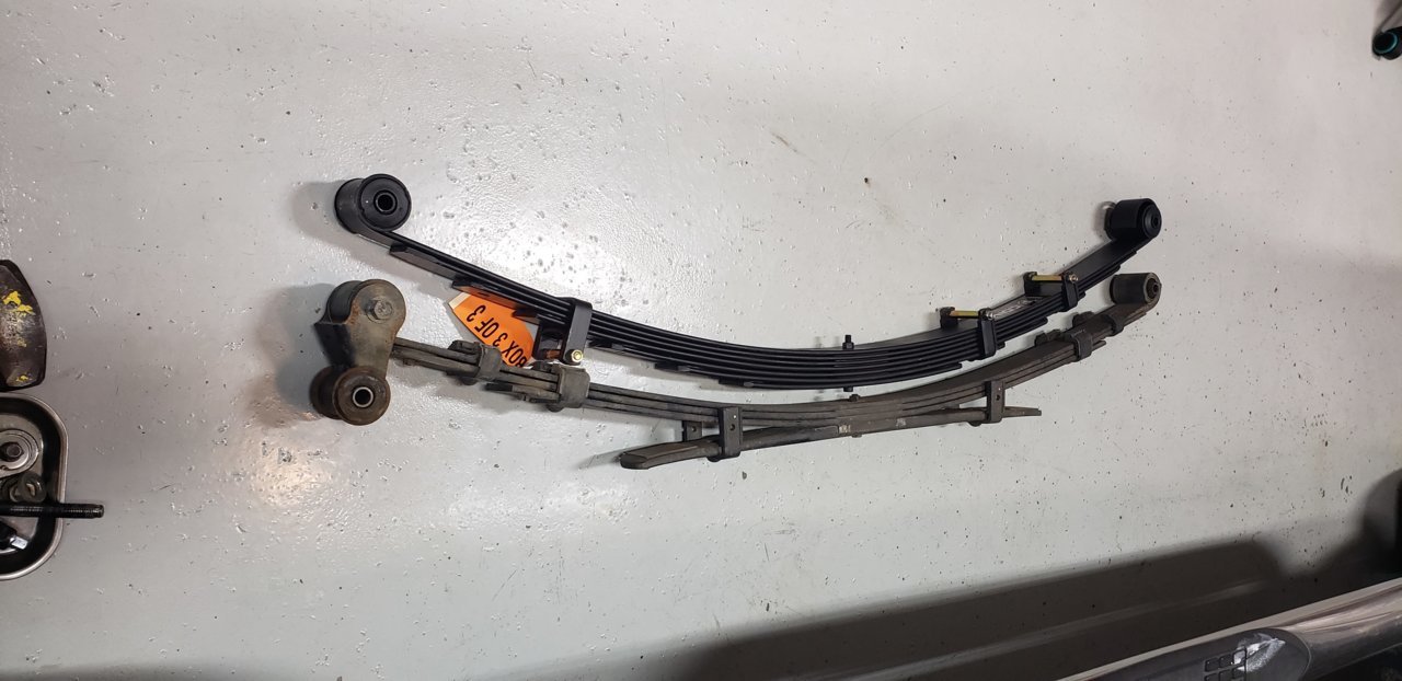

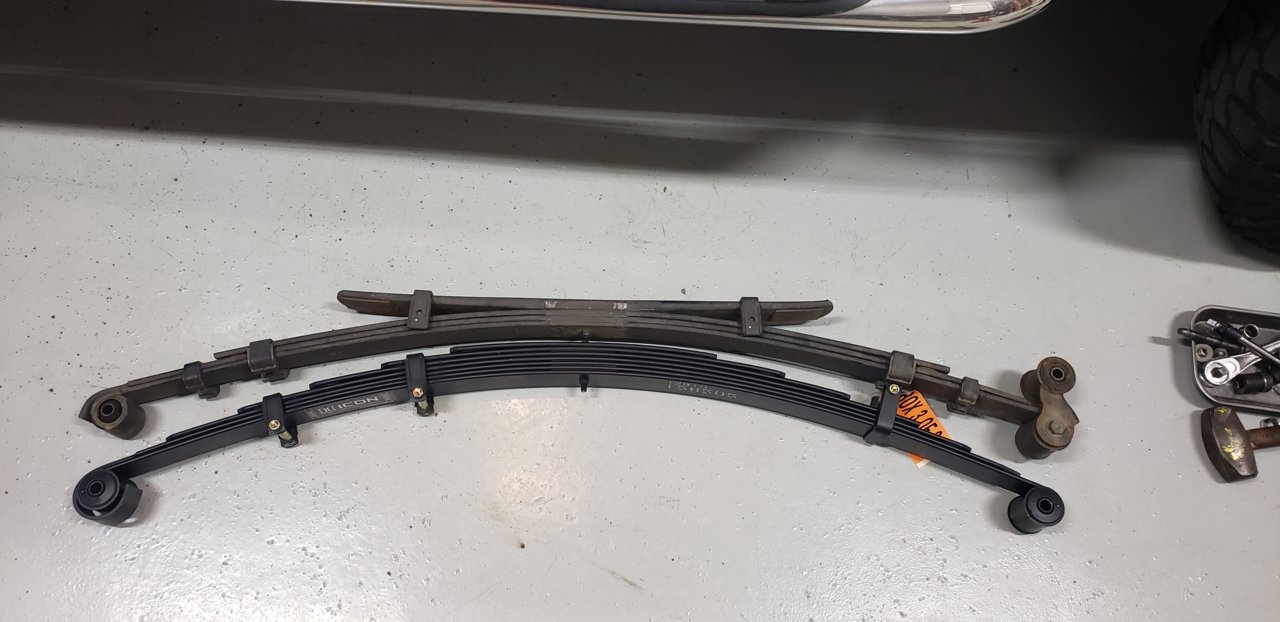

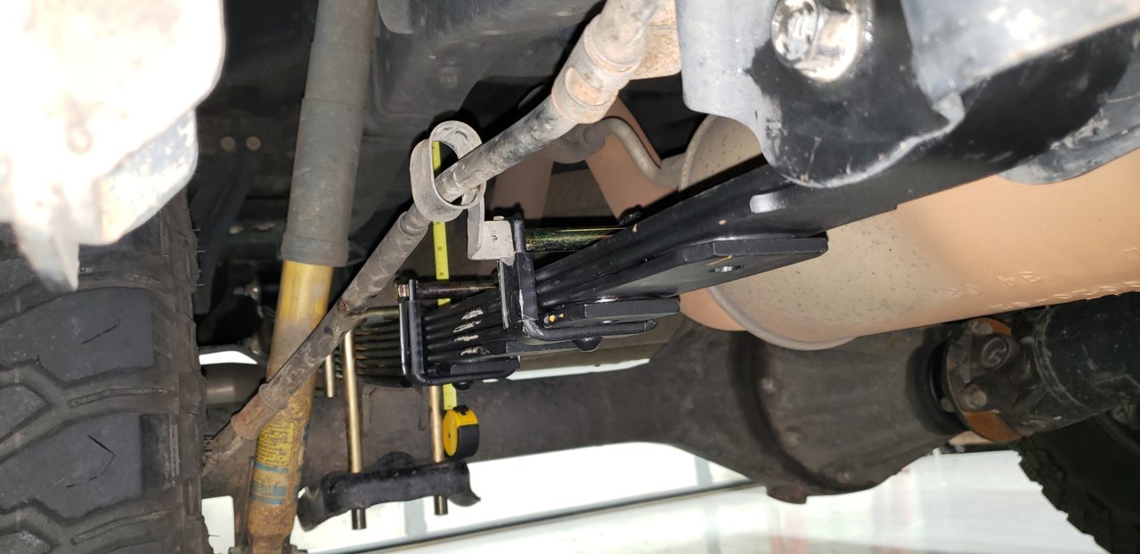

    The springs arrived first. I ordered these because of the multiple stages which in theory will make them adjustable. I am not a fan of when the truck has a rake or bro lean. Anyway, I started to order them from Icon, but the shipping was nearly $300. I ordered them from 4WP, free shipping to my local store.
    I installed these I had one inch spacers with stock leaf springs. The measurements with the spacers were 8.5” frame to axle at rest and 12.5" frame to axle unloaded. After removing the spacer and installing Icons (Stage 1) I was nearly 10.5” frame to axle at rest. Higher than I had anticipated.

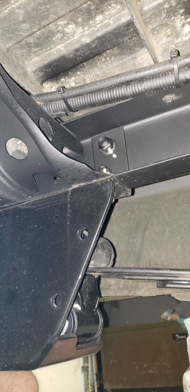

    On to the hammer hangers. I have heard how much fun it is removing the stock hanger rivets. I used my plasma cutter on one side to knock the head off. The other side I used a grinder. Honestly, the grinder, new drill bits, and an air hammer are easier to use. I barely scratched the existing hangers removing them. It wasn’t fun, but I have struggled more with less before.
    One thing I noticed really quick was the thickness of these hangers and these things are heavy. However, the frame these are going on is not nearly as thick. I did install plates behind the frame in an attempt to beef them up a little. I didn’t order it, but I will probably be getting the cross brace for these. It’s obvious the frame will be bending before these hangers do.

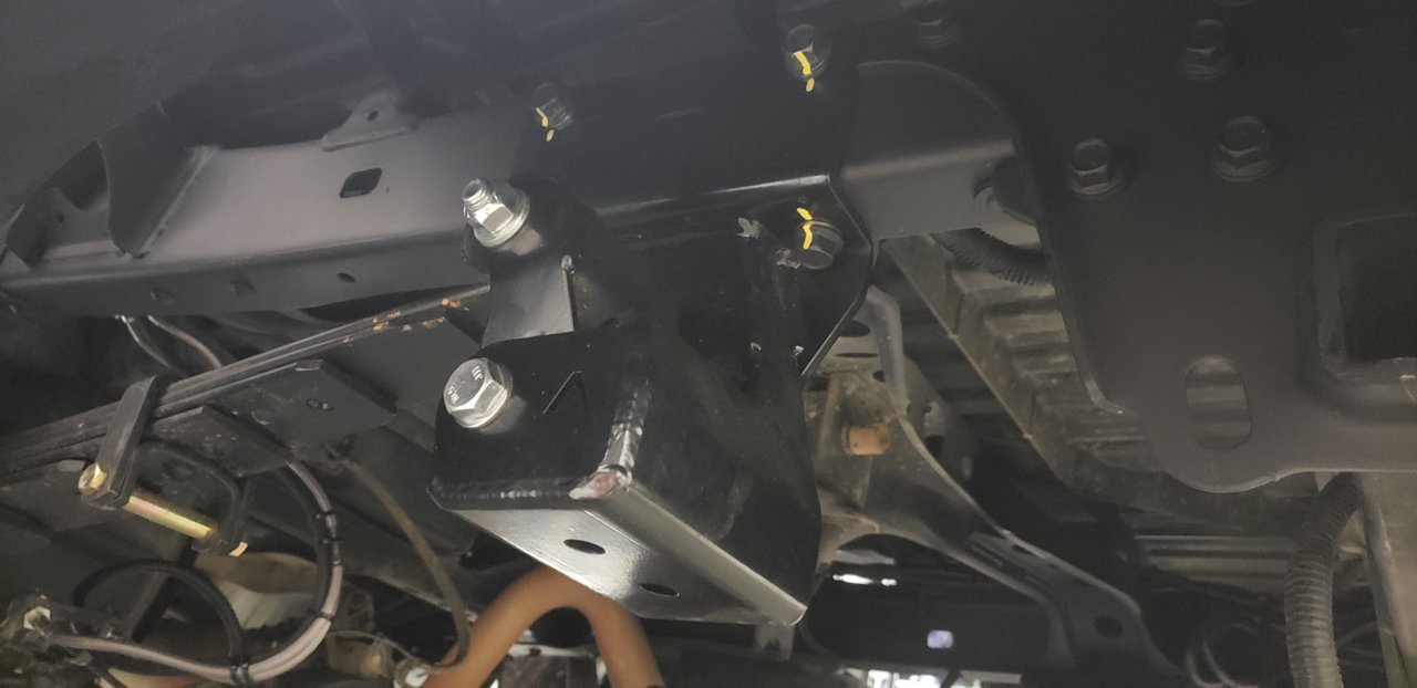

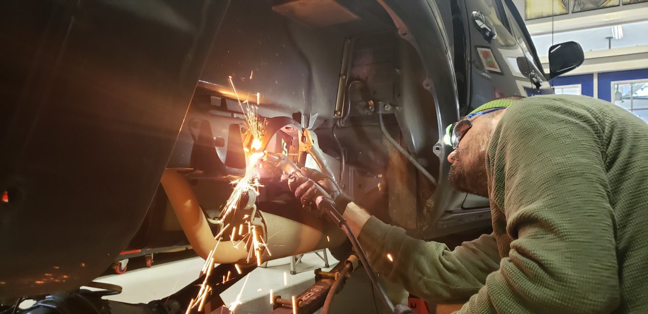

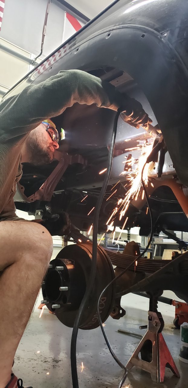

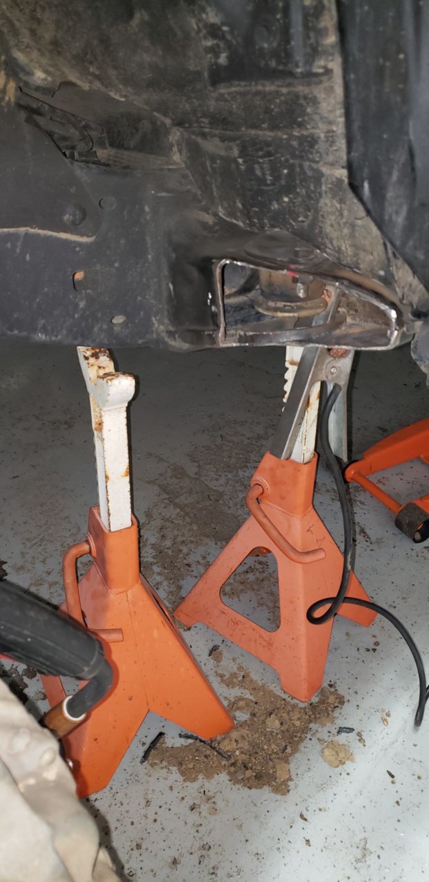

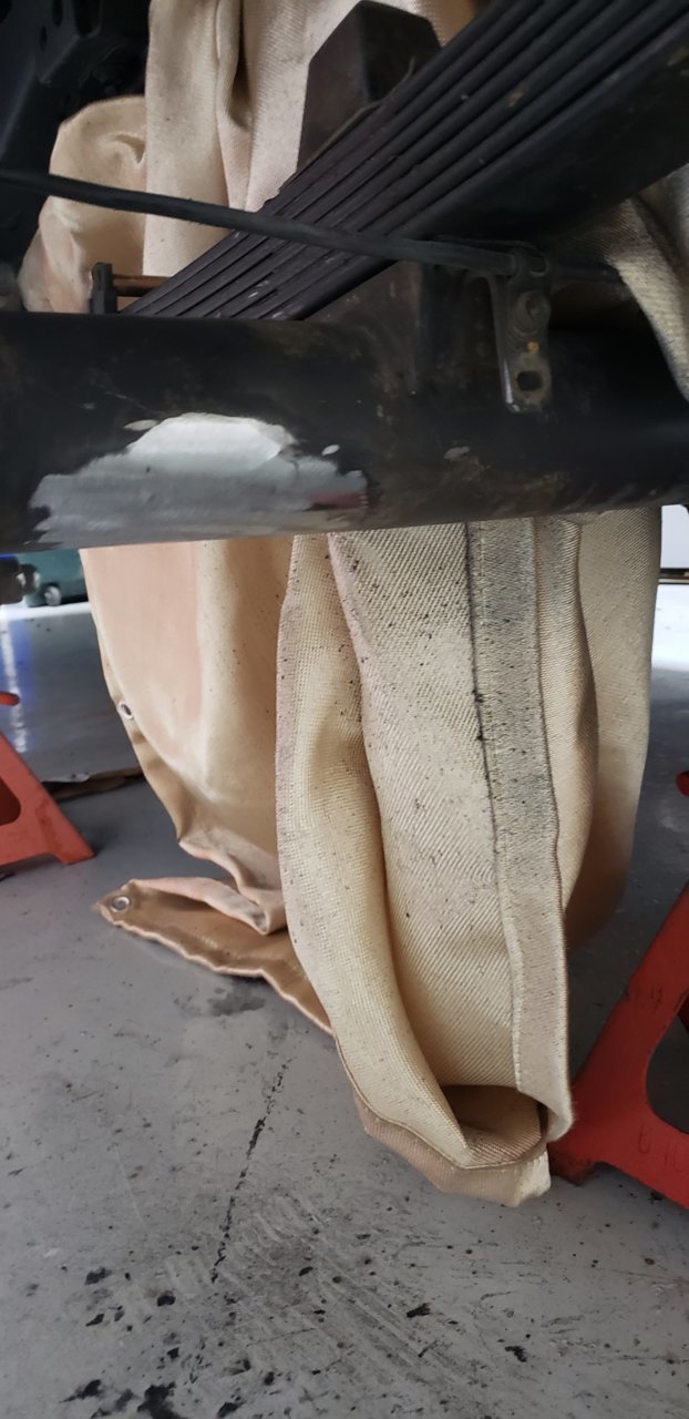

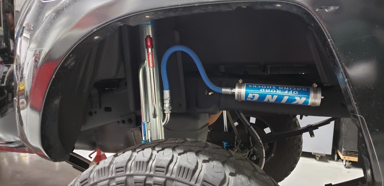

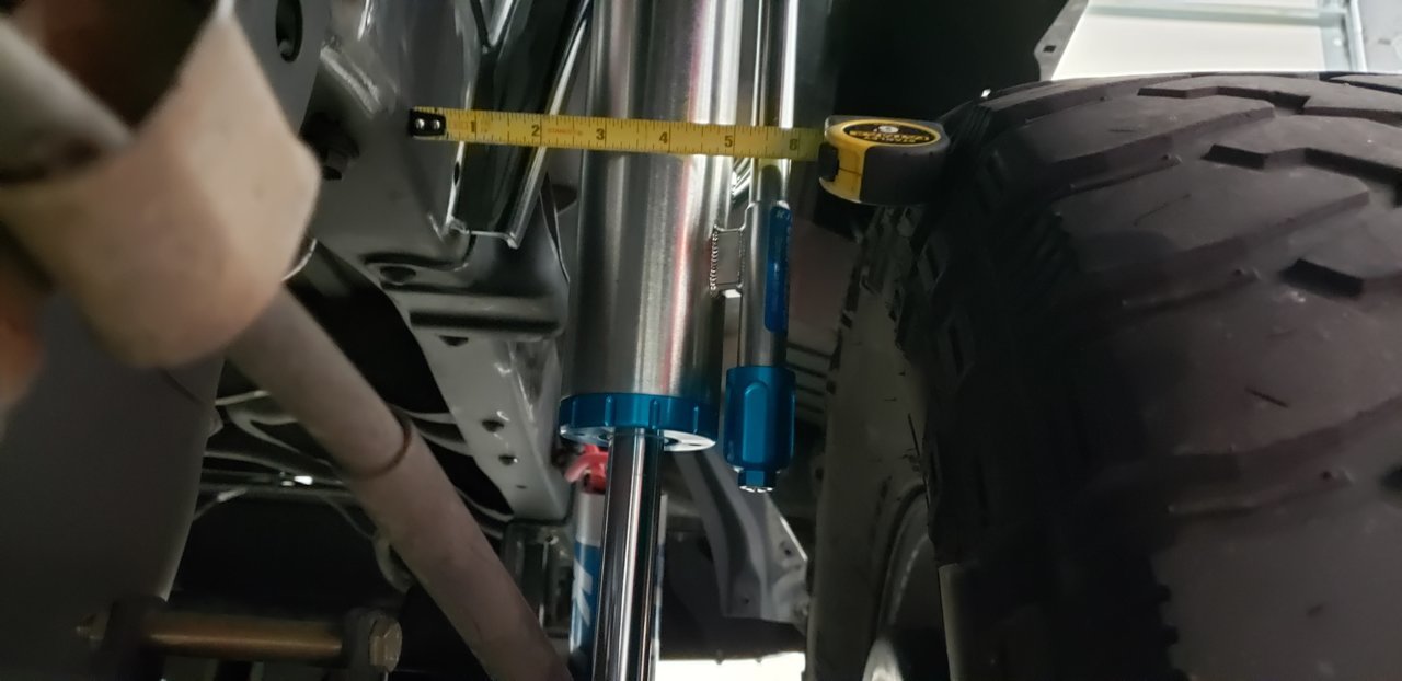

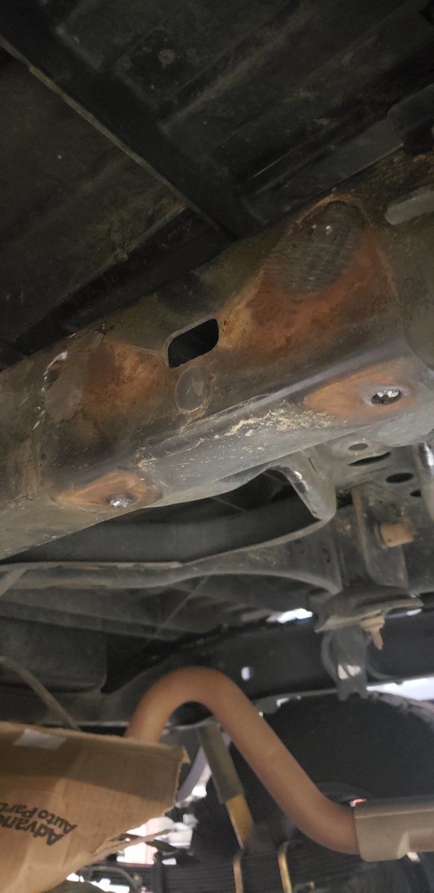

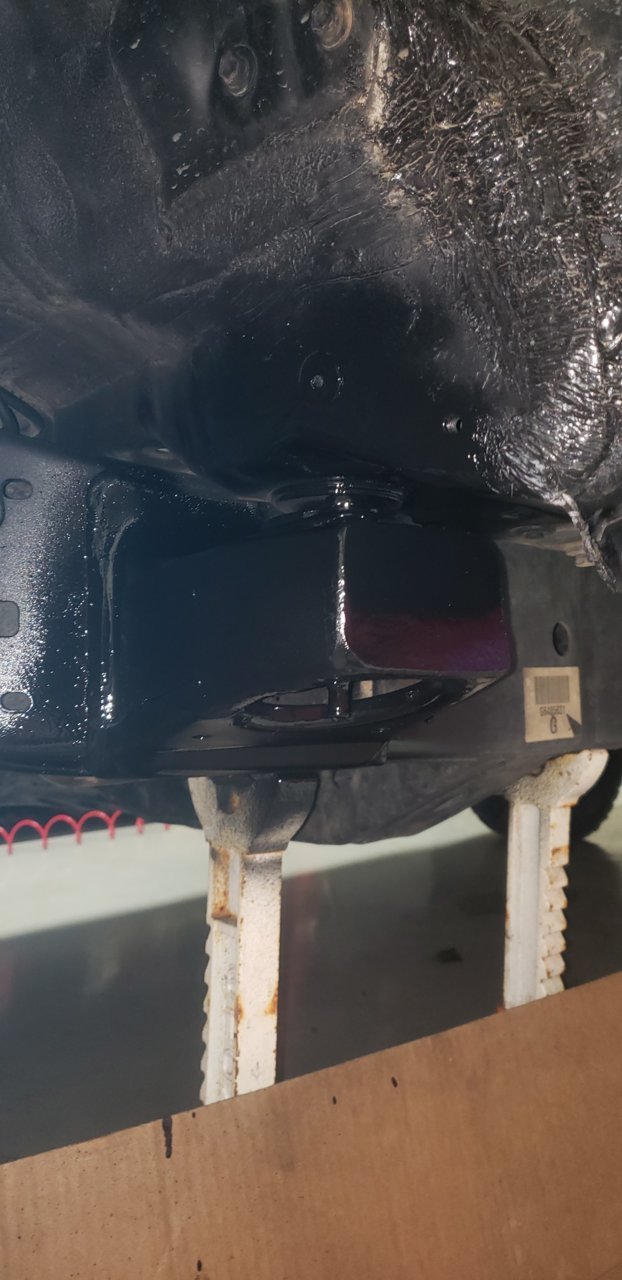

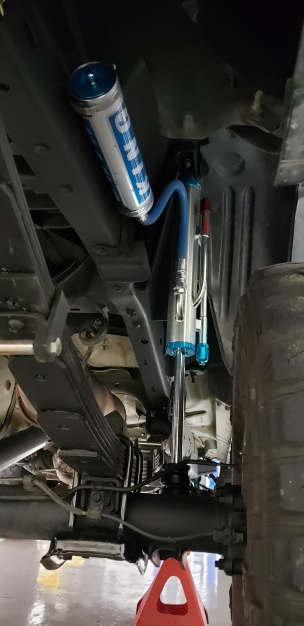

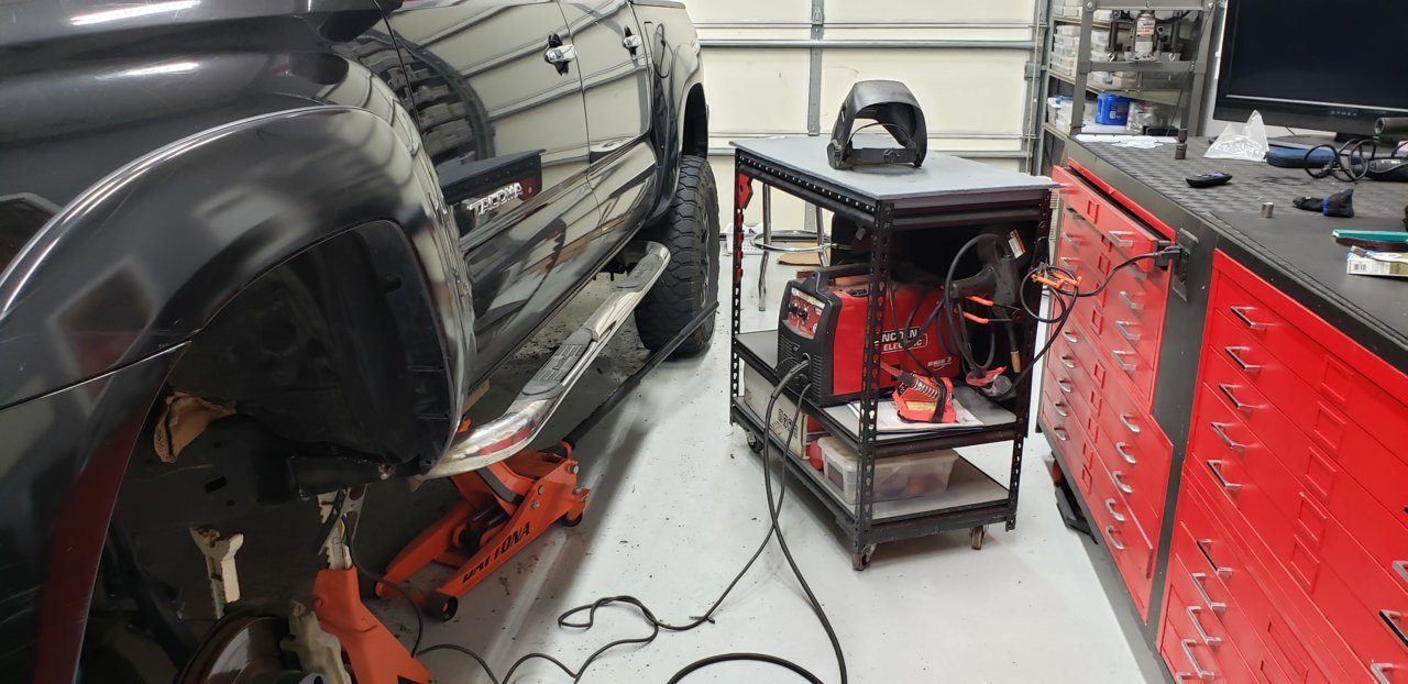

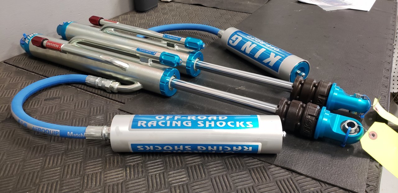

    Finally, received my King rear shocks. This is the first time I have ever cut the suspension off a vehicle and it doesn’t feel natural. After reading about it for months, I started. Cut, grind, chop, align, measure, weld… nothing to it.

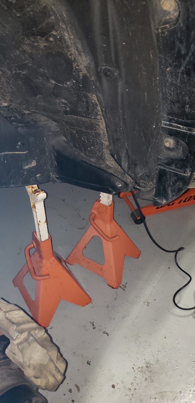

    Never fails. Flares always break. No matter how careful you are. Frustration starts early.
    Safety First. Using a plasma, grinding, and welding an inch away from the fuel tank made me a little nervous. Not the way I would like to go out.
    First cut.
    I had King send me some new stickers so these are corrected now. Hey... they were "free" stickers too.

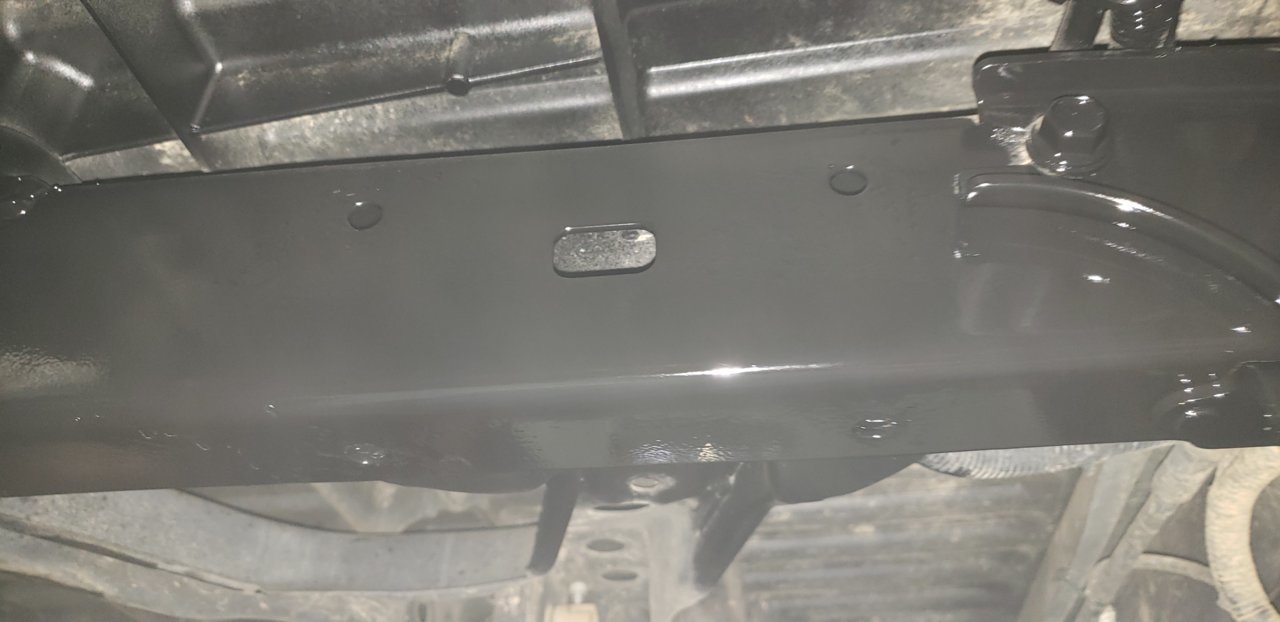

    What paint/coating are you using on the frame?

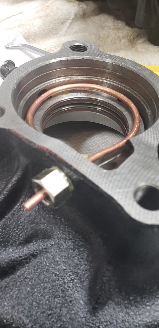

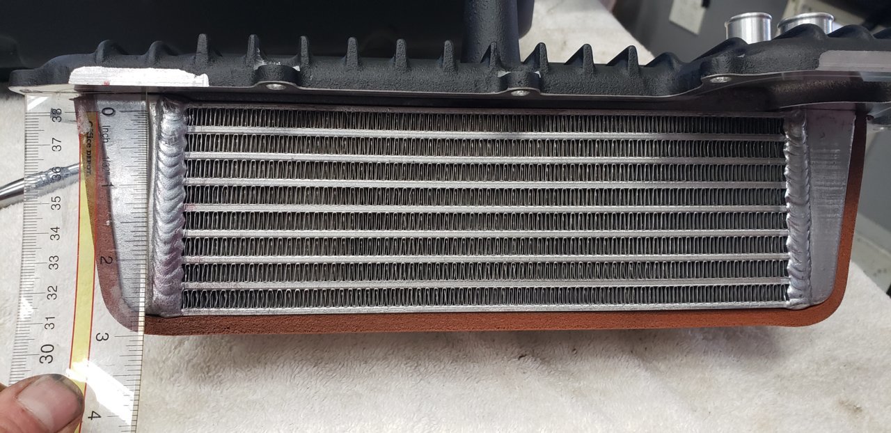

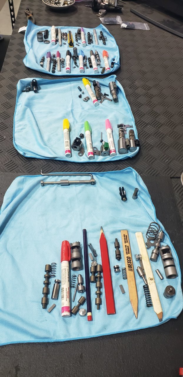

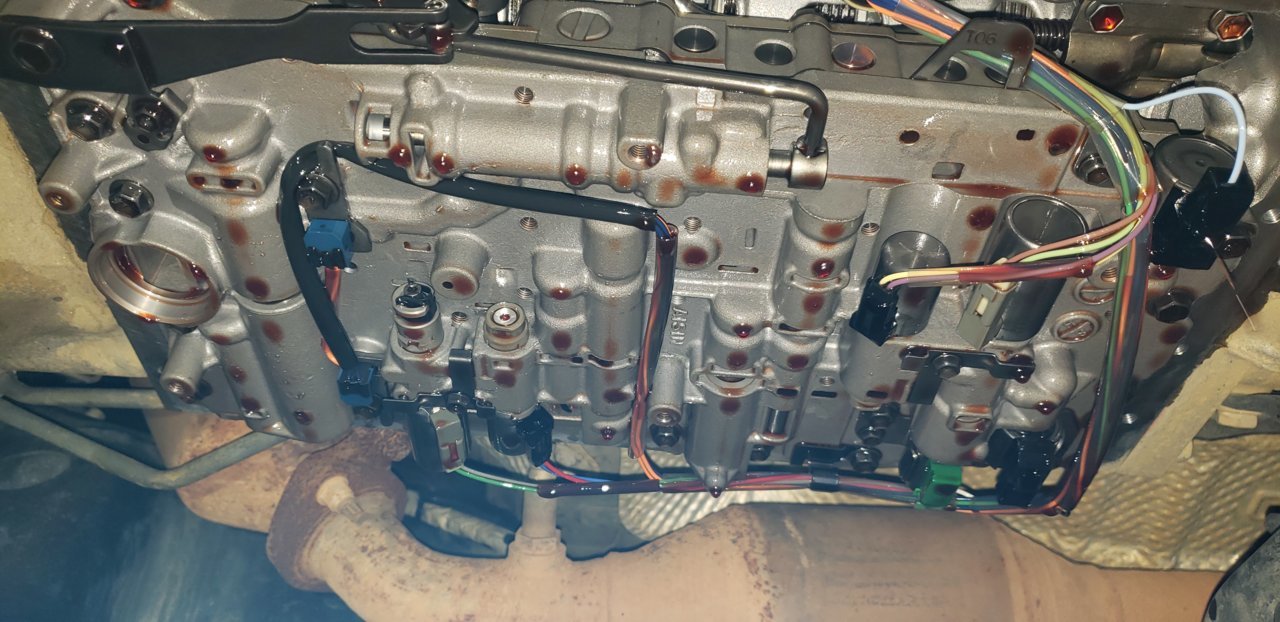

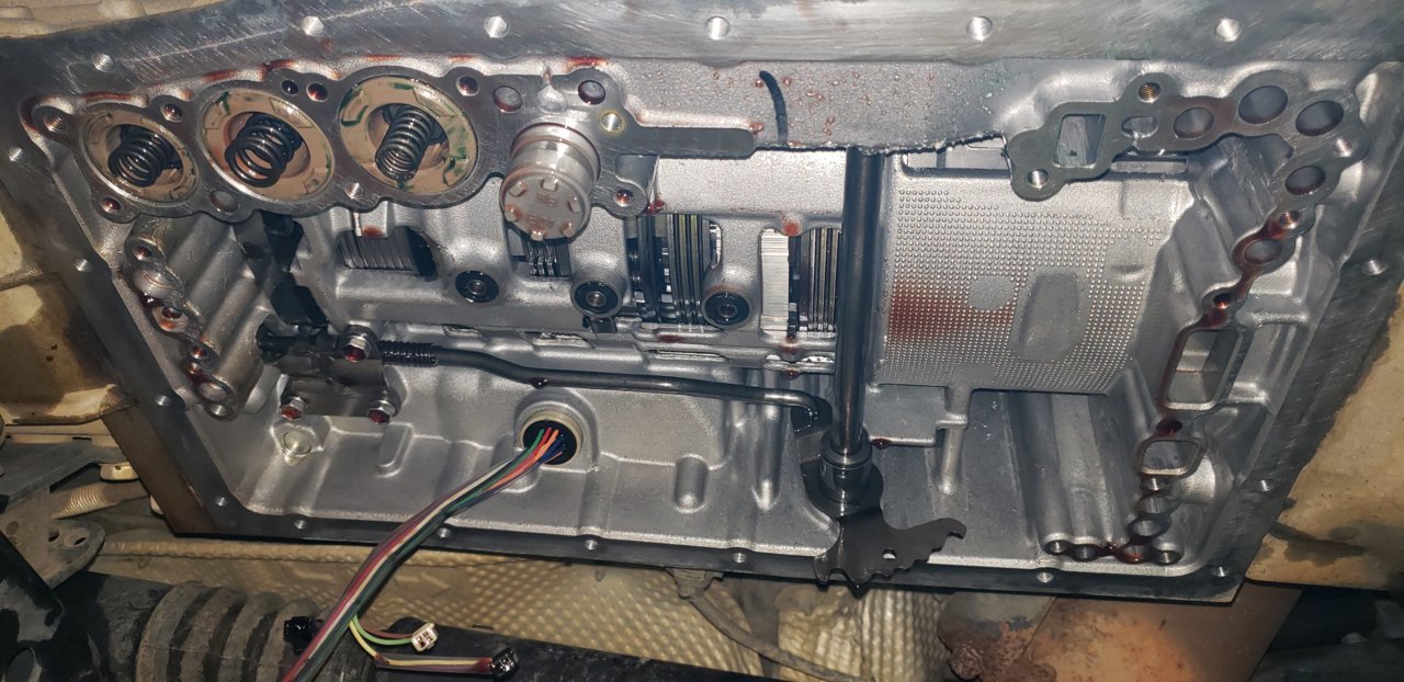

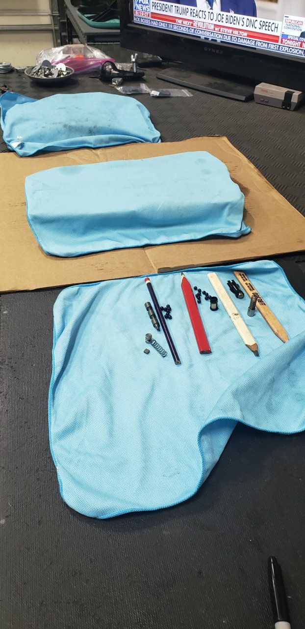

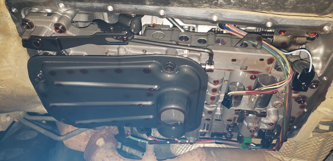

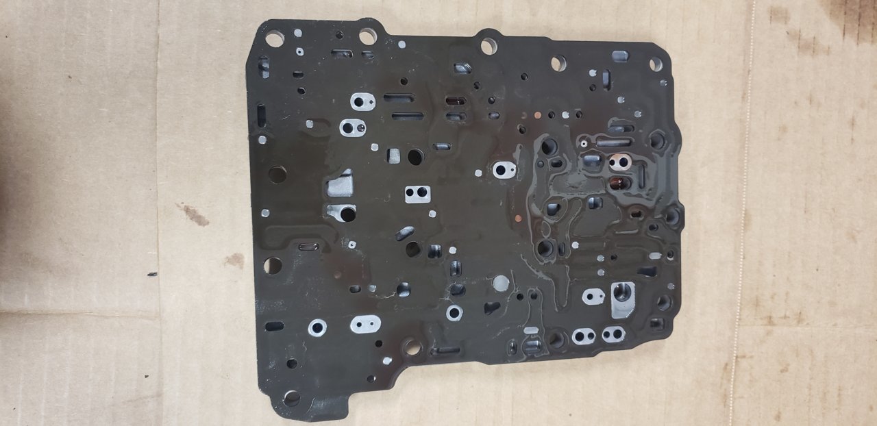

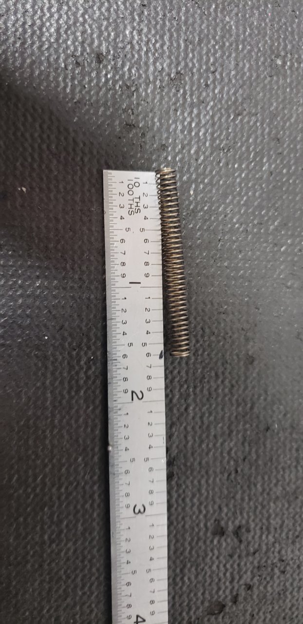

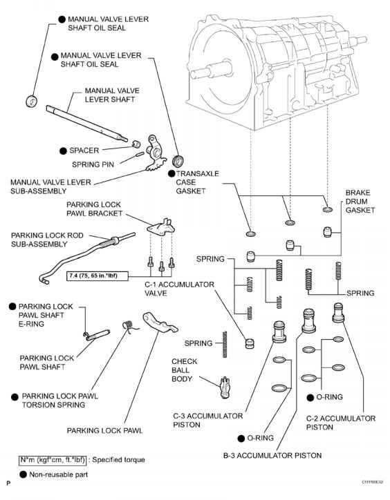

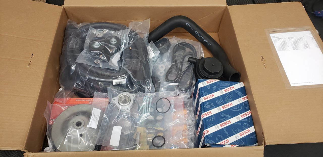

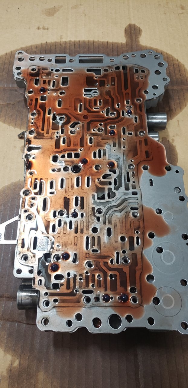

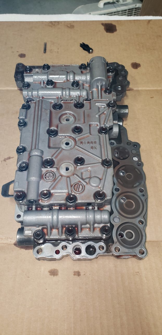

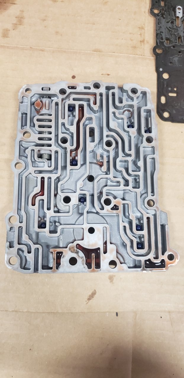

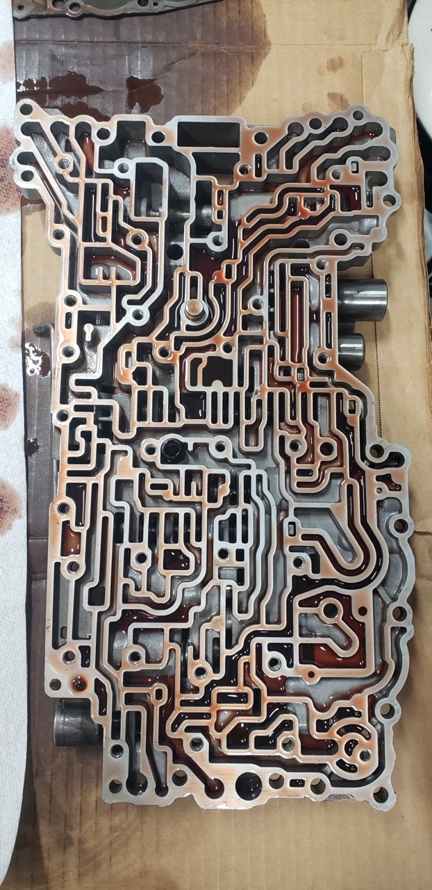

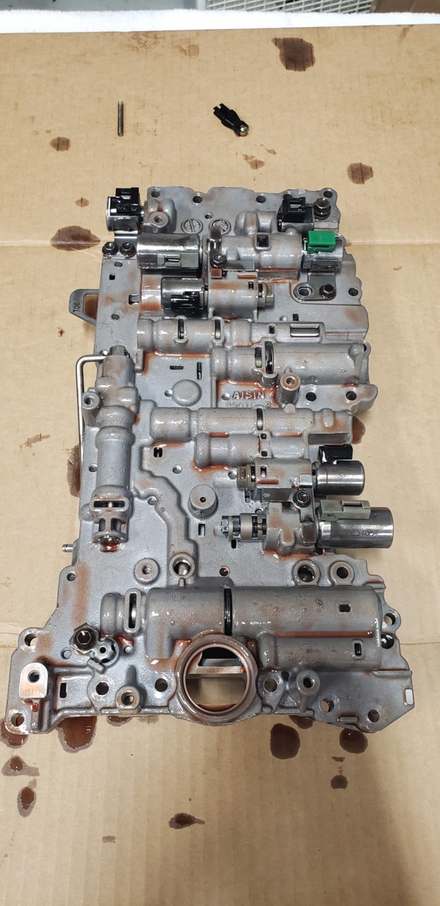

    Shiftkit RatioTek P/N: RT-A750E-HD
    After reading about this kit, speaking with several people who installed it, reading a great writeup, and seeing how inexpensive the kit was I decided to do it.
    The link below is to a writeup which details the installation much better than I will be doing.
    https://www.tacomaworld.com/threads/ratiotek-transmission-upgrade-how-to.528378/#post-16878478
    More information on the transmission.
    https://www.tacomaworld.com/threads/transmission-5-speed-automatic-write-up-with-pics-for-second-gen-4-liter-trucks.289913/page-7
    This is a training video on the transmission.
    https://youtu.be/eMMTlQPZmqs
    IPT Performance Transmissions A750E/F Valve Body Installation

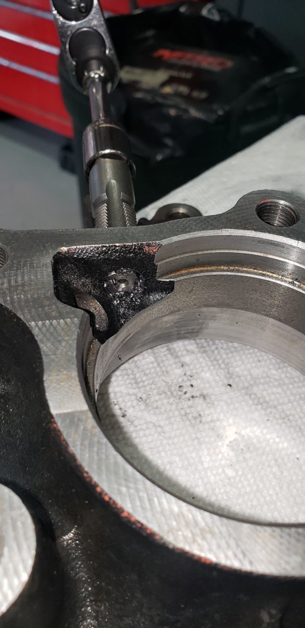

    This kit is very impressive. I would say it is in the top five items I have purchased and installed in my Tacoma. The vehicle seems to pull much better, feels more solid, shifts like it should have been designed to shift. Keep in mind, I have modified the shift parameters with HPTuner. The before and after of this kit is substantial.
    As for the installation, it is more intimidating than difficult. I was a little uneasy about drilling holes in the upper body plate, but hell I drilled a large hole in my front diff for my ARB air locker. I will attach the installation instructions for those who are interested. They are straightforward.
    The three most noteworthy items of the installation are the transmission cooler fluid check valve spring, checking the fluid three times after drive cycles, and keeping the valve body clean.
    Spring – I literally spent three hours on the floor looking for this spring, went through the trash twice, and finally ended up believing my dachshunds walked off with it. They did not seem to be concerned about missing a major part which was preventing me from installing the valve body. A $0.74 part kept me from putting it back together for three days.
    Fluid – When doing this nearly all the fluid will drain out of the transmission. I started it cycled through the gears slowly several times, checked it, filled it, then repeated again. Made sure the trans was around 95F. Everything checked out. Drove the vehicle to work. Decided the next morning I should probably check it again. Nearly two quarts low. I freaked out. Thank God I checked it the next morning. This could have been bad.
    Clean – The tolerances for the valve body are so tight, I was very nervous about being super clean. I used microfiber to wipe it down and lots of air to blow each piece off before installing. I also used Mr. Tranny Lube, green, to install all moving parts. Just a little. Honestly, I would not even get close to the valve body with a paper towel. I think you would be asking for trouble by doing this.
    Here are some images from the installation. Keep in mind, I removed all the valves and solenoids to clean and inspect. Only a few of these are required to be removed for installation of the kit.

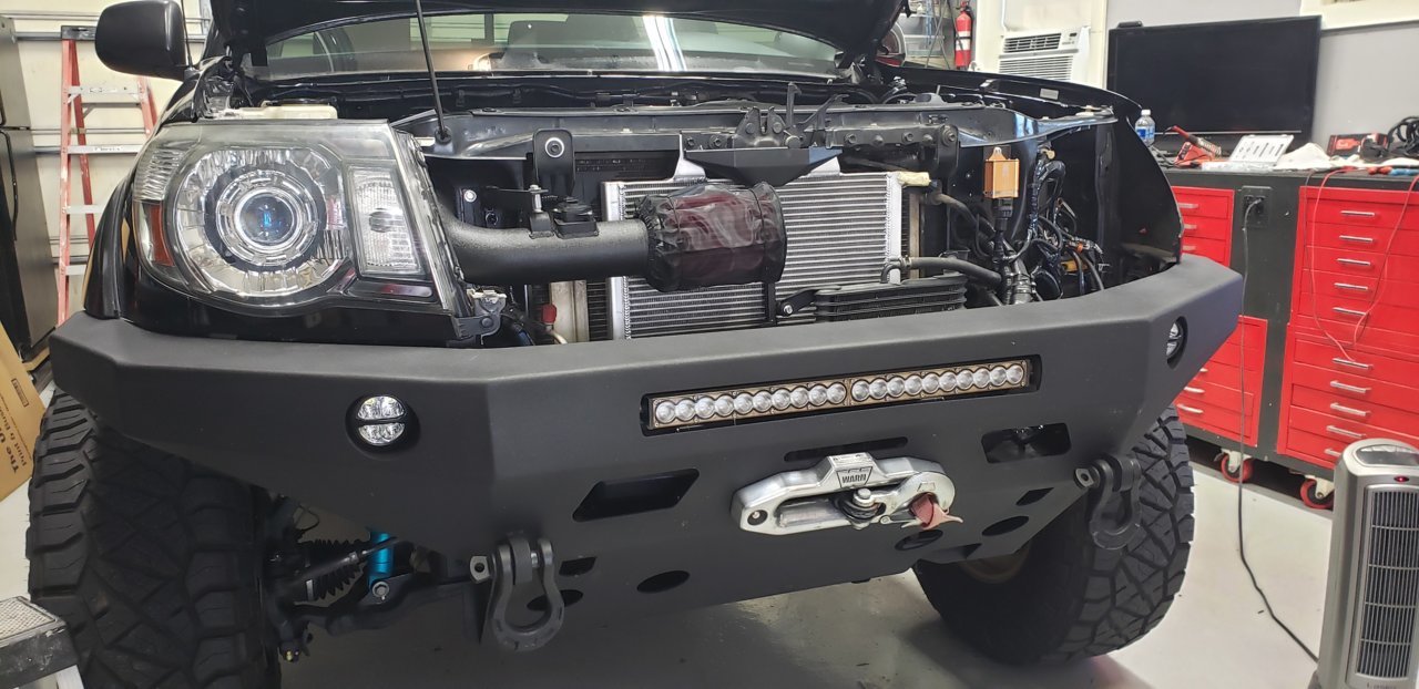

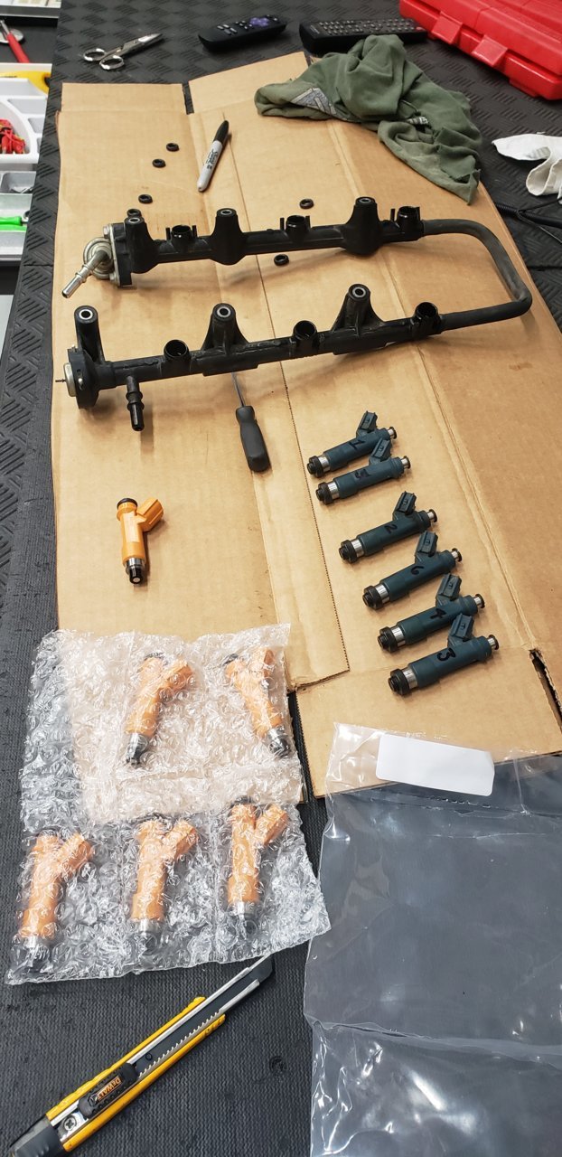

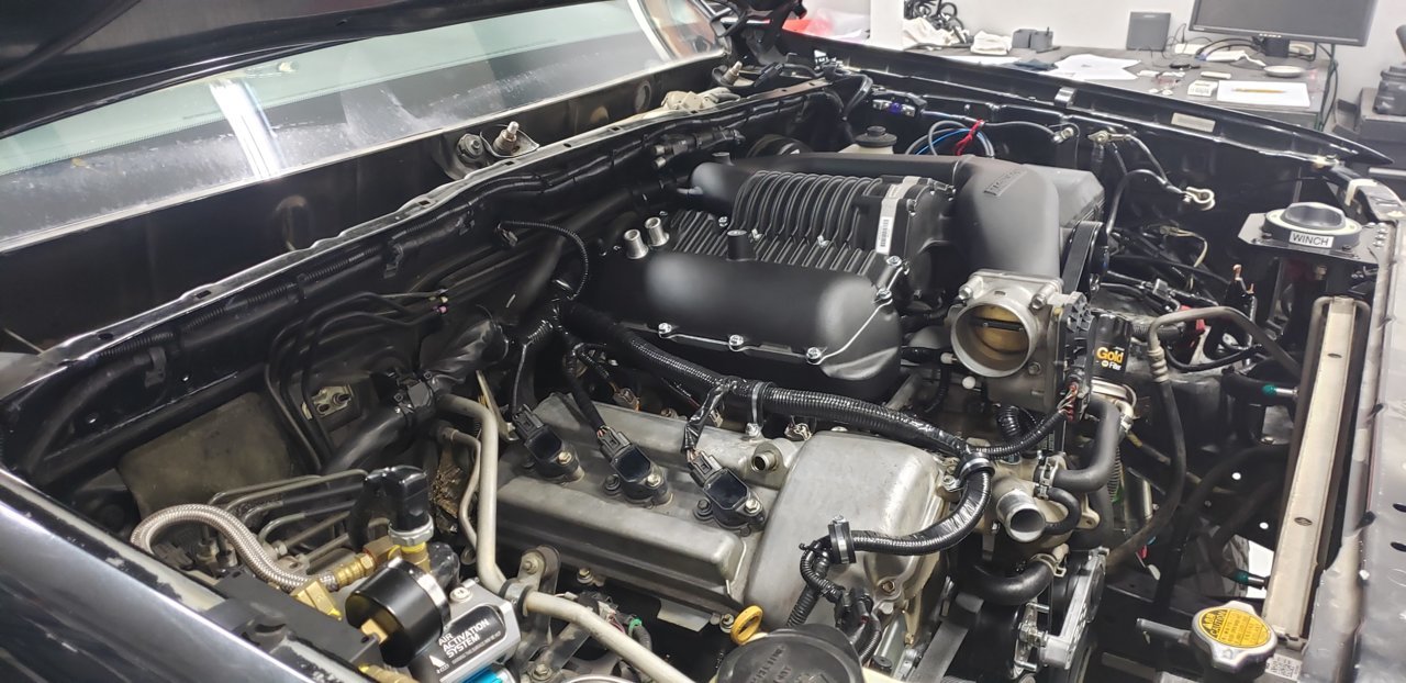

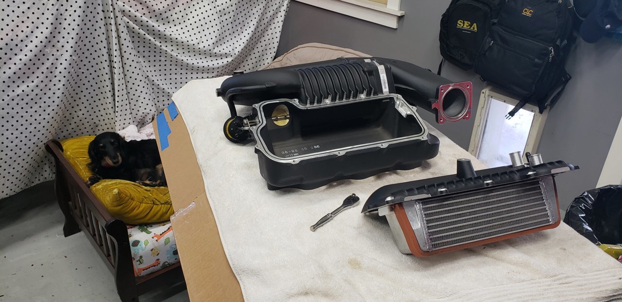

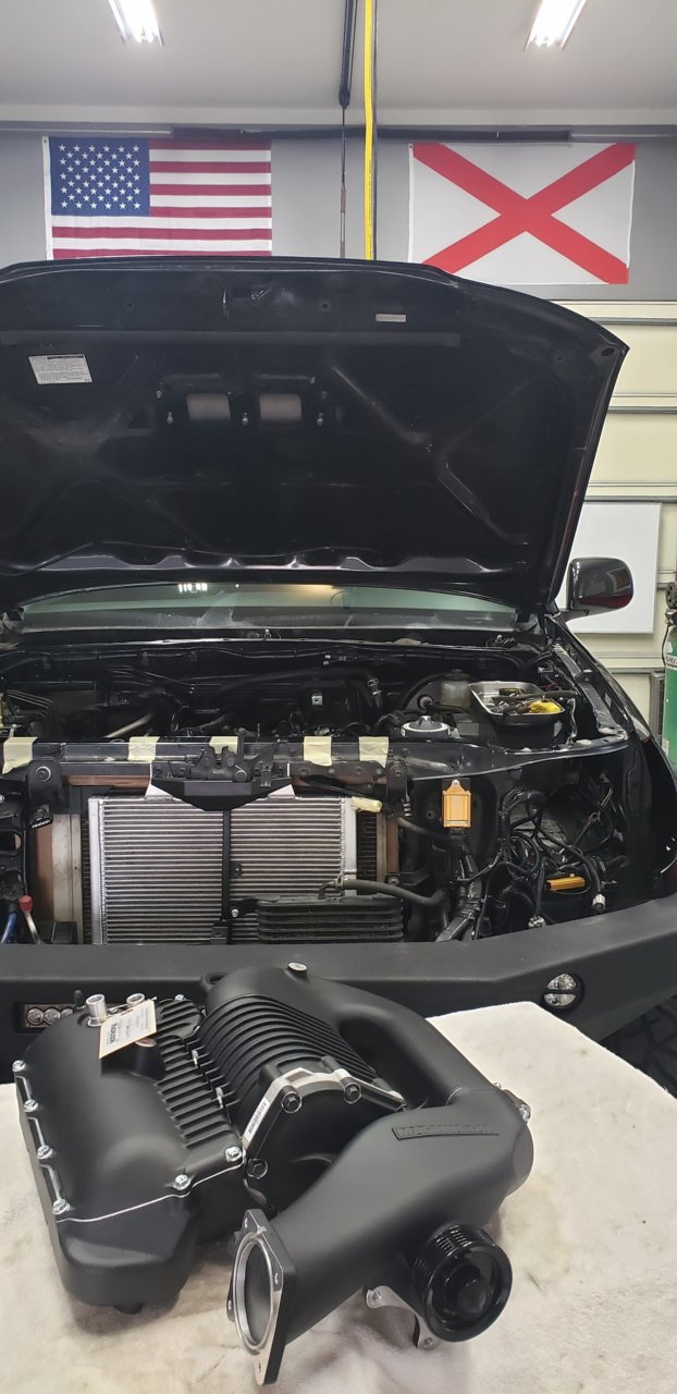

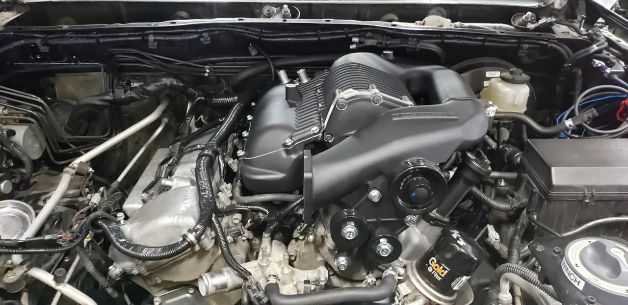

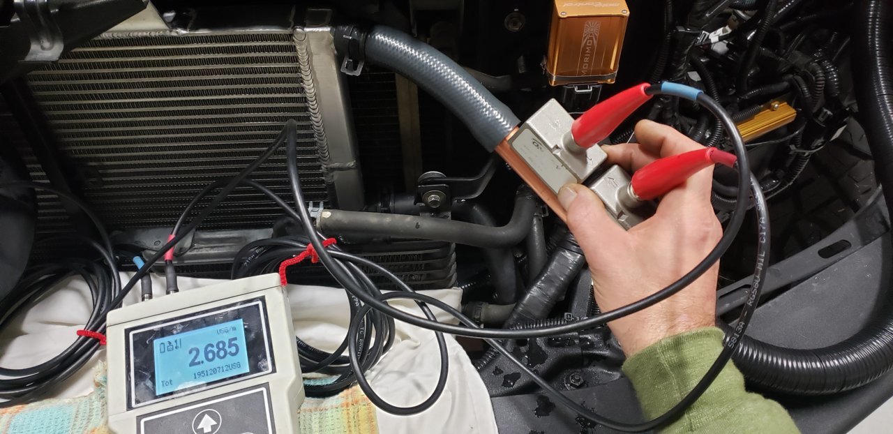

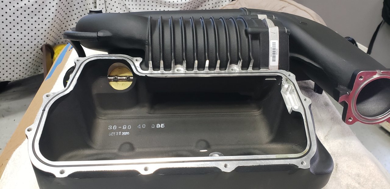

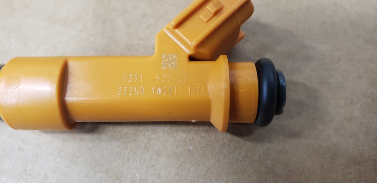

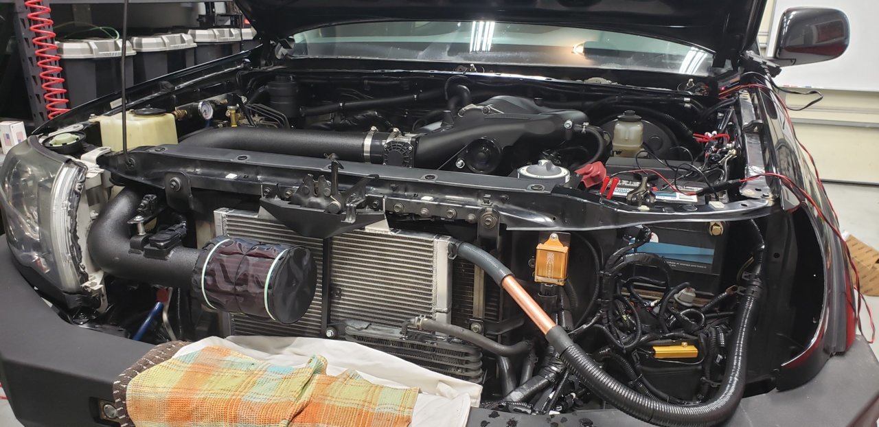

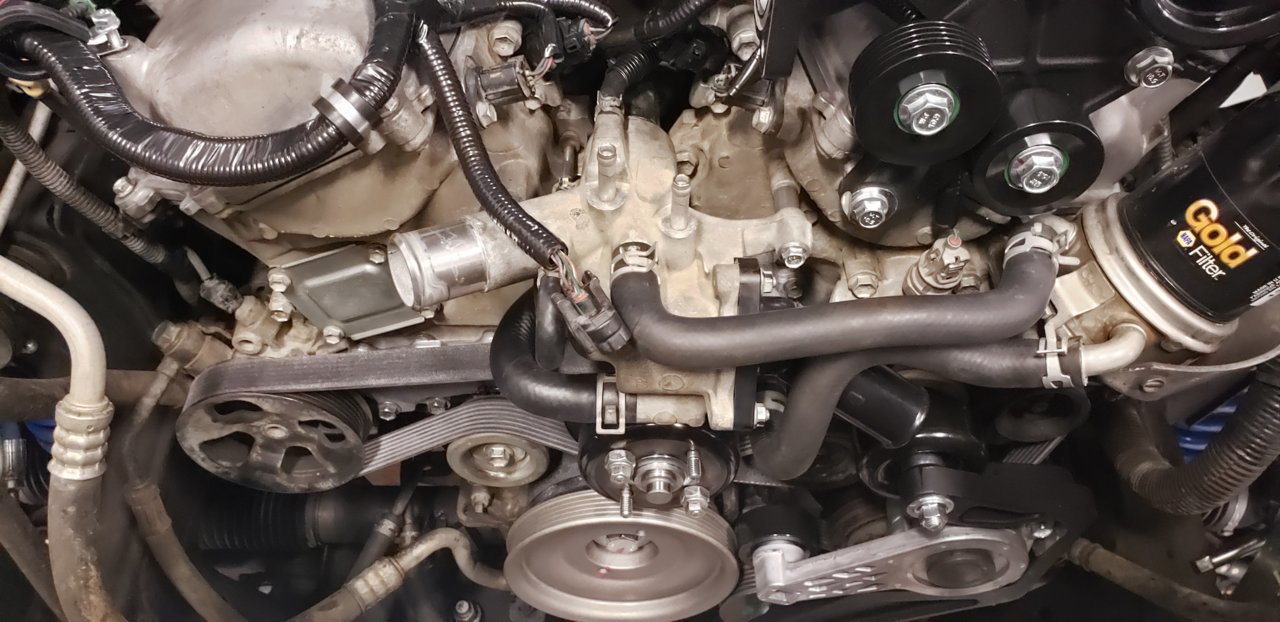

    MP90 Magnuson, Supercharger

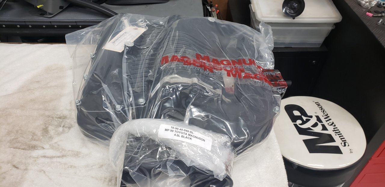

    I purchased a MP90 positive displacement supercharger without the URD engine management, URD Spec-U LT Headers, URD Mark 2 Competition Y-Pipe, AEM E85 320 LPH Pump, Filter “Green Top”, URD Quick Change Supercharger Pulley w/Hub, 2.8”, HPTuner MPVI2, AEM 30-0334 X-Series OBDII Wideband Gauge, and a AEM 30-4900 Wideband Failsafe Gauge. Instead of the URD engine management kit, I installed, with the sourcing help of a TW members, a new SC engine control module. The exhaust and supercharger were installed at year end. The kit was relatively easy to install, but I had to modify the intercooler and hose routes to accommodate my winch and auxiliary fuse block. I am mainly going to dump some photos in here and hopefully come back later for the narrative.
    Some very useful Tacomaworld links are listed below.
    https://www.tacomaworld.com/threads/trd-magnuson-4-0-supercharger-tips-tricks-and-mods.518932/
    https://www.tacomaworld.com/threads/how-to-1gr-fe-supercharger-installation.101770/
    https://www.tacomaworld.com/threads/hp-tuners-for-2005-2015.600793/
    https://www.tacomaworld.com/threads/hptuners-the-tacoma-faq.705981/

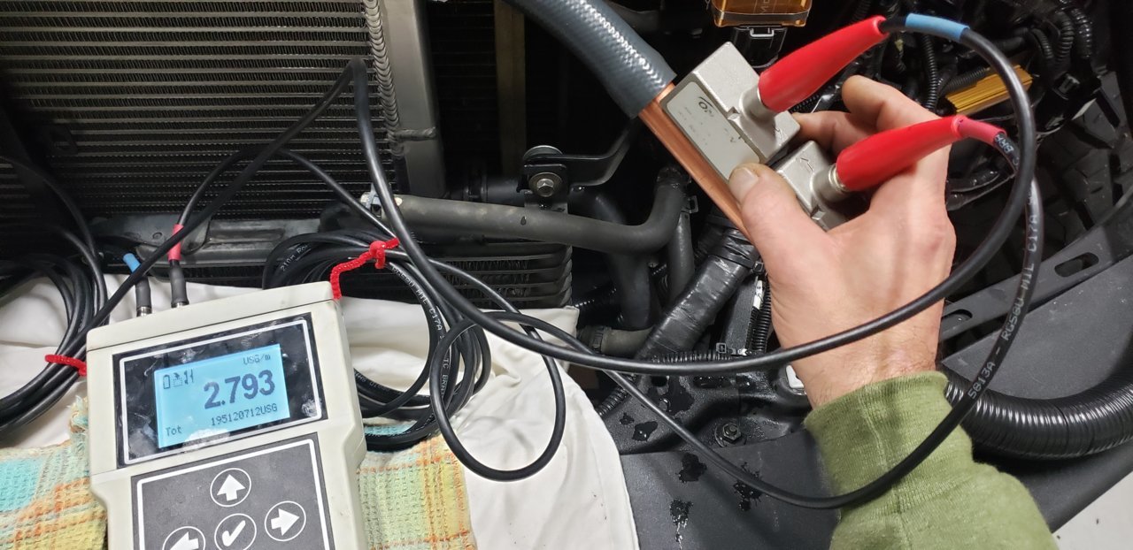

    Nice flow meter. You work in HVAC?

    Thanks.
    Yes... well building commissioning. We commission HVAC, lighting, plumbing, electrical, building automation systems in new and existing buildings. We have some really cool tools I get to "practice" with at home.
