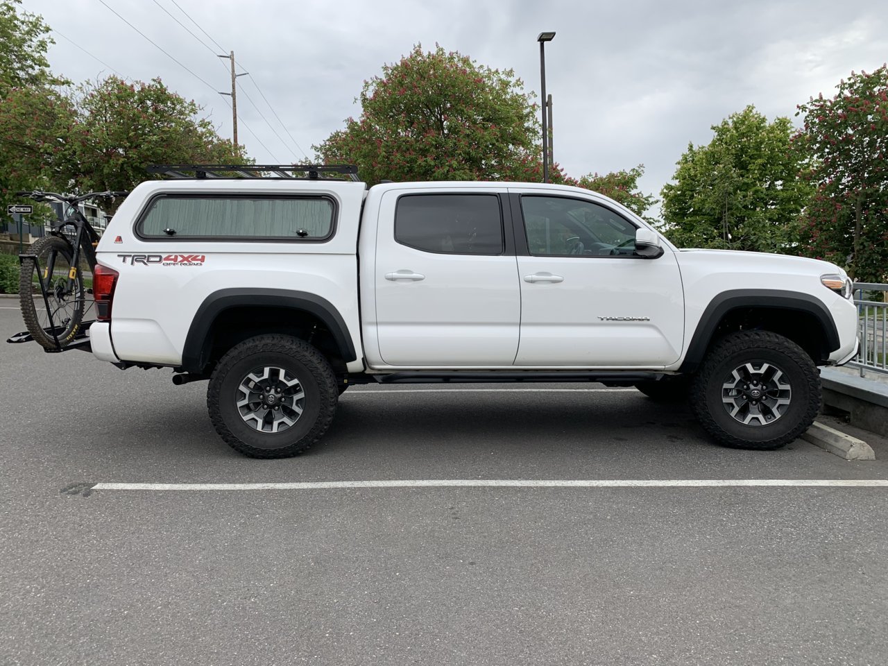

    160
    2020 Cement OR
    HD leaf pack gave me 4 inches of lift in the rear. I have about 300 pounds in the rear from the gfc and bike rack, another couple hundred when it’s loaded with gear. This should settle out a bit, also putting in the bilstein 6112/5160 combo next week.
