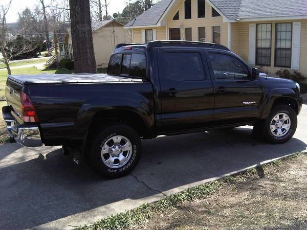

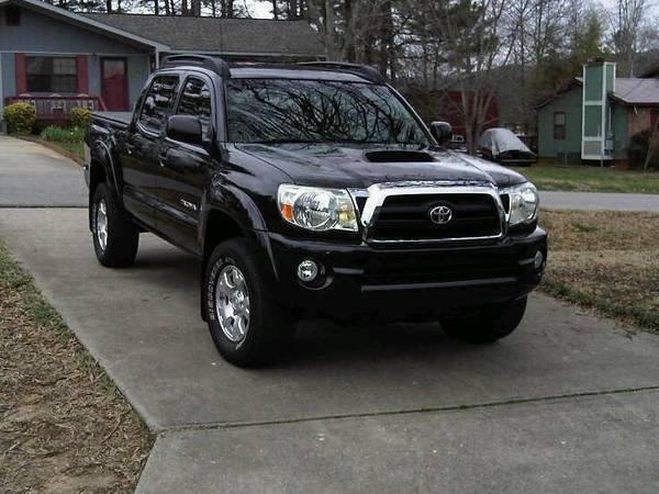

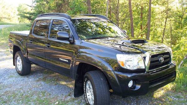

    This is mine one week after I got it. Paint felt ruff when you ran your hand across it and it needed waxing. After claying and 2 coats of wax, it looked like glass !! Check it out.

    nice!

    Looks great Phoneguy, Pride of ownership shows! It really is a labor of Love! When I bought mine (new2010) I used a clay bar, washed, waxed and sealed, it looked really good!

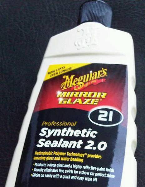

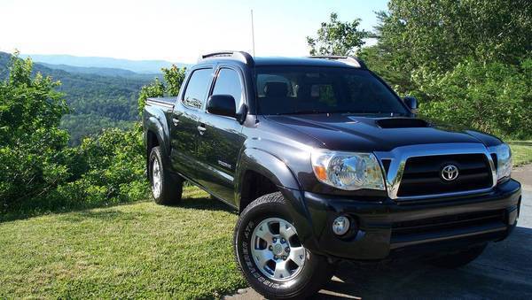

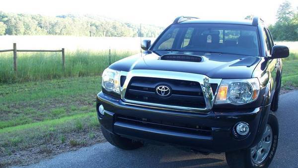

    So as promised, here's the update. I was pleased with Meguiars #21. Note, I am not a professional detailer but I am a person who can read and follow directions. As I said before, I learned alot on autogeek.net and I'll share it all.
    Dont you just love this site.....hands on with pictures !:p
    First, remember that I did Clay Bar my truck about a month 1/2 ago, IT DOES MAKE A BIG DIFFERENCE !!!!
    Washed every square inch of the truck VERY VERY VERY good so that I had absolutely nothing but paint so spread the sealant on. Shammy'd truck dry and then drove it a mile down the road and back to get rid of any excess water hiding in the cracks........Meguiars says to apply it on dry micro pad, not a wet one.
    In the shade applied a thin coat of Meguiars #21 Sealant. It says to let dry for 15 minutes before wiping off with micro towel. I did half the truck and then went back and starting taking it off.
    I have waxed many of my cars MANY times so I know what I'm talking about when I say this stuff was SUPER EASY to wipe off, not like a wax at all.
    I put it on everything from fender flares, headlights, tail lights, side mirrors, front bumper and rear bumper (chrome only).

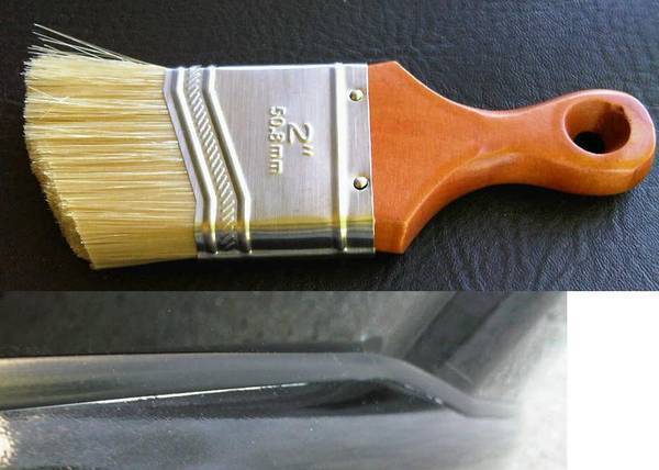

    Now one thing I do want to point out is the residue you leave in the cracks and crevasse's, like the rubber on the fender flares (see below). You can pinch that towel all you want and try to squeeze it in there but you just cant possibly get it all so check it out. There is an easy way to get this !! Called a paint brush. I went to Lowes and bought a 5 dollar paint brush and cut the bristles down so that it would be stiffer. HEAR ME NOW, it's easier if you just stick this thing in your pocket and hit it as you wipe. Seems like its harder for me to get it off if I wait till i have the whole truck done and try to go back and get it. I wind up missing a spot or cant get it cause it's stuck on there like cement. A toothbrush scuffs my wax job.
    Now how you wipe it off is up to you and I know you're not an idiot so dont think I'm saying you are. I just like to have one towel in one and and another in the other. That way I keep my hands off the truck (prints) and if I get tired I can go at it with the other hand.

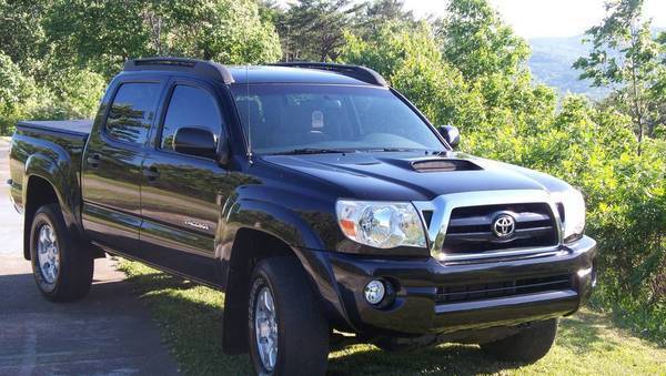

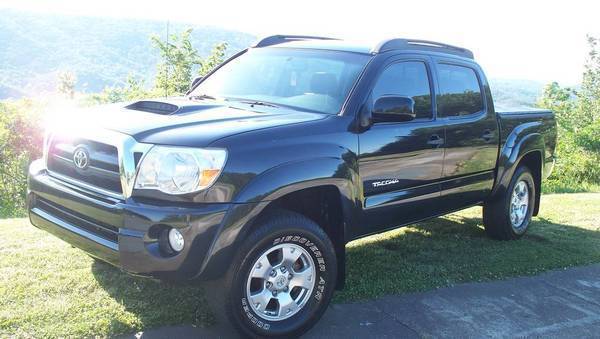

    Last but not least, the final results ! This is a sealant so the shine is not as glossy but I've now prep'd my truck to apply the glossy wax. Thats my next step next week. This sealant will allow my wax to stay on longer and I wont have to keep doing it once a month like I have been.
    Enjoy fellas !! Aint she a beaut !!

    Thats just simply Truck Porn!! :thumbsup: Great job!
    Thanks for the paint brush tip.. The guys will call me nuts now for sure :D
