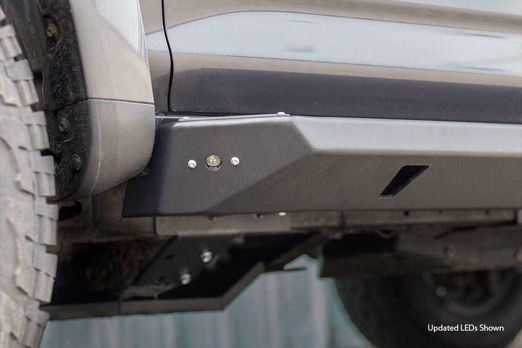

    Mine is in the mirror along side the one used for the puddle light, and they fit just fine. I did the recommended gusset clipping on the passenger mirror for adequate LED housing clearance.
    It took me a few minutes to search around, but I didn't realize that one of those connections is for the puddle light, and the other is for the MESO signal lights. https://cdn.shopify.com/s/files/1/0...lecontents_4000x.progressive.png?v=1581440314
    Also, these lights are sweet! I'm looking forward to doing rock lights with DSIM DomeRock module to work in conjunction with the puddle lights. Probably won't leave the rock lights on all the time, but it is nice getting to the truck and seeing what's on the ground or if I dropped anything. Ice too - really highlights those icy spots on the driveway or street.
    https://www.tacomaworld.com/threads...tesy-rock-lights-v4-by-dsim-solutions.545892/
