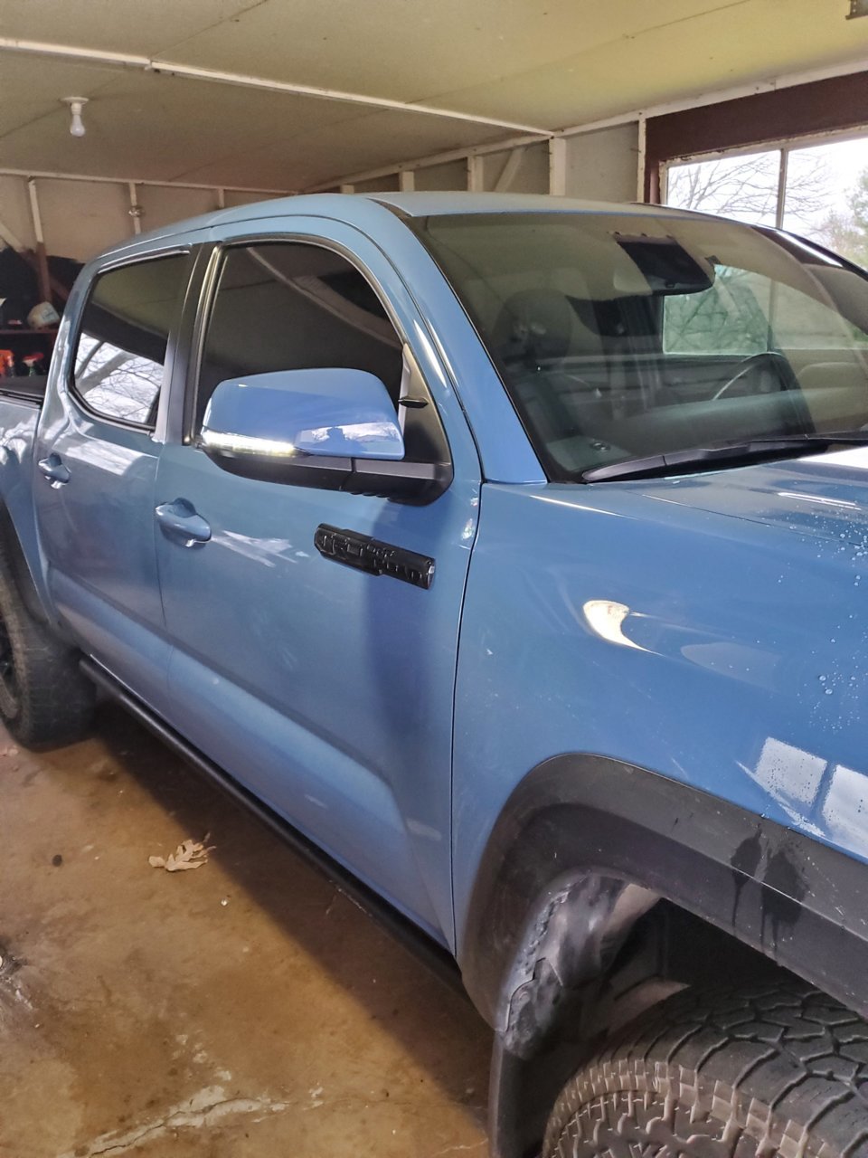

  3. Nov 21, 2021 at 11:50 AM
    #243
    Shades_Of_Red
    Shades_Of_Red Well-Known Member
    May 2, 2009
    #16713
    2,165
    Lou
    Pittsburgh, PA
    2019 Tacoma TRD Off Road Premium Cavalry Blue
    A few.

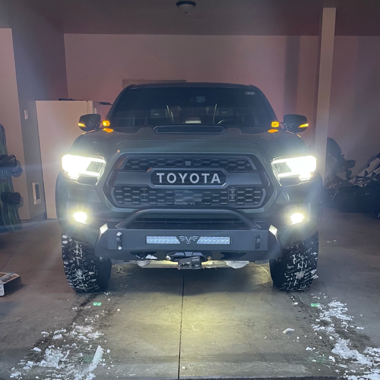

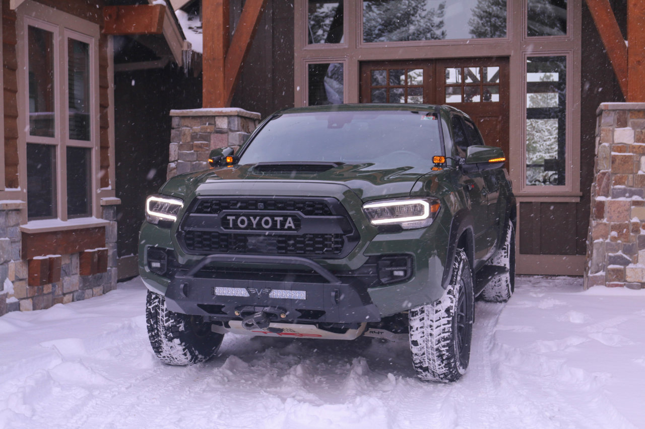

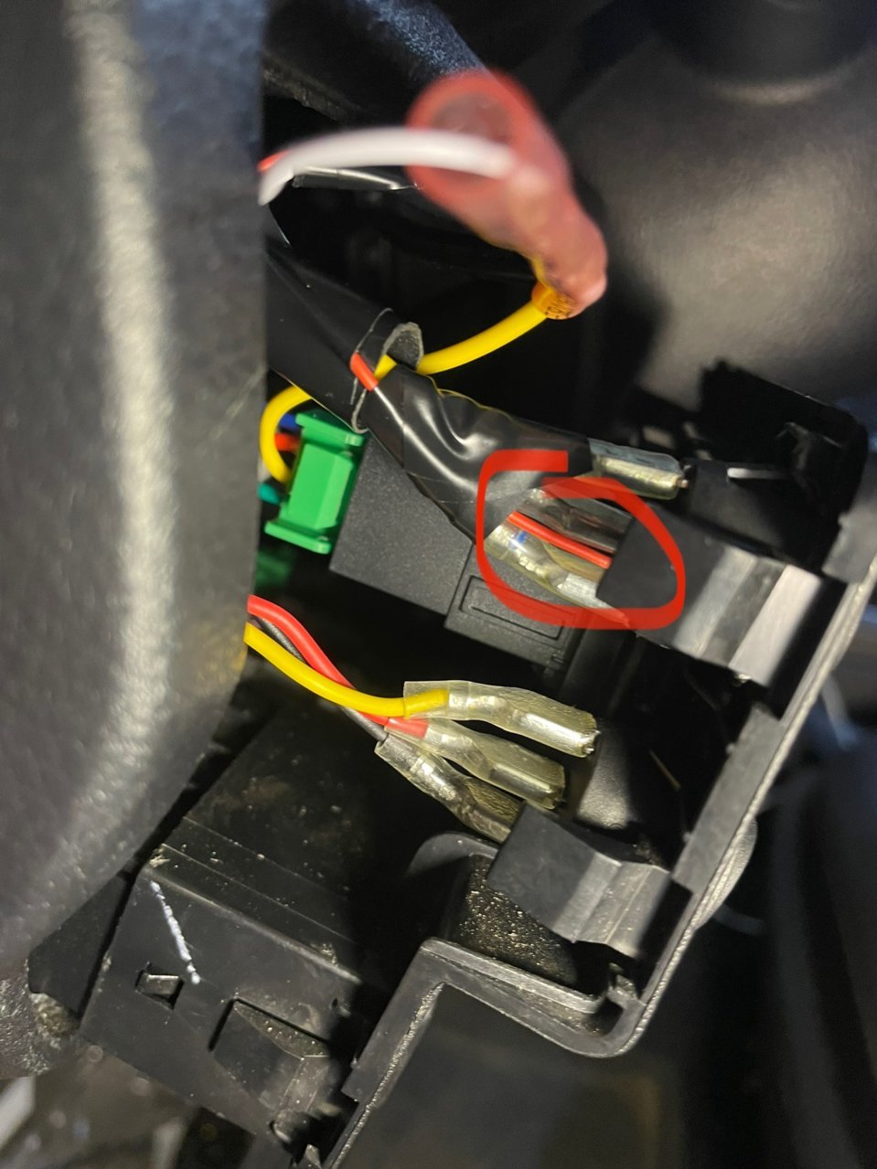

  6. Dec 27, 2021 at 9:14 PM
    #246
    th3clara
    th3clara Well-Known Member
    Jan 2, 2021
    #351455
    157
    Trevor
    Portland, OR
    2020 TRD Pro - Army Green
    RIDE Shocks 255/85r16

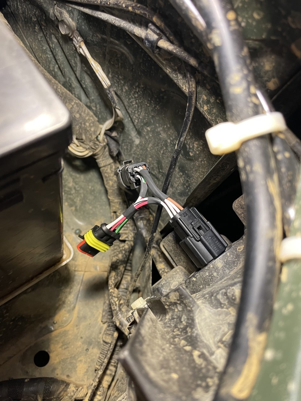

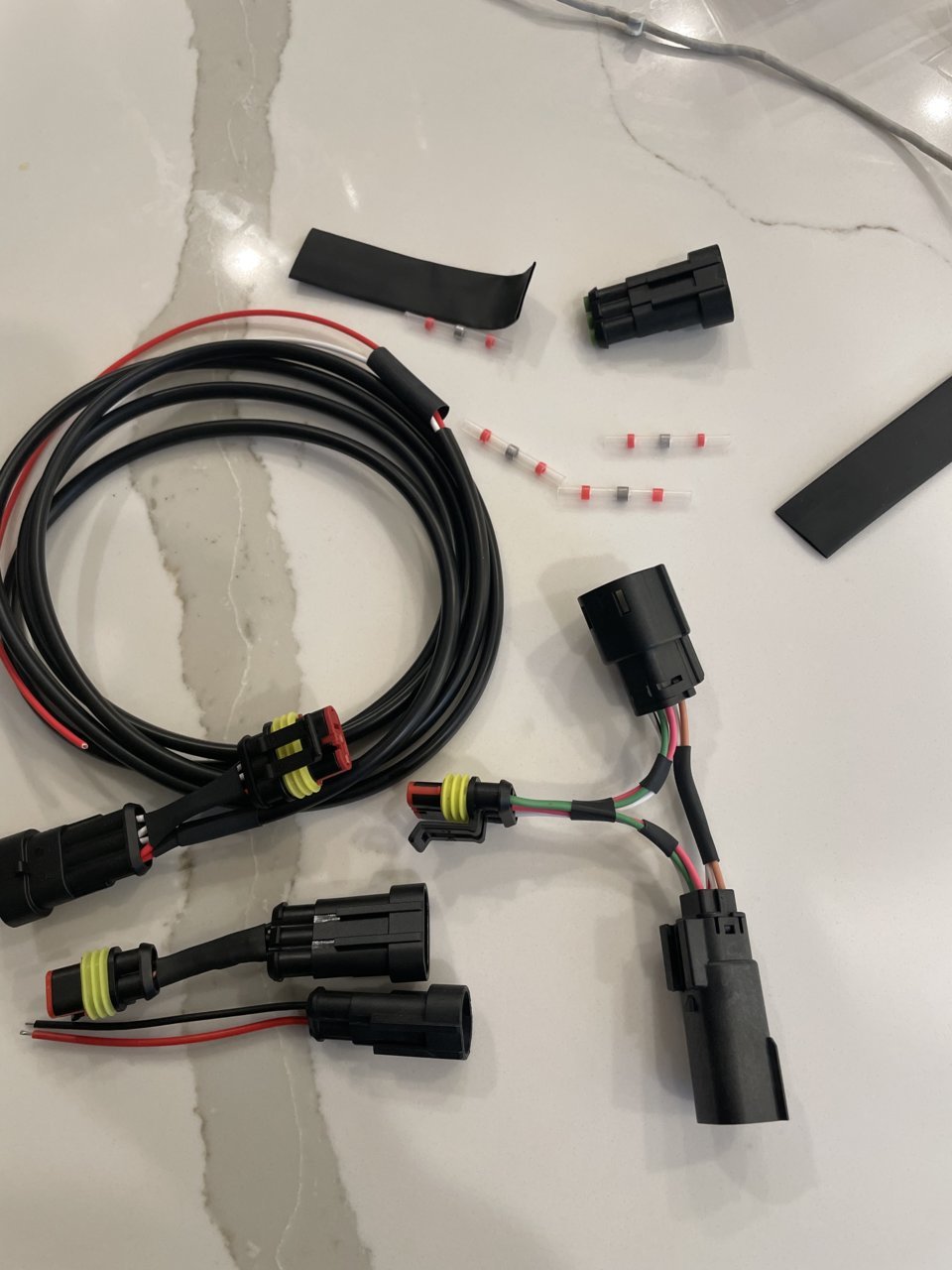

    Recently installed the DRL on the V5 turn signals. Not an easy mod, but so so worth it if you like the look. Went with amber to match the ditch pods backlight, and the amber side marker on the headlights.
    Went with the Plug N Play option that @MESO provides. Wires were ran through the door, cab, and to the driver side headlight. Purchased a T harness from user @daveeasa via this thread.
    Harness connects to the 2020+ LED OEM headlights. I asked for two separate sets of white and red wires coming off this harness, it is sold as the 'Raptor light option' in the link above. My setup has one set of red and white wires going to the two mirror turn signals, the other goes to the backlight feature on the SSC2 ditch pods.
    The SSC2 pods and DRL turn signals go on and off with the headlight control on the steering wheel. Mirror lights also dim when in park, or at night. Super happy with the functionality of this turn signal design and the brightness.

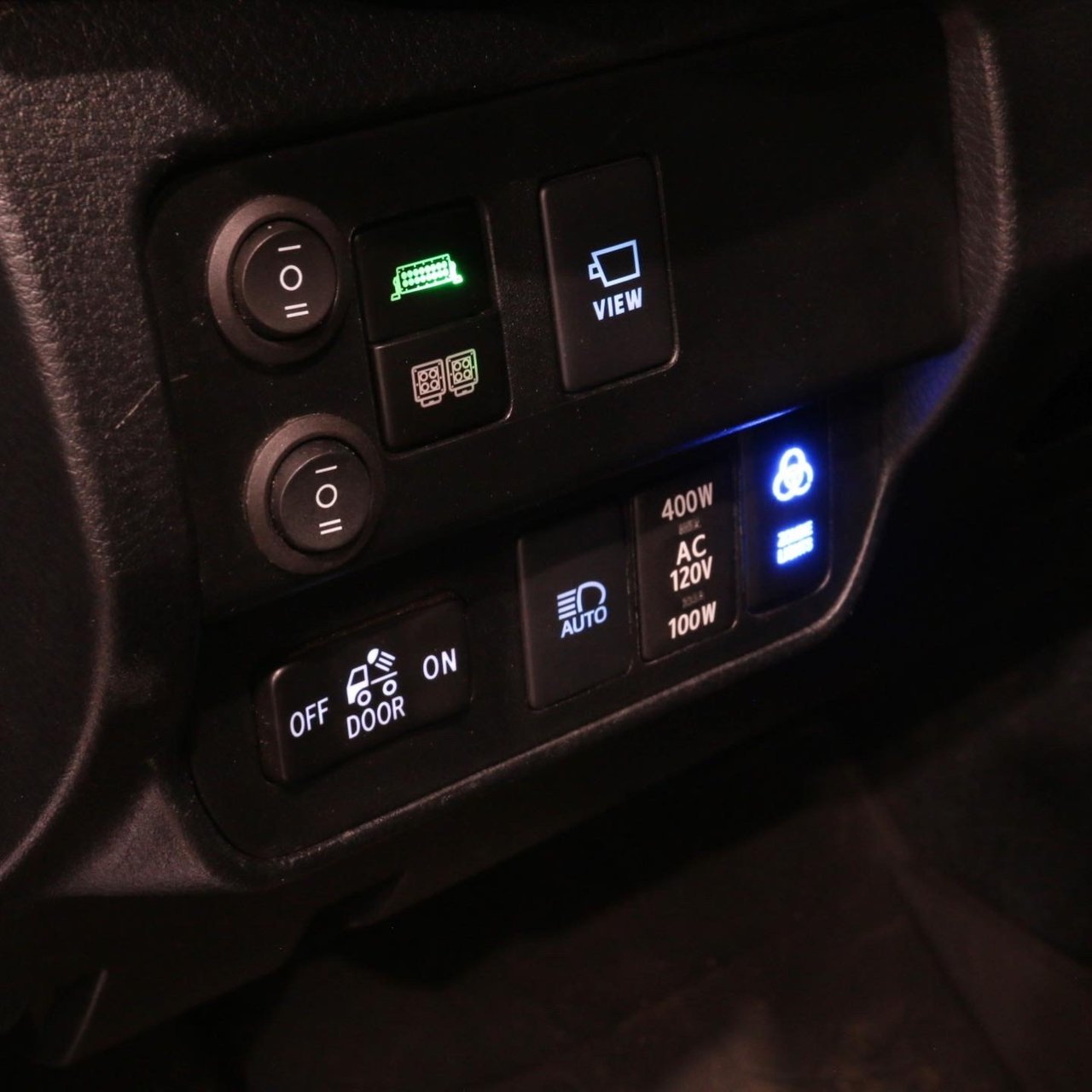

    I wanted the ability to turn the SSC2 backlight on when the vehicle was off (DRL off). I ran the extra 'raptor light' harness into the cab, and connected it onto the dual switch that Diode Dynamics sells. DRL and dual switch are touching the same wire that goes to the relay to trigger the SSC2 backlight.

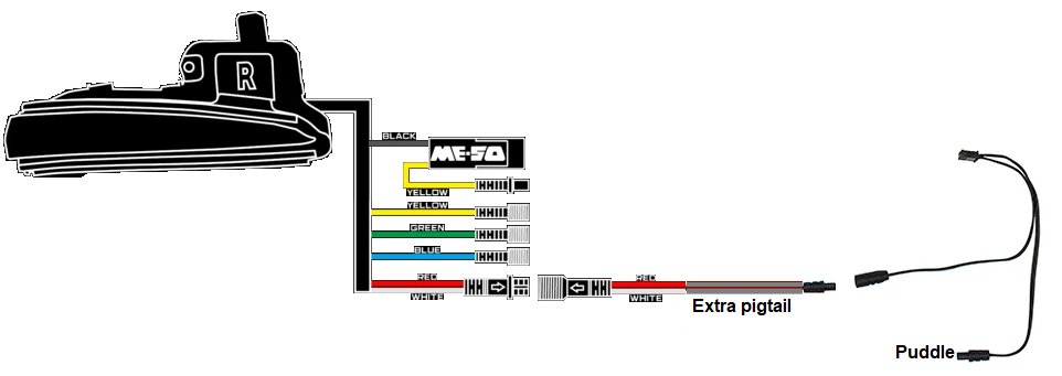

    Question . So if you already had the puddle pods with the puddle pod switch , isn't the new drl v5 just plug and play ? Mine got delivered today
  13. Jan 7, 2022 at 6:31 PM
    #253
    ChrisIz
    ChrisIz Well-Known Member
    Apr 12, 2020
    #324524
    580
    Texas
    2023 TRD Off-road
    plug and play if you ran the extra pigtail to the mirror assembly, otherwise you will need to remove the door panel again.

  16. Jan 8, 2022 at 12:06 PM
    #256
    Invid
    Invid Well-Known Member
    Dec 18, 2015
    #172581
    1,075
    New Braunfels, Texas
    2016 Tacoma Limited
    .... and purchased! My v1 are still going strong but now they will make someone else happy.
    hyrule_trd and Tacospike like this.
  17. Jan 8, 2022 at 4:00 PM
    #257
    shotgunbilly420
    shotgunbilly420 OG Owner 249+ mi club/Tacoma enthusiast
    Jul 10, 2018
    #258947
    3,327
    Montesano, Washington elv. 66ft
    2017 trd Tacoma offraod AT Inferno
    315/75/16, 6in modded RC lift,Anderson Engineering manifold spacer,K&N air intake, URD YPipe, stock exhaust ,16" method nv305 wheels, AFE throttle body spacer, vf Tune program, JTL 3.0 Oil catch can x2, rear cat delete
    So when I connect to puddle pods extra pigtail my v5 illuminated amber ??? I ordered white drls.
  18. Jan 8, 2022 at 4:08 PM
    #258
    shotgunbilly420
    Jul 10, 2018
    #258947
    3,327
    And also from reading this , there is a harness I'm missing that I should have asked for that I didn't know about for the puddle pods pig tail
