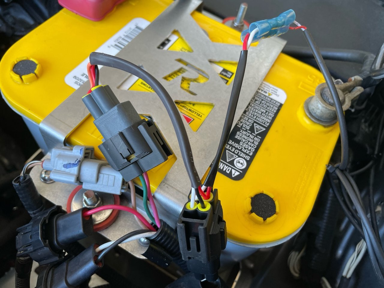

    Just as a note, when I was testing, vehicle engine was off and parking brake on. I just pressed the start button twice to test. Then I tested with vehicle engine off and parking brake off, same results.
    Does car engine have to be running as well? I will try this after work in the evening.

    mokeiko Active Member
    Apr 16, 2017

    Not 100% sure, I defer to Caribe, but the DRL on your headlights being bright should be clear and obvious and that tells you you have the right DRL signal.
    It's possible I gave you a v5 T harness which has the DRL tapped off ground by mistake? That would make me really really sad. Clear photos might help. I would have to be a big time idiot to mess that up.

    Meso's harness pig tail wiring has a red and white wire so I'm assuming the red and white wire from the v5's connect to each color appropriately. Post #116 photo lower right shows the harness I received.

    What did you do to get the Halogen DRL to transfer the input to the LED headlights? There are a few things to tweak to get it to work correctly. @Puppypunter

    That does not fix the DRL issue, unless you had LED DRL's with the Halogen headlights.

    @mokeiko, if the V5 stay on one illuminated feature of the DRL part, I think that maybe they are getting only one input. Maybe a bad wire tap or terminal in the harness to the headlights.

    Do you think it’s safe take the v5’s red wire and touch the battery + post and then do the v5’s white wire after to see if there’s a brightness change?

    This is OK to do, though it's a slight bit better if you can somehow stick a 5 amp fuse on it just in case, even you just twist wires and electrical tape it. A short jumper with inline fuse from battery post to butt connector probe might be worth the time to build for troubleshooting.
    I have a yellow top as well.
    DRL T looks good, you heard an audible click when securing it to both connectors? And I assume the driver headlight functions as you expect, the C is bright in DRL and Park, dim in low and high beam settings, OFF when stalk is off?
    From the butt connectors through the firewall I only see one pair of red/white so at some point you join that to the two mirror signals? In the driver kick panel? Can you get a photo of that?
    So far nothing in the photos stands out as a problem to me, everything looks as expected.
    yes
    yes, passenger side didn't have enough slack to reach driver side headlight.
    I will take the photos as soon as i can
