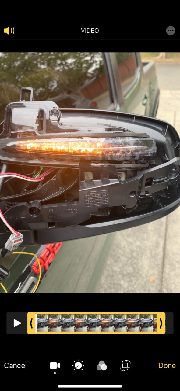

    Just went to install mine, but after reading all the posts about LEDs being out on the drivers side I did a test before ripping everything out. Last 4 LEDs aren’t working……1A7577A3-4895-4029-95A8-38007D903B82.jpg

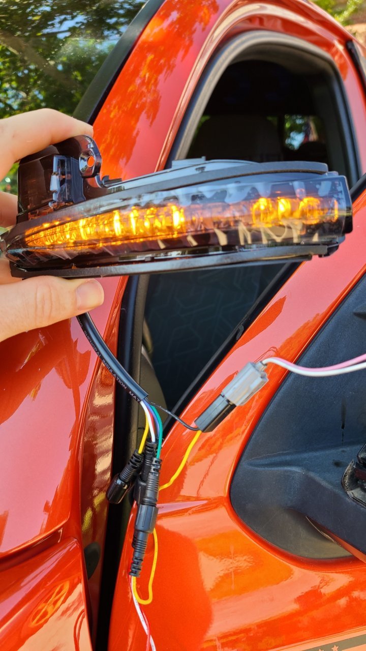

    Looks to be common. Drivers side here as well. These are whites. Will check ambers before putting everything back together.

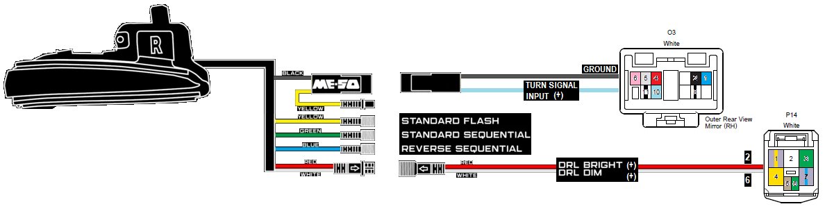

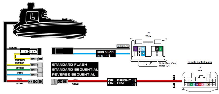

    On the DRL wires, the issue is the size of the wires to tap and the fact that when Panel/Parking circuit is selected, you loose Bright.
    The T harness at the headlight prevents this. Places the V5 DRL inputs in parallel with the headlights.

    So just to confirm here as I am not a smart man. Taping these wires in the pictured harness/connectors will make the DRL function of the lights work at FULL bright when the ignition is turned on?
    If I want to tap these wires, what's the best type of "tap" to purchase?

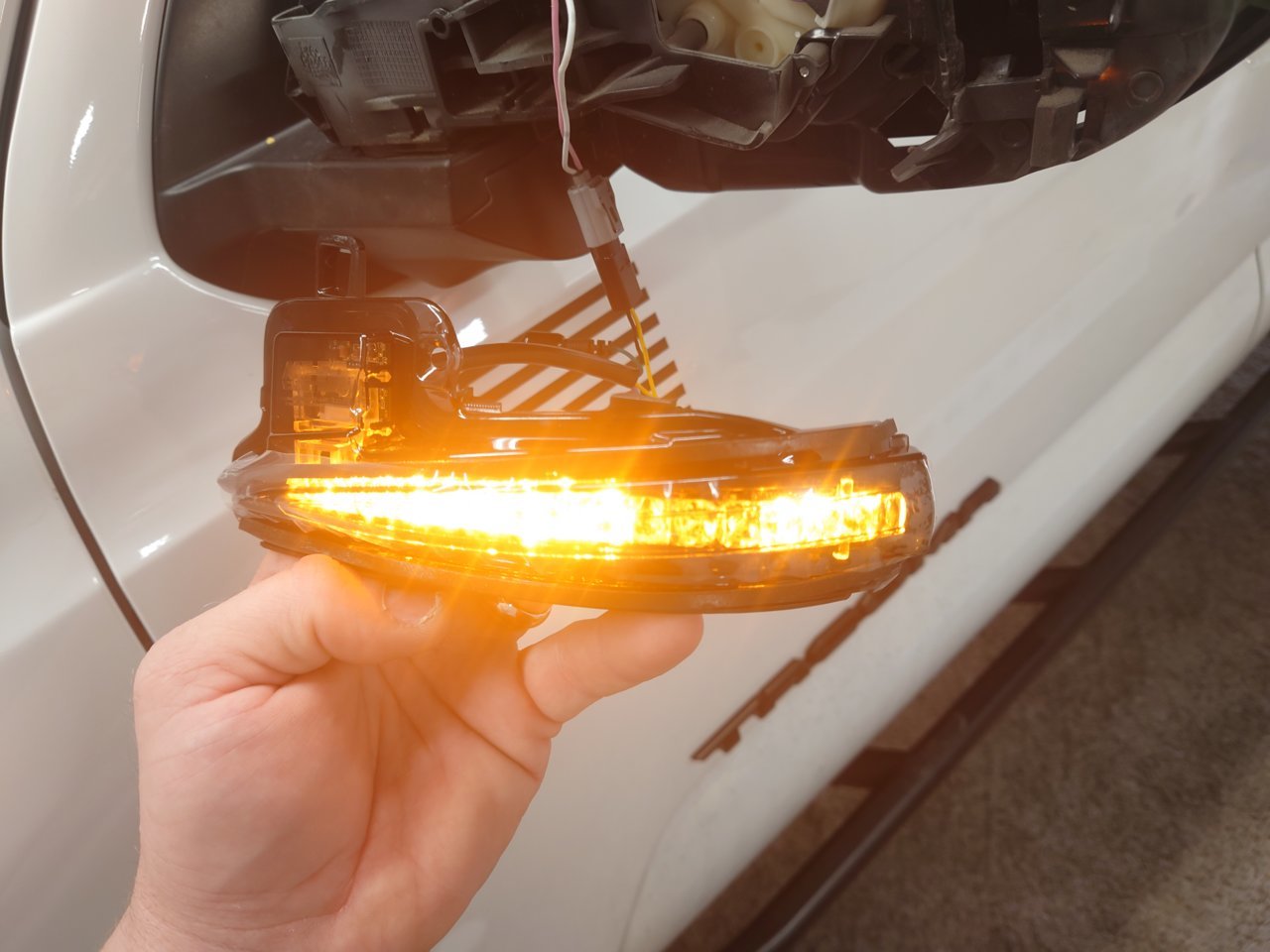

    Looks like I also received one of the driver side assemblies with three burned out amber LEDs (white DRL w/ amber turn) :(
    I didn't even test the white DRLs. I just boxed them back up when I noticed the burnt out ambers and sent a warranty claim to Meso. Fingers crossed that this can be remedied quickly, as it seems like many are having this issue. I honestly expected better QC from Morimoto on the LED panels.

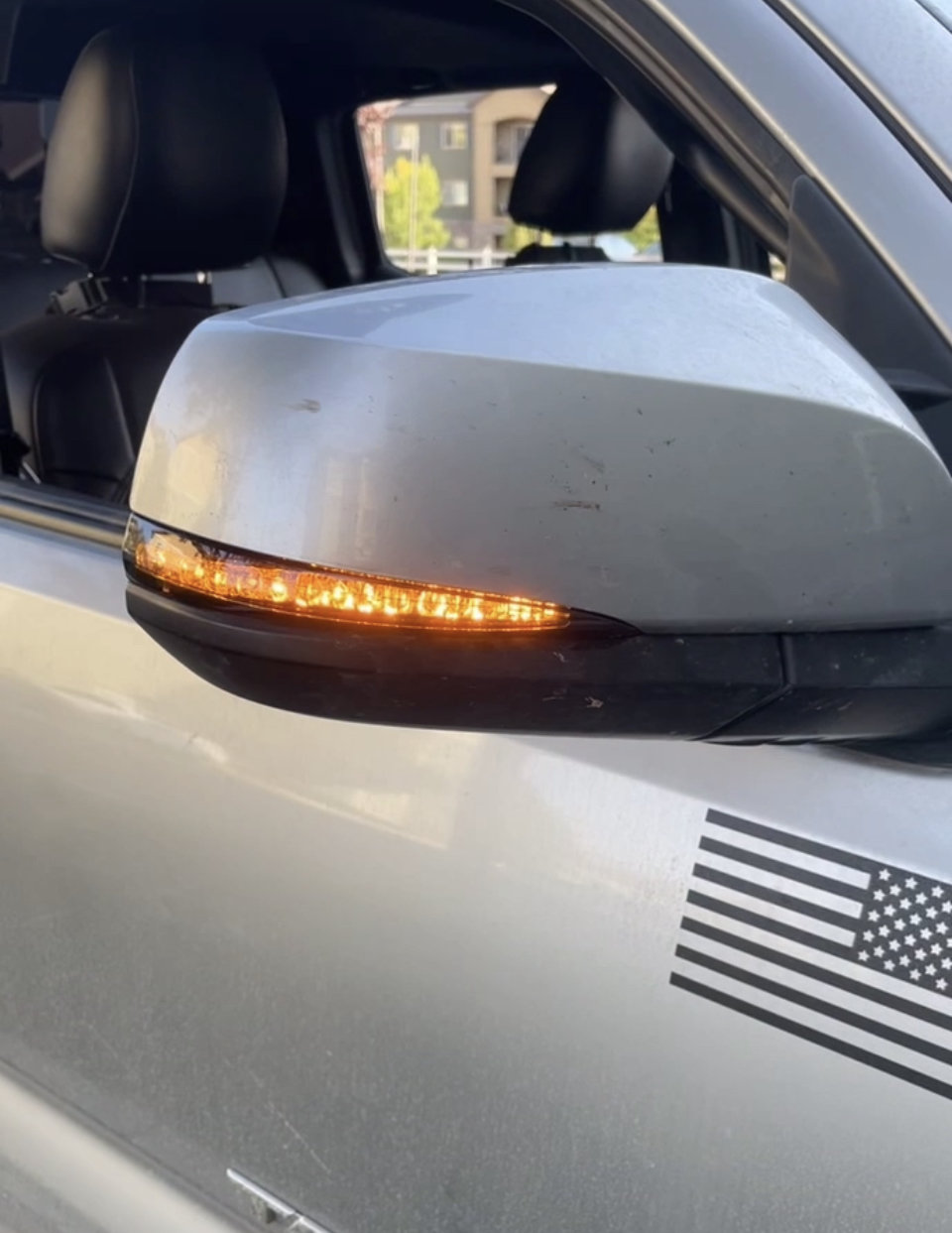

    He’s posted about it in the main Ultimate V5 thread. Send in a warranty claim and he’ll get you taken care of.
    also just got mine installed. Amber/amber and all are working.

    Where did you tap the input? What did you use? 3M type?

    did this come with the v5s or did you have to add it? I saw that there was a harness for non-led headlights but didn’t realize there was an option for connectors for the puddle pod harness/connector.

    According to him, (I don't know if the kit is his), it's included.
