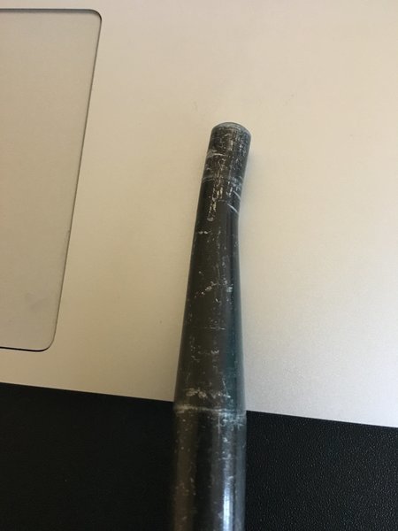

    Yea mine were relatively hard to adjust also.. bent the T handle
    I have to take my coils all the way out to adjust them:anonymous:

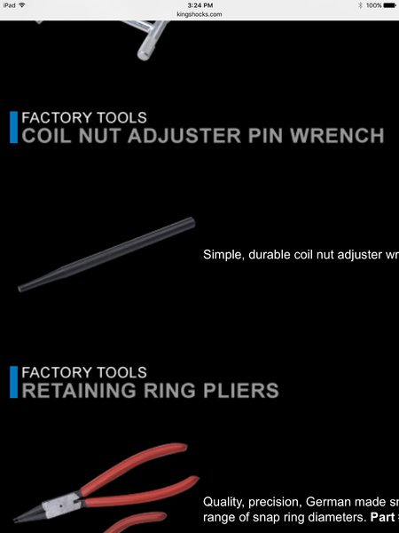

    ...well...you were not using the right tool buddy, I have never had a single problem using that actual King punch tool and a squirt of WD silly cone spray. The King punch is milled to the exact right size and it's hardened steel / prob chromoly. The tool is 4 years old and still perfectly straight and none of the holes in my collar and disfigured either. That King punch tool is prob a foot long and it gives you plenty of leverage to turn the collar. I've probably adjust my fronts 20 times over the years and always on the truck.

    This is the tool you guys should be using :

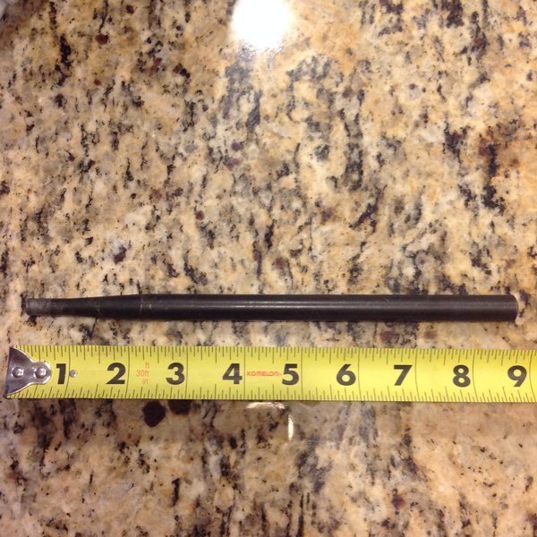

    Here is actual size, it is beefy...no way in hell you are ever going to bend this thing

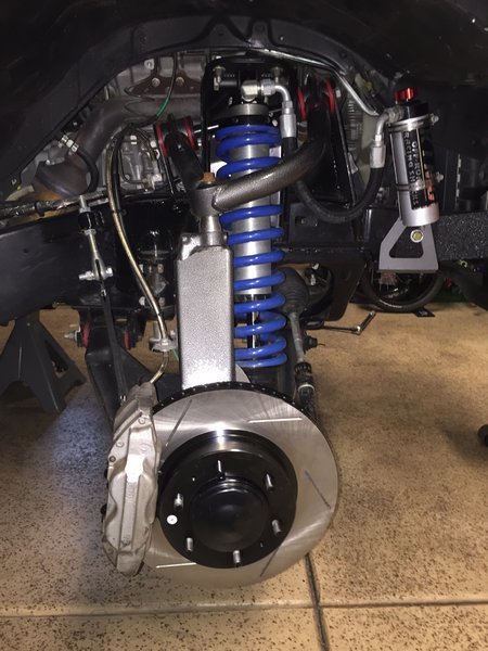

    ...if you have the previous generation of Kings the next time you rebuild your CO's swap out the hose fittings like this makes t a lot easier too :

    Thats what it got bent on.. a buddies #700 coils.. and yes the set screw was loosened (but not too much)
    With the actual king spanner wrench it was cake
    But the king punch tool worked fine for my coils... #600
