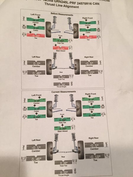

    You never said specifically what is out of whack?
    If it's camber, something is bent.
    If it's toe (positive on both sides or negative on both sides), something is bent.
    IF it's toe (positive on one side, negative on the other which causes a dog-leg while driving) then it's just not centered. If the packs are oriented correct (front to rear), most the time you can recenter on your own. Just jack up the rear of the truck and rest on jack stands by the FRAME. Let the axle float freely and loosen all the ubolts so you get some wiggle room. Give it a good shake and tighten all the u-bolts back up.

    Toe is out.. I have so much droop that I don't think my jack stands can go high enough to free float the rear, i'll have to use a car lift. Thanks though that definitely helps!

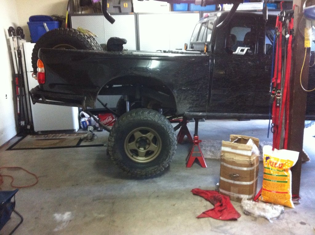

    Jack under the axle, remove the rear wheels and let the truck down on the jack stands under the frame. I have so much droop that I cannot put mine on jack stands either unless I remove the wheels

    Yeah that's a dog leg. Borrow or buy some bigger stands or get creative with 12x12 concrete blocks or wood. Also take your tires off so the axle is easier to manipulate and you get more clearance to the floor on droop.
    If I can droop out my truck in my garage, I'm sure you can as well. 12 tons FTW

    Oh duh thats true :facepalm: how do I know when its centered?

    You won't unless you build a string box. But the majority of the time, you just need to loosen, shake, tighten.
