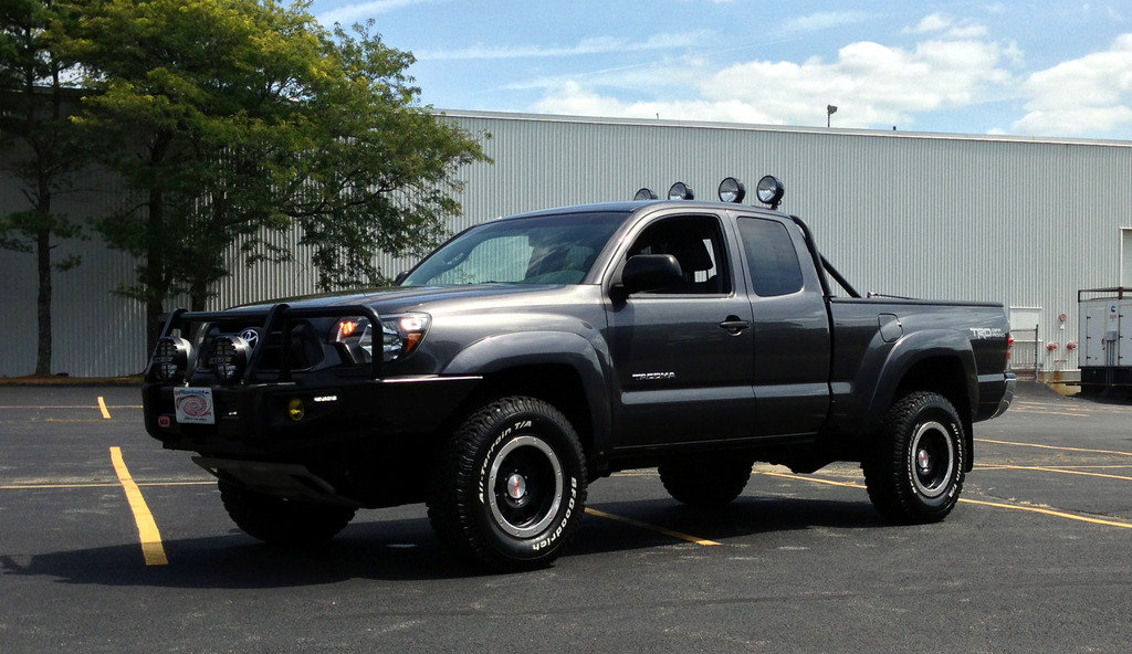

    - ARB Deluxe Bumper
    - ARB Optional Fog Lamps
    - Lamin-X yellow film

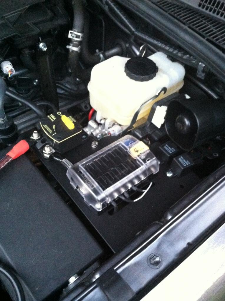

    - toolblutacoma06 fuse panel plate
    - Blue Sea 12 slot fuse panel
    - Blue Sea 100A circuit breaker

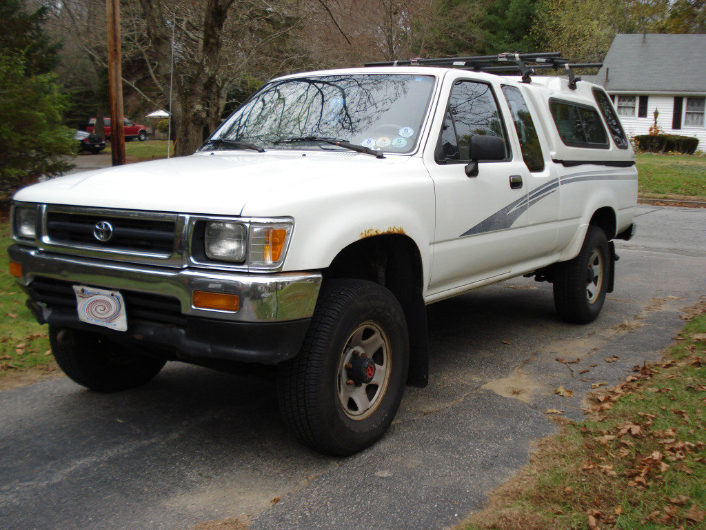

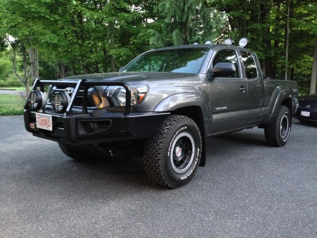

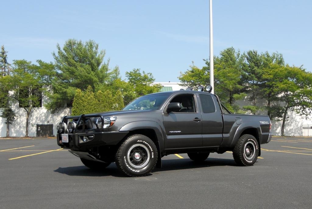

    So, now that I've spelled out where the truck is at, a little more background. My first Toyota, the aforementioned 93 started out like this:
    Ended up like this:
    As you can see...that was very much the inspiration for my Tacoma...as well as the always popular Marty McFly Xtracab from Back to the Future (hence the user name).

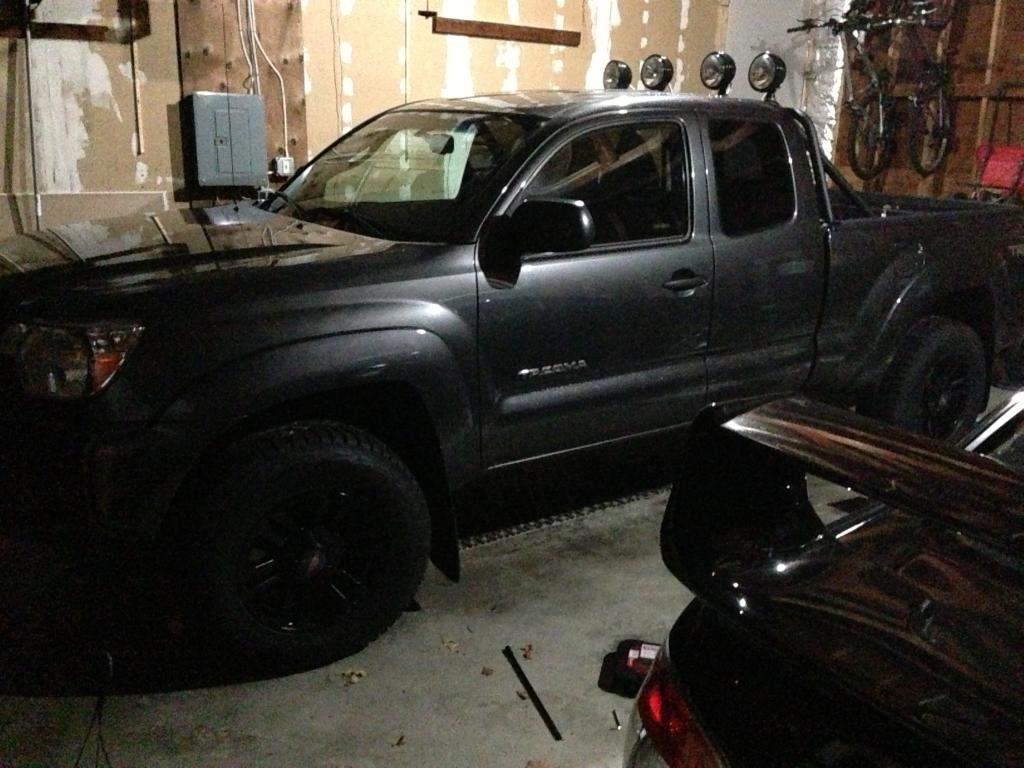

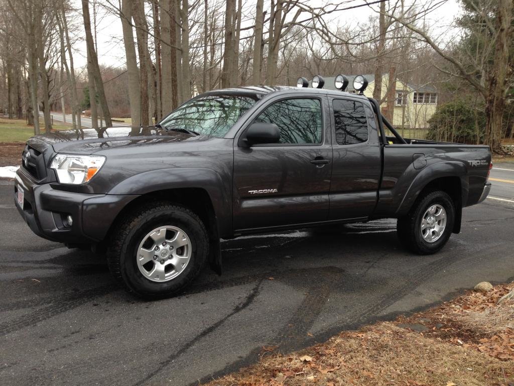

    In November 2012 I took deliver of this:
    which was a gleaming new 2013 Tacoma TRD Off-Road in Magnetic Gray Metallic. I was back and forth between that model and the TRD Baja, as well as back and forth between the 6MT and 5AT. I knew I didn't want a black truck having dealt with a black car and the pain of trying to keep it clean and scratch free, so I was looking between the red of the Baja and the gray of the Off-Road. Ultimately gray won out with the hope of getting the Baja TRD Beadlocks. I finally settled on the 5AT after reading reviews of the 6MT and caving a bit to the pressure of family who can't drive stick.

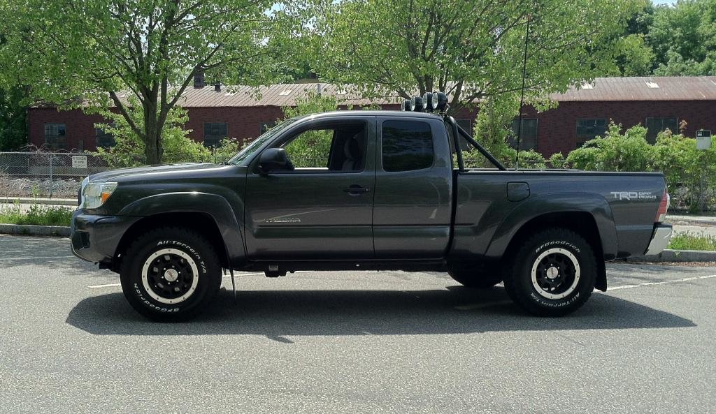

    My initial plan was to purchase the TRD Baja wheels but I kept hitting dead ends, even after trying to bribe the local parts counter guy to order me a set. I was able to secure a set of four of the black beadlocks from TRDParts4U which worked well enough for me.
    I swapped over to those wheels with a set of BF Goodrich All-Terrains in 265/75-16 and resold my OEM set for $840 - score! Truck was at 843 miles when I did it a few weeks before Christmas. So, so worth it.
    I saw a member on here post a picture of his Tacoma with a Marty McFly style light bar. At the time he wasn't able to post who made it but I spent hours upon hours trying to figure out who built the truck until I figured out it was N-Fab. Multiple emails to the member's contact @ N-Fab went unanswered until I emailed the owner of N-Fab himself to get a hold of someone to sell me the bar. After the headache that was ordering that (I literally had to mail a check...so annoying) and dealing with the long shipping times, etc, etc, I actually finally got the bar. While I was waiting I had a member on here build me a fuse panel to house a circuit breaker and fuse panel for the auxiliary lighting I hoped to run. I also found out that Tundra-Part.com made switches that fit under the HVAC I could use to run the lights.
    As the year wore on I decided for the winter the All-Terrains weren't the best choice for slippery surfaces as I had a habit of having them lose traction on bumps with the Off-Road's touchy brake system. I also didn't want to deal with ruining the Beadlocks with salt.
    I purchased a set of winter tires and wheels, which were Hankook I-Pike RW11's in 265/70-16 mounted on MB TKOs in 16x8.5 in matte black. At first I was really excited to get the wheels and tires on the truck but once I actually got them on, I didn't really like how they looked. The Hankooks weren't an aggressive looking tire and the low offset of the MB wheels made the whole setup look strange. I had seen those wheels on knobby AT/MT tires with white lettering and I thought it looked great, but on my truck, not so much.
    I started searching around for a replacement set of wheels that were more OEM looking. Originally I wanted either Ivan Stewart wheels or even a set of the accessory "Baja" wheels to run, but I stumbled across a set of near mint Off-Road wheels for $140 including OEM lugnuts. The MBs were sold for $350 which netted a quick $100 profit after dismounting and mounting costs. I used that to purchase a Flyzeye V1 unit and a Gilmour Foaming gun.
    Next came the fun cosmetic stuff. I already had the body colored grille, so I did the BLHM.
    Followed that up with the heavy hits. Got an ARB bumper which really beefed up the front end. Added a set of IPF driving lights to help out on dark roads as well.
    Added the optional fog lamp kit with Hella Optilux bulbs in yellow and put in a Philips DRL kit to fill the gap where ARB wants to put in a set of turn signals I couldn't use on the Tacoma without hacking into the truck wiring. It came out really well.
    Added in a new OEM accessory skid plate this weekend and here we are.

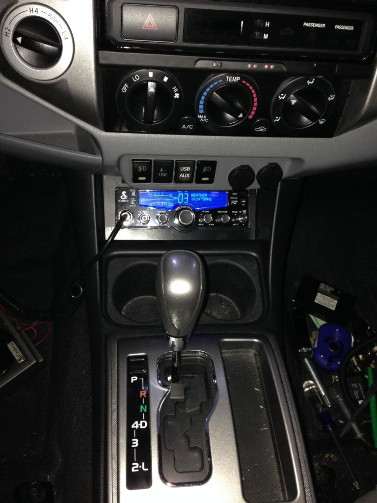

    New CB in the center console with the remote face mod.

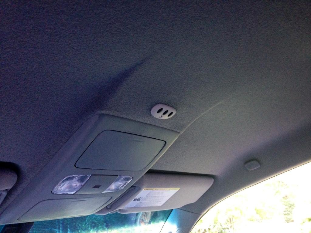

    Homelink in the overhead console.

    I like the CB placement. Do you have any pics of how you mounted it there?
  11. Sep 28, 2014 at 12:45 PM
    MikeyMcFly
    MikeyMcFly [OP] This is heavy, Doc.
    Aug 11, 2012
    #84551
    5,982
    I'm a Masshole
    2016 TRD Off-Road 6MT / 1999 Corvette 6MT
    Building a Broja
    I don't unfortunately. I followed this thread on how to lengthen all the wires from the face. Then I just cut a piece of sheetmetal to fit inside the opening where the cubby was. There is a bit of a lip at the bottom of the console opening that the metal sits on. I used some small L-brackets at the top of the plate and drilled a hole through my console on either side for a pair of #10 screws to go through.
    I hope this helps. It was about 9 hours of soldering, a solid 3 hours or so figuring out the best way to cut the plate, about another hour or so to get it into the truck where it promptly failed the RF Power Output test. Spent another half hour taking it out, another hour trouble shooting it, 2 hours give or take going back and forth with the CB shop who wouldn't work on it and then another hour rechecking every connection (there was over 100) to find the broken wire.
    I'm never taking it out again! It worked though. The only negative if there is one is that using CAT6 cable caused a voltage drop through the unit so I'm only getting a little over 3W of transmit power compared to the ~4W Cobra is allowed to let the unit to transmit. However, I am not looking to use it for long range communication, more keeping tabs on my buddy in front of me when we're at the beach.
