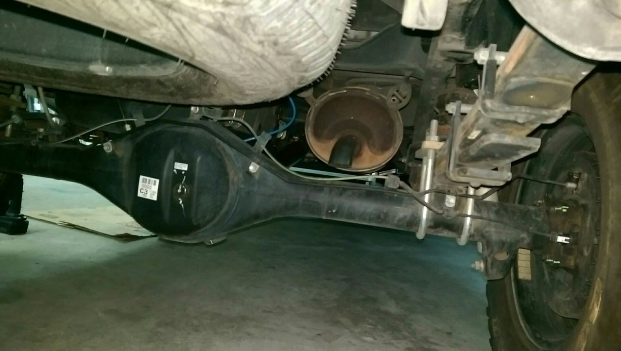

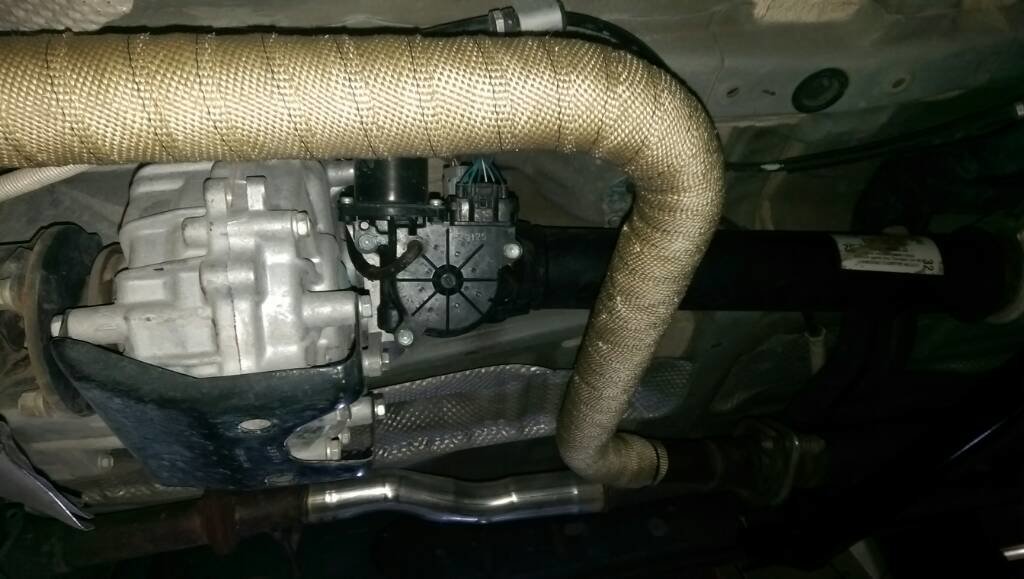

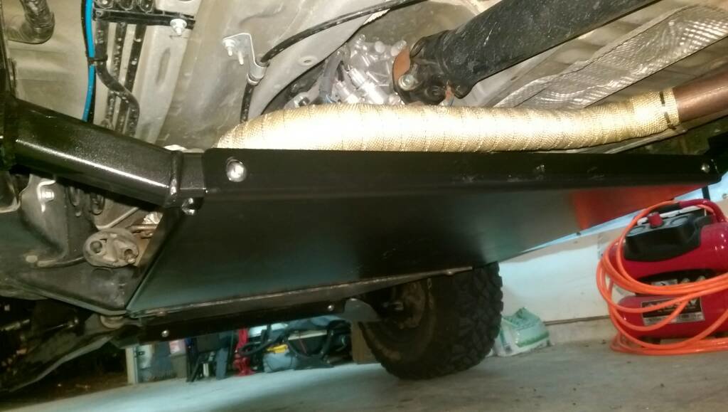

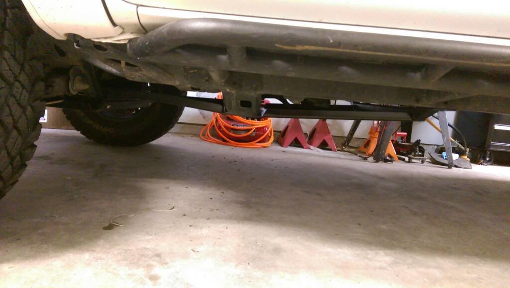

    Exhaust reroute done today plus turn down and got the transfer case skid on.

    That's not a bad price at all. Hopefully, I can get someone around here to do it for that. I've got the same skids - those things are BEEFY.

    I have managed to bend the trans skid quite a bit on both sides...it and the LCA skids take most of the hits. LCA's take the large rocks and the trans skid is where you land when you go down a ledge that turned out to be a little too tall lol
    People say you dont need the LCA skids...and they are right...but they look darn good and things to hit them alot

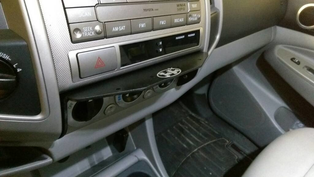

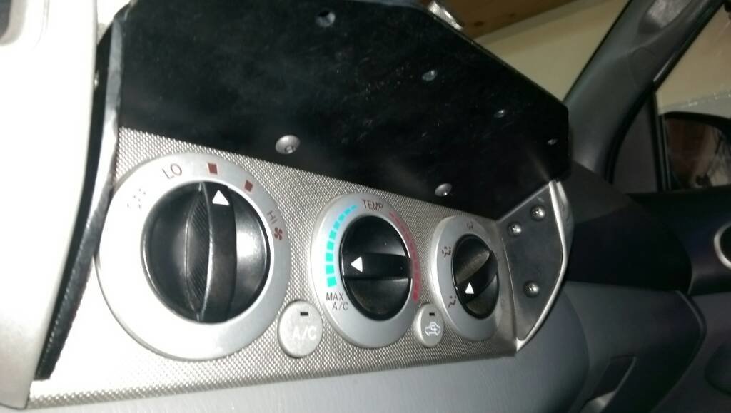

    Installed my Bird Dawg Industries Tech Deck HD today and I have a ram ball to mount on there but no hardware for it :anonymous:. The whole process took about 30 minutes including taking the head unit out to epoxy the blacking plate in.

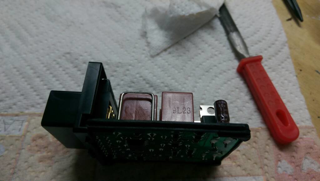

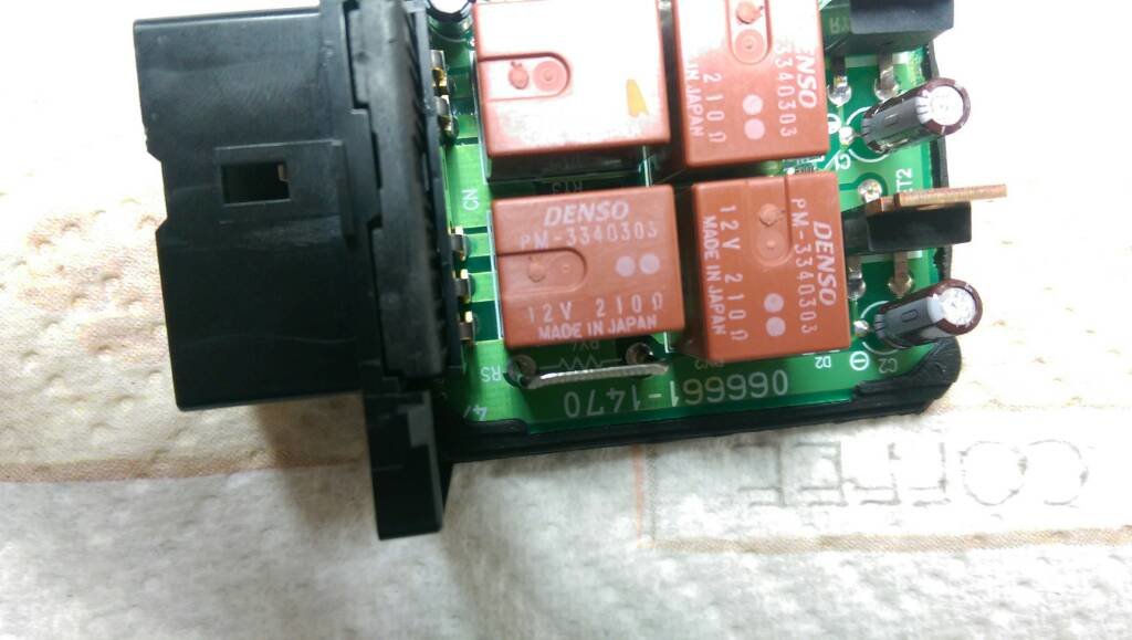

    Installed LED towers in my DTRLs, so had to do the hyperblink mod to the relay. I removed about 2/3 of the thickness of the shunt resistor. Used a small file.
    Works great!

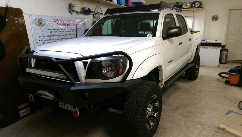

    The Taco now has a hat...Prinsu Cabrac installed.
