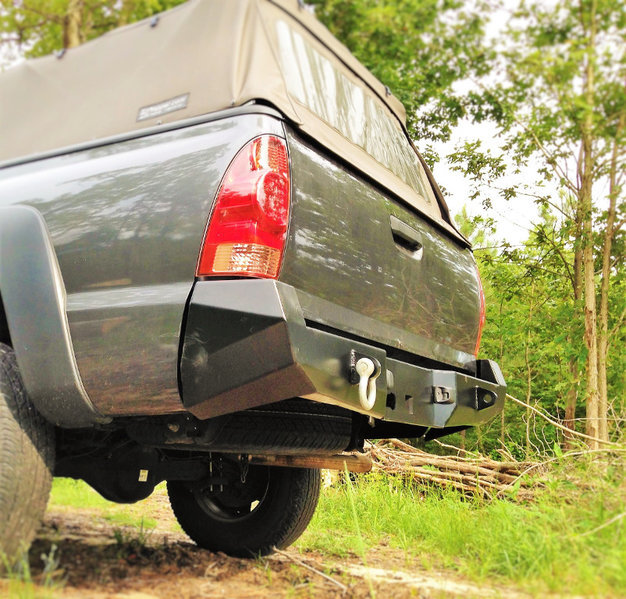

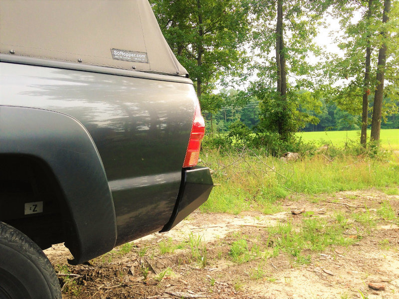

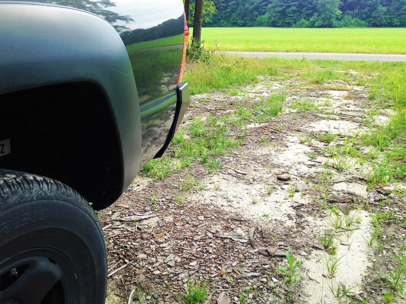

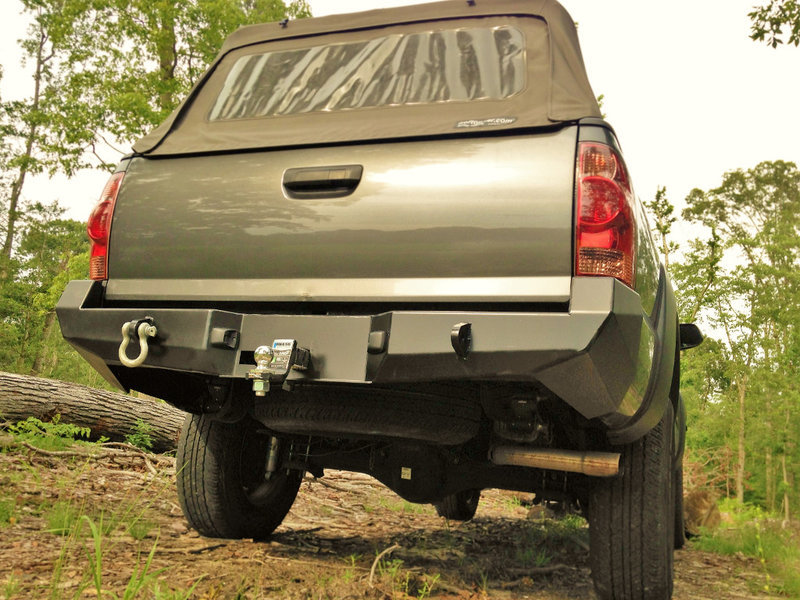

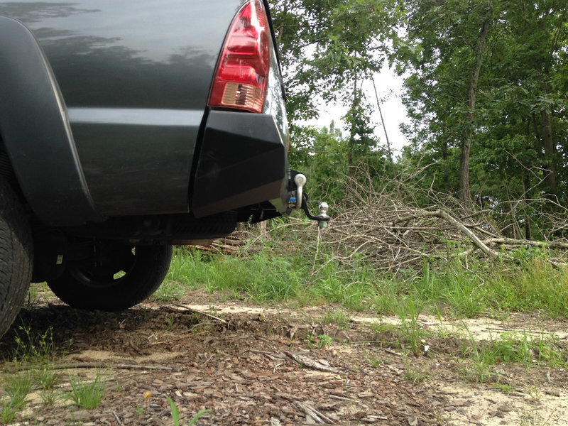

    Mobtown Offroad has their design completed and fabrication has started for a rear plate bumper for the 2nd gen Tacoma. We are making one right now so we can work out any little bugs that may come up so the photos here are what we think it'll be in the end but there may be a minor amount of changes.
    The key features of the bumper are:
    Outer Shell: 3/16" CNC Laser Cut and Formed Plate Steel
    Shackle Points: 3/4" CNC Plasma Cut, pass through the bumper and wrapped around 2-1/2" heavy wall steel tubing for the strongest design on the market to date.
    Hitch: Integrated into the bumper which allows the bumper to tie in to it for maximum strength. The hitch is up in the bumper and passes through where the license plate will be so the depature angle is not effected. The hitch will be built from 2-1/2" heavy wall steel tubing. It also is reinforced in the center with a formed plate and slots for trailer chains.
    Attachment: 1/4" CNC Laser Cut and Formed Plate Steel. Not just a flat, plasma cut plate like most bumpers out there which isn't the best for side pulls. We added two bends on the plate, one goes under the chassis and bolts into the existing factory weld nuts.
    Accessories: High Lift Cutouts, Flip Up License Plate Bracket, will use factory trailer plug and factory license plate lights.

    love how the shackle points wrap around the back of the main bumper tube. :thumbsup:

    Right. Not very strong any other way.

    factory tow hitch compatible? i will also volunteer my truck as tribute.

    Will not be factory tow hitch compatible.
