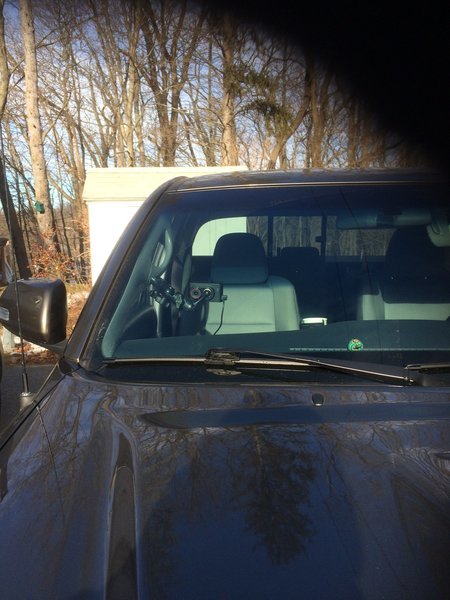

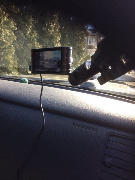

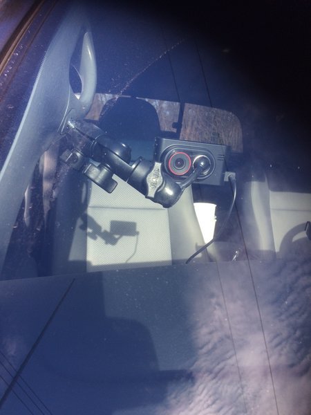

    I Finally got my Dash Cam mounted. It came with a mount that your suppose to glue to the windshield, that wasn't going to happen.
    I'm going to work on it to make it less obtrusive.

    I like that allot.

    Have you seen the thread on the Rearview Mirror windshield mount that some guys on here made? That would be perfect for your dash cam!

    great idea but id be worried about the passenger if the Air bag goes off...

    Thank you for that site. I do like that solution.
