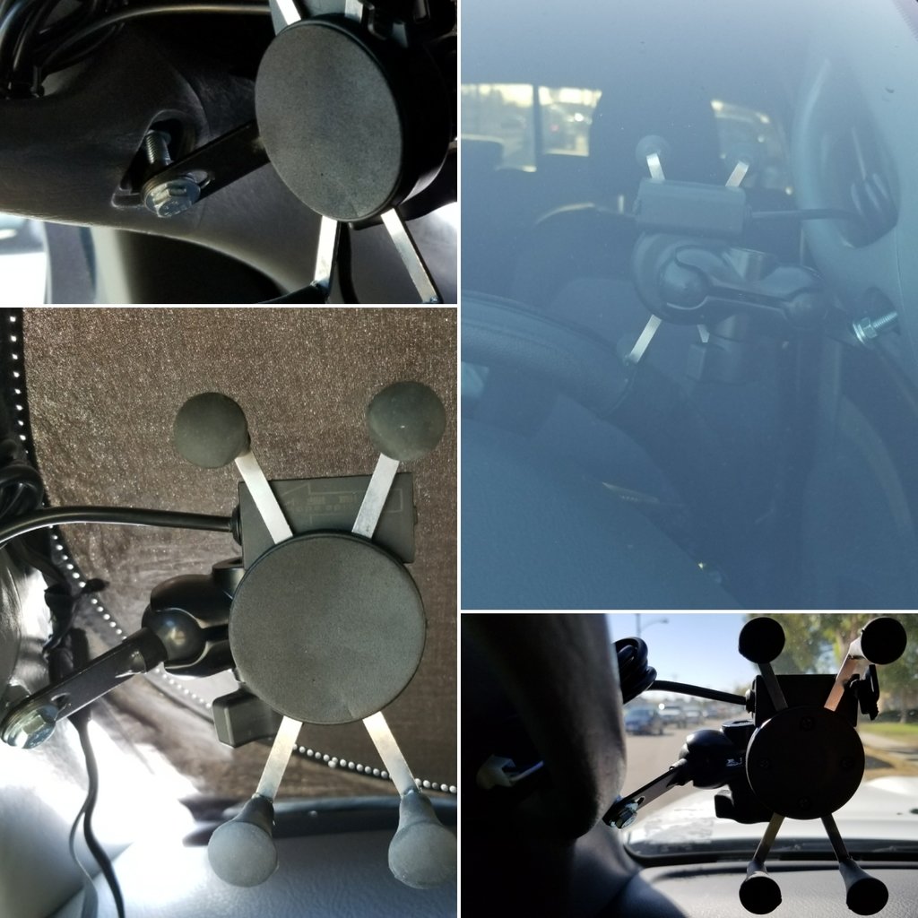

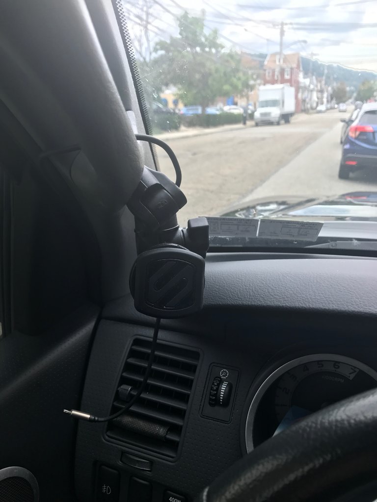

    Did this a while ago, one of my favorite mods for sure. I can't remember exactly which RAM accessory i used but I believe it was actually made as a motorcycle mount. It can be adjusted in many ways. Added the magnetic magic mount as well.

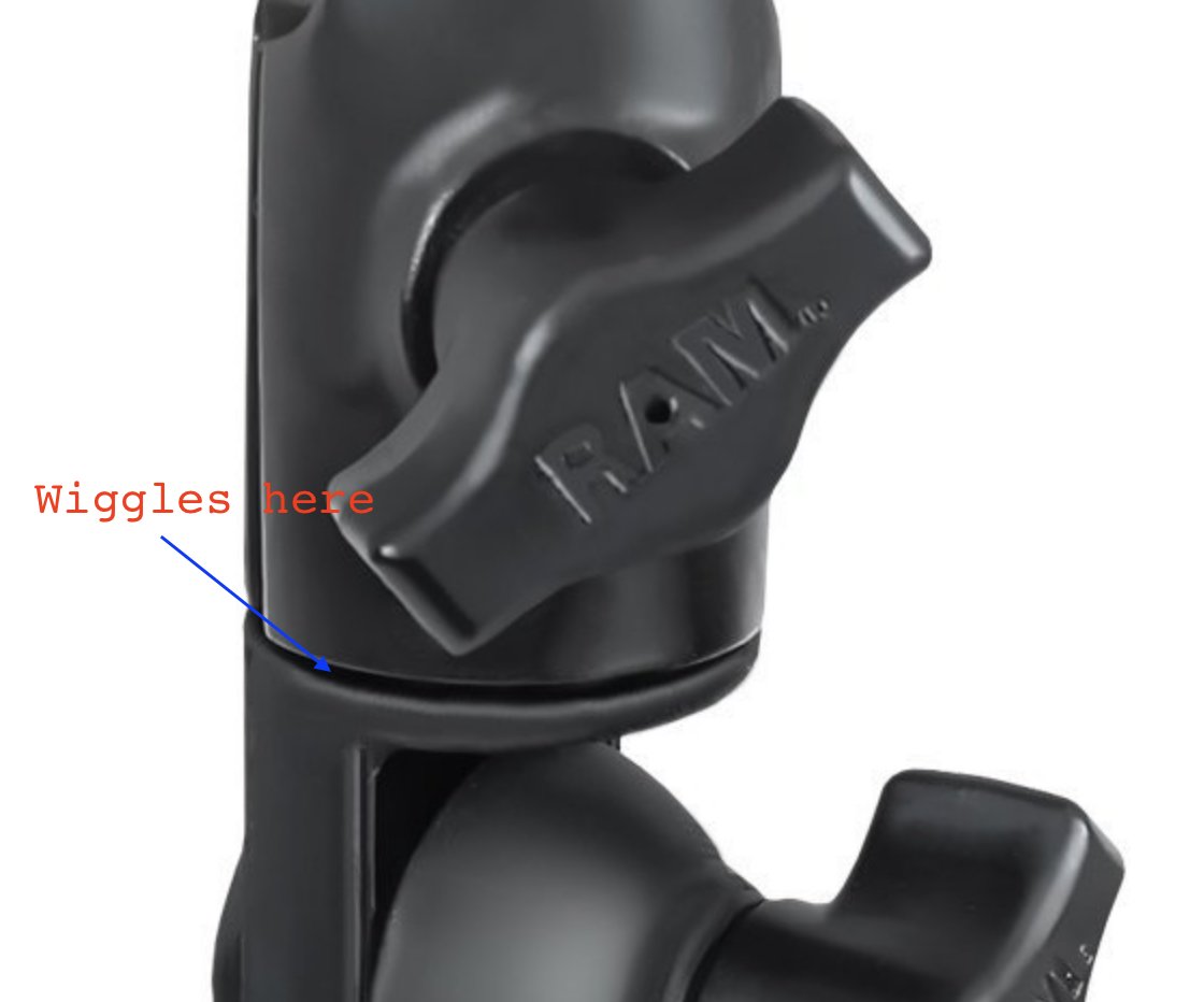

    I picked up a Ram Mount double socket swivel arm this week and installed it. It lets the phone (6Plus) vibrate too much over bumps. The socket/ball ends, even when fully tightened down on the balls, have enough give in them to let the phone vibrate. I went back to the straight arm and less adjustment to escape the aggravation of the vibrations.
    I tried to shim the mating surface where the ball sockets meet up with the central joint piece using o-rings, but that didn't really help. See the attached picture to better illustrate the 'wiggle' area. That said, I'll still end up using this for another project where the vibration isn't an issue. Has anyone else had this problem with a larger phone?

    I went with this knock off mount from groupon for under $10. Just need to wire the built in 2A USB port. Fits my Note 8 in Otterbox Defender case.

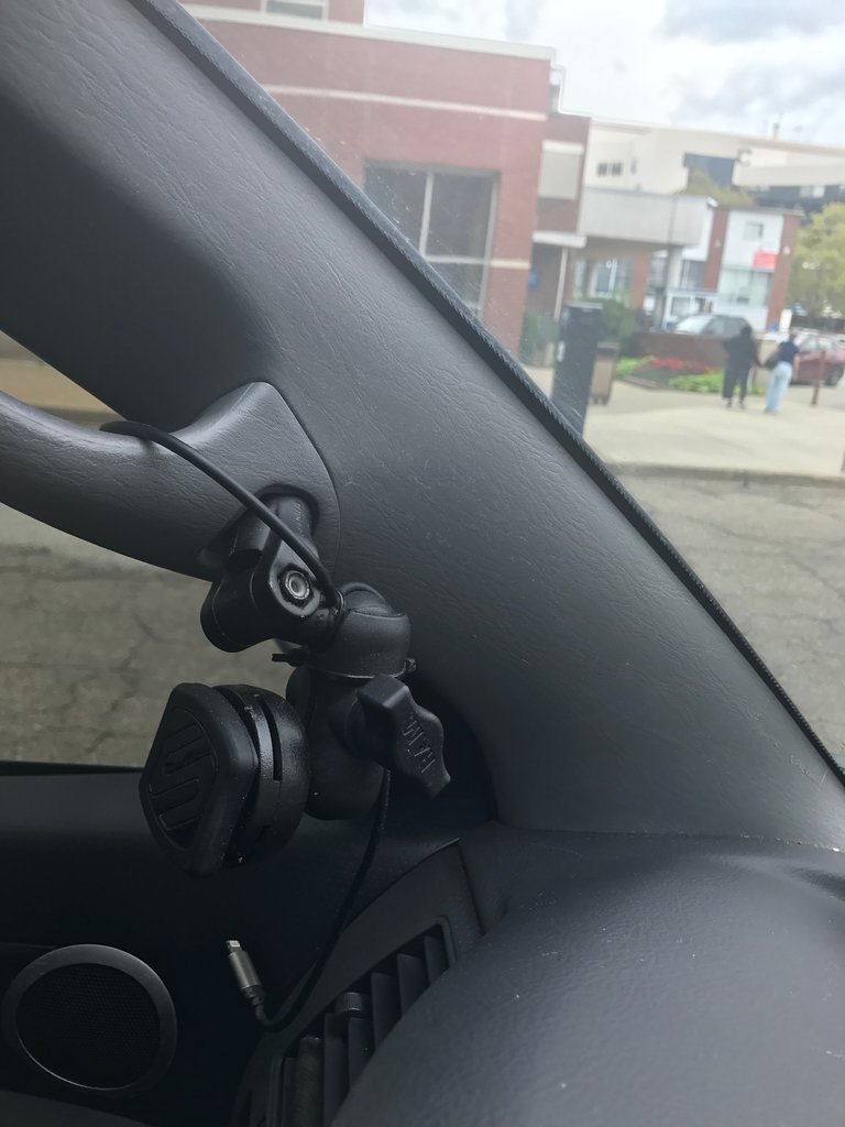

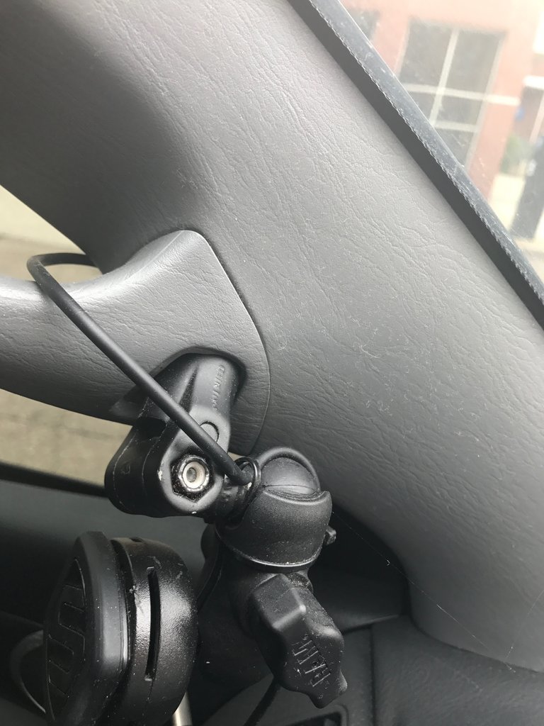

    I want to try this mod, but I'm a bit confused as to how the M6 x 50mm socket head cap screw attaches to the pillar and the ball joint. Do you have a picture of that setup?

    The socket head bolt goes through the center of the ball, resting below the surface, so it does not interfere with the swiveling capabilities. The grab handle on the A pillar is held on with 2 bolts, you remove the lower bolt and replace it with the new longer bolt, which is also holding the ball. Hopefully that helps.

    Ball joint has to be hollow so the M6x50 can pass through to make the connection.

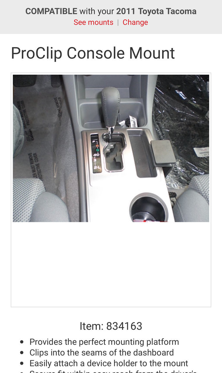

    Assuming your profile is up to date, (2011 Taco) and not a manual...
    https://www.proclipusa.com/vehicle/dashboard-mounts/3856-toyota-tacoma/2011
    Which is just the mount and not the “holder.” You have to click the link and specify which phone model you have.
