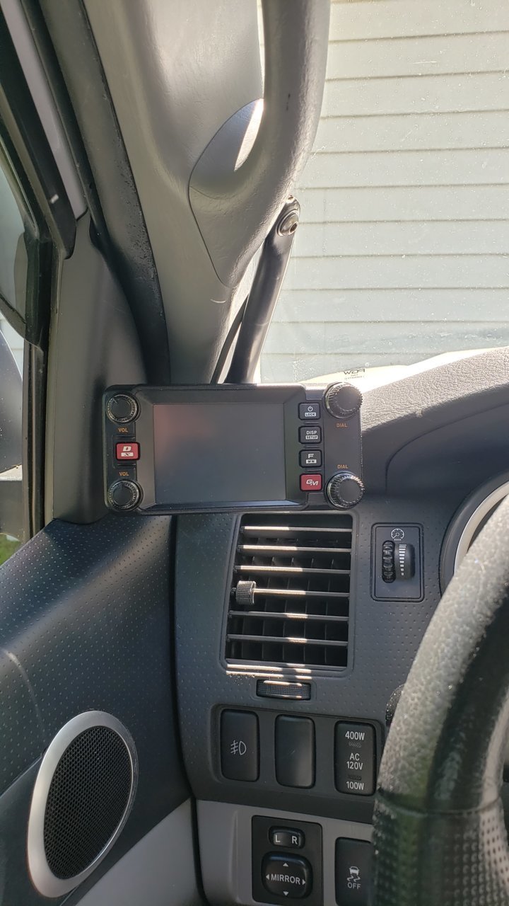

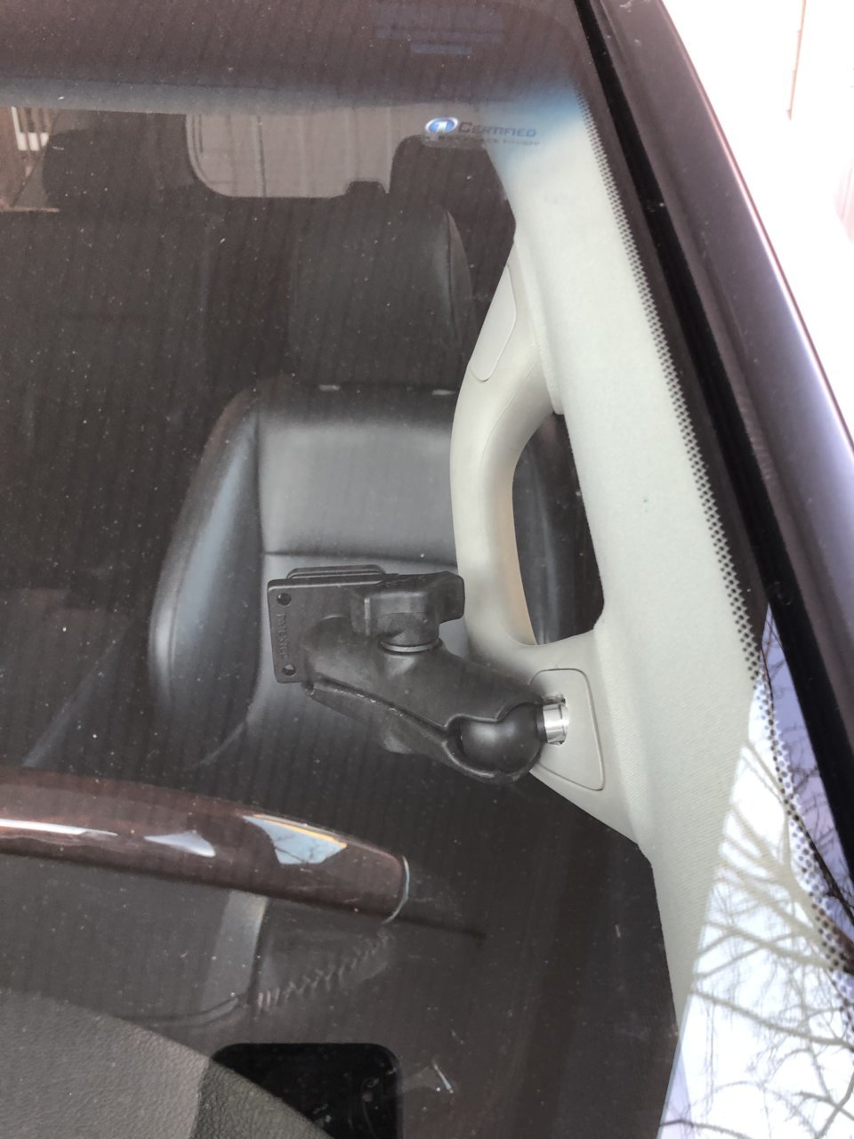

    "Getting out of hand" - Wife
    For those that may care, this mod works on a Lexus GX460 :thumbsup:
    EC317883-1BDD-4834-A7FB-9EDF75C159F6.jpg 564FD9CE-FAFB-47CB-975D-FFC974EE45F2.jpg
    Probably will swap to an articulating arm though

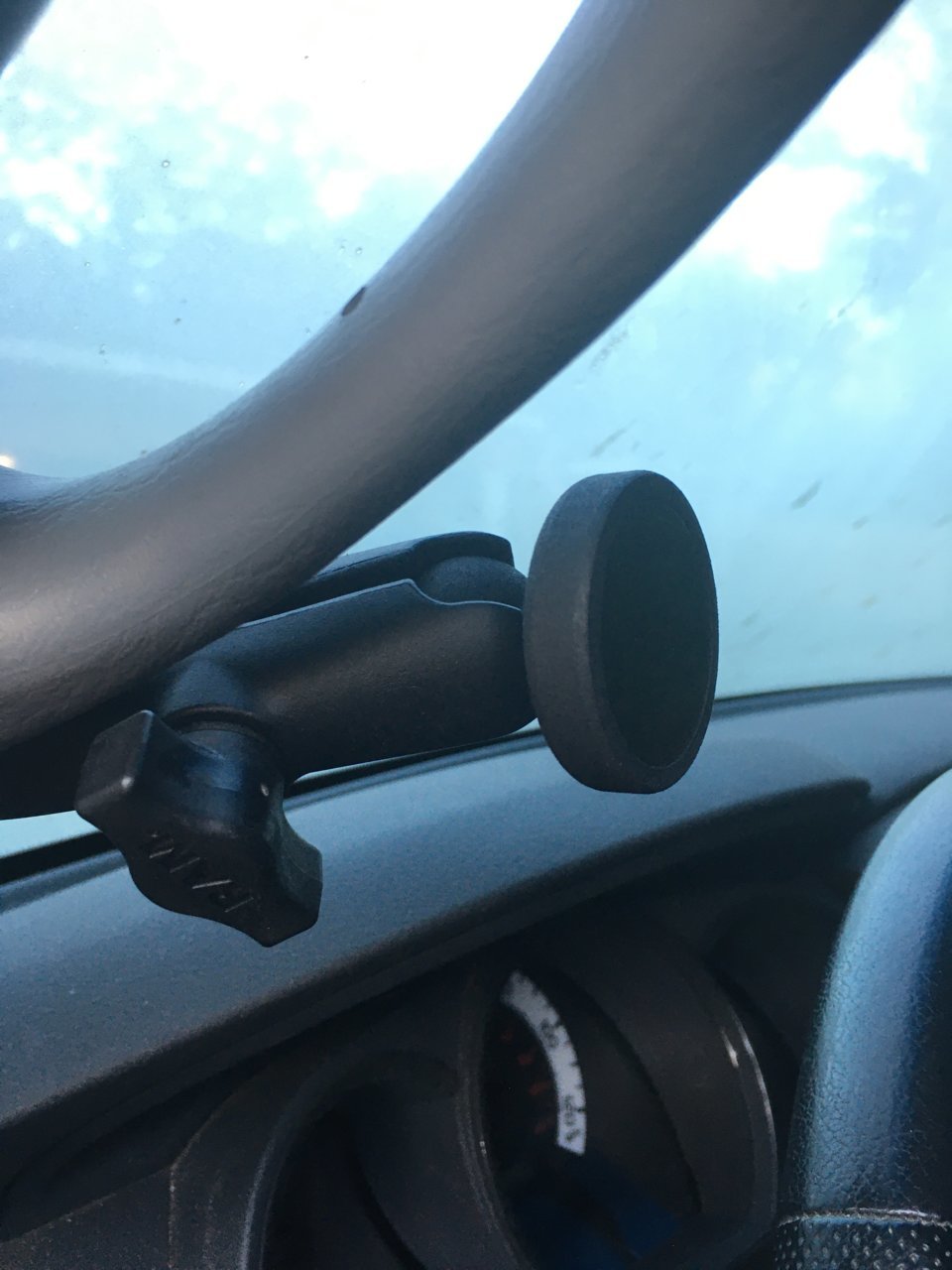

    I couldn’t find a magnet mount I liked, so I 3D printed one.

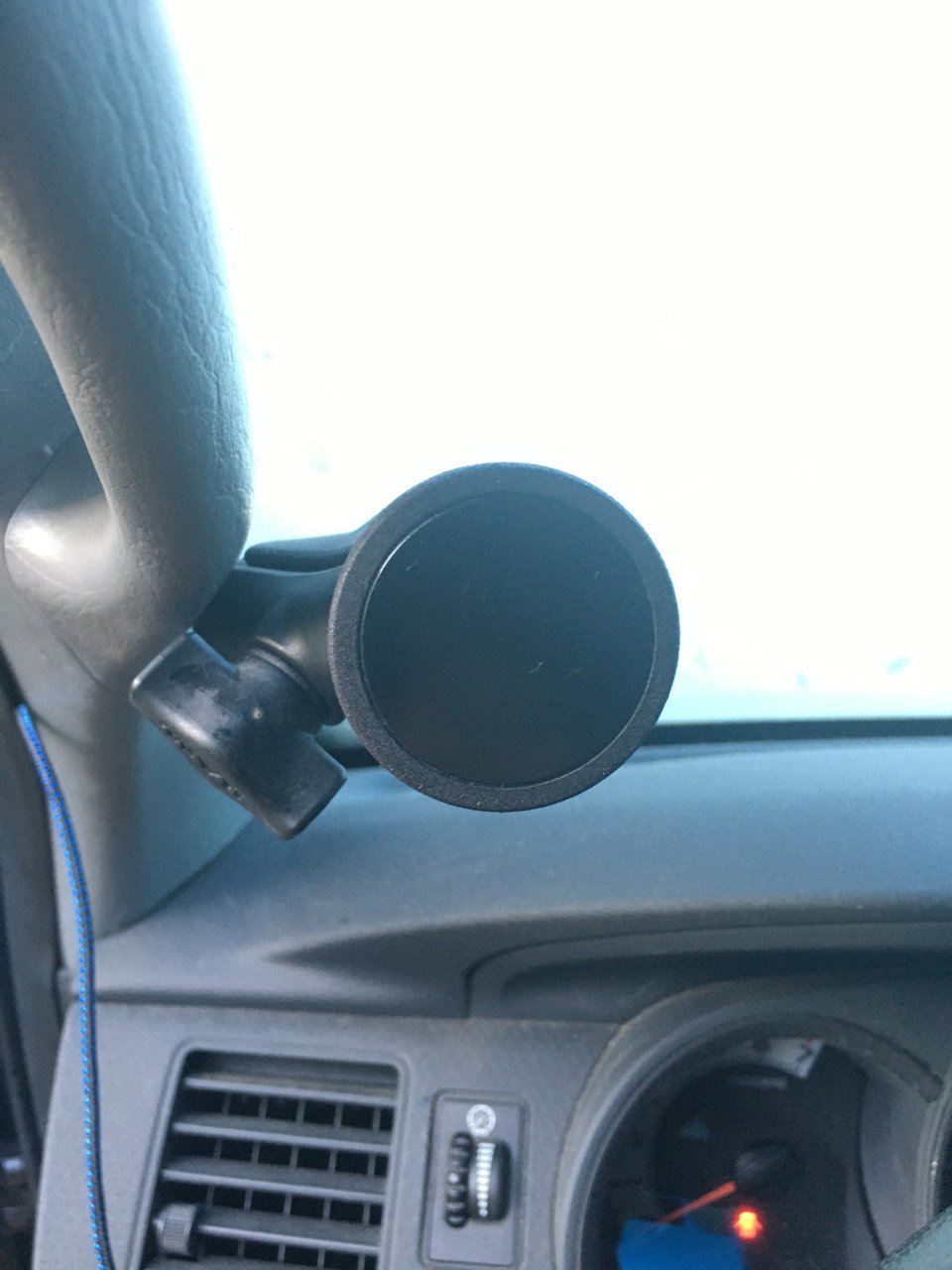

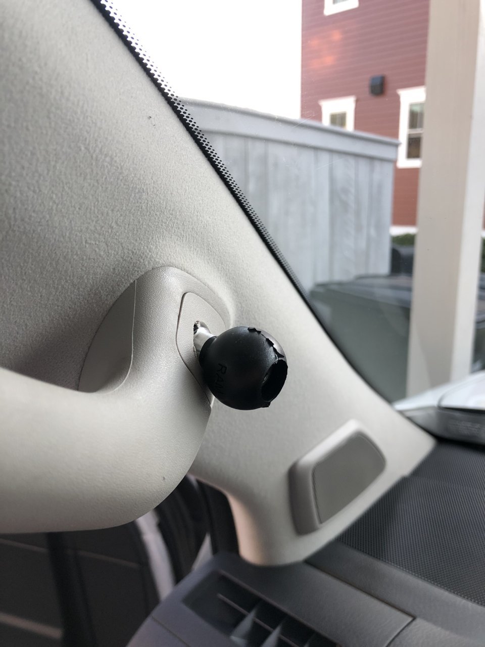

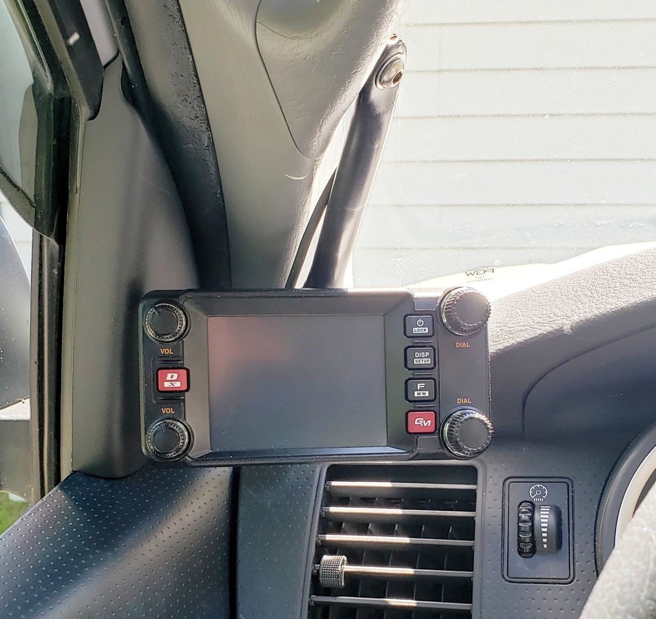

    My take on the A-Pillar mod.

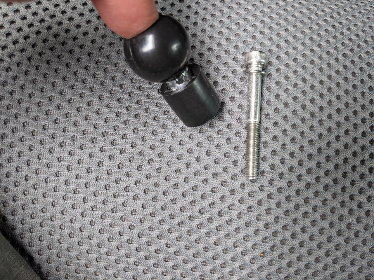

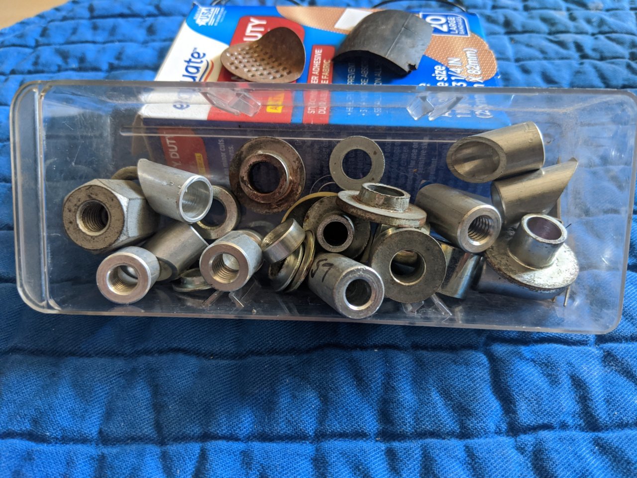

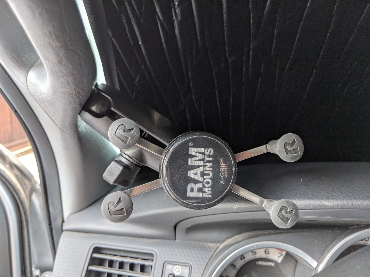

    Just about the easiest mod I've done and quite useful as well. My version:
    I have a bunch of delrin stand-offs in the garage; cut a section to length, opened the end a bit with a 31/64, whacked the RAM in the hole -- held quite rigidly in the delrin 'housing'. 50mm SS cap head + SS lock washer, and good to go. Took 10 mins to complete.
    Cheers,
    DJM
