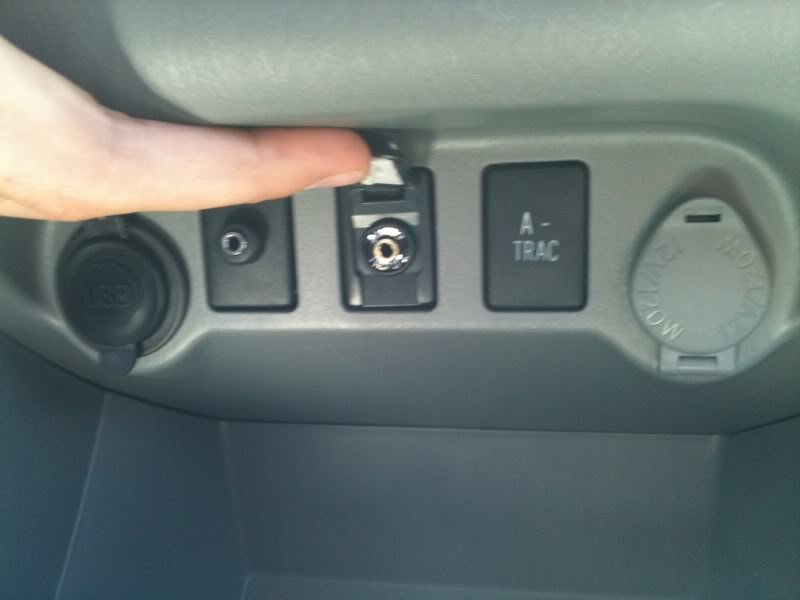

    Step one:
    Remove the aux plug and unclip it from the harness. This can be done withoutremoving the panel it's in and just reaching down through the HVAC controls andpopping it out. HVAC controls will need to be removed and you will need skinnyfingers.

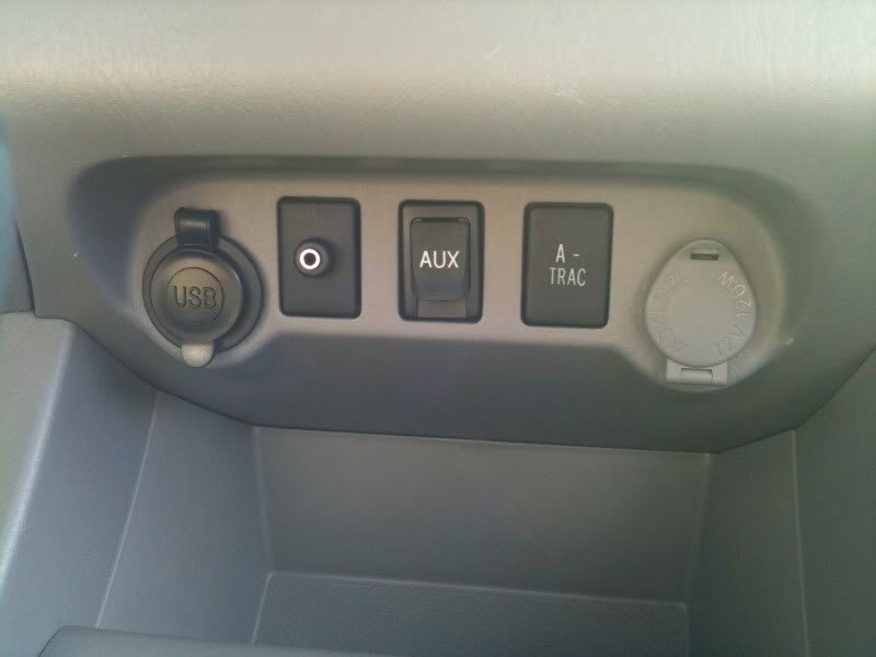

    Step two:
    Takeout the white plug from the aux plug/button and remove the circuit board. Just pull from the rear and this will slide right out
    Step three:
    Drilla 3/8" hole where the current green aux plug is (your factory aux button/plugshould be gutted and empty at this stage)
    Step four:
    Insertthe PAC iSimple IS335, through the 3/8" hole you just drilled. I gotmine on ebay for 14- bucks shipped.
    Step five:
    Wireit up to either a 3.5mm pigtail connection in your aftermarket unit or rcaconnections with the supplied rca adapter in the IS335 kit, and snap the auxplug back in place. I wired mine up to aux input 1 on my Alpine iva-w505using the rca connections.
    Step six:
    Enjoythe ability to hook up a aux device for listening.
