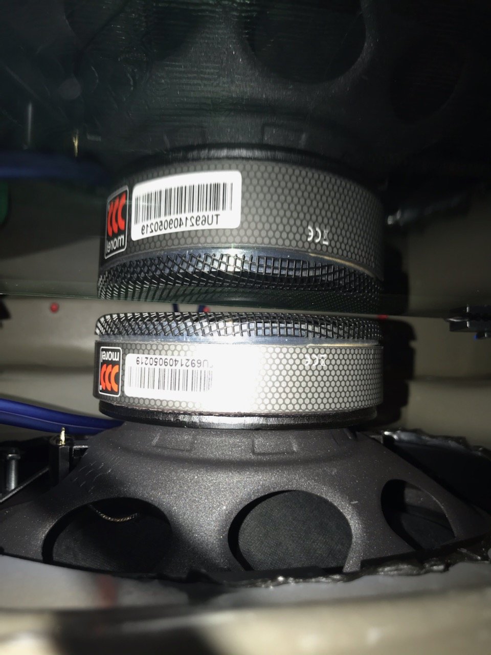

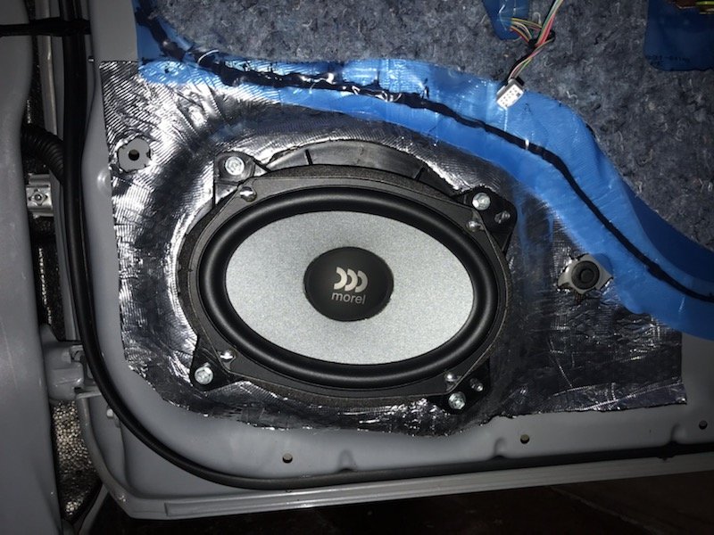

    Just a heads up for anyone looking at Morel Tempo Ultra 692 Components, they DO fit 3rd gens (Crutchfeild says they don't). Just barely though lol. I will be creating an audio build thread soon if you guys are interested. 2nd picture shows just how close the rear of the speaker is to the window.

    You know that magnet moves back and forth some with a good bass drop, right? Crutchfield usually knows what they are talking about.

    You sure? I was pretty positive that part doesn't move, I could be wrong though.

    I think it does move but not positive. Great looking speakers though. Bet those things have some power

    The electromagnet attached to the cone moves, but the permanent magnet on the back is bolted on. It's not going anywhere.

    That's what I thought.

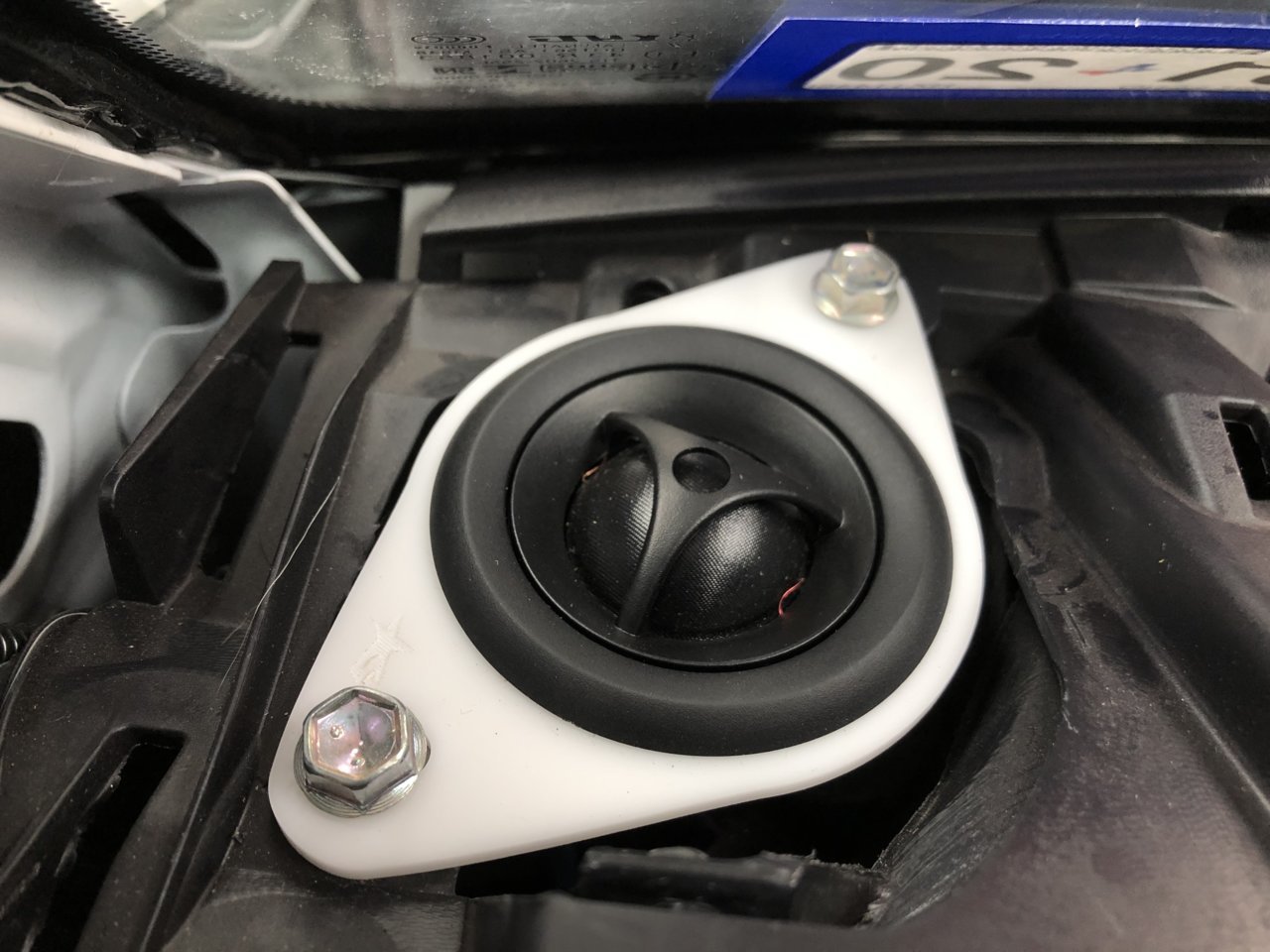

    We run them in the front doors on my wife's '17, along with Morel 6.5 coaxs in the rear doors. Fronts are crossed-over at 80Hz. The midbass is incredible.

    It looks like 5star did the install. Nice!!

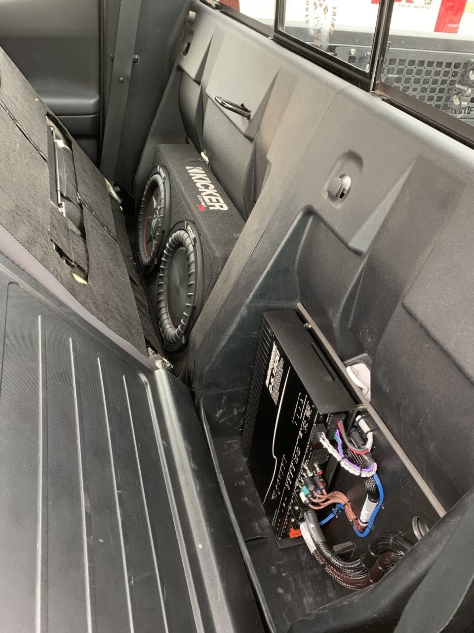

    Believe it or not, I want more power. We're running front components and rear coaxs at 125W/ch, currently (rear fill is turned way down). I think we'll add an LC-1.800 and an additional 10" Kicker, then run channels 1/2 and 3/4 on the D-6.1200 active to front mids and tweeters, and channels 5/6 to the rear coaxs.

    Too much.

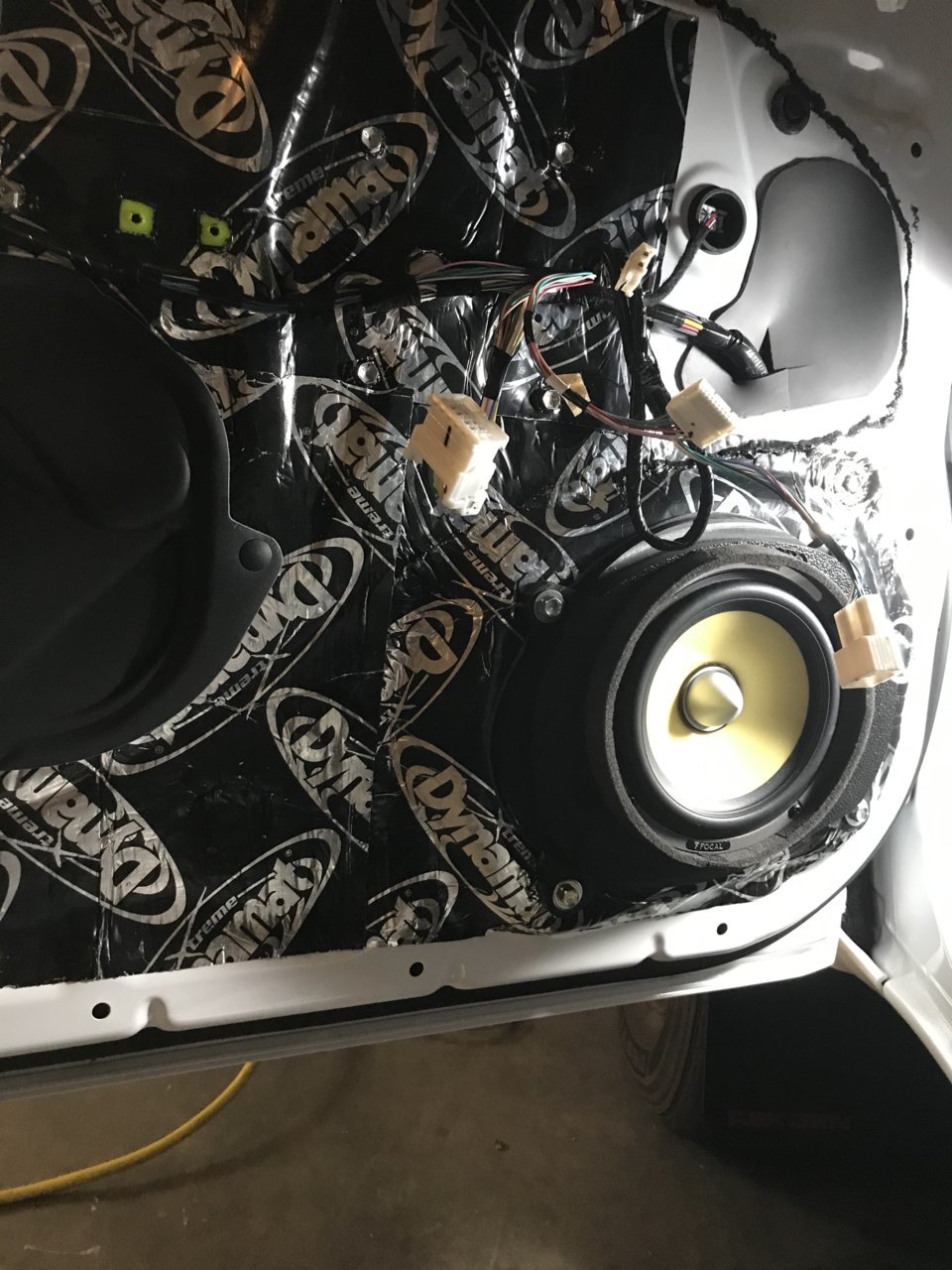

    Wow, nice! Will you be going back to 5star to get the work done? I’m thinking about going active on the front stage. I got the same amp and I’ll be tuning it myself using REW. Currently I’m rebuilding my system and running new wires throughout. I just finished the front doors

    Is that a focal elite power K series? I’d love to see how you get these installed as I’m very close to pulling the trigger on a set of kx2 matched up with the focal 3” pod and or an Audiofrog gb10 for oem dash location and focal elite power K coax but I am still trying to figure out more info on it
