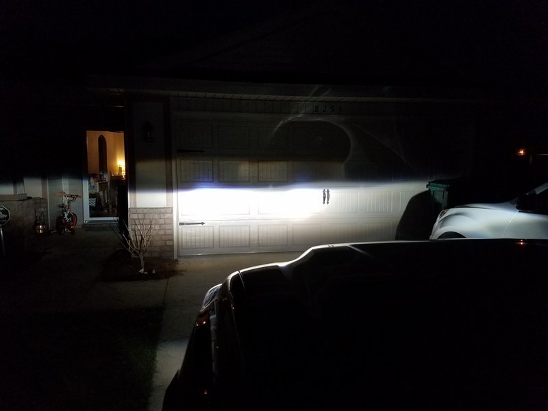

    Finally got the lowbeams in along with the dogs. The fogs look like they need to be lowered but these new lights make such a big difference from the stock. A big swing and a miss for Toyota.
