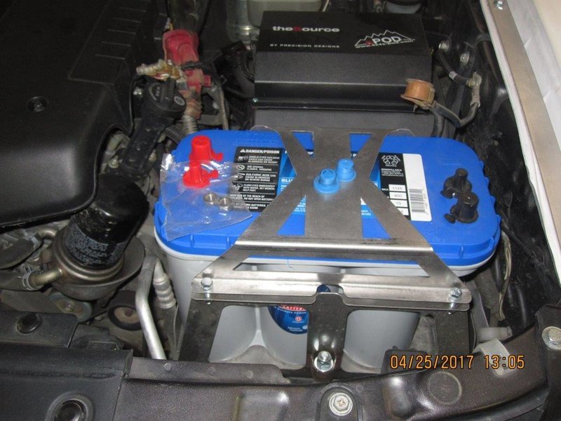

  13. May 3, 2017 at 4:28 PM
    THROTTLE231
    THROTTLE231 Well-Known Member
    Aug 16, 2014
    #136297
    1,616
    Shane
    High Dez,Comifornia
    2011MGMDCSB6MT With Not So So Cool Shit...
    I LIKE BEER....
    Cant go wrong with a Optima Blue top 31M In a sexy @Pelfreybilt battery cage.
    excorcist[OP] likes this.

    I very well may be going this route, don't know how I didn't come across this battery in my searches, seems everyone hates optima these days.
