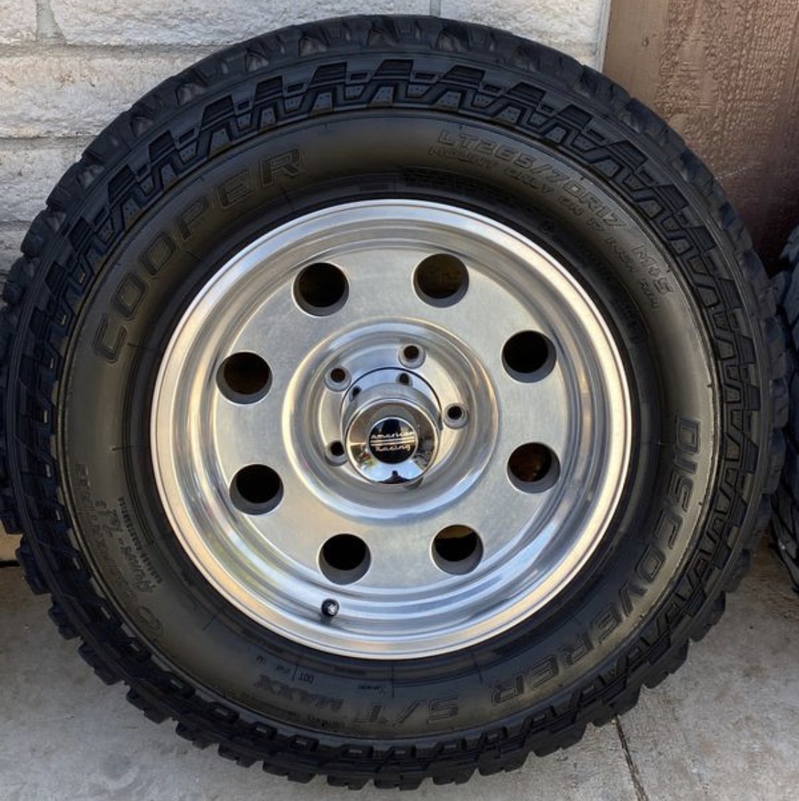

    Hi all, this will be my first post! I just got a set of wheels and tires for my 2.4L 5-lug, I love them but I have some concerns about fitment.
    Tires:
    LT265/70/17 | 31.6x10.7" Cooper Discoverer Maxx
    Wheels:
    (Probably) American Racing AR172 Baja Wheel 17x9"
    I reached out to the seller to get the exact model number, but it looks like the rims have ~4.5in backspacing, and are ~9in wide. A tad difficult to measure with the tires mounted.
    These look right:
    https://www.amazon.com/dp/B0168SV22C/ref=twister_B01N6807AH?th=1
    The bolt pattern on the new wheels is different so I ordered some 5x4.5" to 5x5" adapters which double as 1.25" spacers. I couldn't find any adapters in size m12x1.5 on Amazon, so I went to eBay(yikes). Not positive they will fit/last, these are them.:
    4 1.25" 5x4.5 to 5x5 Wheel Spacers M12x1.5 Studs for Toyota RAV4 2008 2009 2010
    I like those 3" 5-lug fabtech spindles but they're out of my price range, for now I got these to raise the front-end 2 inches:
    Supreme Suspensions - Front High-Density Delrin Shock Extenders for 2" Lifted 1995-2004 Toyota Tacoma 5-Lug 2WD
    and for the rear:
    TORCH 1.5"-2" Rear Add A Leaf Lift Kit for 1995-2020 Toyota Tacoma 2WD 4WD TRD SR5
    I'm in college and just learning about trucks so I'm a tad incompetent and definitely broke, please go easy on me. I know the truck is underpowered but I wanna go ahead with the bigger tires and lift anyway, I just love the look. If I can't make these work or if they look silly, I'll just revert to stock or go smaller.
    Any advice for me about installing/transitioning would be greatly appreciated, I plan to do this work on my own, believe I have everything I need.

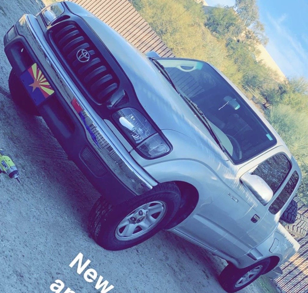

    my truck(27" tires on 15" wheels):IMG_2925 2.jpg

    Gonna have to abandon this plan, damn. Shouldn't be too hard to sell these wheels though I hope

    Seems the overall consensus is to get spindles with add-a-leaf in the back and ~29" tires, I'll probably go that route. I found some 15" steelies and I like the walmart 235/75r15 Goodyear wranglers.
    Do people usually get 1.5" spacers for their rear to match with the spindles in front?
    Will the Supreme suspension spacers and torch aal that I got on Amazon work?

    Keep in mind that increasing the overall diameter of the wheel/tire will have an impact on the way your Taco drives.
    The 2.4 isn’t exactly a powerhouse, so it will take more energy to get the truck moving from a dead stop because larger wheels and tires will reduce the final torque output.
    In other words, you will be putting more strain on your clutch (especially on hills) because the engine will now have a higher tendency to bog down.
    Your speedometer will also not be as accurate but that isn’t a big deal.

    I hate to sound stupid here but I think the shock extender is just for the shock itself and not the coil spring??
    We do not have coilovers like 6 lug and have a coil springs, so u gotta run a coil spacer.
    This is what u need to get that lil lift in the front. You might need to send other part back to Amazon if u bought it
    https://www.amazon.com/Daystar-Leve...cer+tacoma&qid=1581956874&s=automotive&sr=1-6
    TBH u could just do the spacer and bigger tires like u said and imo have plenty of clearance for some modest offroading. I fill my bed up and go camping and trailing often on stock height with the 235's and have done well.

    I just ordered the daystar spacers and v6 coil springs, probably gonna leave the rear stock. Would my truck be level with that setup?

    Yup, should be level maybe a lil higher in the front at first until springs settle. Interested to see how ur build turn out man, please post pics as u progress. Truck should great with that setup and some 235's
