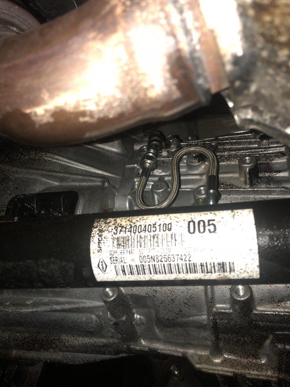

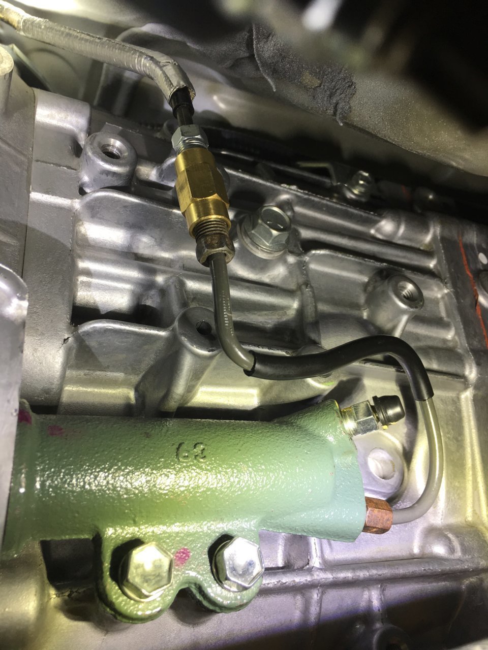

    My Plan was to try and get it done fairly quickly but it didn’t turn out that way haha. Unfortunately the universe told me...slow it down bakaroo. Did you do the dremel mod? Getting those bolts back in we’re definitely difficult and more time consuming so I just did a direct fitment with a brake line. Maybe next week I’ll place the accumulator with the mod back in.

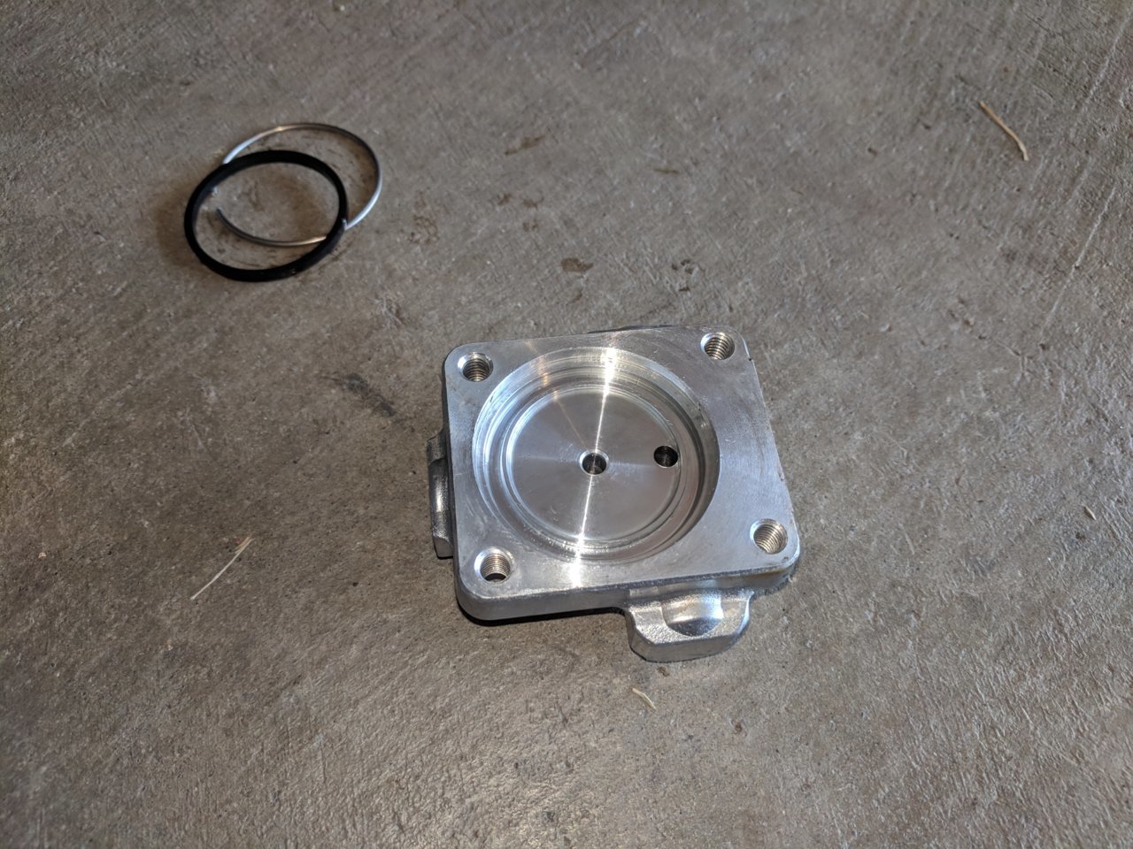

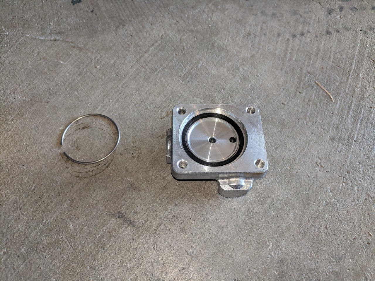

    Yes I did the dremel mod. I put the bolts in without tightening them down, that way I can adjust if needed.

    I don't know if this has been mentioned already, but to throw some more shit in the ballgame I think a big pro to doing the delete with flexible line is being able to remove the slave cylinder easier if you have issues with the slave cylinder/release fork interface making noise like I do, just something to consider

    I think most people are just removing the Accumulator and dremeling it these days

    Yeah I just bought a new accumulator and dremeled it, then replaced the one that was on there. I barely had to bleed it after since it was off for maybe 20 seconds
