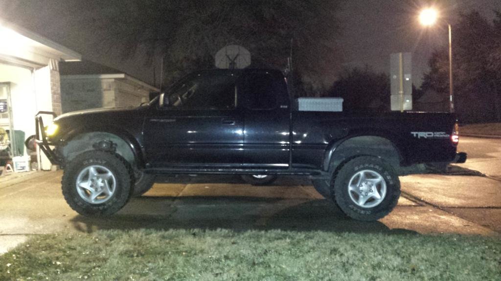

    I guess it's about time for me to make a build thread. I've only had the taco since early 2009... I do mods occasionally and in spurts. I have a few other hobbies I can barely afford and usually just hop back and forth between them.

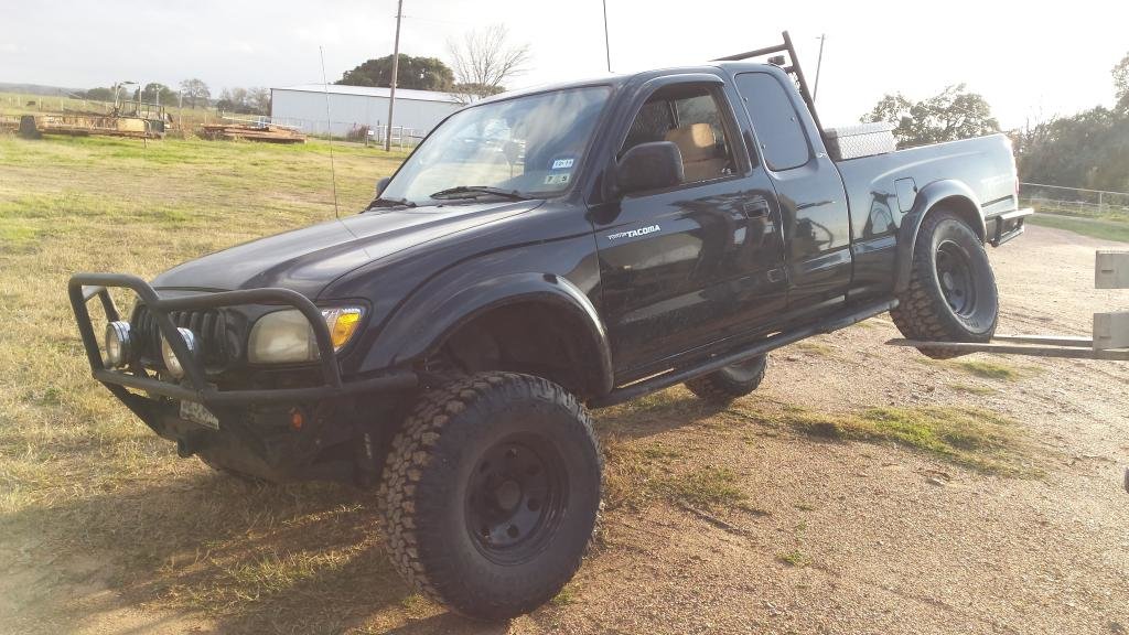

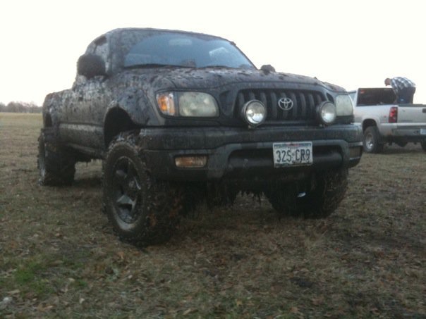

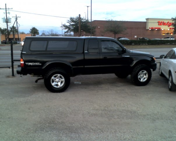

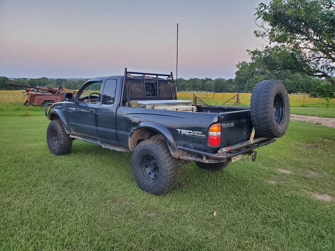

    How it currently sits currently with 205kmiles:
    95cd752b-4841-4f46-8bb2-cc85ca3d3ce0_zps_2b6758b5565d4302d6c258ce2eb06b83b2b4a450.jpg

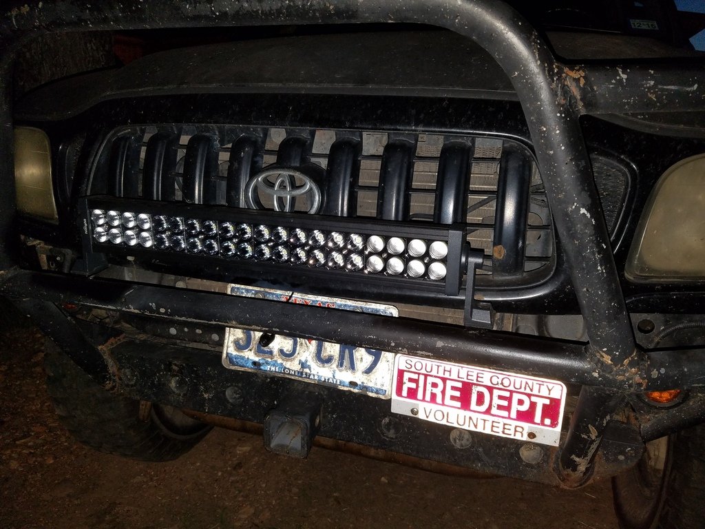

    Nilight LED light bar off Amazon.

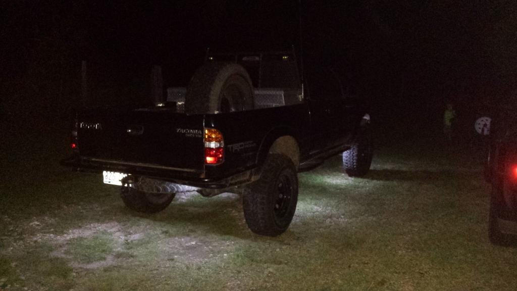

    Nilight LED flat cube thing in the headache rack wired into the reverse lights.

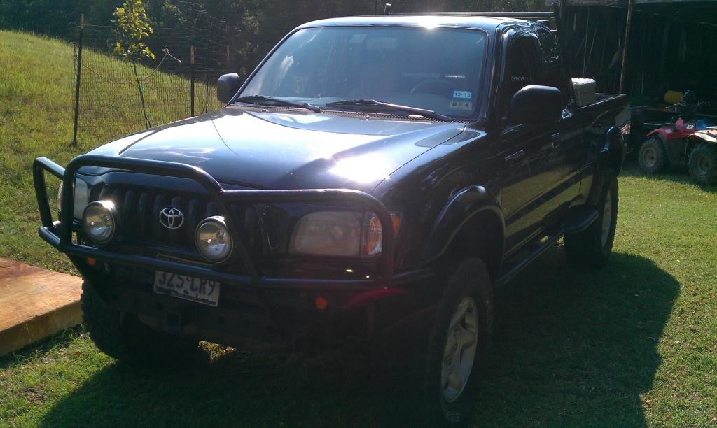

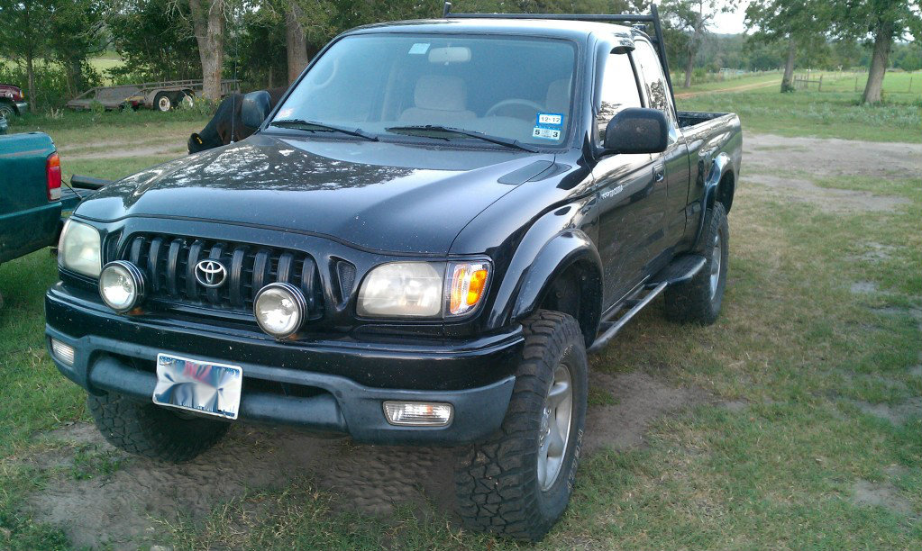

    How it sat in the lot when I found it:
    Camper shell made it for a few hours after I got it.
    Existing modifications when bought at 92.5k miles:
    K&N intake missing some bracing and shields :confused:
    front coil and top plate spacer lift
    rear lift shackles
    255/85r16 BFG KM1s
    Exhaust tail pipe modified to hang too low

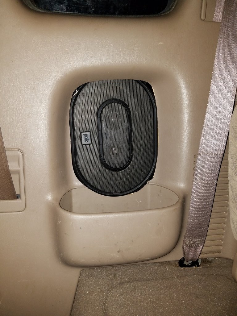

    I put a cb and pa speaker in sometime. Bought the cheapo offroad lights from auto zone and put them in the holes in the factory front bumper that the PO had for some reason.

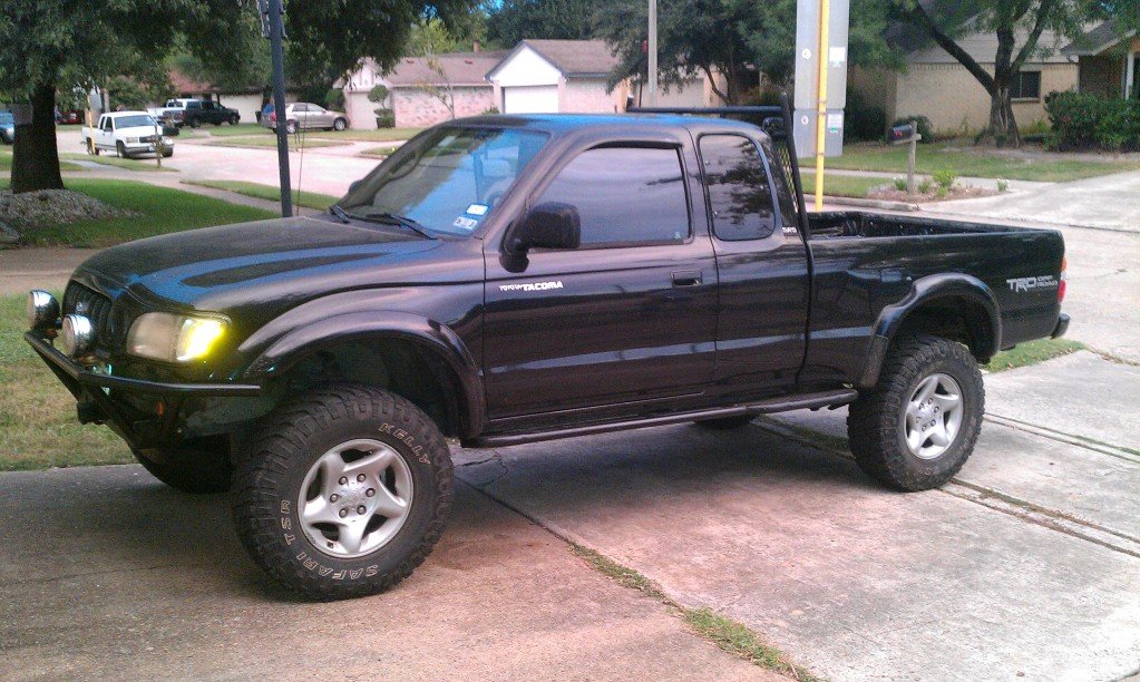

    Met a girl (that became the wife) that told me about their family trips to Colorado and wheeling there... Did a little googling and apparently I have a great platform to build a wheeling rig to take her out there one day. And so it began :drevil:
    Did a grey wire mod and removed the front sway bar at some point in time. Built a headache rack because I have some perfect chain links etched into my passenger rear window.:eek: Put some no name fog lights on the rack and wired them in with the reverse so I had some extra light when backing up at night. Lets just say the window tint made things difficult before. Went to 265/75r16 Kelly safari TSRs when the KM1s wore out.

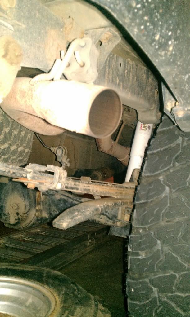

    Got tired of the low hanging exhaust and moved it between the axle and frame.

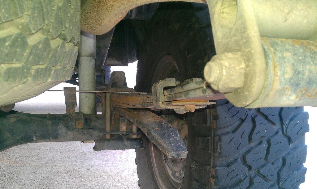

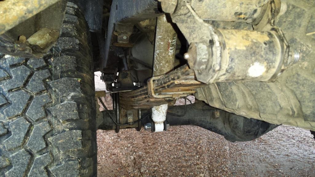

    Wasn't doing major wheeling yet but the stock leafs suck so added two leafs out of the original pack from my 67 Mustang (hence the username)

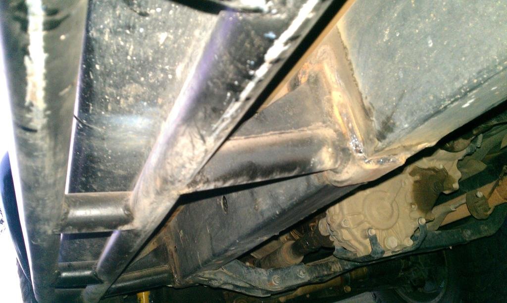

    Build some sliders:

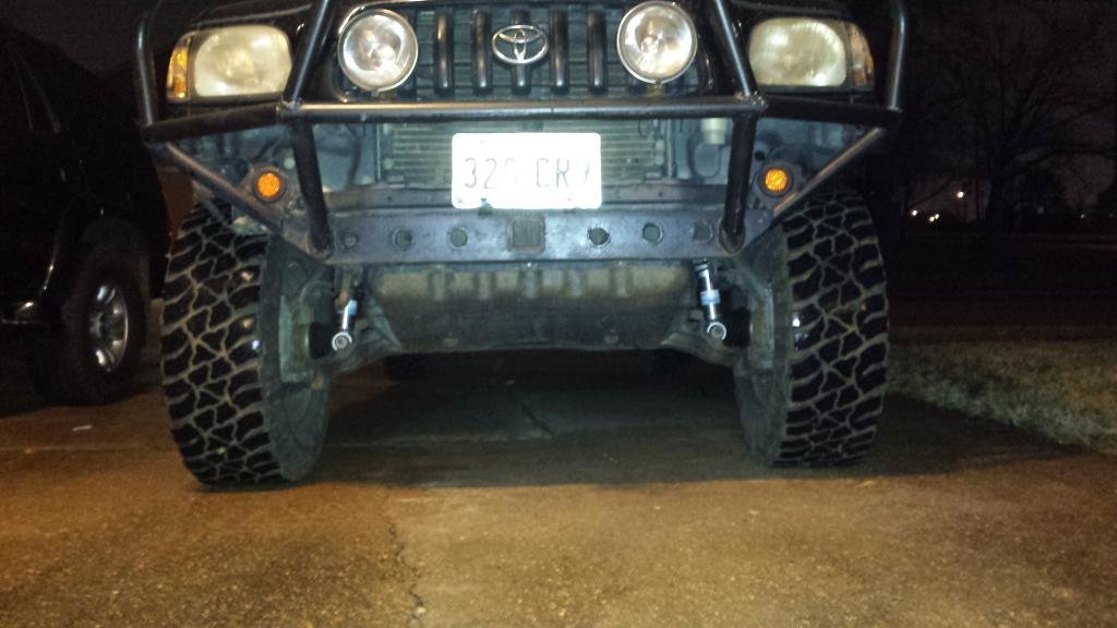

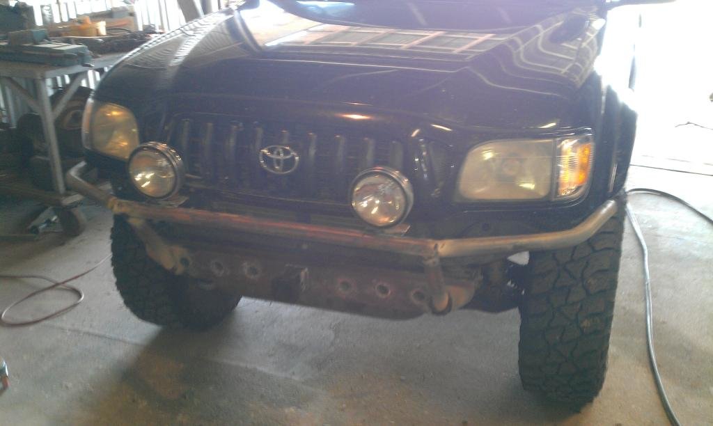

    Then a front bumper:
    Figured the bumper needed some more work.

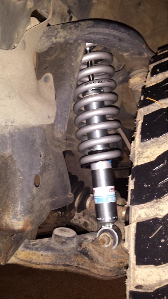

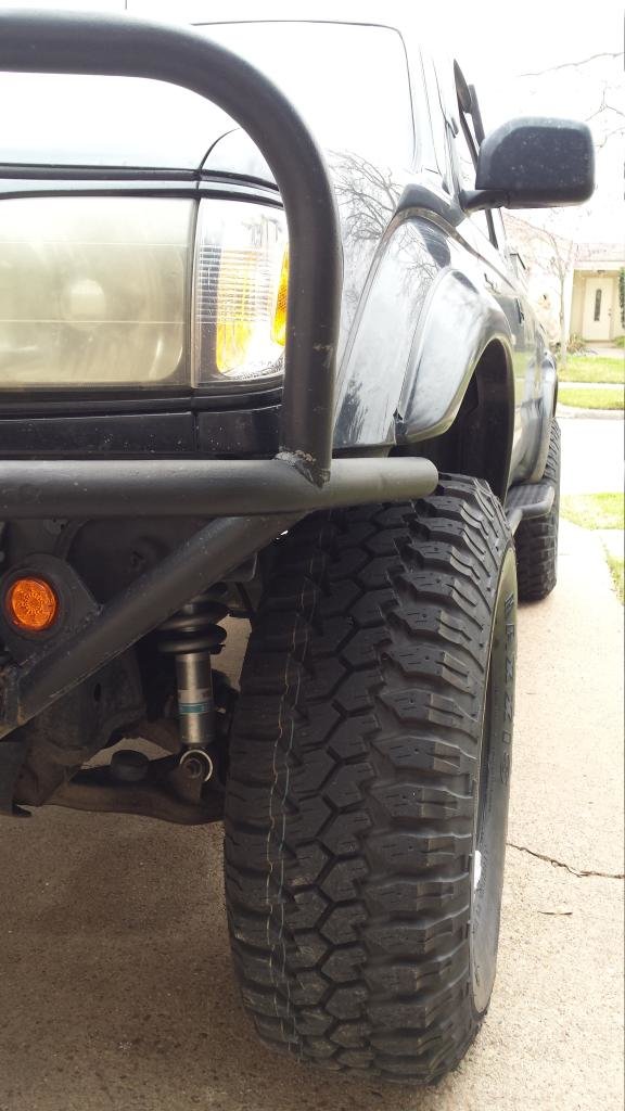

    Got some eibachs and 5100s here the beginning of 2014.

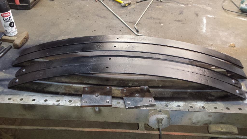

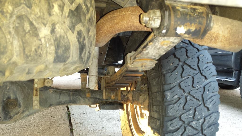

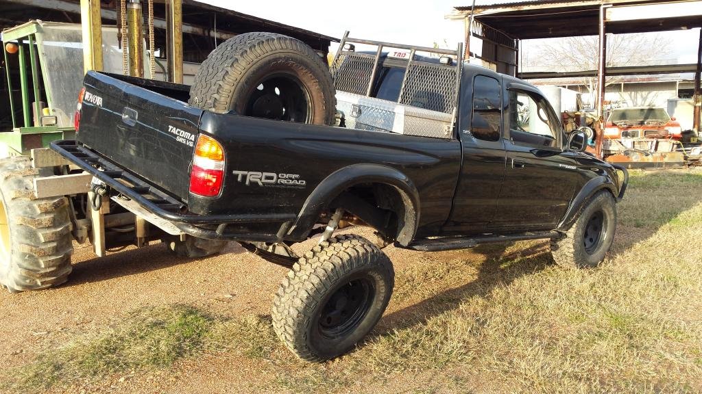

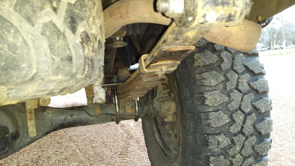

    Redid the rear leafs. Ditched the lift shackle and went back to stock shackle. Found out the bushings were different and decided to press out the studs on the factory shackles and run the greasable bolts from the lift shackles. The extra leafs came this time from a late 80s 1 ton ford overload leaf pack. I think the pack could really use one more leaf somewhere but I'm out of spare packs so this will be a future project one Saturday.

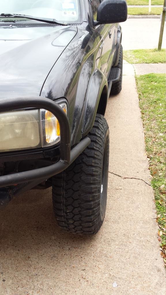

    Got some 285/75r16 maxxis bighorns at 170k miles.

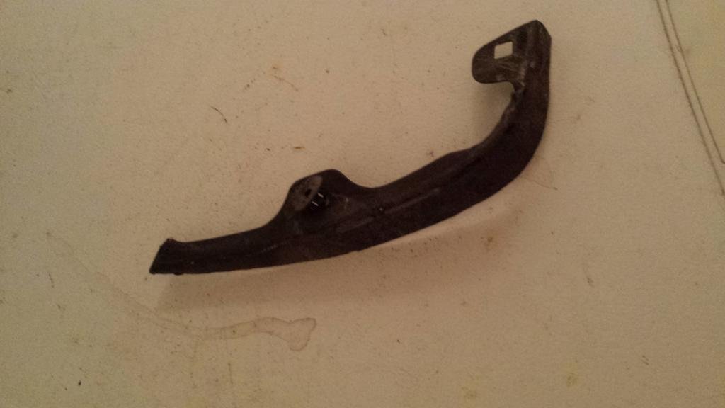

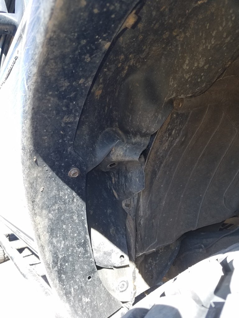

    and removed some of the front fender after finally doing the pinch weld mod. ( )

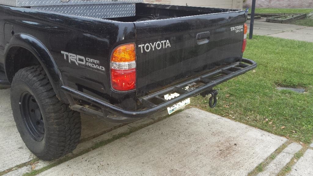

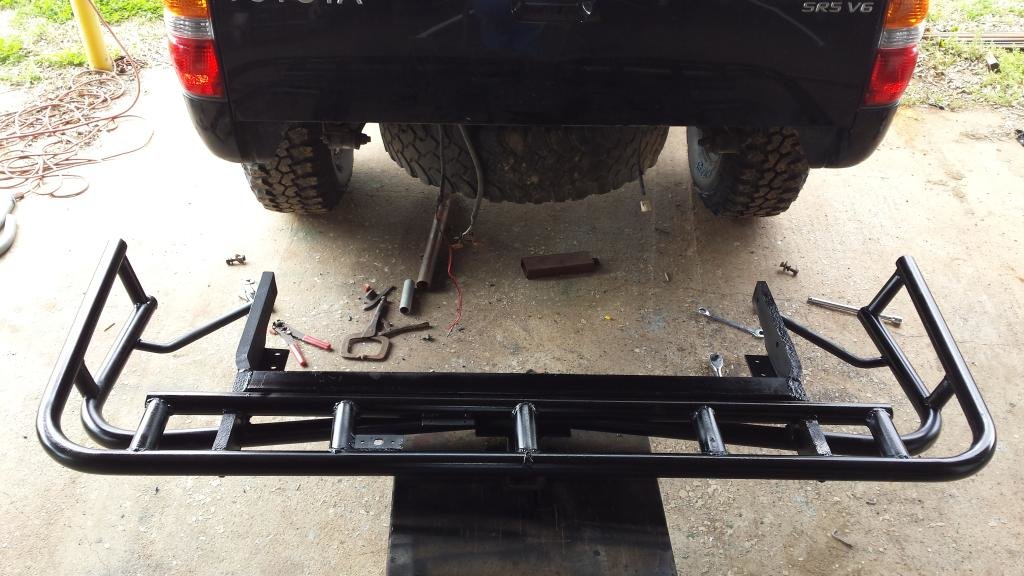

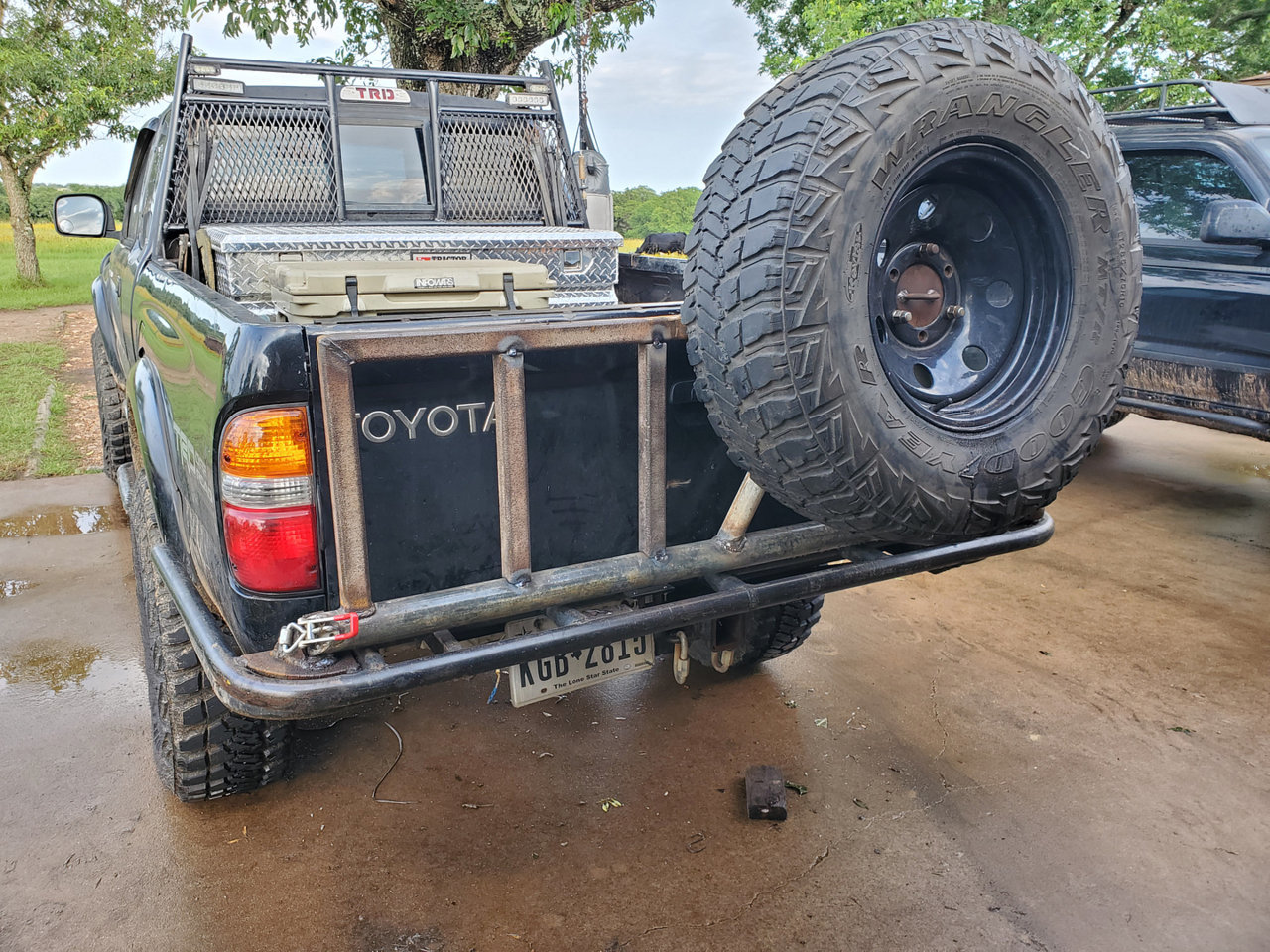

    built a rear bumper (inspired by the 4x innovations)

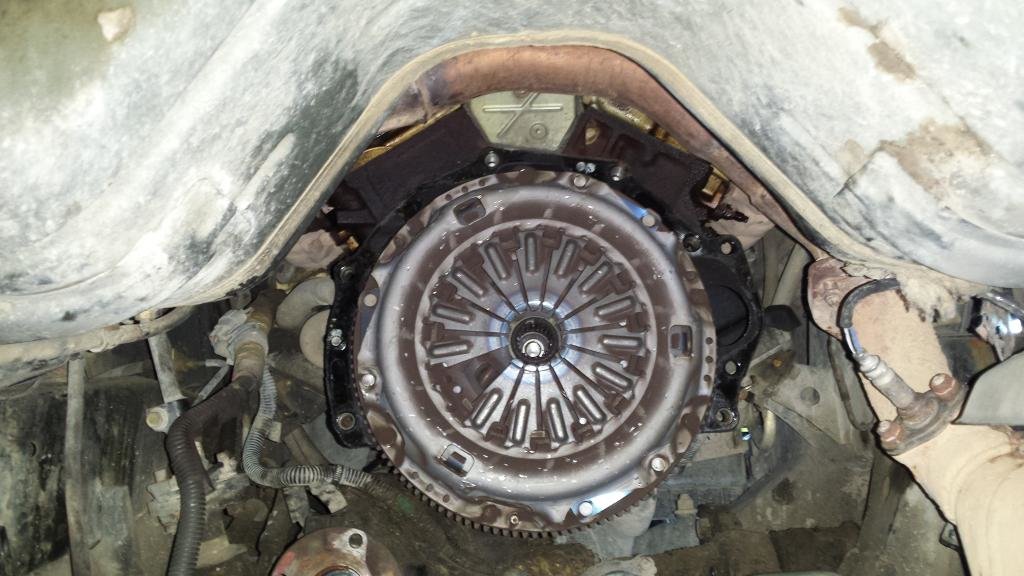

    clutch from advance went out. Went back with a marlin:

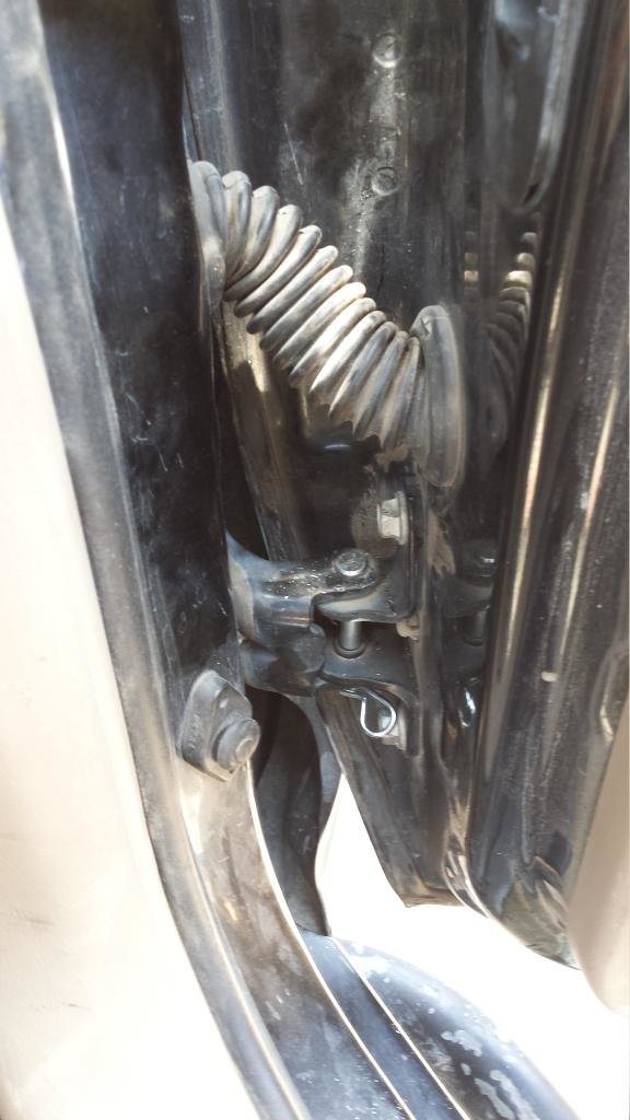

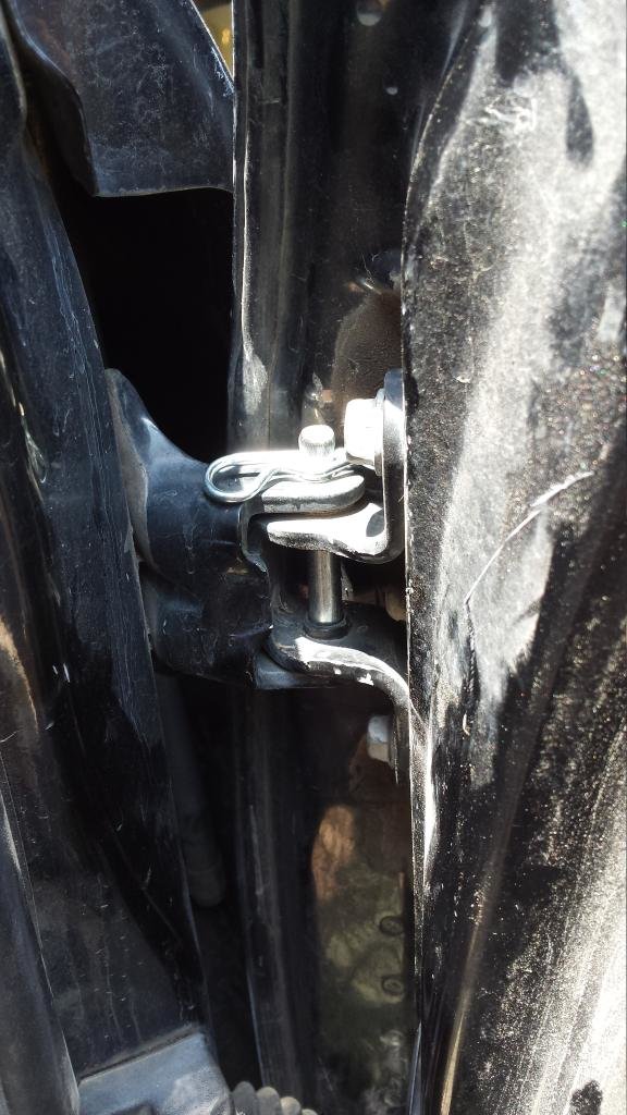

    made removable door hinges (still need to take the doors off) (here):

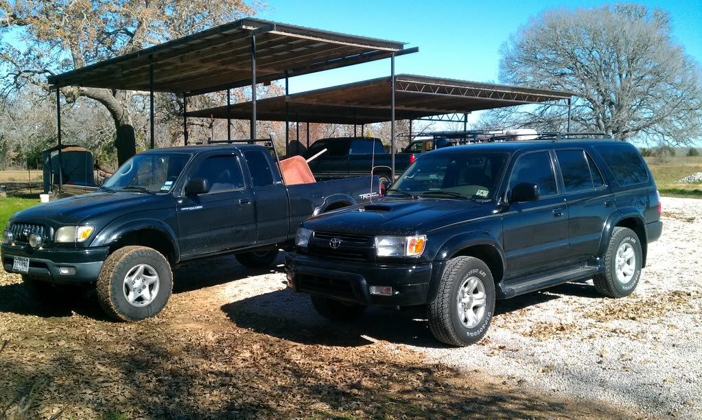

    Little off topic, got the wife a 01 4 runner 4wd sport December of 2011. It's been a great vehicle also aside from the tranny going out. Found out I should have been changing the fluid and filter ever 40k-ish so I guess it's partly my fault. When having it rebuilt we put a transgo shift kit in it. I also did an external tranny cooler the first week we owned it.
    She won't let me lift it. :(

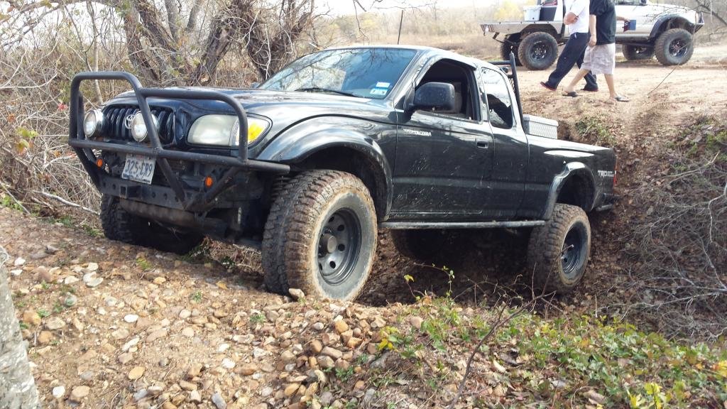

    Went wheeling at Brazos Valley Off Road Ranch the 13th. Had a blast. Tried a spot I knew I had no business in but got to test out the rear bumper.
    Highlight of the day for me was this climb. :burnrubber:
    https://www.youtube.com/watch?v=YvOHbh5GuWc

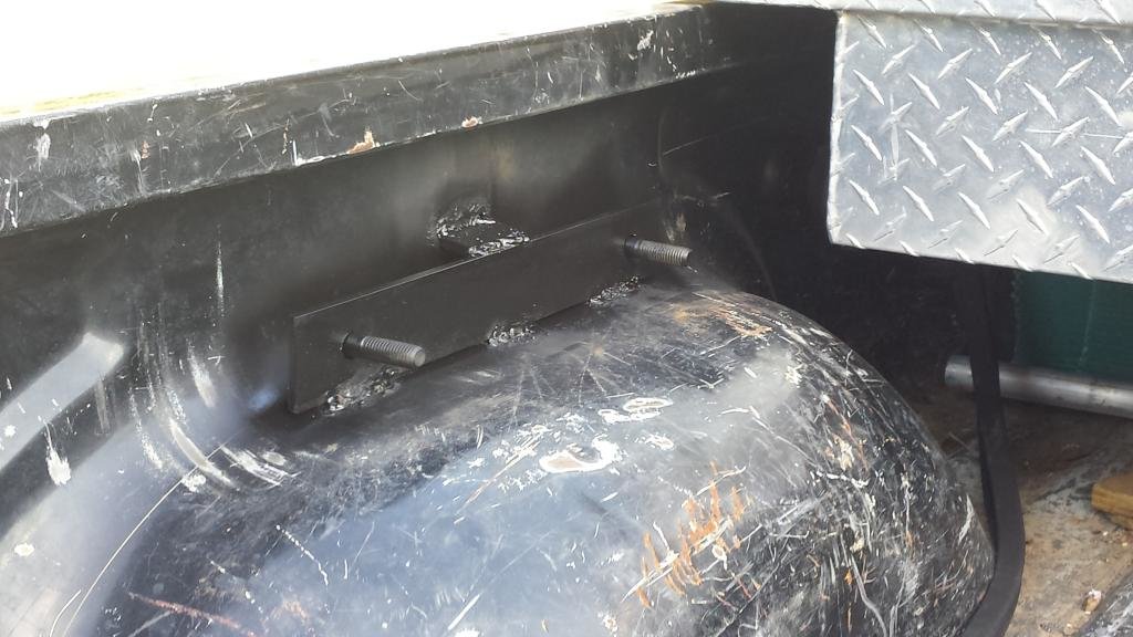

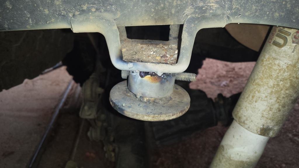

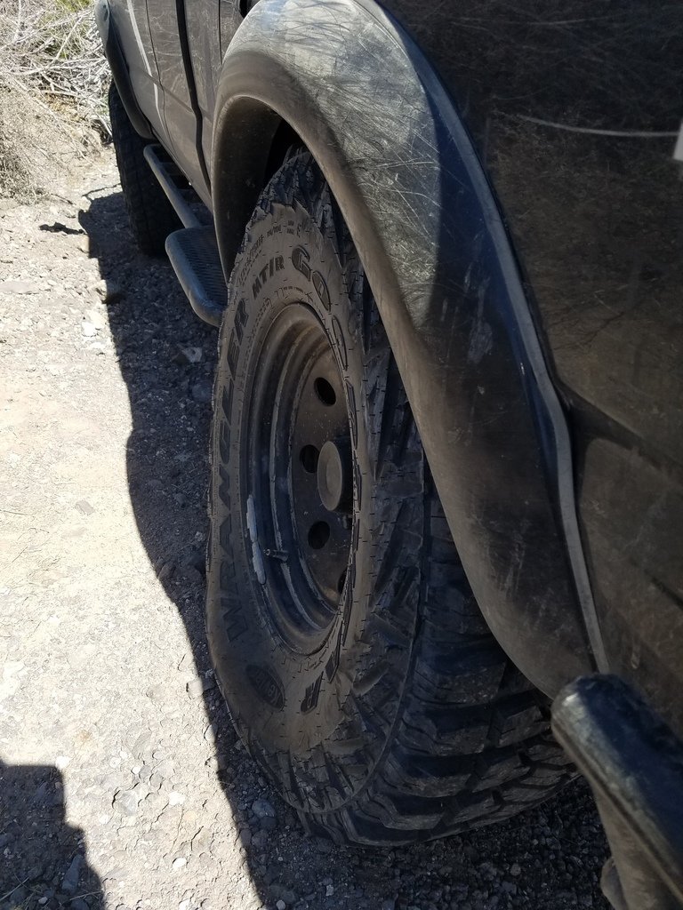

    And learned my rear tires were rubbing at full compression. So I made some extended bump stops. Should be able to easily extend them at a later date if need be. Still need to paint them and yes I got my nut on.
    And in the near future I'm going to change up my rear leafs a little bit again. Mainly just add another leaf so the truck doesn't sit perfectly level and have a bro lean whenever I put a cooler of beer in the bed. While doing this I think I'm going to do a U bolt flip while at it so I can put a 2.5" wide spring in instead of being limited to the factory 2.375" width. Found this 9/16" kit at the local car quest for way to cheap. Top plate isn't wide enough but that's easy enough to make. Probably use a flat piece of 3/8 and drill it accordingly. I'll also make some shock mounts and just use the existing shocks. I hope to have this done by the end of the year.

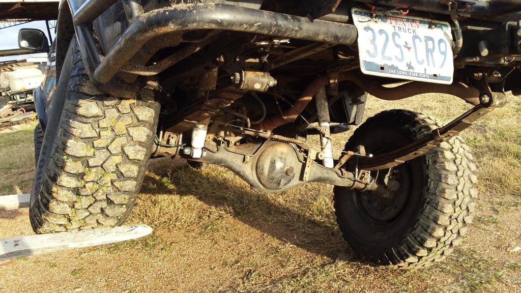

    Made my top plates out of .5" flat bar. Little overkill but had it available. Only added the large leaf between the toy leaf with the alignment tabs and top two. Removed the factory plastic tabs and fit like a glove.
    Made shock mounts or of .25 x 1.5" flat bar. Here is a drivers side pic after adding another leaf.
    Flexes a little better I think. Need to step up to 26" extended 10" travel shocks.

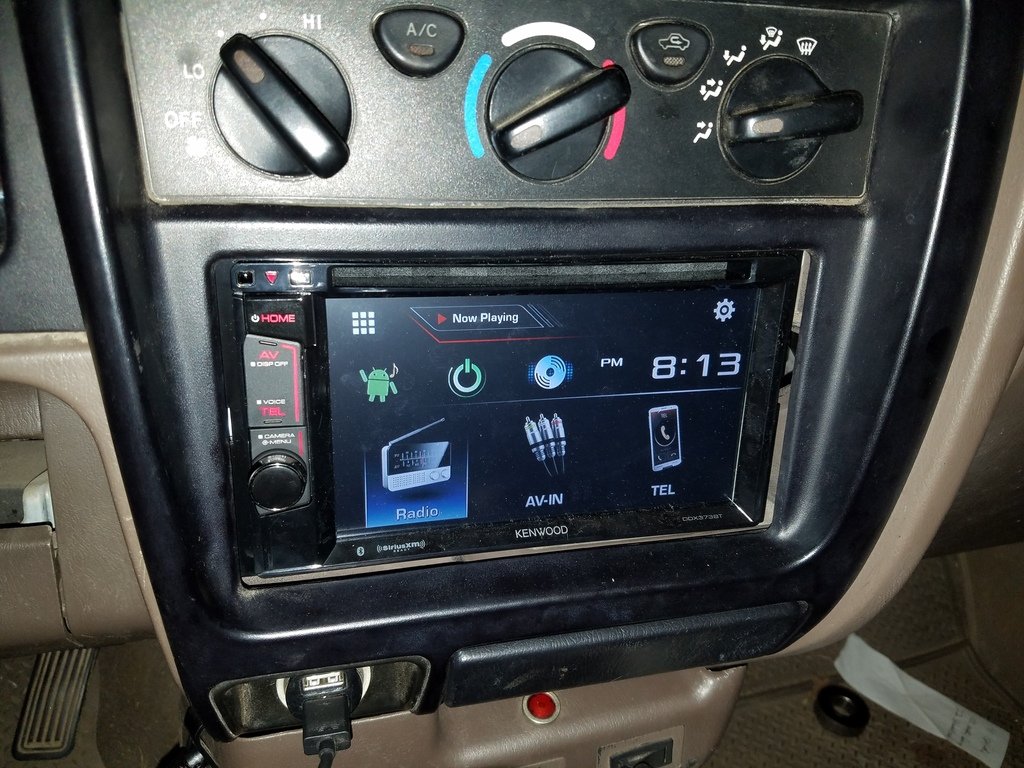

    Time for an update. Radio went out so time for an upgrade...
    Kenwood DVD touchscreen and stuff. Wanted a trail camera I saw on Colinb17's taco ages ago. Also swapped out the vatozone off road lights for a cheap Amazon light bar. And upgraded the rear speakers while I was at it. Squeezed in some 6x9s in the 6x8 opening.

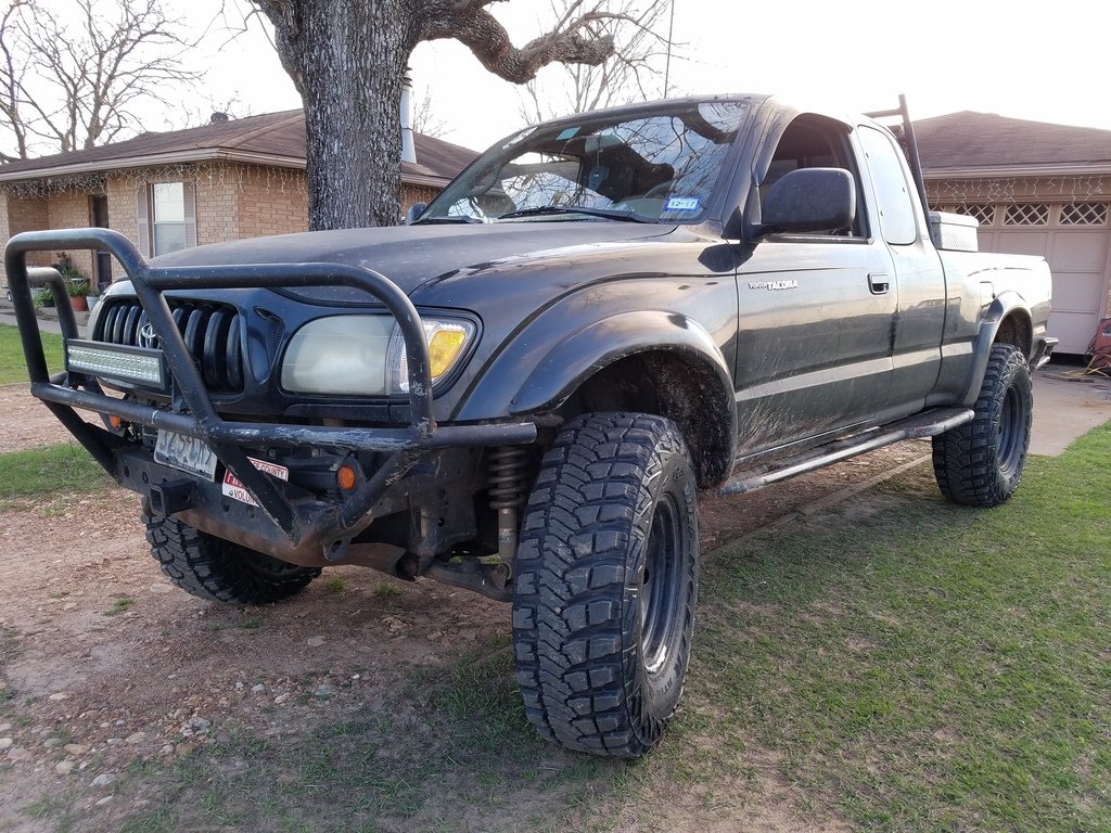

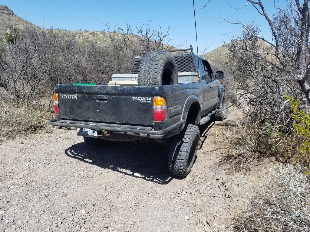

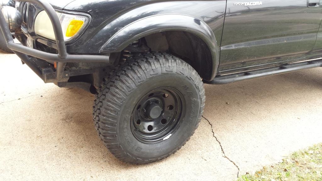

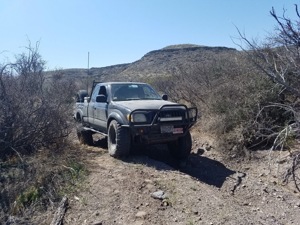

    First up is it was time for new rubbers. Decided to try MTRs this time. So far I like them. The old Maxxis Bighorns had 34k on them and 3/16-1/4" tread left when removed. Interesting note. These MTRs in the same 285/75r16 are 1/2-1" taller than my old bighorns.

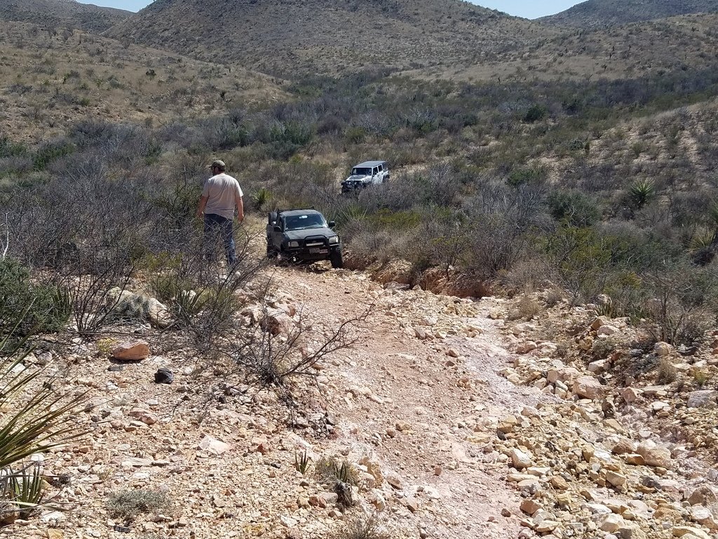

    And time for a trip to Big Bend Ranch State Park and National Park
    Built an expo/utility trailer (4x8 with 2' sides)
    fixed itself...
    then there was this...
    https://www.youtube.com/watch?v=LSpQUoqjSUs
    All in all it was a great trip being out in the middle of nowhere.
    Then because I hadn't seen enough rocks I hit up a local spot back home and needed to reinforce the gas tank skid. I've seen this done somewhere but don't remember where.

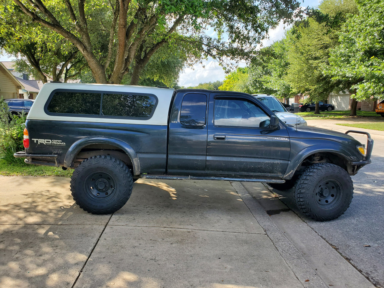

    Time for another update...

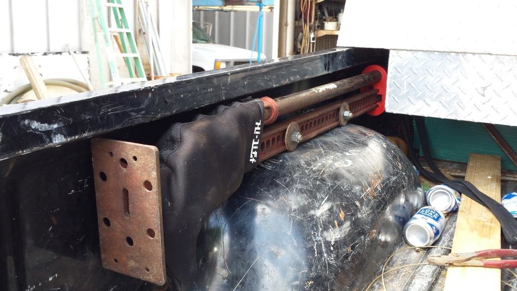

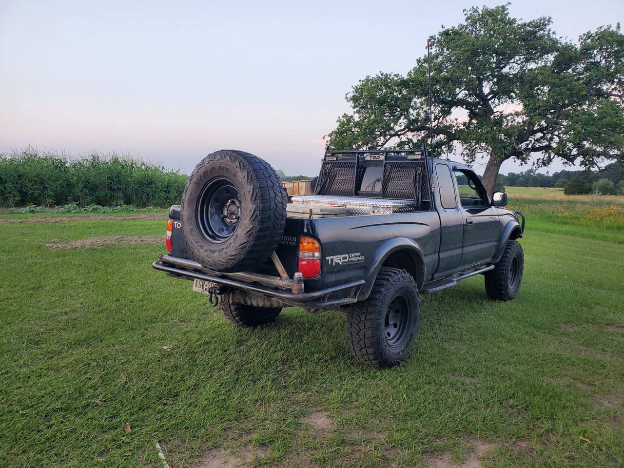

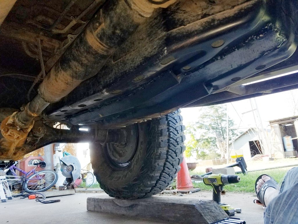

    At 245k ish the mtrs were pretty worn but the best had about 3/16th tread left so moved it to the spare and got another set of mtrs. Then the wife decided we needed to do a trip for our 10 year anniversary... Apparently I need to buy mtrs more often... :rofl:Current plan is to ditch the kiddos with grandparents and go to new Mexico for a few days and camp out of the truck. Which will need a camper shell again...
    So I got this until i can find a high rise one.
    Now gotta do some building...

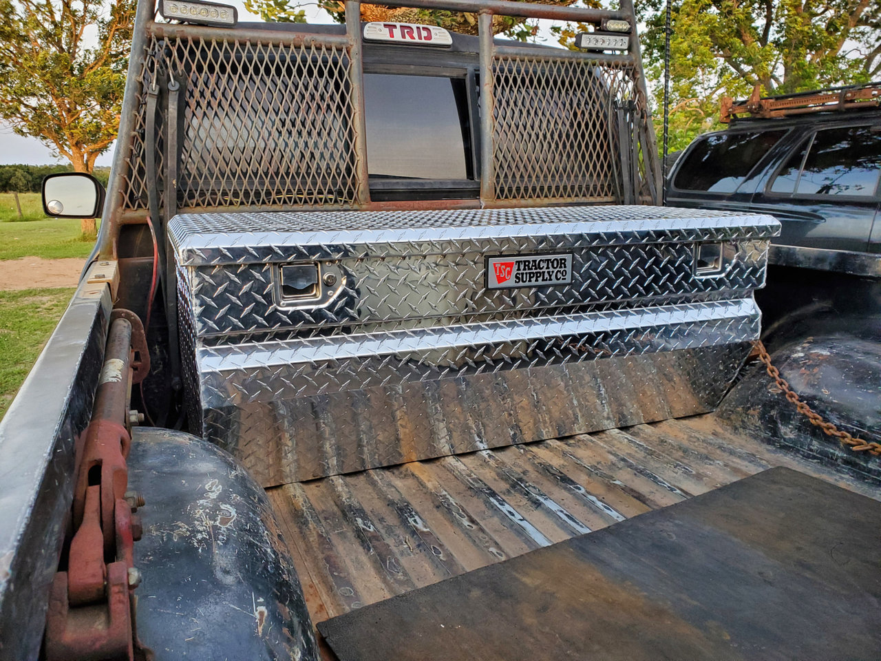

    Also the 48" chest tool box from tractor supply fits like a glove. I know it'll be a little high for the sleeping platform coming but the shell will be off 98% of the time so just going to live with it for now.

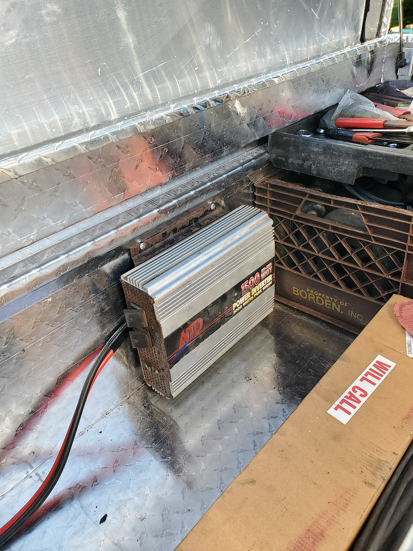

    And an inverter.
