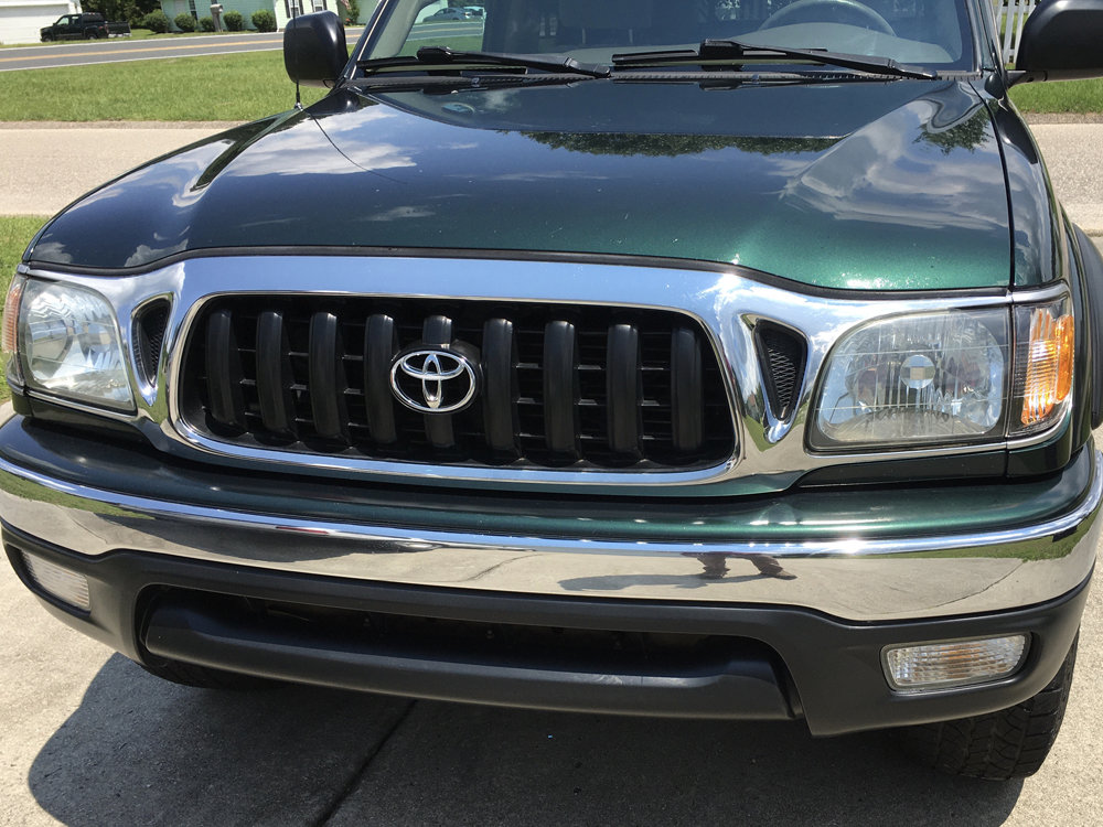

    Kings, J59's Total Chaos UCAs Custom skids Sticker mod
    I'm willing to bet that this doesn't actually do anything for the light output. Those kits IMO are for looks only.
    Here are my lights AFTER I ran my original 2004 headlights through one of those 3 stage kits twice in about 3 or 4 months.
    Low beams. Notice how my gutters are illuminated.
    And here are NEW headlight housings (CAPA certified TYC brand, from rockauto):
    Notice here how you can barely even see the alarm sign on my garage door anymore, let alone my gutters.
    Those kits really are about as close to a scam as you can get. The "good" ones cost about as much my my headlight did. Just get new housings...

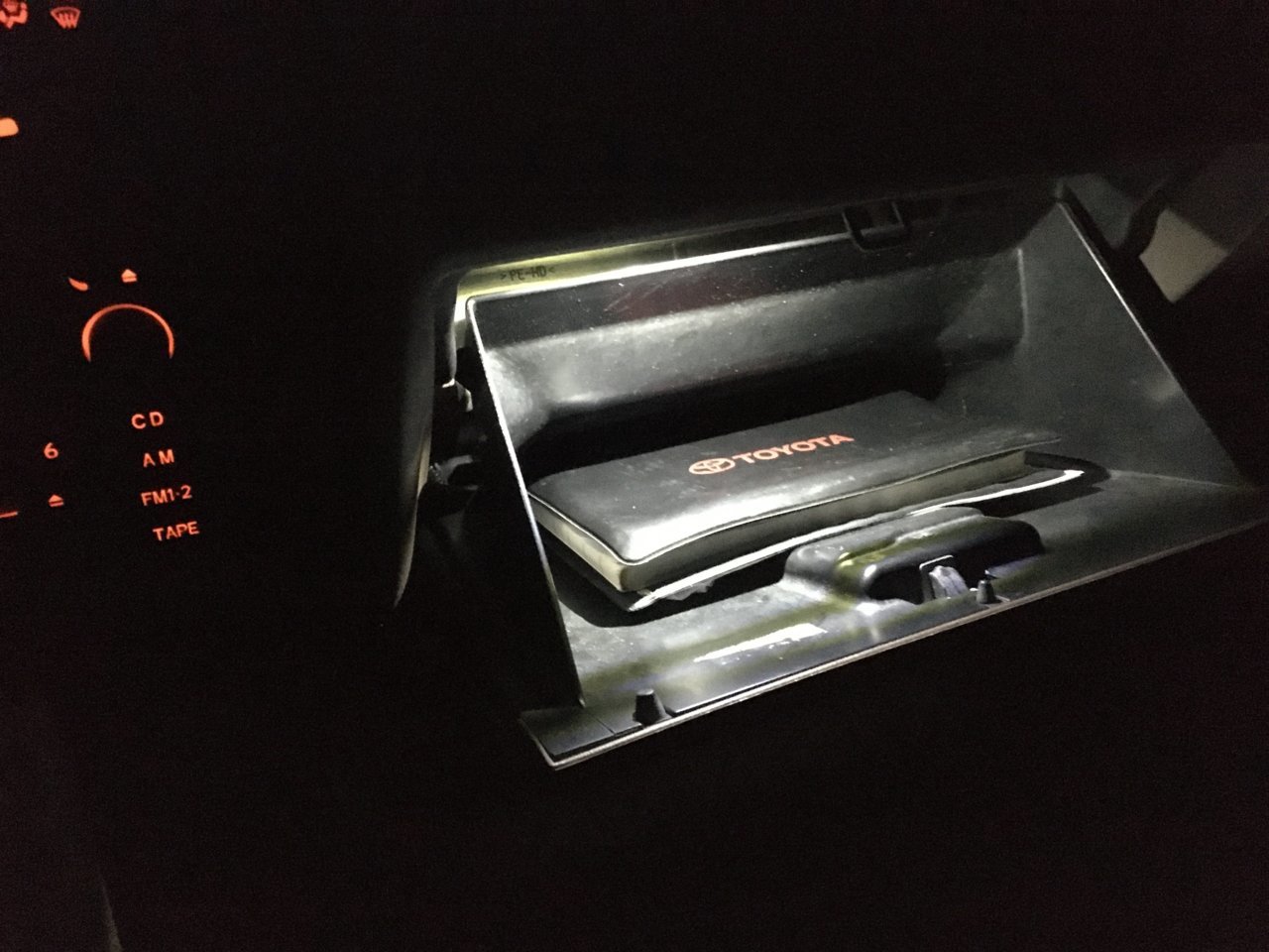

    314
    Today I fixed replaced the light in the glove box. Best $2 I ever spent!

    The 1st Gen: All pro 3” lift (650 lbs coils, expedition rears with bilstiens),Timbren rear bumpstops, ubolt flip, diff drop, carrier bearing drop, 33’s on beadlocks ,ARB Bumper, winch, hand throttle, ARE canopy, roof bars, poly bushings all around minus the body mounts. The 2nd Gen: Leveling kit, roll up tonneau cover. 265/75/16’s
    You think the headlight restore kits are a scam? I’ve restored 3 sets of headlights with the 3M kit and they’ve improved my light output significantly. I most recently did it on my first gen and it was a night and day difference. They don’t get the headlight back to brand new, but it’s a huge difference if you have heavily oxidized lenses.

    A scam? only partially. They don't exactly lie about what their products do, but they kinda gloss over what they don't do.
    Sure, your light gets brighter, as did mine, but if you look at my pics the quality of that light is complete shit. There is no cutoff whatsoever, just round blobs of light.
    Like I said, that first pic I posted was after doing 2 different sets of "restoration" with a Maguires kit. 2 sets of sanding discs, polishing compounds and finishing wax stuff.
    Sure it made my lights look absolutely brand new, and I was rather impressed. That is, until I realized how little it did for the light cutoff pattern.

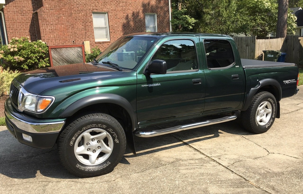

  14. Jul 5, 2020 at 4:04 PM
    #34
    nchiker1
    nchiker1 [OP] Well-Known Member
    Jun 1, 2020
    #330014
    314
    Buffed and polished the paint. Still has imperfections, but made a great difference!

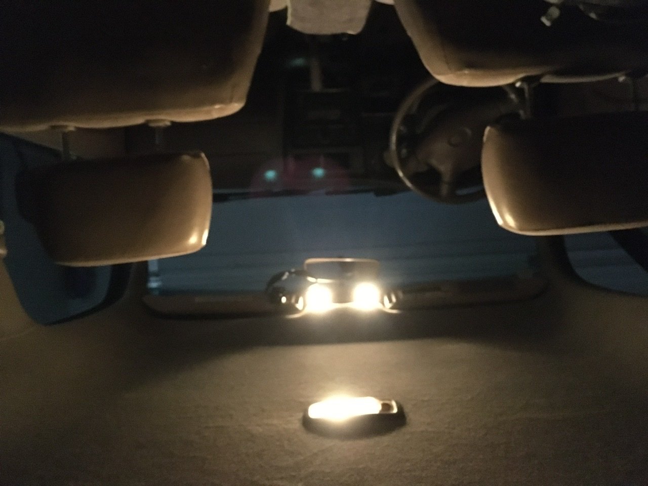

  17. Jul 7, 2020 at 9:27 AM
    #37
    nchiker1
    Jun 1, 2020
    #330014
    314
    Replaced the map & dome lights with LEDs. Huge improvement-can actually see the floor!

    I realize that, it just devolved into something else.
    to your point, I believe the kit did make a difference. The spread was less than before, because the light was able to go in its intended direction instead of being flung every which way by the haze of the light. It probably goes further also. Personally, I like the results, and would do it again. But to each their own
