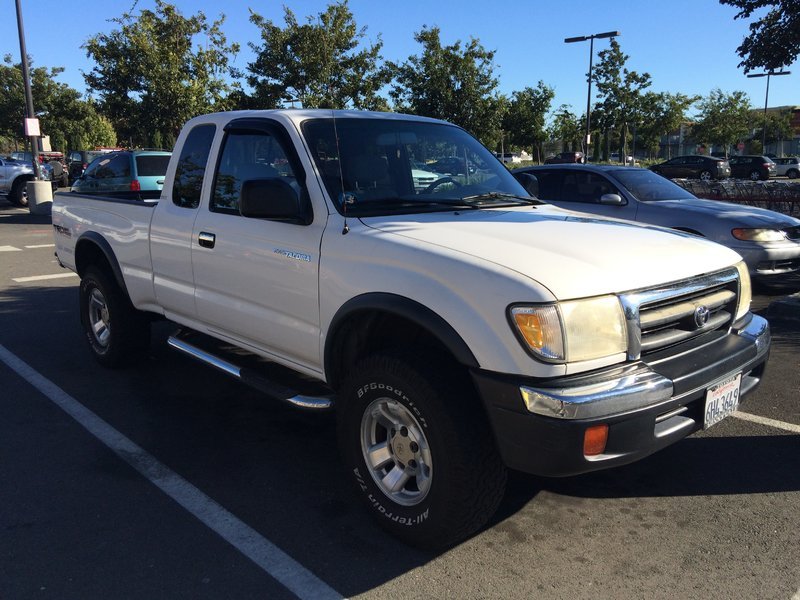

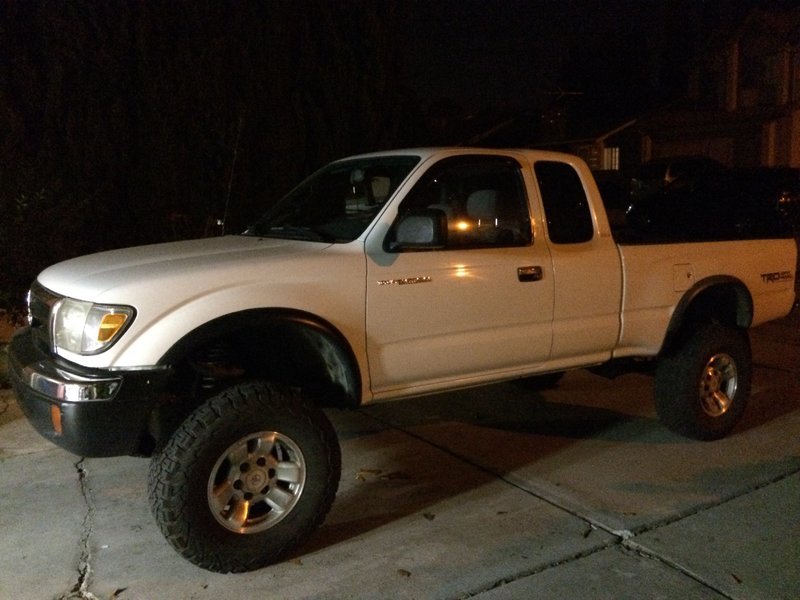

    I got it at 170k ish from the first and only owner..It needed some love from sitting a while.
    BFG KO Tires were cracking so that needed replacing. It needed a full tune up
    So I bought an oem timing belt kit with extras..
    Also bought oem front pads, valve cover gaskets, cam seals, radiator, and flushed all the fluids out.

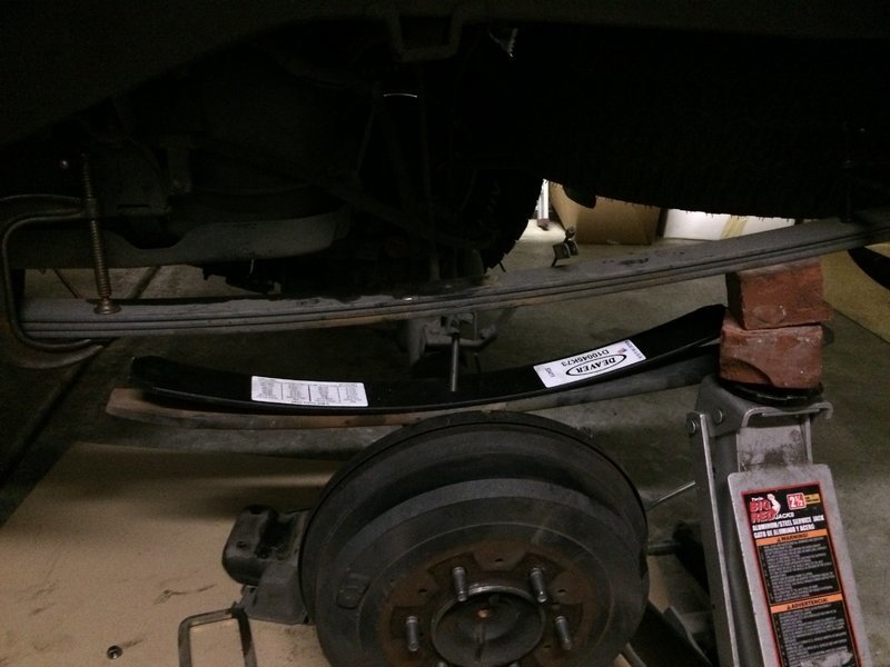

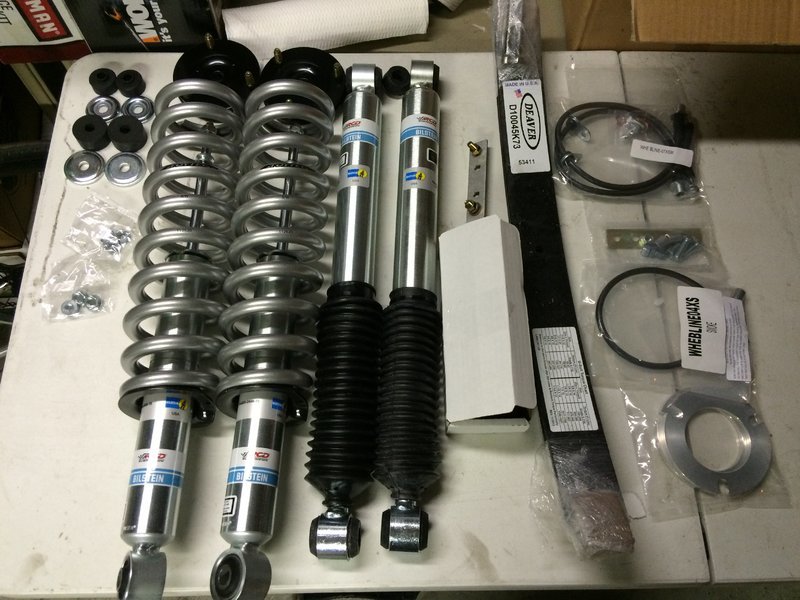

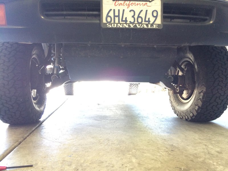

    Suspension is looking tired so upgraded to
    5100 billies all around
    With eibach 620 coils and rear deaver aal

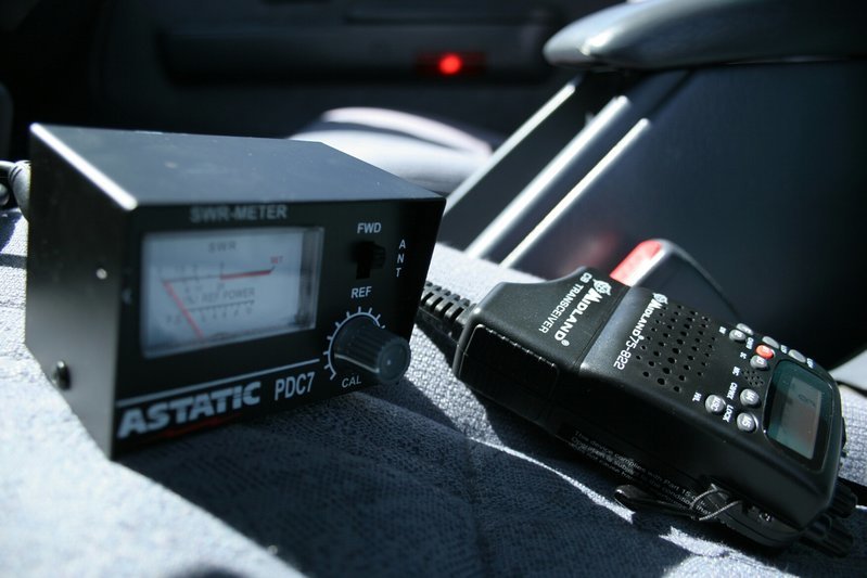

    Put in my CB setup. Got the lil wil magnet whip and a midland 75-822 that I can swap between rigs for different adventures!
    Took it out on the clear lake run with some folks on here. Performed better than I expected. Definitely need to show some attention to my bushings/axles after the run I can see they were showing some age and probably didn't like the new angles they were being put in.

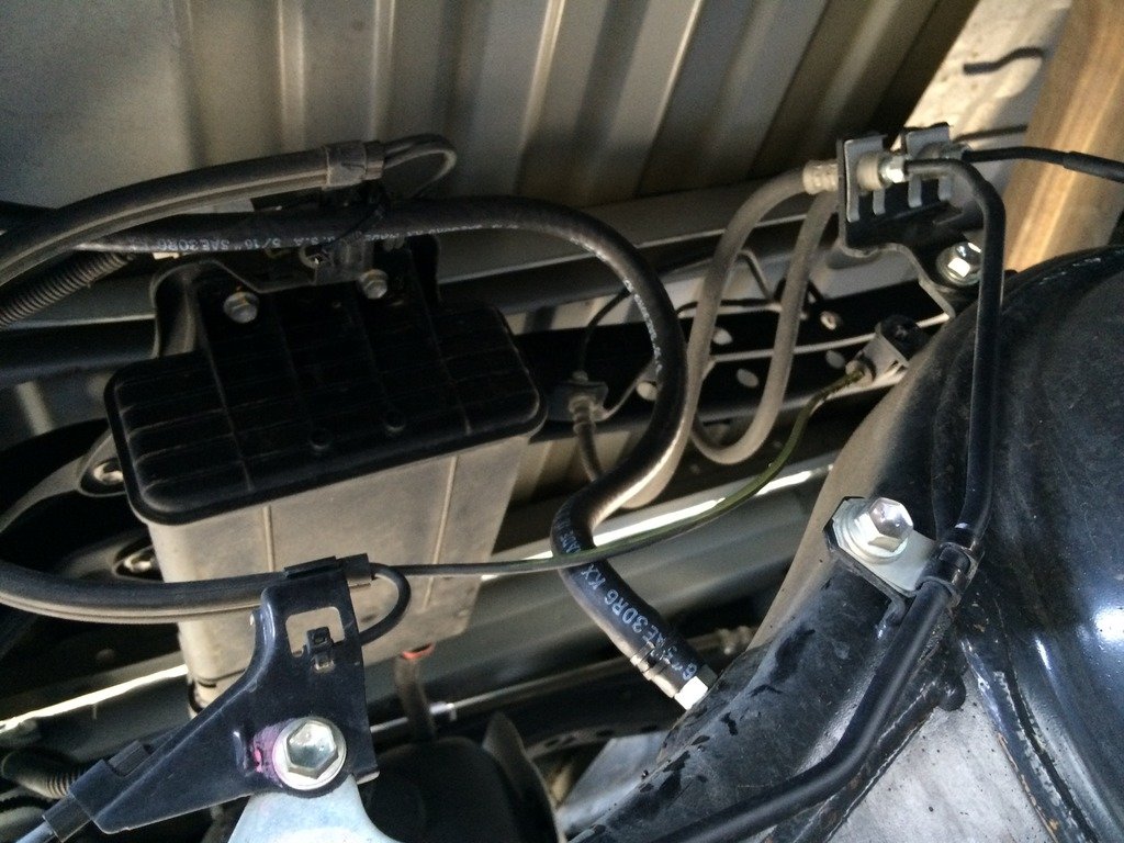

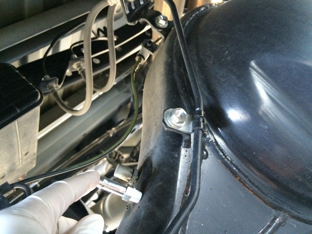

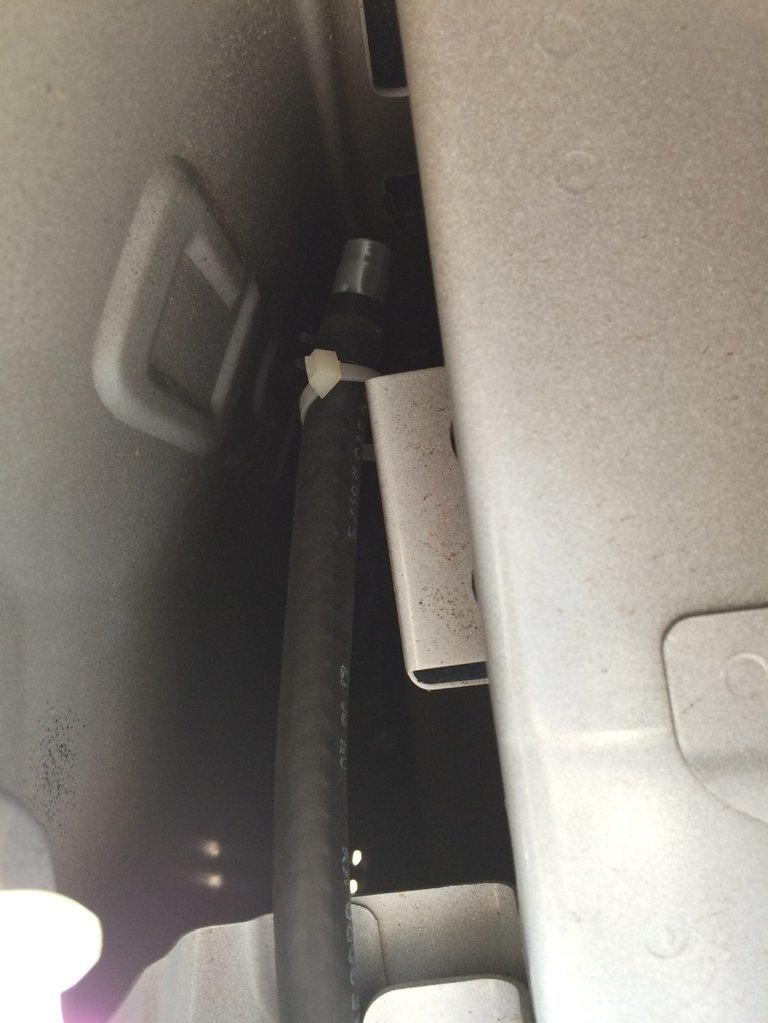

    Right after this run I picked up a RAT front skid, and did my diff breather mod.
    Behind the driver tail. Don't worry it's not pinched. It was actually a perfect spot to put it as it holds up by it self and the breather stays upright.

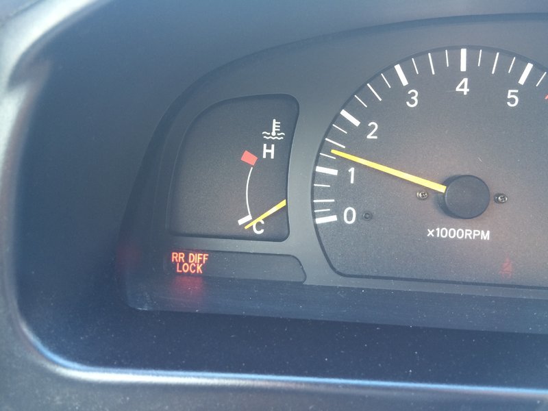

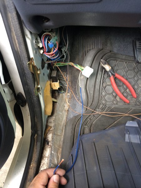

    Did the "grey wire elocker anytime" mod, really cool and easy mod.

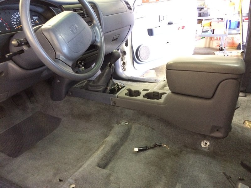

    Little cosmetics; got the 2002 and up center console with real cup holders. Re-finished my grille and compound/polished my headlights.
    Tough decision keeping the chrome, but I'll just paint it later on when I de-chrome the rest of the taco.

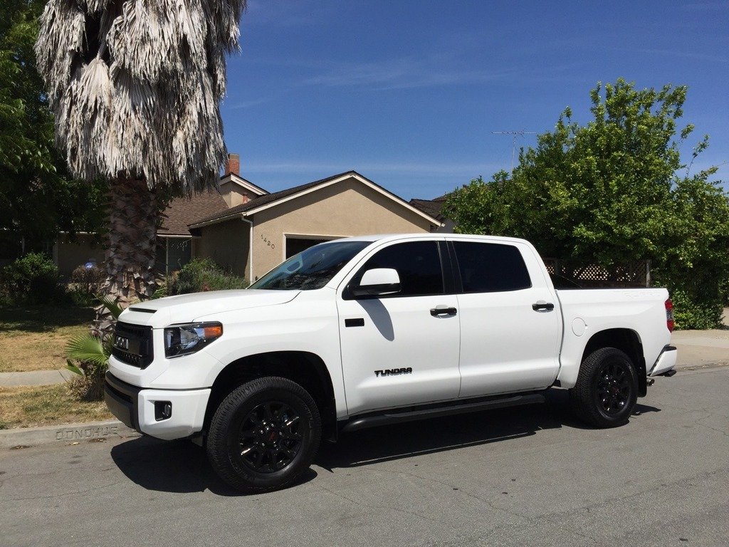

    Now to start with the Tundra Pro.
    This was my first new car ever. Coming from a background of messin with Honda swaps and Lexus' I've always wanted a Tundra since the first gens.
    Main purpose for the Tundra was to tow my civic to the track, but that ended up selling because I had a little halt in my career.
    Here was the original rig I checked out before she said, " you should get what you always wanted."
    And then the hunting went on..
    here is the Tundra when me and my fiancé picked it up!!

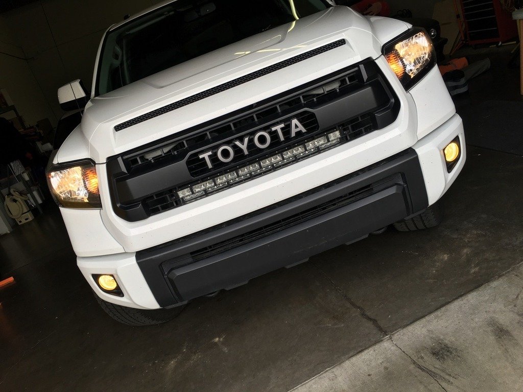

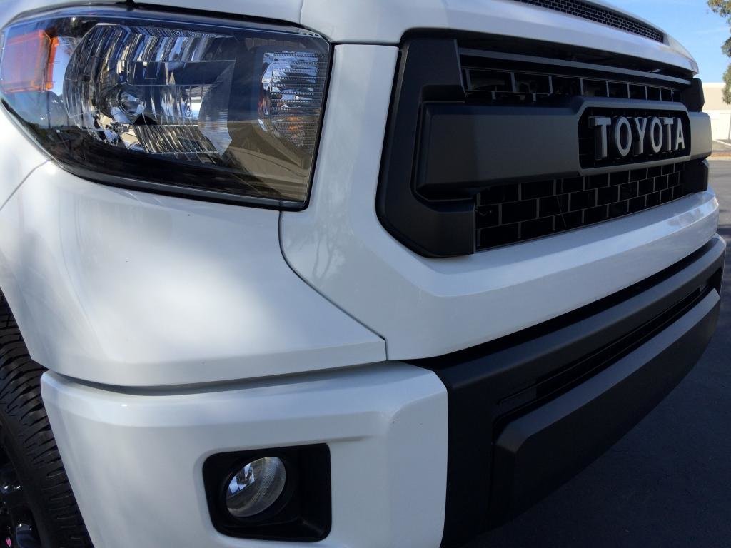

    Yellow nokya halogen fogs installed
    AB0183CE-E3E8-4889-8AA1-9E4B9EDE894A_zps_3aeb4b3ec1c448e112ff1eee9840fcd5cd9c1507.jpg
    20161C6C-B8D1-403B-994E-A1C9C6A9855E_zps_b65eb2ed03e51d58f07288d62845586e3c15d808.jpg

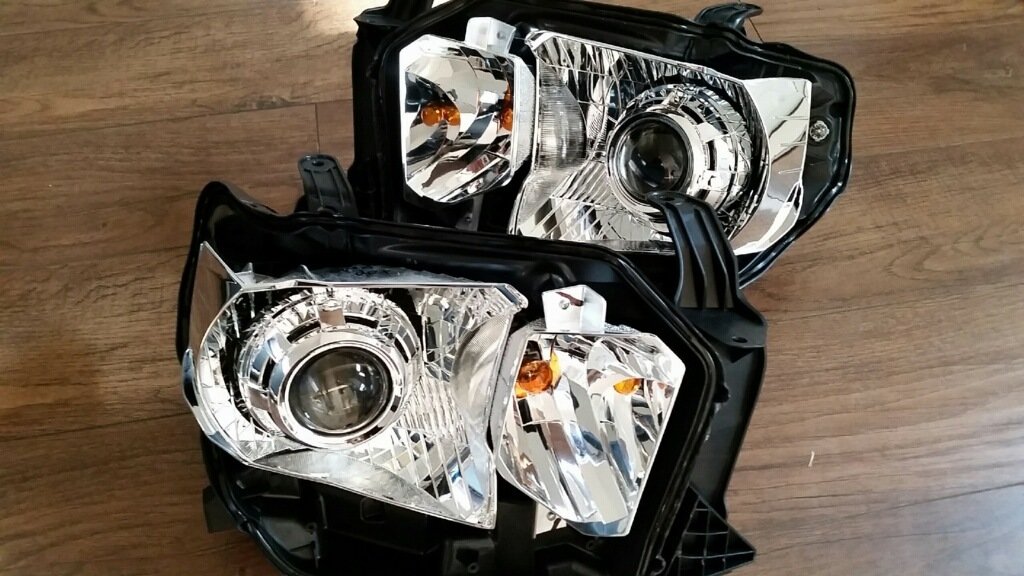

    Got the retrofits going.
    Mini d2s with Apollo shrouds. Kinda wish I bit the bullet and got the ls460 projector for the more authentic oem look and cutoff. This is one of my favorite mods for all the cars I've owned.
    478F80B6-0291-43AF-A0EE-B4DC6FBA4801_zps_ade82f7edfde788d2874bed9da06d5c456aa9ac8.jpg
    61A8FAE9-1AF0-4E56-B34E-93CEEB46C557_zps_c1e244e1f795a85c5bc25fa5251f2966eb9fa576.jpg

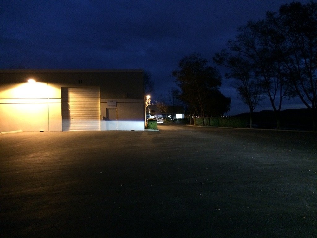

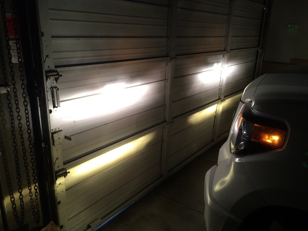

    This is from about 25-35ft ish.
    BEAF3DB7-5B19-4EF5-A69A-D58C15B9170E_zps_bd78259b517874fc356ee1d9eb2375344c08bddb.jpg
    A bit scattered light but it's not noticeable on road and doesn't blind oncoming traffic.

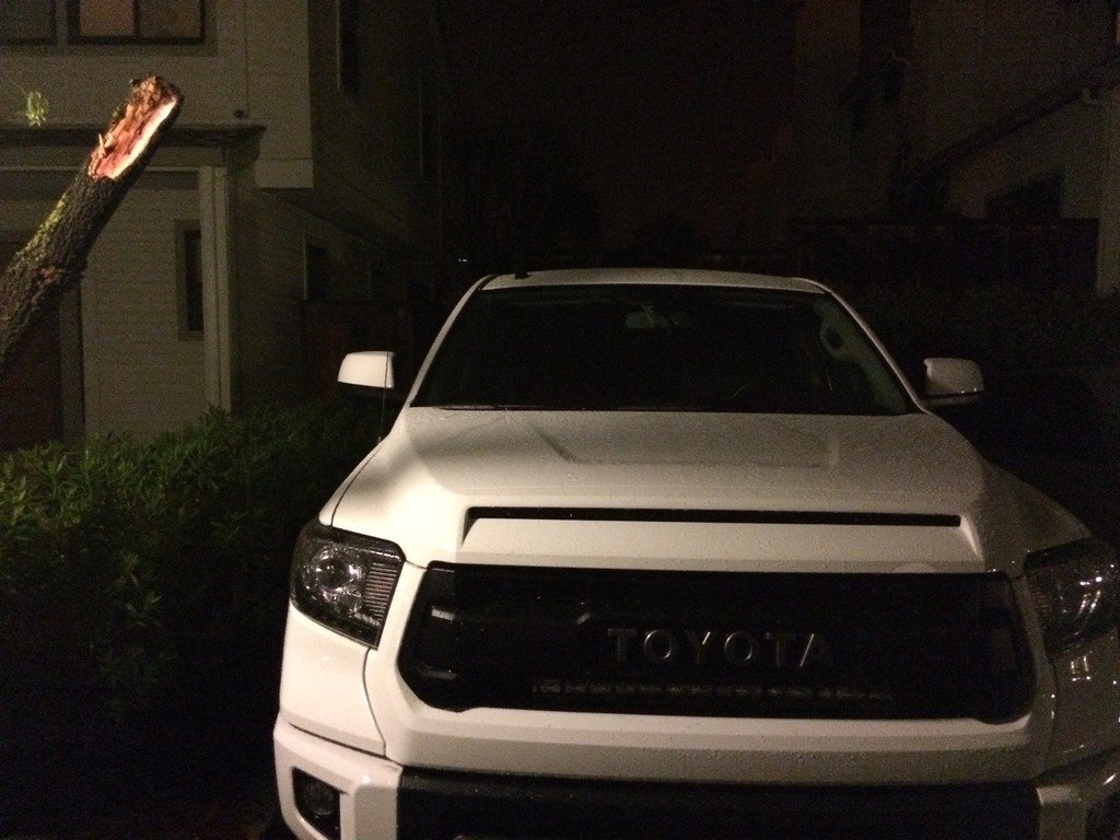

    Had a bad storm one night and got lucky on this.. Or did I? Let's just say if it did hit I McNeil fenders would've been in.. Maybe hood?
    496B7B79-2B1A-4C40-A7AF-62E3DC0B1748_zps_4564bada182e171cd5e6bf799e671fb3944f4a0f.jpg

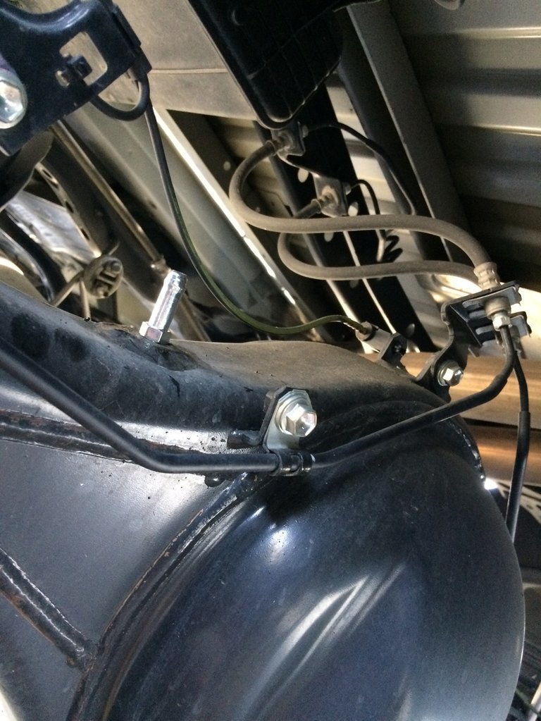

    Ok.. Back to some mods.. I got more diff breather parts and did the tundra as well.
    E16AA888-46C9-4A65-80DC-47B7143C03D3_zps_e15e9c4721086f101b0b5121cdfe43a57252218b.jpg
    7A55505E-383A-4DE1-894E-117573419366_zps_4afe8c5a18eb69f01ecd9ac174dc391de4d4cbc5.jpg
    Same spot as my taco. Behind the driver tail.

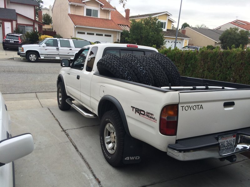

    Loaded up the taco with some dirty fives!

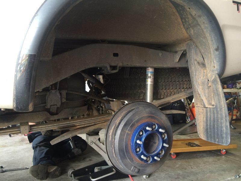

    +3 CB shackles going in!!
    1C296AB3-5B27-48E1-BF45-F20AE2D3B86E_zps_e3a956c0fc6a924c4d2a80027ff4eb546757cf49.jpg

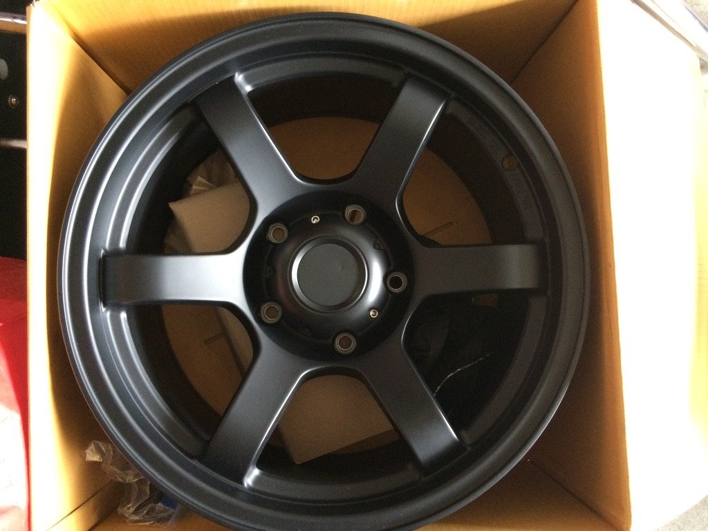

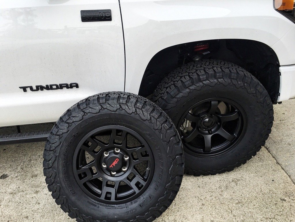

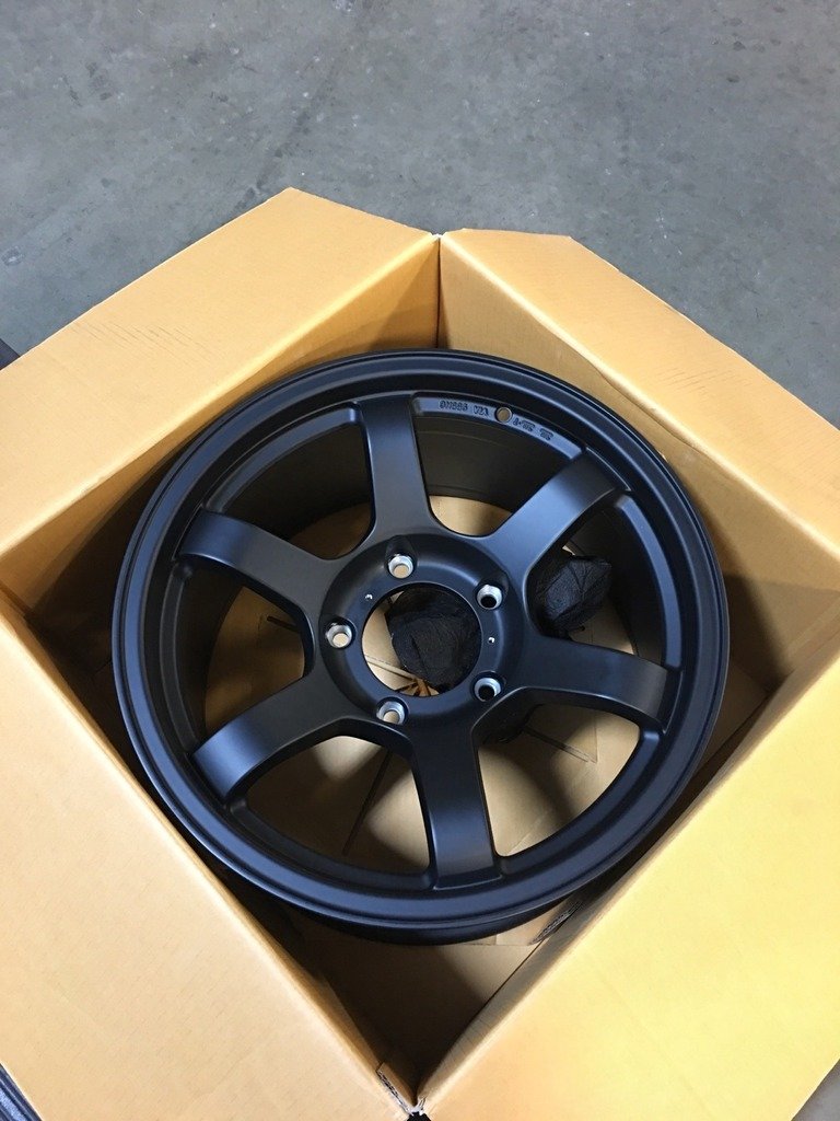

    The wheels came in!!
    18x9 +12 FN BFD !
    Dustin @JdMeF9SiR2 came through with a clean "blemished" spare.. Really didn't find anything wrong with it..
    9B523CCC-B308-4B2A-8AC2-4BA50068E5A7_zps_06e9e937c712dd6be5bd34cb995e7bc54f66157d.jpg

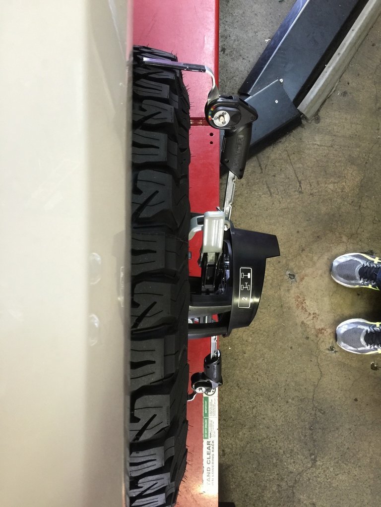

    Yup 2 sets of tires fit. The set of 285s and the 35s ready to go mount!!
    1687BE24-322F-47F1-8708-709B2DE115D5_zps_1d0b29901c7fbc3b1b2426e6b51803e53170ef27.jpg
    That +12 poke
    70D8AE27-A687-4332-AFBC-7059C62CE081_zps_bf78b2339221f344141974dd9e6a39f45776dcec.jpg
    6D954397-9879-49C9-9AAC-D3DFF83EE4AE_zps_4353b5528e1cafcea6f4af5d7a00141056654006.jpg
    Dialed in recomended specs

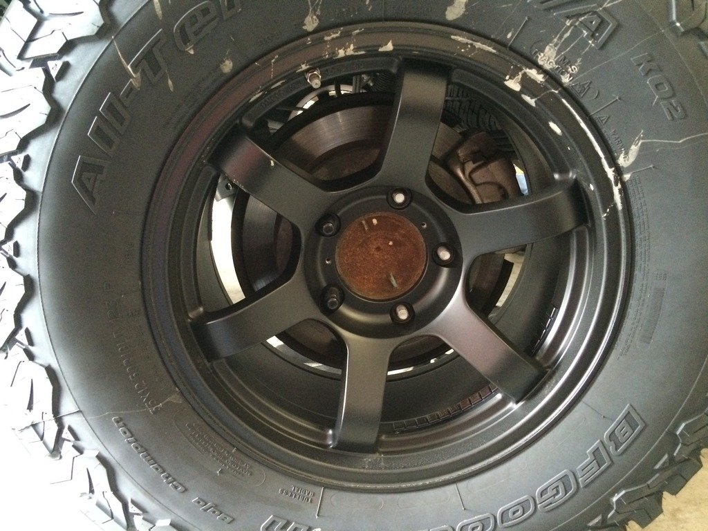

    That rusty rear cap really did bug me. I didn't want to run the fn centers because the screws was silver (getting black screws ordered)and the cap just wasn't appealing to me.
    79FD5A54-5778-452F-919D-7CA5E72C1C25_zps_8b896961d4e2798fd938140e75c9f04e30158e8a.jpg
    Welp I decided to buy some front hub grease caps and modify them to fit the rear.
    Came out pretty good.

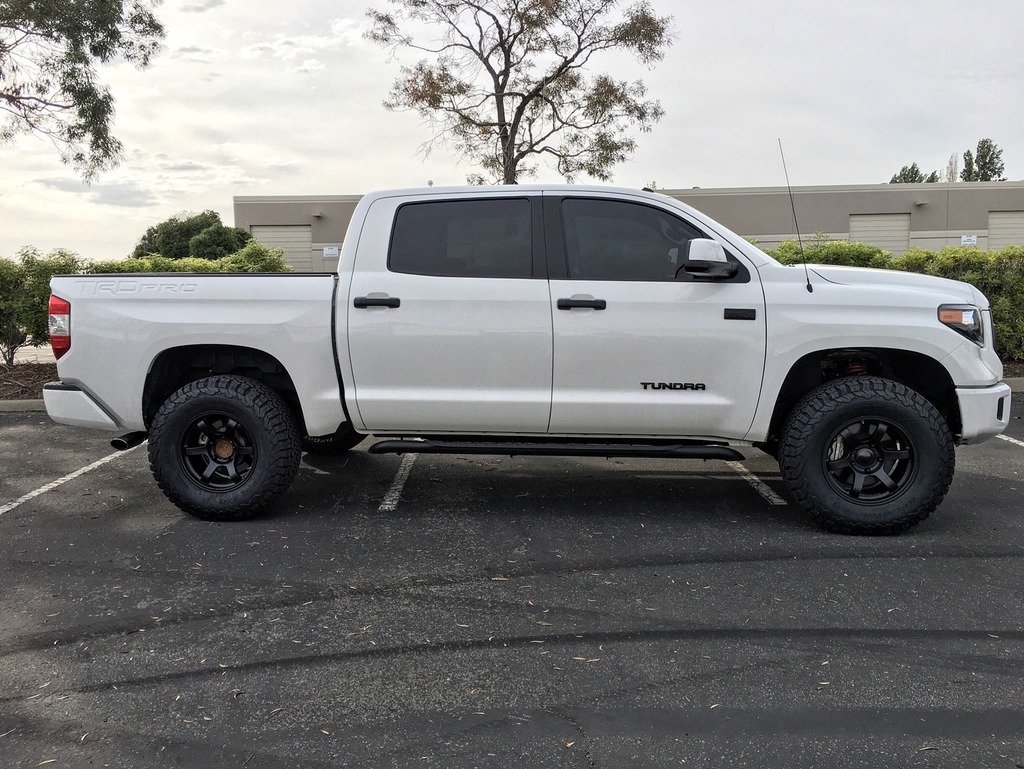

    And this is how it sits as of now..

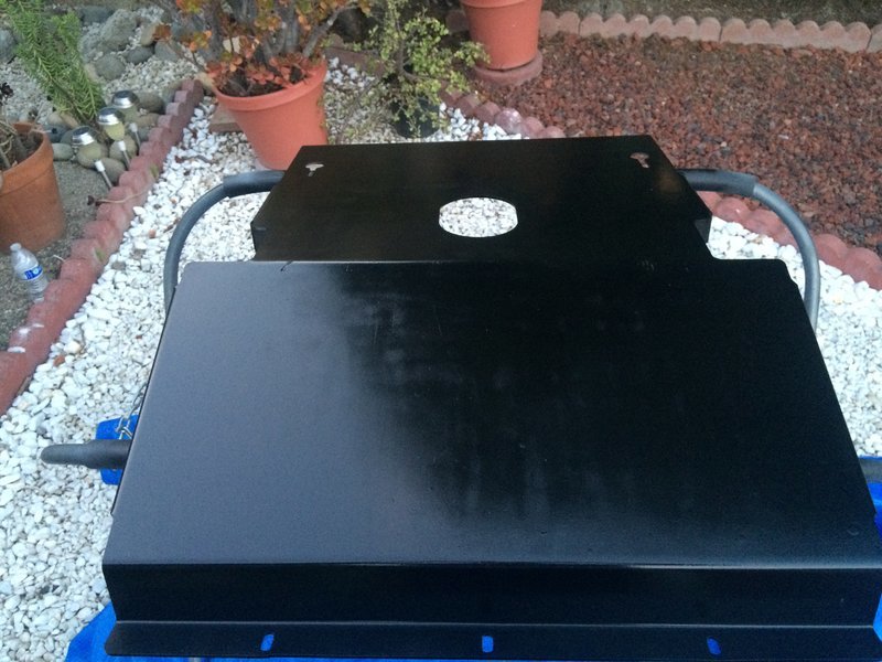

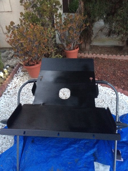

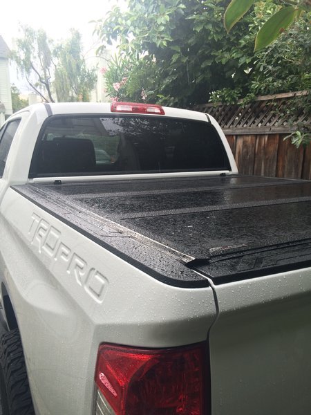

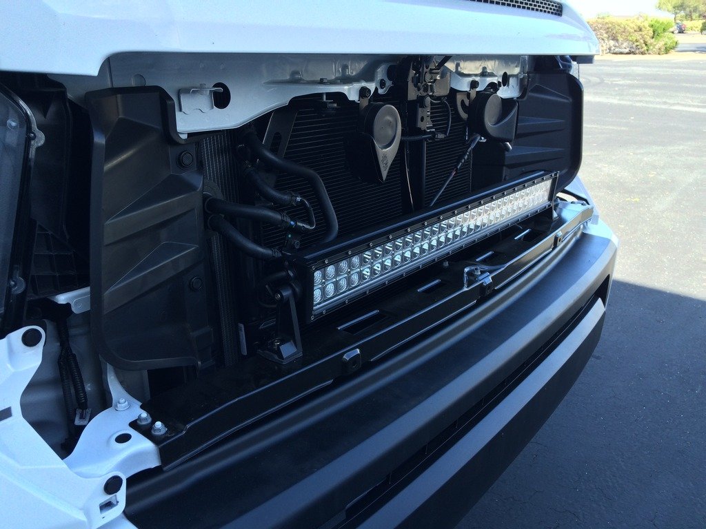

    Tundra cleaned up! Also got a free hid kit from my buddy. Decided to run them for a bit until I pull the trigger on a retrofit kit.

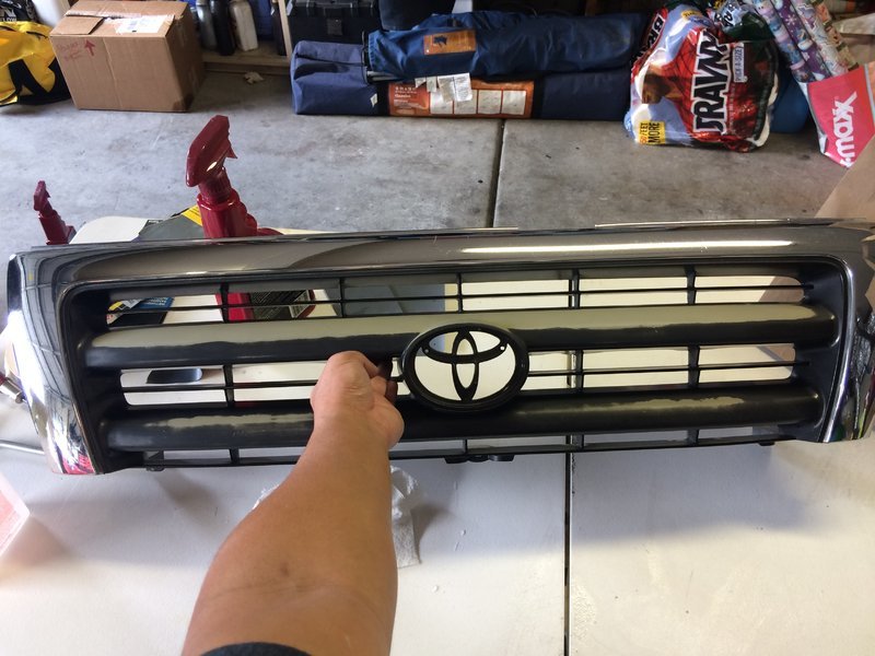

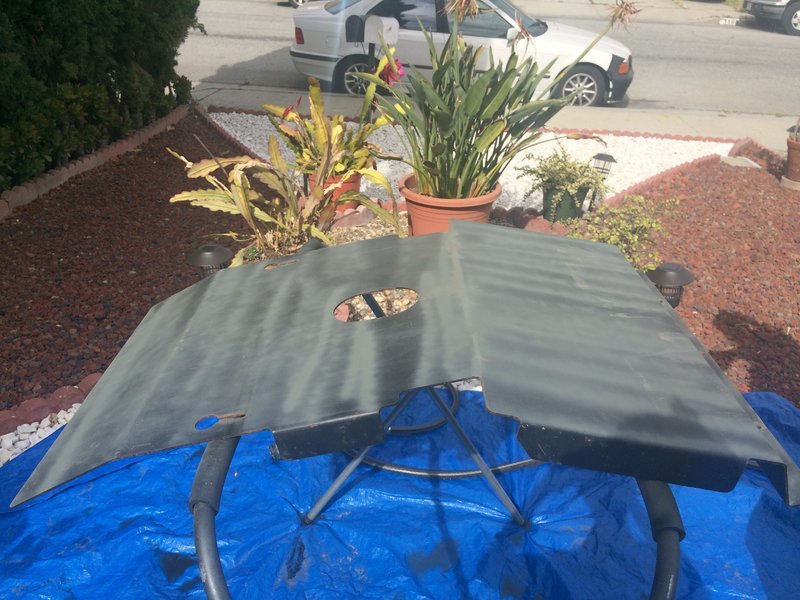

    Got a undercover flex off craigslist for a steal! Reconditioned it and brought some life back to it, but it does the job! Just need to redo some weather stripping getting a bit of leak towards the tailgate.

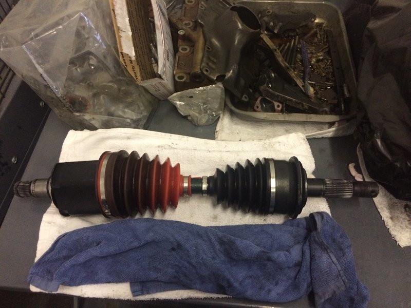

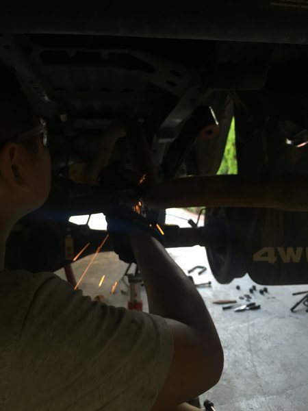

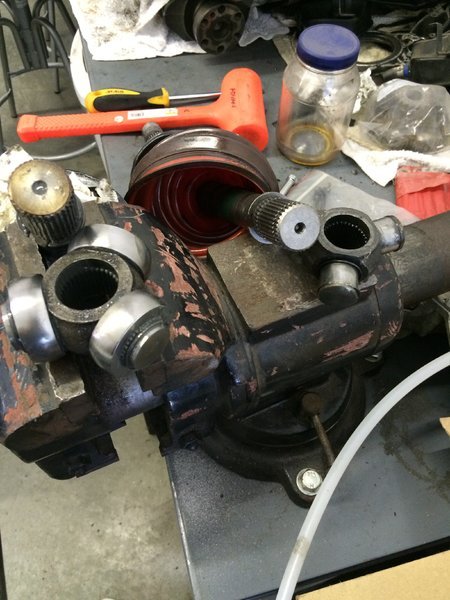

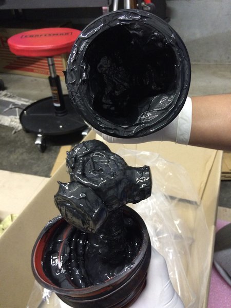

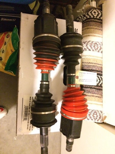

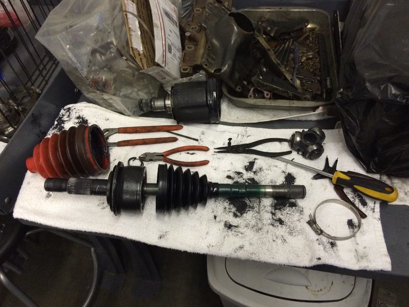

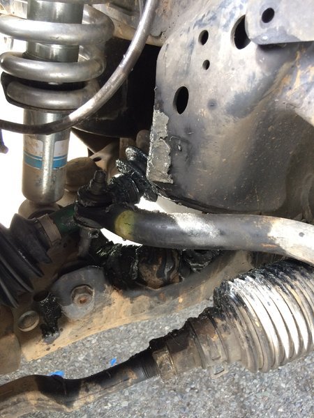

    So it was inevitable.. 190k of axles lift @188k.. 3 wheeling trips..Boots weren't to happy. With the new angles.

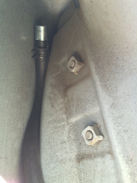

    So I bought some used hi angle booted Inners, oem axles, and turned out one bearing slipped off the tripod. 1 was rebuilt. The other one and a couple thousand miles on them.
    Long story short and a sh*t ton of mess.. had to rebuild and reboot. Came out good. Just checked my clamp earlier today and looks like I can tighten a bit more as grease is seeping out..
    I trashed my old axles so gonna turn em in for some duralast golds and reboot those. I plan to boot slide mod both inner on the next project.
    Thanks to @akamrkent for this write up and helping me out!
    https://www.tacomaworld.com/threads/high-angle-inner-cv-boot-with-boot-slide-mod.382314/
    image.jpg You can see the bearing that came off the lobe.. And all those roller pins(not sure what they are called) are all over in the boot.
    Outer needed to be replaced it had some seaping. Grease from age cracks. Bought a oem kit. And replaced just outer kept inner for emergencies.
    image.jpg Pulled off the tripod old axle
    Finished product. I used a thermostat gasket on the inner boot to keep the fins a little gapped when flexed.
    Headache rushing this stuff and ran through a good amount of band clamps.. Next time I'll be using ear clamps and taking my time..
    But happy how it turned out and it's on the road again!

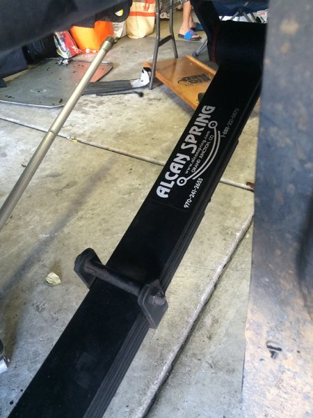

    Just got some Alcan leaf packs from @bteck slapped em on earlier today.
    Re clamped my cv boots:fingerscrossed:
    And topped off the front diff once again.
    Also sanded and repainted my rats skid plate.
    Going to torque everything down again after a few hundred miles.
    99SuperTaco4x4 likes this.
