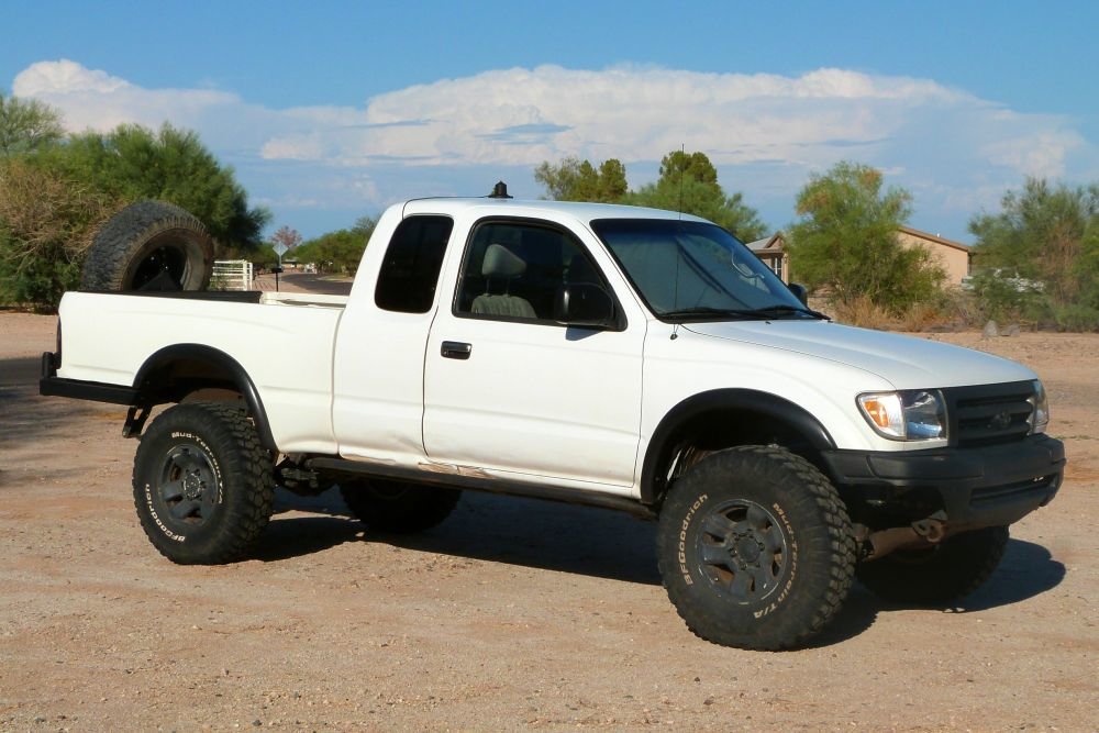

    Setting up for some night fishing at Lake Pleasant...

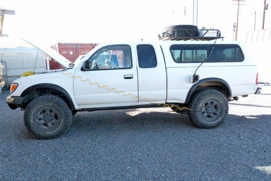

    Bilstein 5100 front and rear, dakar leaf pack, fuel hostage wheels, 285/70/17 Trail Grapplers M/T, color match shell, rola rack, hi -lift, dual cb antenna's with 520 XL cb, sandblasted bumpers an brush guard to paint black, color match grill, blacked out badges, and much more.
    like the rack on the shell set up man. and also the swing out tire carrier looks good man.ive got the same set up minus the swing out.

    Thanks... I had to do some minor work to make the rack connect to the shell strongly, but I suppose eventually the fiberglass will start stressing and cracking. Could be another year, could be 5 years. Then I'll just go back to the way the truck was before, sans shell :notsure:

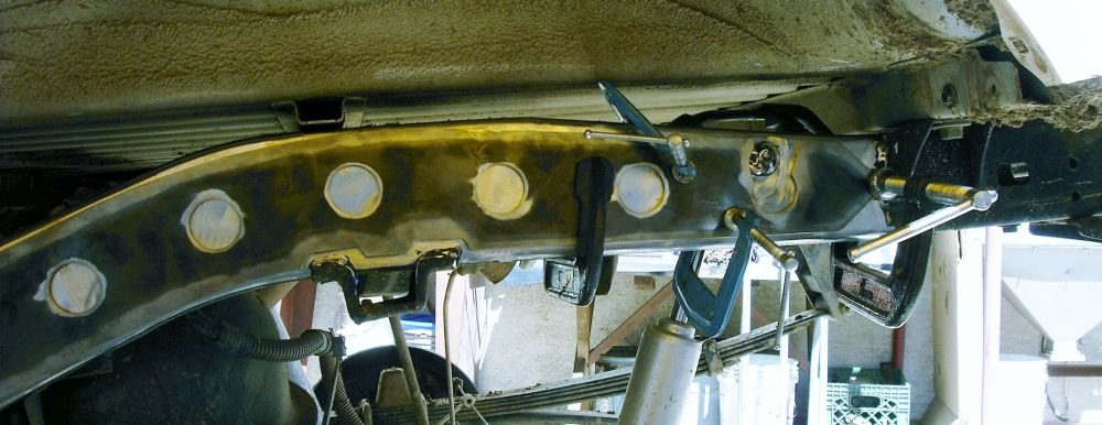

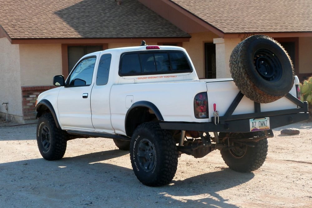

    Speaking of sans shell, I took it off in the first step towards welding the rear frame reinforcement plates onto the truck. I have only taken the shell off once before, for about 6 months, since I initially put it on. I'll probably keep it off at least 6 months... maybe until next summer.
    When the frame reinforcement are put on, I plan on adding some angle iron between the main frame rails, near where the stock spare is located. It might add some additional rigidity, but I want them there for future mounting purposes, in case I eventually add a fresh water tank.

    Cool build, sir. Your rear bumper is making me jealous.

    Thanks... it's certainly strong and simple. I'll get some hi-lift mounts on there eventually. Actually I have a lot of little things to do once it cools down some.
    Thanks, without the shell that rear spare looks HIGH! I actually prefer the shell as well, but it's nice to change it up every once in a while. Still, I wouldn't have taken it off if I didn't need it off for the rear frame plates install.

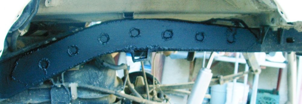

    With dove season over and the archery elk hunt complete, the Tacoma is on stands now... the to-do list is as follows:
    - new steering pump
    - new master cylinder
    - new brake booster
    - new black corner lights
    - weld rear frame reinforcements
    - add 2 extra bolts to rear bumper
    - new belts
    - new door handles
    - fix heat shield above the cat
    - new ac/heater blower
    Once that is done I'll re-paint frame/sliders/wheels/etc with rustoleum satin black, get tires rotated and balanced, and alignment. It should be ready to go for my 4x4 trout-squirrel trip in mid-October.

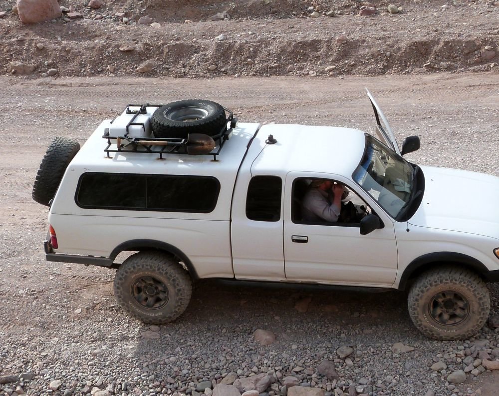

    Mogollon Rim trip report! (if you can call it that)
    I'm not sure about the ultragauge, it kept throwing alarms when I still had over 1/3 tank of gas... gonna have to figure it out and tweak it.

    You got anymore pics of your roof top fuel tank set up? I've thought of doing that with my boat fuel tank too
  13. Oct 19, 2013 at 7:34 PM
    #53
    Buckoma
    Buckoma [OP] Well-Known Member
    Jan 26, 2013
    #96125
    978
    Buckeye, AZ
    2000 SR5 TRD 4x4 Ext Cab V6 Manual

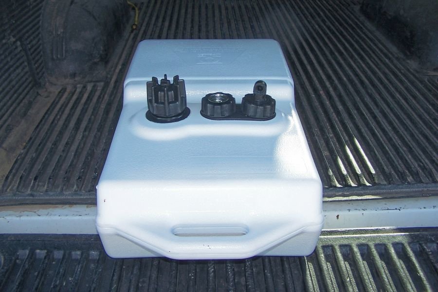

    Here's a few older pics.
    This is the 9 gallon tank. I painted it white because a big red tank up there would look silly. Of course a few years after I created this set-up, they started selling those red modular/stackable gas cans that people put on their racks. At least mine's white and I can refuel without taking it down :cool:
    I made a little custom fitted hinged bracket to secure the tank, it attaches to the non-hinged end with a large wingnut. Very secure.
    This is me airing and fueling myself during a trip in New Mexico. I jumbled together some hose, a primer bulb, and a connector to the tank. It takes about a minute to set up and prime it and once it starts flowing it takes about 6-8 minutes to drain 9 gallons. When I need to put gas in the "fuel cell" as I call it, I just stand on the tailgate :rolleyes:
    This was about 500% cheaper and easier than doing a "real" aux fuel tank, and since my truck is beat up and nothing to look at anyway, it just fits the hard-nosed motif :D

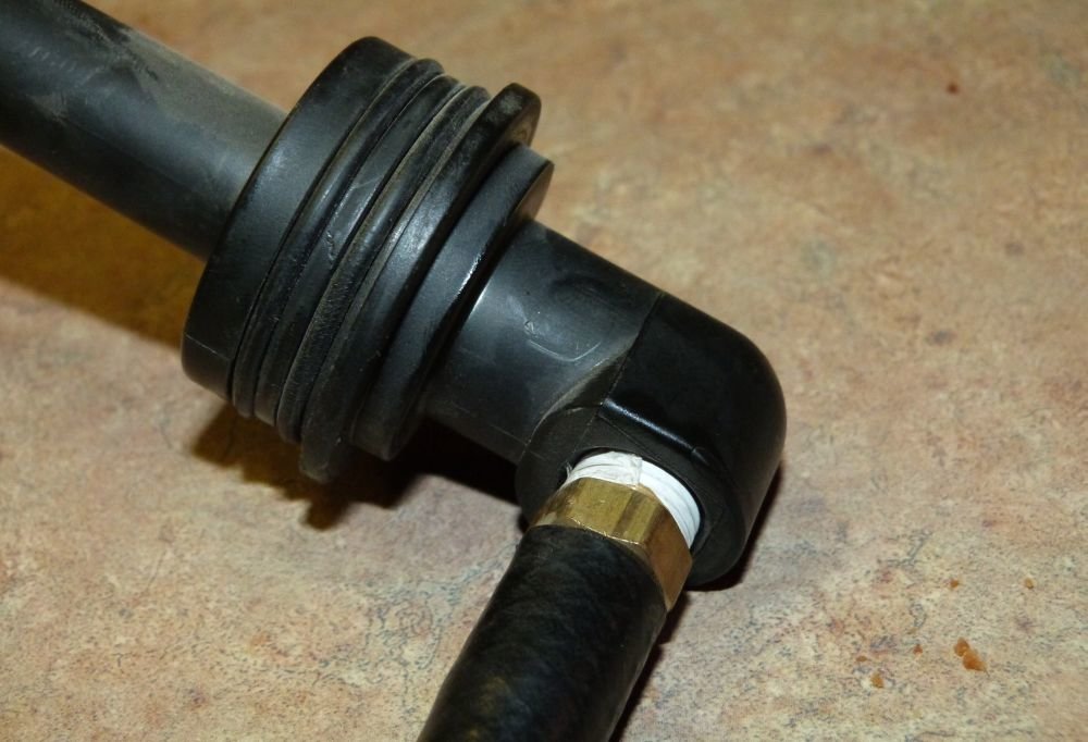

    And sorry let me re-phrase my question. What do you use as a nozzle or spout at the end of the hose going into the filler cap to the trucks fuel tank? I have all the other pieces from my boat tank already but the end of my hose that connects to the engine has a connector to attach to a boat motor.

    I used to have a neat connector/adapter that was similar but just hardware, all I had to do was screw it in and push a hose on it. That was lost on a trip some years back so now I use my extra outtake nozzle with hose attached and pop it in when refueling.
    I'd imagine there are many way to make something work, probably better than mine... I just just tend to go with what works and not worry about things much :rolleyes:
