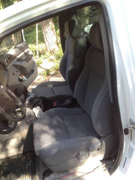

    A D/S bucket seat is a very close reality.
    After spending a good while figuring out how to mount the seat, I think I've found a decent solution. As of now, I have 2 mounts affixed; the LF mount and RR mount. I will need to put some time into the LR mount to make it more secure. Since I have a LF and RR mount only, it still flex's a little if you push down on the LR portion of the seat.
    I'd really like to get it back together by the end of tomorrow. Riding around without the back support section of a car seat fucking sucks.
    I did drive around on the Civic seat base and cushion...very nice. So much better than that damn bench seat. Add a layer of memory foam into the seat cushion to make it even better.

    Just installed my buckets, the tear down was hell at spots but it was so worth it!
