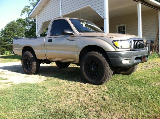

    I got my 2001 PreRunner in 2010 and got the itch to start fixing her up and here's the result.

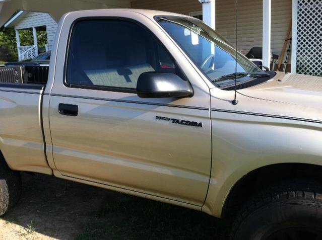

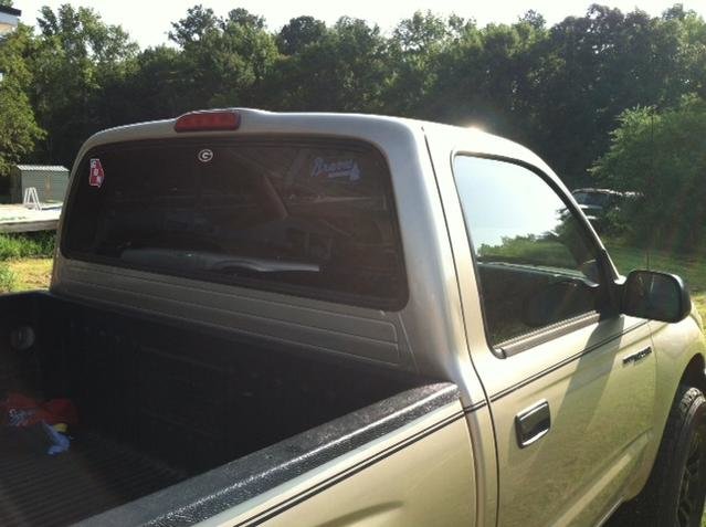

    First, was tinted windows: 20% on the sides and 5% on the back

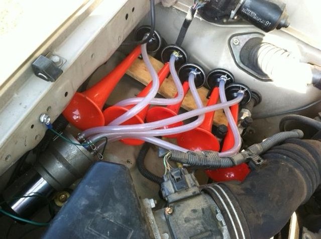

    Second, was the dixie horn...the g/f was THRILLED about this one lol

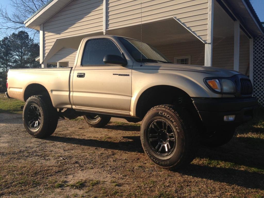

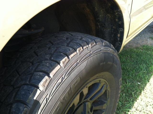

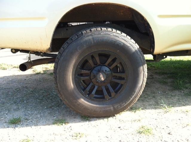

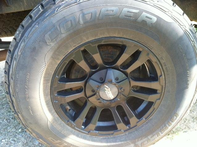

    Third, was new tires and wheels: Cooper Discover ATP 31's and 16'' MB Wheels

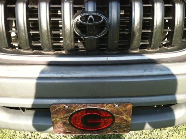

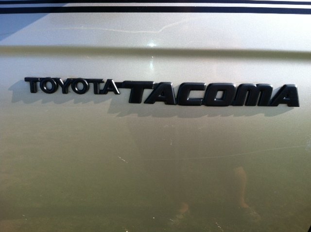

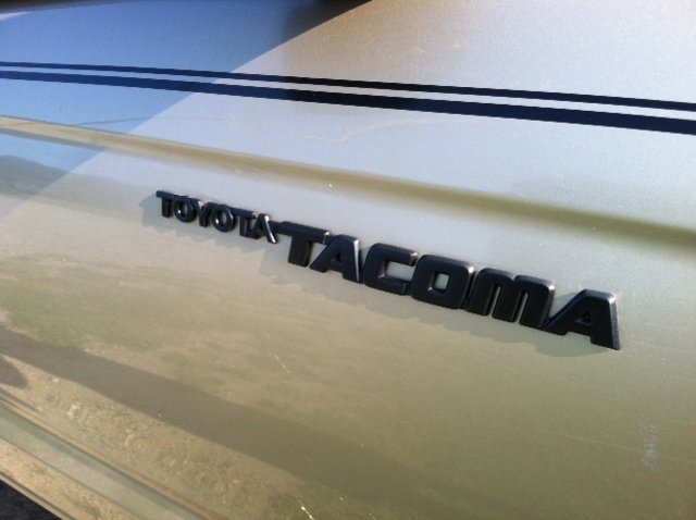

    Next, was to get rid of all the chrome...blacked out the Toyota logos

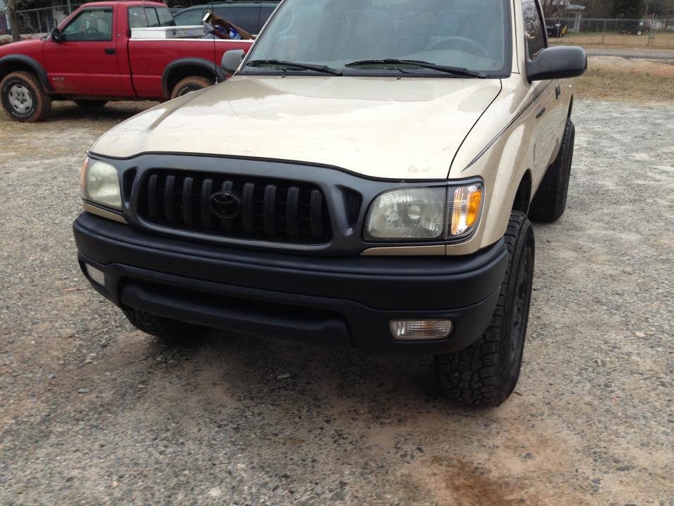

    Next, was blacking out my weathered grey front bumper

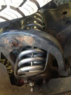

    Next, was Bilstein 5100's and Eibach's in the front and the ToyTec AAL in the rear
    Next, was the deck plate mod

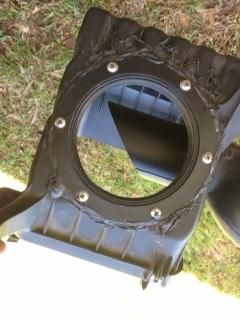

    Next, was the Satoshi grill
    Next, was a Black Kobalt Toolbox

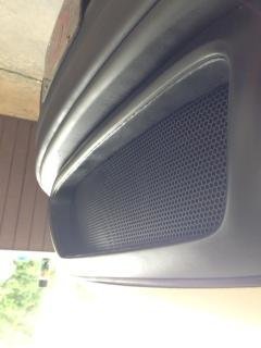

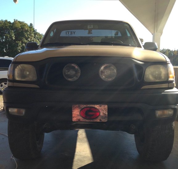

    Next, was Hella 500's behind the Satoshi

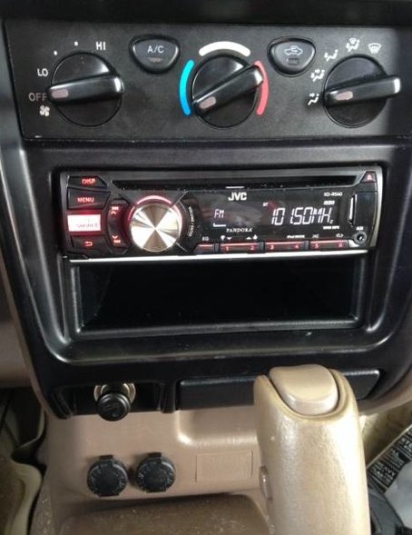

    Next, was a new JVC CD/mp3 player

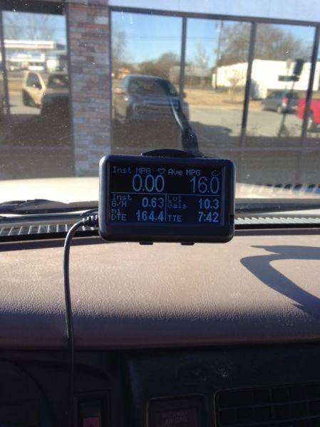

    Next, was the Ultragauge

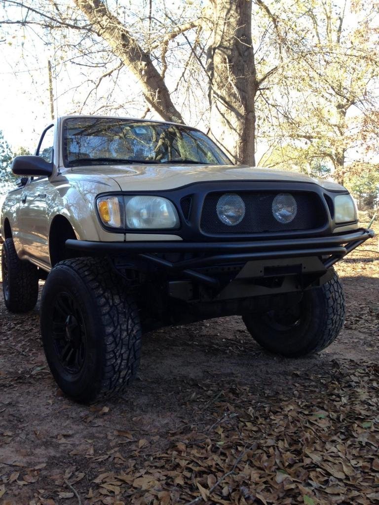

    Next, was the Trail Gear Rock Defense Front Bumper
    Next, was the blinker relocation mod

    Ties & wheels:
    Blacked out logos:

    Hella 500's:

    Ultragauge:
    TrailGear Front Bumper:

    Thanks! I think 135dB, but I'd say they're about 2x louder than the stock horn.

    I bet those horns get peoples attention.:eek: What kind are they? How was installation? I think something like that would be good to have.

    Not sure what brand, but I think they're a spin-off the WOLO horns, which are twice as expensive, for the exact same product.
    Installation was easy, but took about 2 hrs. I just mounted all the horns to a 2''x10'' piece of plywood and put them on top of the passenger wheel well. I mounted the compressor on the wheel well and just cut the wire from the stock horn and ran it to the compressor. Mostly wiring and drilling.
    And, yes, every time I honk it, heads turn lol

    For the emblems, I just sanded down everything really good a few times and sprayed it with black rustoleum and stuck them back on with that 3M automotive tape. There's a thread on here how to do it. BE SURE to sand all the chrome off the emblems or the paint will chip over time. I sanded the hell out of my side emblems and they're great, but my front emblem is chipping, so I have to re do it. Also, put a hair dryer to the emblems to get them off...it melts the glue.
