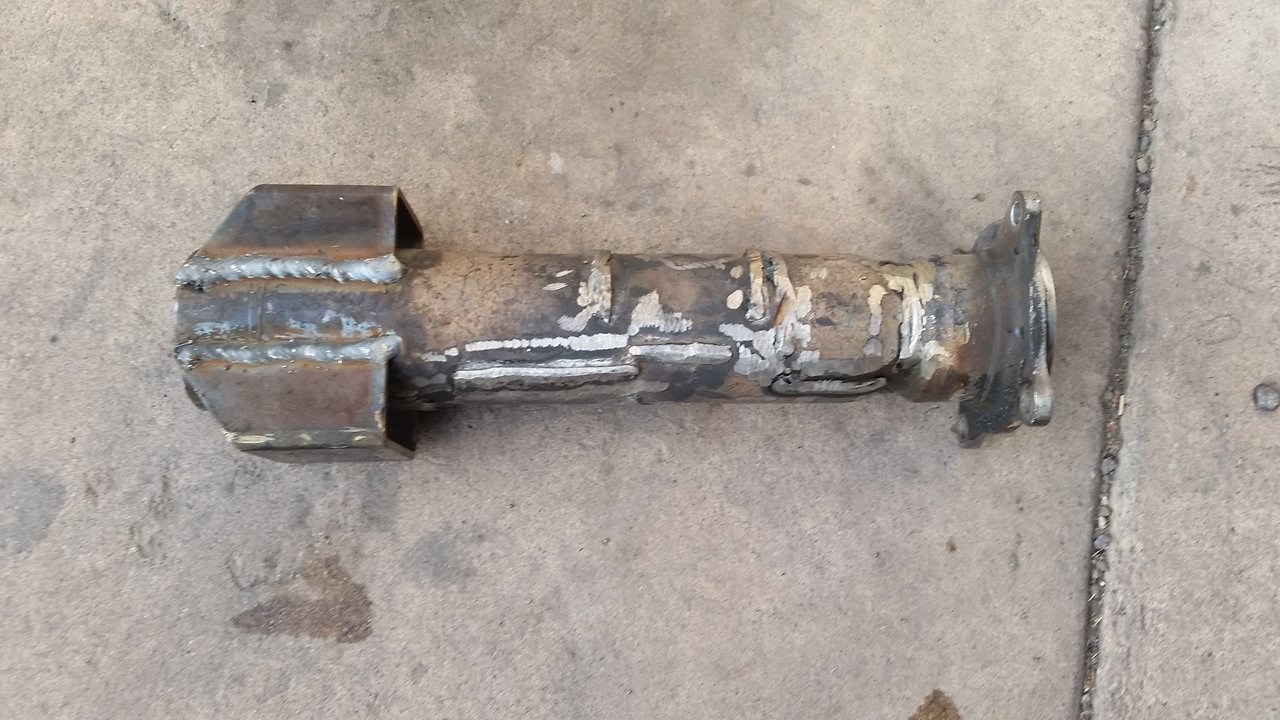

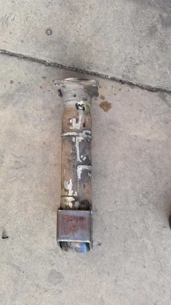

    20171112_160450.jpg This is a tool i made for about $25 and 3 hrs labor.20171112_160458.jpgcut off an old 4runner axle housing.

    You still have to install the ring the seal rides on. If you measure it before you take it off. You should be pretty close

    That thing is brilliant. I have been looking for a cheap/bent axle housing to make this. My alternative is to just fabricate the entire thing.

    The other half of the axle was scrapped.:(:(

    No worries. It is never a priority until it is. I will eventually build one as I still have those chomo/cryo'd shafts I need to install. But have to get an abs eliminator ring first like Marlin made years ago.
