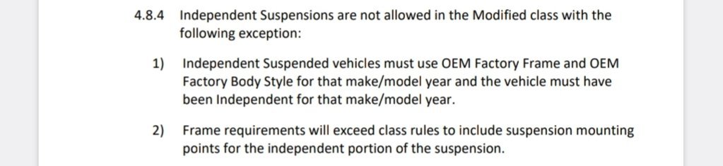

    Ya, I'm looking in to a bunch of ways to reinforce the front end.
    ULTRA4 4500 specs say no IFS allowed unless
    This is an Easter Egg for those paying attention
    OEM Factory frame / body style for that model year, BUT the frame requirements will exceed class rules.

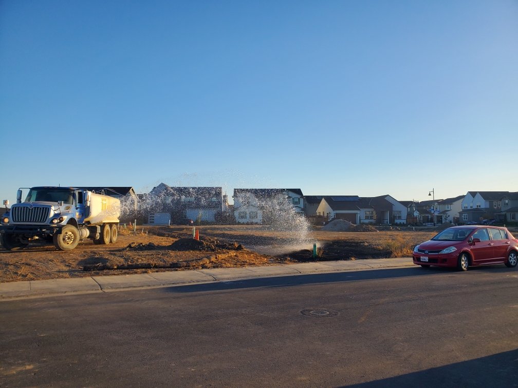

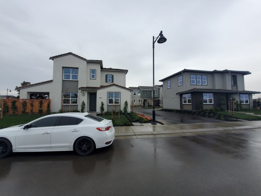

    43 business days for these 3. (Models)
    Business day 1
    Business day 43
    realsystem and theesotericone like this.
