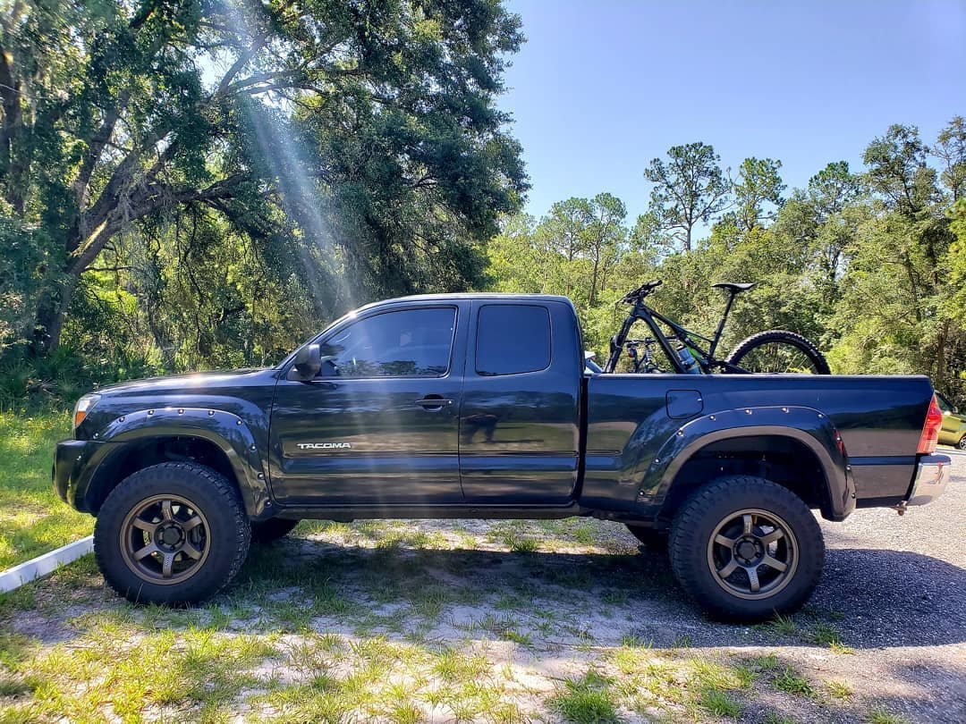

    Hey guys, I hate to do this but I need to thin the herd as I am running out of room for vehicles. The truck is up for sale here: Been stored in one of my warehouses for the last year and I feel bad that I don't get to drive it much.

    This makes me sad. Really liked following this build. GLWS man!

    Whomever gets it, will have a very fun truck, with a properly built turbo kit.
