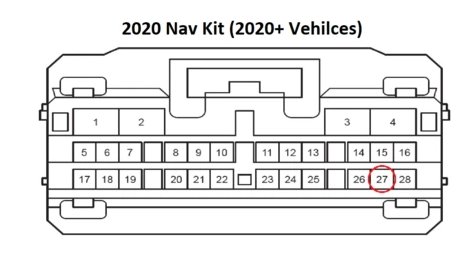

    I was thinking about doing this. So you cut the wire on pin 27 and nothing changed?

    Same as if nothing was done. And my switch is good, the circuit is really open in one position.
    Have worked on something else since my post, but I will try to monitor the pin when moving and not moving, to see what kind of voltage is there. Maybe it need a pull-down or pull'up resistor on one side...

    I really thought this was a 12v or 0V circuit. That's how it worked on my 2014. Let me know if you get it figured out.

    Perhaps ground it, like when installing an aftermarket stereo to allow DVD playback while in motion?

    2016+ it’s a speed sensor, something like 0 to 3v, but since 0v is not moving cutting it works fine. BUT is does effect the GPS resolution, so cutting it and leaving it cut means your gps is slower to update, which is why a switch is better. No idea on 2020+ though, but from the link above one would assume it’s the same (which doesn’t seem to be the case from StephB post)

    I would think it would work the same on 2020+ since anytimebackupcamera.com sells a kit to override it by simply cutting the wire and adding a switch. Plus I doubt Toyota re-engineered the vehicle speed sense.
