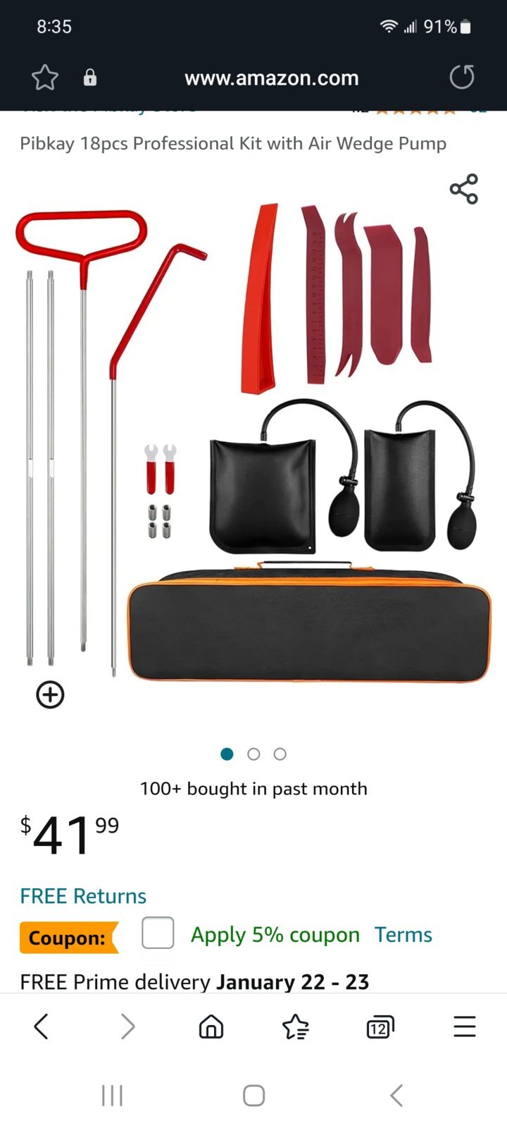

    This will be your best bet. Wedge the door and open from the inside

    Get the kit or if you dont mind scratching up your truck take a big screwdriver to the top corner to wedge it open a bit. Then bend a coathanger just right to get at theinside opener
