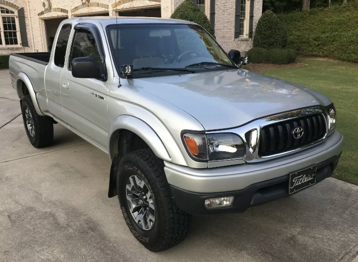

    There’s a reason they have water in them. I’ll probably install the regular ones for now and try to reseal them but I’ve not had good luck doing that in the past. They are a clear lens with black inside. But I would also like them to match the chrome grill. 372B18A7-B8C8-43A5-9CF2-ACD2585C4296.jpg

    If you press enough silicone into the seams you’ll make sure there’s no condensation or so little you could dry it out right before the inspection. That was mainly my point - not that they shouldn’t get replaced since you want the look to match.

    When u buy new ones silicone the edges with blue rtv or something else. Did that with my spyder ones from fleabay and haven't had an issue. It's worth the 20-30 min to do em both

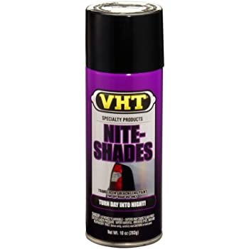

    Maybe use some of this?

    I used that before - it's a good product and gets you a good amount of tint. It does fade even when clear coated over though. Using a 2k UV resistant clear *may* increase how long it lasts though.

    I live in Mass- no tinted lenses- that’s why I’m looking for the clear lens with the black reflector and orange reflector on the side
