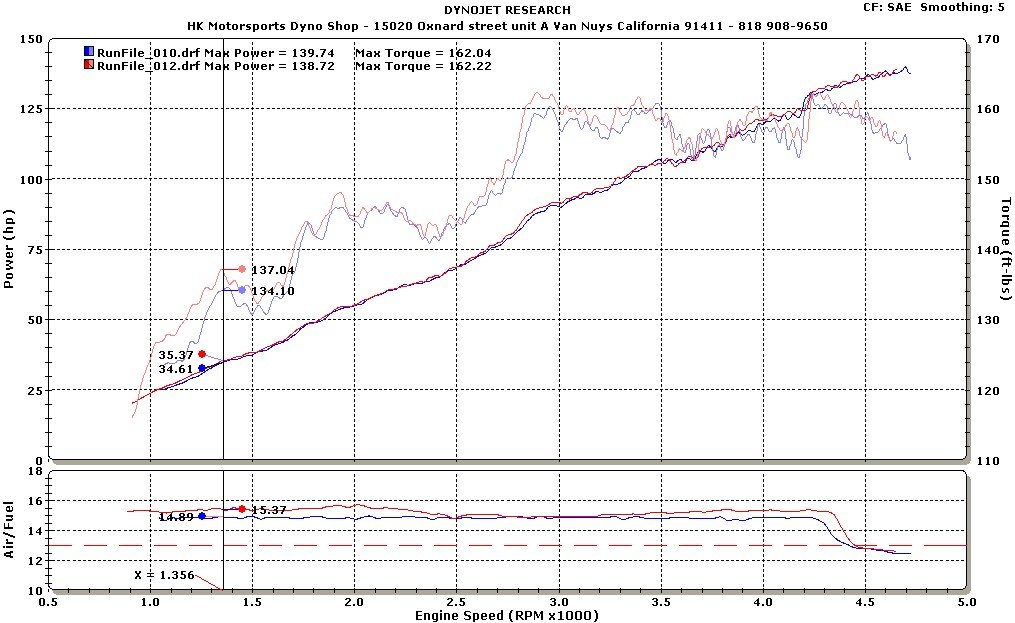

    http://www.fjcruiserforums.com/forums/attachments/introductions-new-arrivals/16569d1192723493-hey-guys-515-l-dyno.jpg
    Headers are the best exhaust mod you can make but the gains are over 3000 rpm...
    so get the loudest muffer you can stand and or headers, intake spacer, air filter, delete the pcv valve and silencer filter and reset the computer.....
    Above 3000 rpm the truck will be faster..
    Ultimately we will all need a good tuner but the jury is still out....

    My own personal experience is different from yours...
    Dyno results showed that torque actually did slightly improve under 3,000 rpms just by changing from the Magnaflow to a Flowmaster.

    This is what I'm trying to tell people, just changing out the muffler is the best value unless you want more power at higher RPM...
    But you used a smaller pipe for low end, I went to a larger pipe for mid range and we are both happy....
    I read tons of post before I did mine and went with the 2 1/2 and it was too big and lost low end but it did accelerate better and hold speed on the hwy much better but towed worse. Adding the spacer made it better from idle... So I'm letting people know that if the want more low end don't go to a larger pipe and just add the muffler you like and if you get larger exhaust add the intake spacer...

    Your results were different than mine because you were tuning for low end with a bigger muffler and smaller pipe and you already had a header and spacer on the 2.7...
    I put a larger pipe with a smaller muffler on a almost stock V6... I had to add the spacer to regain low end... Now I think it makes more power from idle to red line. I know it pulls harder and revs quicker. I hope to get to the dyno or drag strip to get some data for people.
    I found both header dyno charts... The long tube headers loose 28lbs of torque at 2000rpm but gain 25lbs of torque at 3700rpm. Looks like the short tube headers start making power at 2250 to 4000 rpm.
    http://www.tacomaworld.com/forum/performance-tuning/224447-doug-thorley-short-tube-header-dyno.html
    I think your next test should be an open pipe for comparison and/or a smaller pipe like 2".... I would think if 2 1/2 is big on the V6 there could be gains going down to 2" on the 4.....

    The dyno is the only credible way to really know for sure what's going on. Anything short of that is just subjective impressions.
    This dyno chart is interesting in that there are no torque gains under 2,700 rpms... and that's giving up a lot just for more top end.
    2,700 rpms is over 80 mph on the freeway on my truck.
    There's also another difference. The FJ engine has Dual Variable Valve Timing while the Tacoma only has single, so it's going to react differently to any changes.

  18. Jul 26, 2014 at 10:34 PM
    #18
    CanadaToy
    CanadaToy Well-Known Member
    Nov 7, 2013
    #116081
    1,713
    Greg
    Toronto
    17 DCSB TRD OR Alpine
    TRD Pro grille & skid, OEM tonneau and roof racks
    It is not losing 28lbft of torque. The long tube graph started testing at a higher rpm, thats why there is a huge difference. The engine has to catch up basically.
