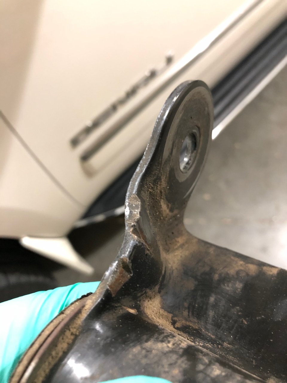

    I am disappointed with OME. They started to chew away at my shackles. I would look into another company. I have heard good things about the dobinson leaf packs. I think the price point is similar.

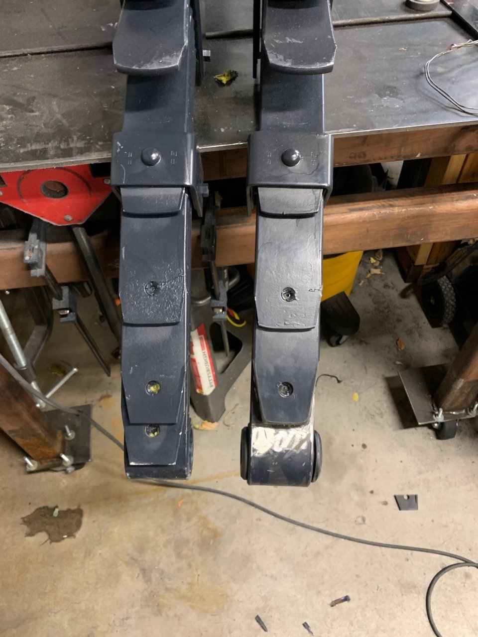

    For any of you guys that haven't seen the Archive Hammer Hangers thread, there has been a fair amount of discussion about this issue over there.
    Tacoma Hammer Hangers - SOA + SUA - Archive Garage
    TLDR-
    Looks like ARB just re-purposed the springs they built for the Hilux with traditional hung shackles and sold them for the Tacoma. The second (and third on HD sets) spring down are long enough that they actually stick inside the shackle when at rest or compressed. When flexed on a given side the spring ends will move out of the shackle and when the suspension comes back up if the spring isn't centered on the shackle it can hit the edge and cause damage to the shackle.
    Looks like a few people have trimmed and cleaned up the ends of the offending springs to prevent this from happening. I will probably take a look at doing that myself the next time I get around to pulling the springs off in my never ending attempt to stop the squeaking. Probably going to end up being when I install the hammer hangers one of these days.

    My squeaks from the rear suspension are next to nothing compared to what they used to be before going to a heavier duty shackle hangers and shackle. I cut/trimmed the offending leaf back. I did it with the leafs still on the truck with a cutting wheel and angle grinder. Pretty quick and easy. Good luck.

    Not my picture. Borrowed it from BAMF HD shackle hangers thread posted by @smw62891. I did the same thing and it turned out great.

    Just looked at mine last night and sure as shit they are rubbing. Both sides are rubbing in the driver's side of the shackle hanger and have already worn a groove in it. Guess I will have to chop them down.

    Yup mine are rubbing bad too. I always wondered my springs made so much noise now that explains it..
    Really disappointed in the designs of the OME springs that they do not work with stock shackles...
