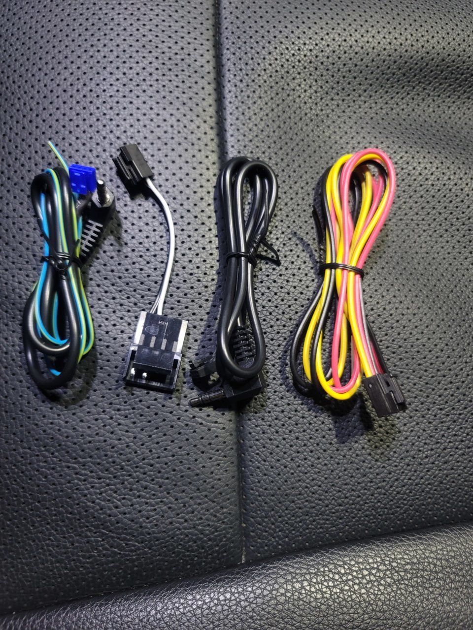

    Alright gents, I did my install tonight, and I have a few questions. First I know I am missing my GPS antenna adapter, that comes in on Wednesday so I'll add that once it comes in.
    The obd2 cable that has a white and black connector coming out of it, I was able to figure out where the white one plugs into but I was not able to figure out where the black one goes to as I had nothing else to plug into, picture for reference below
    I also had some leftover wires, everything seems to work fine except for my USB which is grayed out on my screen for some reason, but I'll mess with that plug when the GPS adapters come in and I have to get back there.
    Here are my extra wires, do I need to do anything with these?

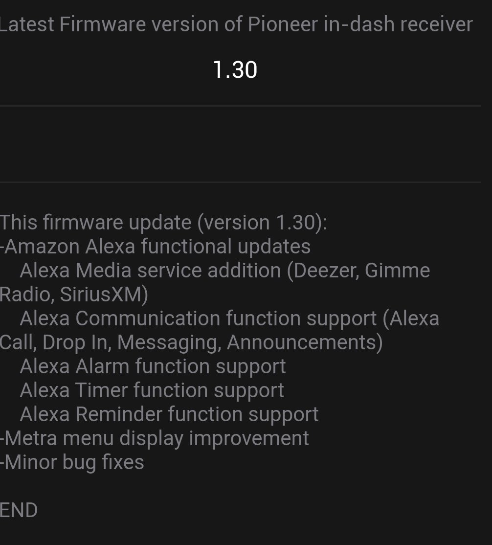

    FYI Firmware version 1.30 dropped today (at least for the 6600). It only appeared on the CarAVAssist app and not on the downloads page for some reason. I can confirm it did fix an issue some have reported about triggering the front camera with a button from the maestro config (rr2 in my case). Most of the other fixes were Alexa related. I wish I screen grabbed the release notes as I assumed it would have been on the website. I am sure someone else can upload that shortly.

    This is correct i just installed my 6600 today and I updated the firmware to 1.30

    Here it is :headbang:

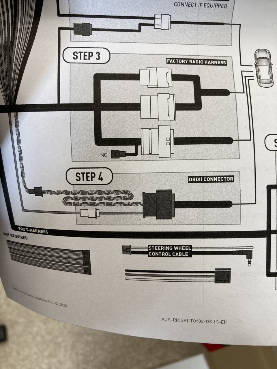

  8. Oct 7, 2020 at 4:48 PM
    #1148
    daveeasa
    daveeasa FBC Harness Solutions
    May 14, 2020
    #328079
    7,483
    David
    PNW
    2016 Tacoma OR DCSB 6MT, 2005 RC 5MT PreRunner, 2002 Tundra SR5 RCLB 4x4
    Step 4 I believe? I’m not sure though as I haven’t connected mine because I’m not even sure where it’s supposed to connect to with the large connector.
